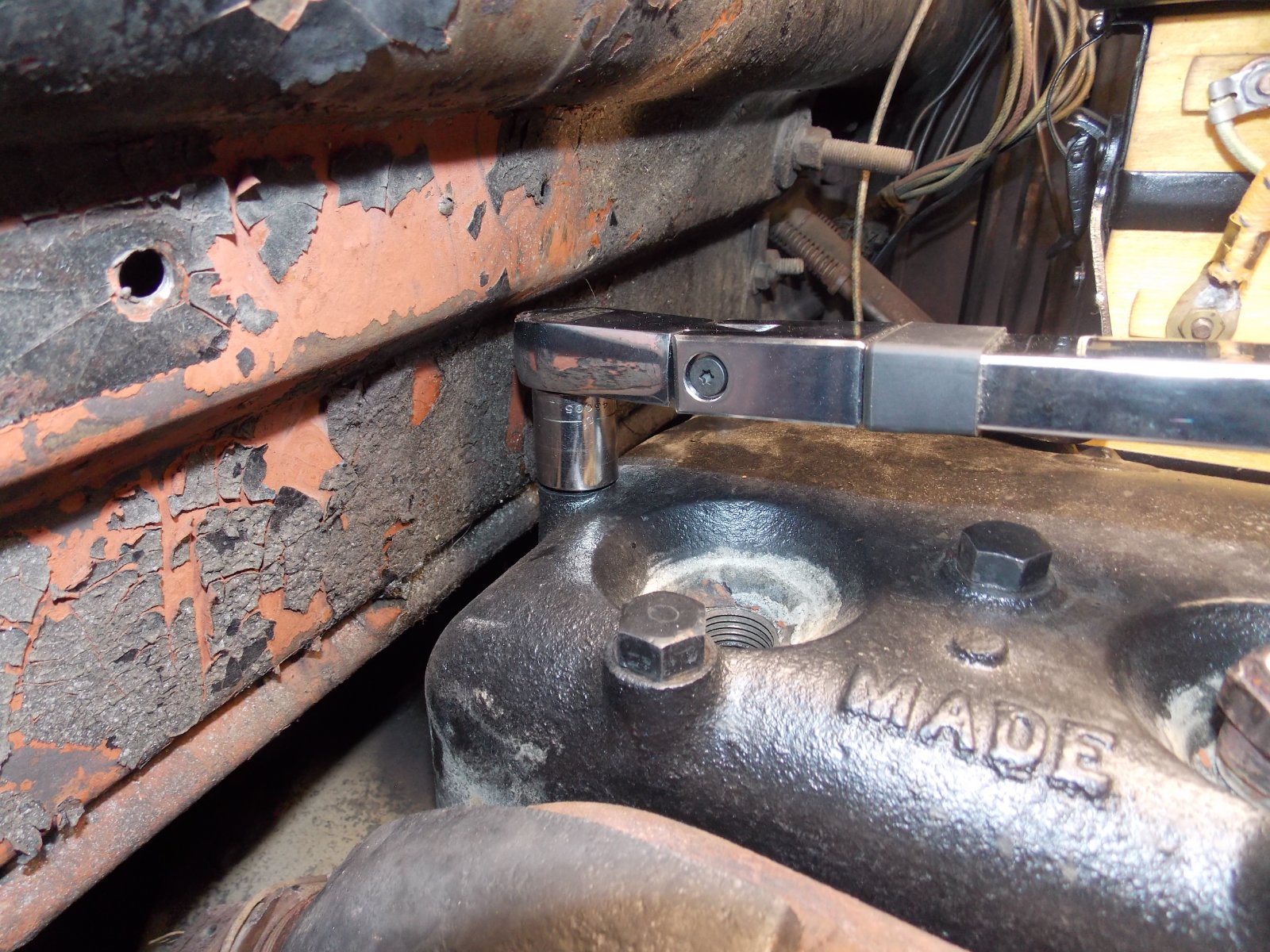

Rear head bolts another fix

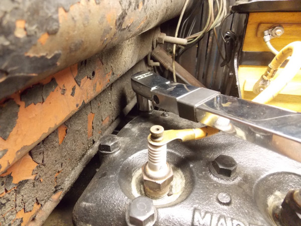

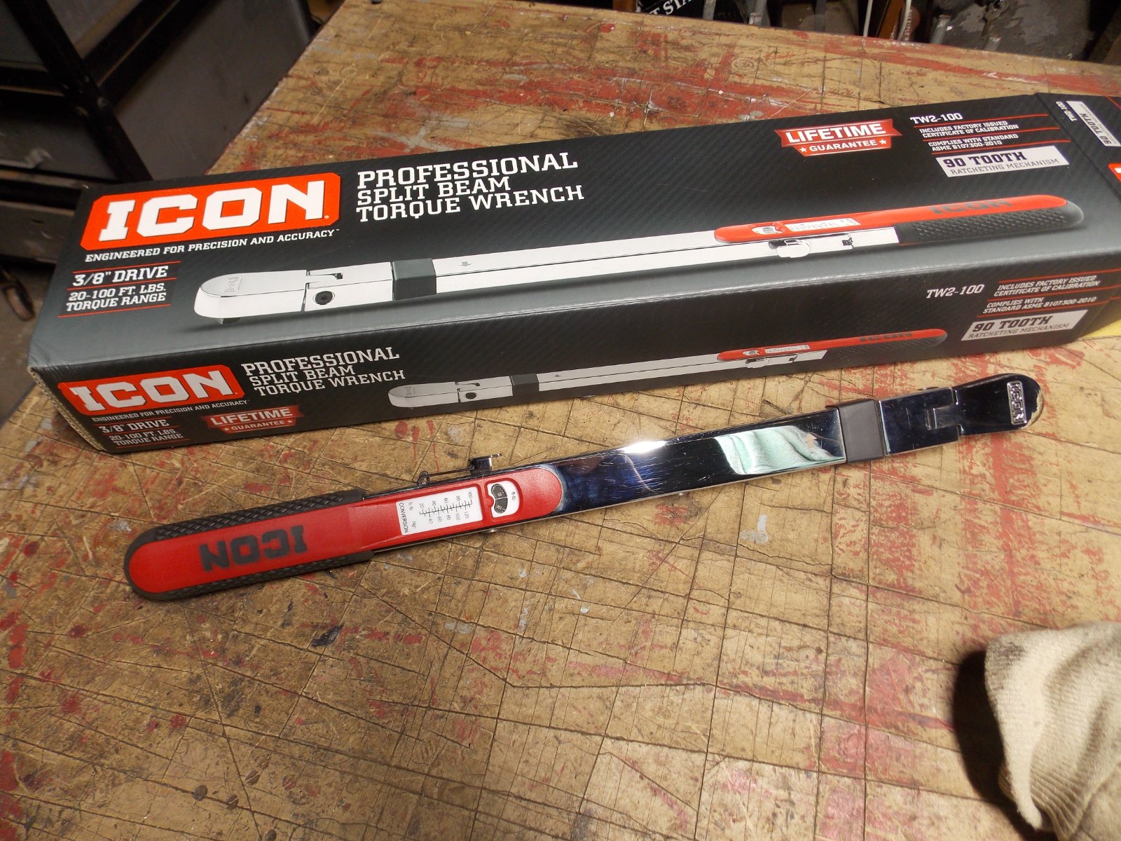

I had to replace the head gasket that failed on my 26 RPU, in replacing it there is always those two rear bolts you can't get a torque wrench on. Well I found a cure at Harbor Freight, a 3/8 drive torque wrench with a very thin flex type head. It gets in where I couldn't with any of my normal torque wrenches. I don't usually get tools from H.F. but in this case I made an exception. Hope this helps some of you out. Jim

A crows foot works too…, just saying.
- Posts: 6573
Re: Rear head bolts another fix
Yeah, but what other justification do you need to buy yourself a flex head digital torque wrench other than its "My" Christmas present too.
Looks like harbor freight has finally copied my Snap On torque wrench.
Not digital it's analog so no batteries to go south when not in use. Plus my wife was happy to find something that I could actually use for Christmas. Jim

They have copied more than the torque wrench. The ICON brand is definitely not the Harbor Freight most people remember. Harbor Freight hired engineers and product developers from Snap-On to help better their ICON line. I am not saying all of Harbor Freight tools have gotten better (I'm looking at you Pittsburgh and Doyle) but the ICON line is actually pretty good. I bought a pair of the ICON slip-joint needle nose pliers, as I already have a Snap-On set, not only are they identical but the fit/finish on the ICON is better than the Snap-On.
The September/October 2025 Vintage Ford has a detailed article describing how to join a box end wrench and a socket wrench to help with measuring the torque on the rear two head bolts (article and photos by Bud Redding) . Merry Christmas to you all !
The original sparkplug head bolt wrench does just fine and was made just the right length to tighten the head bolts to the proper torque without more cool shop tools!

Before you trust knock off shore tools take that torque wrench to any Snap On truck and check the accuracy of the calibration on the calibration device on any Snap On truck for free.
I'm not saying these off shore tools are bad just check them. Those back bolts are the last place you want to break a bolt. Think of the work to remove those broken studs.
I have used crow foots.
My preferred way is to use my 1/2" proto torque wrench.
For the 2 rears, I use a long double box wrench on an already torqued bolt to calibrate my pull with that long wrench.
