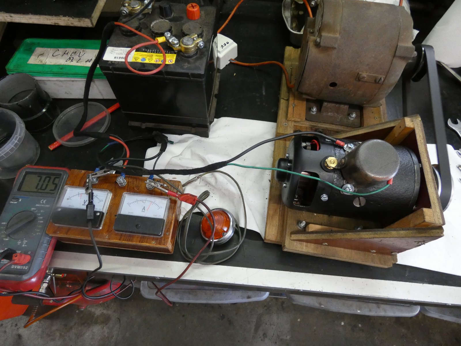

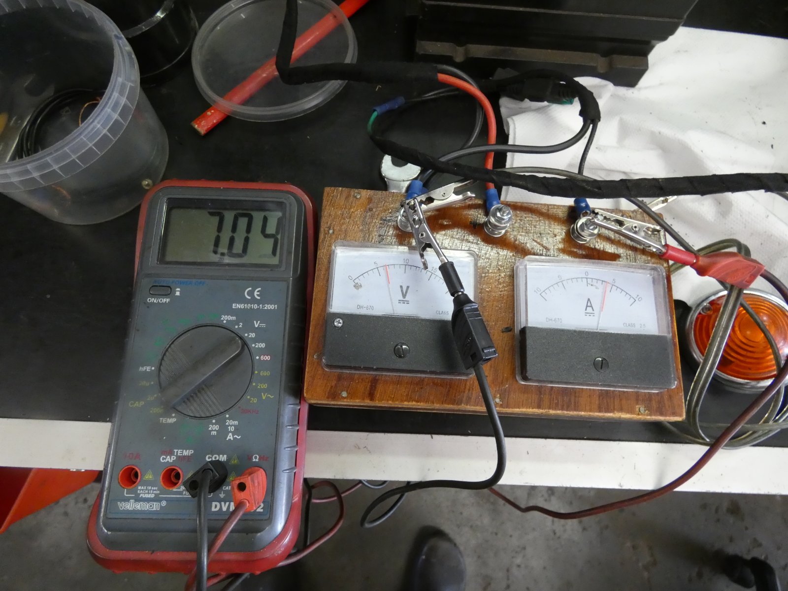

"Bench tested it and it puts out 6.8 - 7.00 volts at 1100 rpm."
It should read MUCH higher voltage than that. T gens are constant current, not voltage. They turn clockwise when looking directly at the gear. I stopped setting null point long ago. Ron Patterson's adjustment method is much more reliable.
If you're bench testing, set the brush plate rotation for 1A charge into a 6v battery with the 3rd brush pushed all the way away from you. Then, you can set the final charge rate once the brush plate is calibrated.

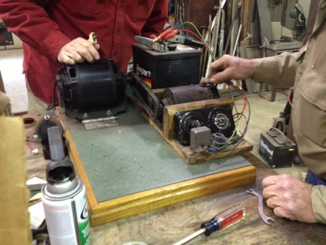

I also use Ron P's method on my bench tester. Much less aggravation to get a correct null setting leading to a correctly adjusted output.Jeff wrote: ↑Thu Jan 08, 2026 1:29 am"Bench tested it and it puts out 6.8 - 7.00 volts at 1100 rpm."
Jeff
Use the same method for in car adjusting also.
Above is the method as explained by Jeff.

Buy the book and read the setup procedure, Ron wrote a lot of it.
With the generator out of the engine, I noticed if you put an ammeter in line with a + voltage to the generator terminal and touch a bare spot on the case, the amps will be the same as the generator operating in the engine.
The test is recommended in the book, but not like mine.

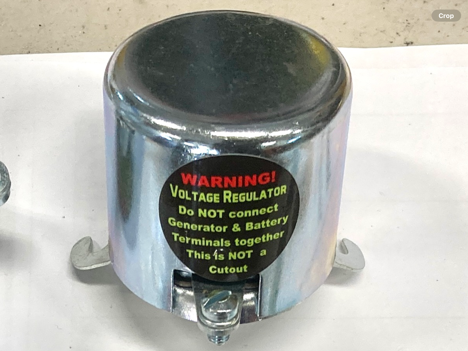

While shorting the generator used to be normal and common practice, I do not recommend it anymore.
Voltage regulators and diode conversions have been around too long and shorting them WILL cause damage.
Use the light bulb as a test load like Dave Woods described.
Too many cars and parts have changed hands plus some owners have forgotten they installed them.
I had trouble diagnosing a charging issue when the owner forgot they had a regulator and the battery was fully charged.
I hate ruining good parts for no good reason.

VERY well said Mike. Of the 1000+ VRs I've sold the vast majority of the ones that have failed (a dozen or so) were due to owners "flashing" their generators. Even my warning label wasn't enough to save them!Mike Silbert wrote: ↑Sun Jan 11, 2026 10:19 amDave & Dave,

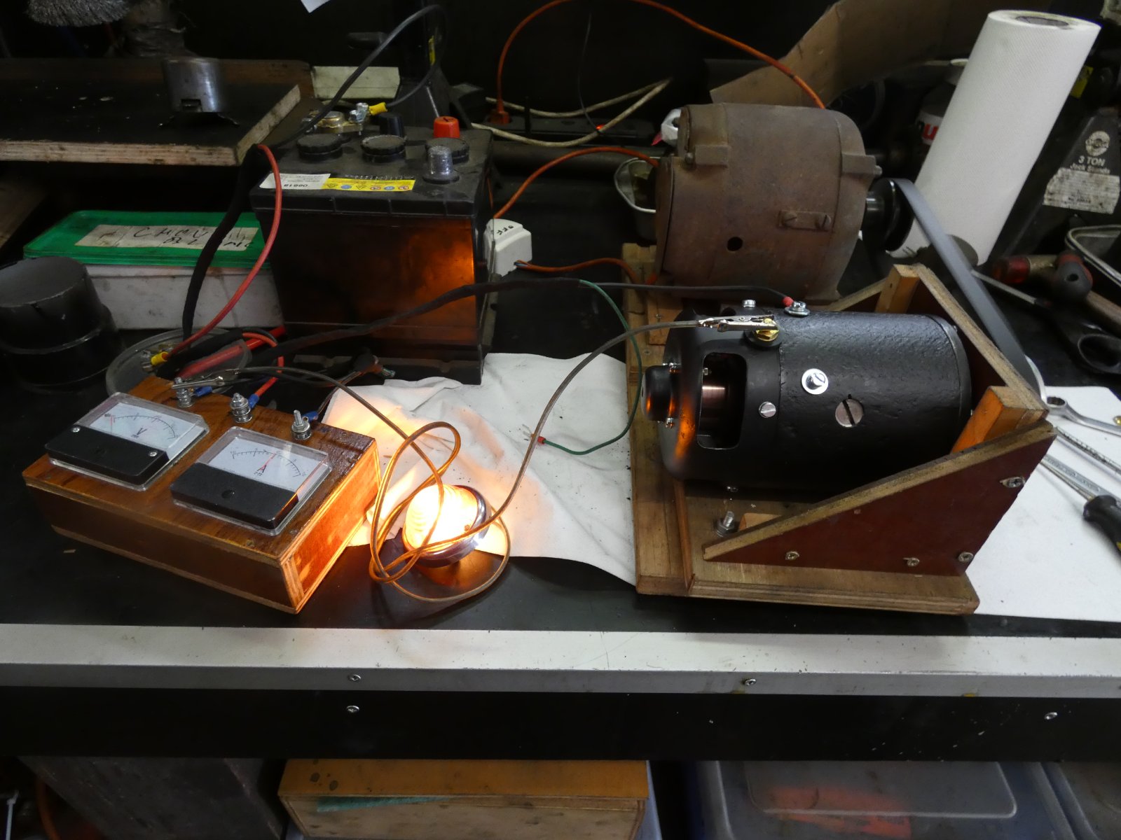

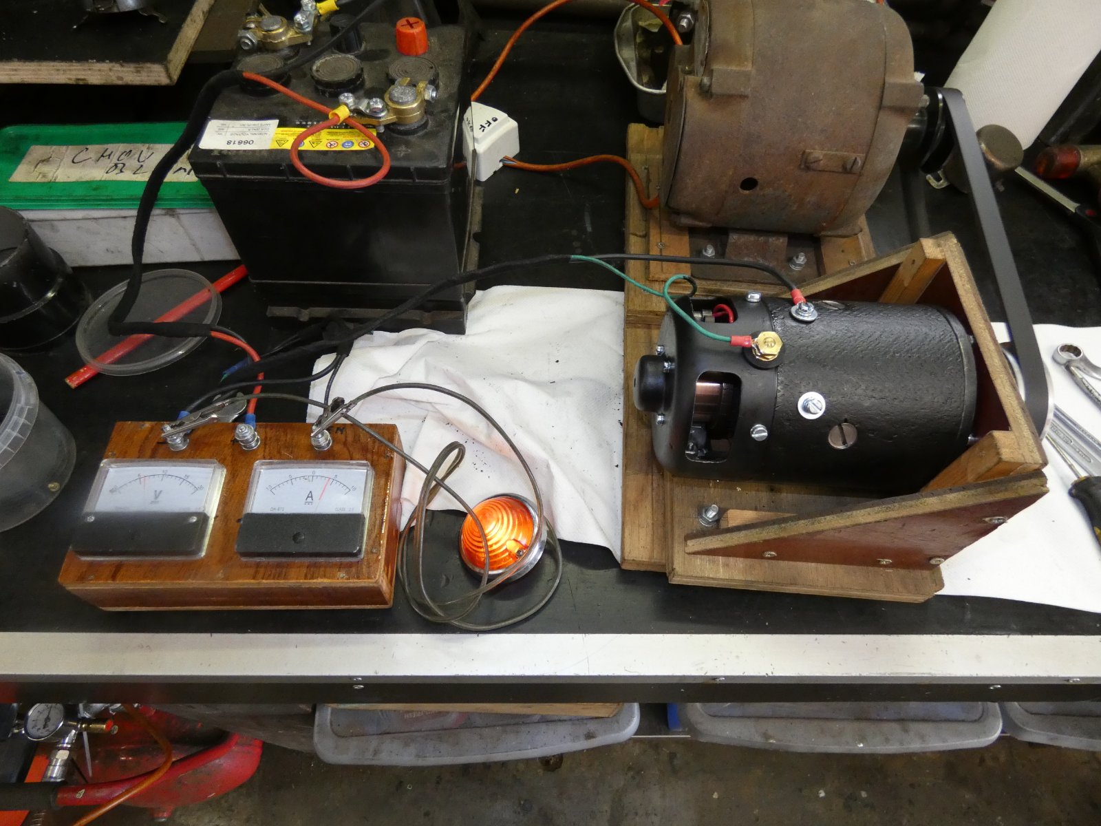

I was studying this post. What bothers me is the way the generator was bench tested by running it the wrong direction.
Did you tried to flash the generator and re-polarize the field?
Here is how I do it.
Take of the cutout.
Connect a test light between the generator out put and the frame of the car. A 21W 12V bulb will do the job.
Connect a wire on the + post of the battery. Don't use the yellow black wire. It is connected to the amp-meter. By flashing with this wire you risk to distroy the amp-meter .
Make the engine run at a brisk idle and flash the generator with the wire connected to the +post of the battery. Flash only 2seconds.
During the flash the test light should light up and should stay on. Speeding up the engine should make the light brighter.
Stop the engine, wait a moment and start up the engine. Now the light should light up right away.
If not your generator have a problem.
If yes, just put the cutout on the generator and connect the yellow black wire. Before connecting the wire test the voltage on the wire, it should be the battery voltage.
To set the brushes, Use a good amp-meter (not the amp-meter on the dash).
Connect the amp-meter between the generator out put and the +battery.
Set the third brush all the way down.
Loosen the four srews on the back of the generator the way you are able to move the brush holder bridge.
Make the engine run and turn the brush holder bridge till you read 1A on your amp-meter.
Tie the four screws. Now you can set the third brush to find the right current output (4A to 6A)on the amp-meter.
An other question.
How was the armature tested on the growler?
Was it just the magnetic test or did you also test the armature output on the growler?
Did you test for shorts or open windings?
Good luck
Andre
Belgium
