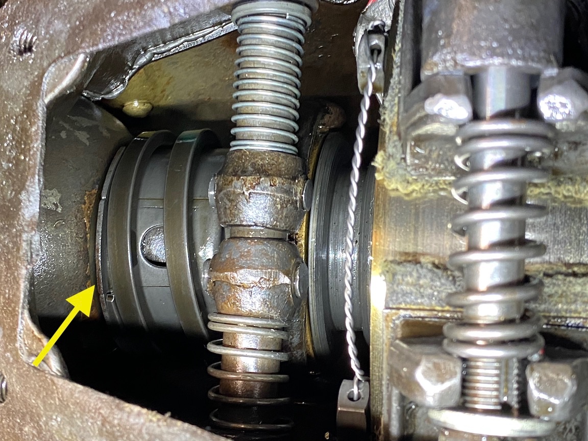

1926 Touring, sudden-onset problem of slipping in high, but low and reverse are fine. Peeked inside for clues and found the clutch fingers quite loose. Had the clutch spring broken in service? Careful inspection showed it was intact, but...
After much puzzling I finally noticed that the clutch spring and spring cup were pushed right back the half-inch or so to the 4th main. This took a lot of tension off the spring and is doubtless the reason for slipping in high.
So what happened? Pin sheared in two places? Sounds unlikely to me and an engine-builder friend has never seen such a failure. The spring cup and the two 180° holes look just fine with no signs of trauma.
Anyway, I'm resigned to pulling the power plant out for inspection and repairs, but in the meantime I welcome any speculation about what's going on here.

Where is the rest of the spring ??????? Something (spring?) came from together !

The spring retainer cup normally sits very close to the ball cap. If the pin was sheared or gone, the cup would be rubbing on the ball cap. There would be NO gap. I see a gap. If the pin was gone, the cup rubbing making chips, You could see some of the pin hole in the output shaft under the spring @ the cup base.

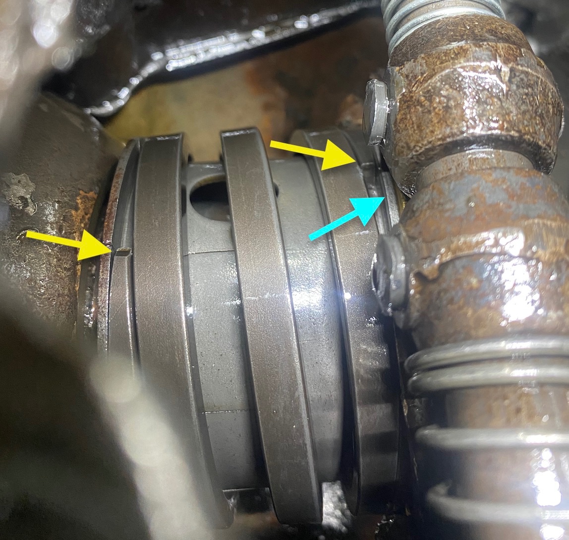

Steve, here is another photo with the hand lever back and spring compressed .
Near as I can tell, the two spring ends (yellow) are where one would expect and the spring coils evenly spaced. And, while it's hard for me to see, it appears the forward end of the spring is riding tight to the back face of the clutch collar, also as one would expect (blue arrow).

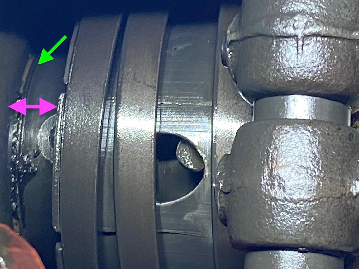

John, my assumption of roughly 1/2" clearance between spring cup and fourth main is from my '24 Speedster, photo below. Pink arrows indicate that gap. Agree the above photo looks like a gap, but in the photo below, I see a lip of sorts at the small diameter of the fourth main (green arrow) that could give the illusion of a gap. One can also clearly see the end of the pin in the cup hole, something not showing in the problem transmission.

Is anyone in a position to look inside an assembled transmission to eyeball the clearance, if any, between the rear flange on the spring cup and the forward end of the ball cap (my pink arrow above).

Your 24's retainer cap has a problem.When properly installed the cup gets rotated from the pin to lock down into home. You should NOT see the end of the pin in the cup. That would decrease the gap you see by aboul 3/8". We found another problem on a different car.

The gap between the retainer cup & the 4th main on your 26 looks normal.

Regarding the 24. The pin goes in in the position you see then the cup gets rotated about 45 degrees to drop the pin into a slot in the cup bottom, thusly locking/capturing the pin in the cup. you should be able to rotate the cup to the proper position in place without removing the transmission. you will need to minimize spring tension.
(added) Grab the spring & cup & rotate CCW 45 degrees. (Looking toward the rear end) The cup will pop back into locked position.
I mentioned I mocked up some loose parts. There is very little gap (1/8') between the cup & the 4th main with the cup pin in the correct place.
That extra gap is definitely from the cup pin riding out of position on the inner cup flange.
