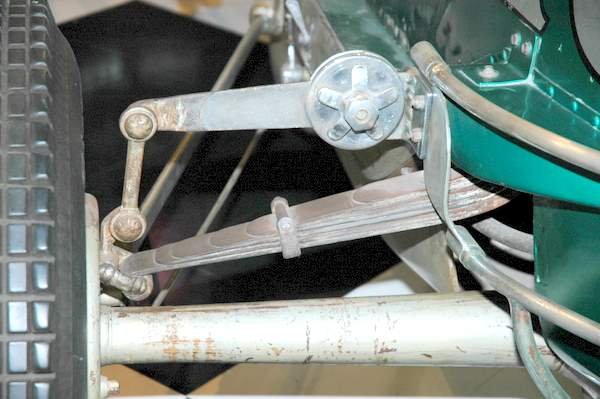

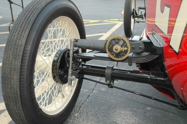

This from a noted speedster builder, Elvin Townsand, on one of his.
off the internet
off the internet
- Attachments
- 116841.jpg (56.32 KiB) Viewed 864 times
- 116836.jpg (58.73 KiB) Viewed 864 times

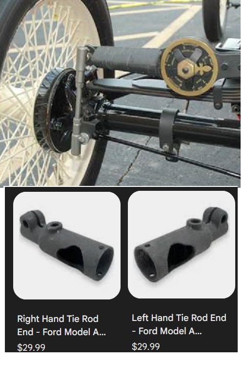

In the last picture where can the connecting link be obtained? I need a double end to connect the shock to the rear axle?

The last picture linkage was not Elvins, it appears to be Model A tie rod ends

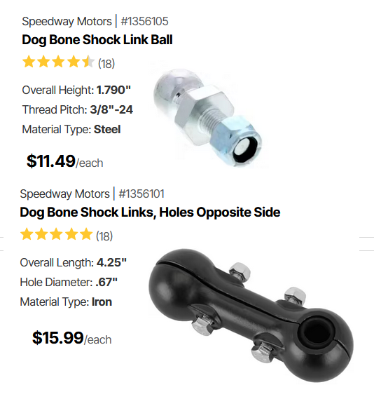

a more traditional way is with dog bones. the come if various for configuartions

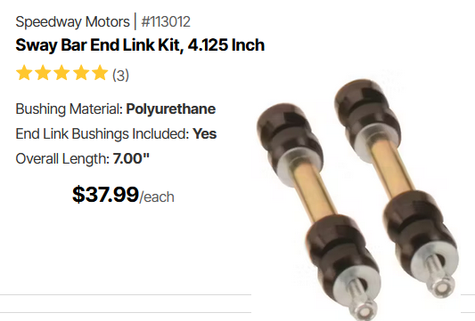

Elvin's, first photo, look like Sway Bar links
Browse Speedway they have many styles https://www.speedwaymotors.com/Search?q ... ay%2520Bar
