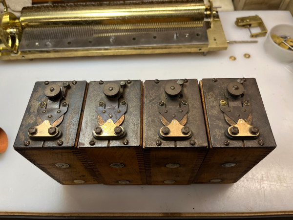

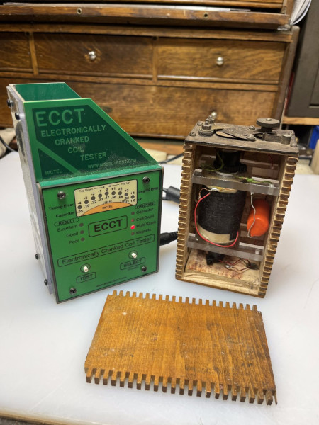

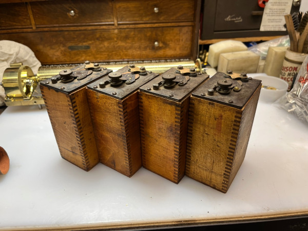

While my hand heals from surgery, I’m slowly getting back into doing things. I started out this weekend by doing something small and light, and for myself. I’ve had an unrestored spare set of late 1912 Heinze ignition coils for my [October 1912 build] 1913 Canadian Ford. I decided to rebuild them. Since my car is a very unrestored cosmetically, but very well maintained, and running car, my coils won’t be visually mint condition but mechanically they will be like new. Completely gutted with new primary and secondary windings used for the later Ford model T coils available from Lang’s or Snyder’s, and new correct capacitors. The original contact points have been carefully removed and new ones installed. Now that they have been calibrated on Mike Kossor’s awesome Heinze edition ECCT unit, I will be able to fill them with tar and they’ll be as good as new for the next 100 years! 😁
These coils work very reliably! The set currently in my car has been giving me flawless performance for quite a few seasons with thousands of miles!
My grandfather bought this car from the original owner in July 1956 who purchased it new in November 1912

Darren what did you use to open the case?

I used the iron rods from the original Heinze core and very carefully packed the new primary coil as tight as possible. That way nothing needed to be modified.
I opened the case by forcing the side panel apart from the inside where the original capacitor is with a screwdriver and hammer like a pry bar. They mostly come apart without issue but if it breaks I just glue it back together and no one will ever know after careful repair.
The brownish potting material Heinze used is similar to the “cement” used inside pre-1900 Swiss cylinder music boxes that I restore. It’s a recipe of rosin, shellac, and pulverized brick. I actually use type two roofing tar to fill them and save that cement for my music box work.
9 times out of 10, the original cement has lost its bond to the inside of the coil box and there’s actually not that much in them because the original secondary’s took up a lot of room.

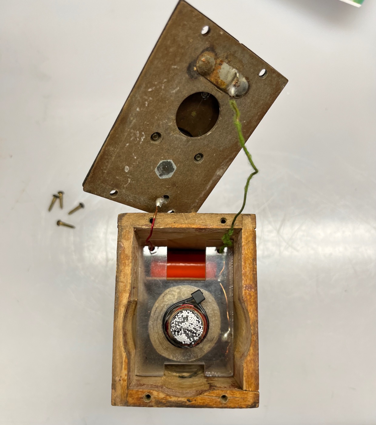

Darren are you squeezing the secondary around the original core & tying wire below & above the secondary windings? Did you make the stabilization plates out of plexiglass?
I really wish that you would share on a thread the specifics so some of us that have these early coils can try our hands at duplicating your work. Thanks ever so much for sharing what you’re doing on this thread. Best John

Hi John, you are correct on all accounts! I will post some more photos and details of exactly the things you mentioned in further details a little later. 👍👍

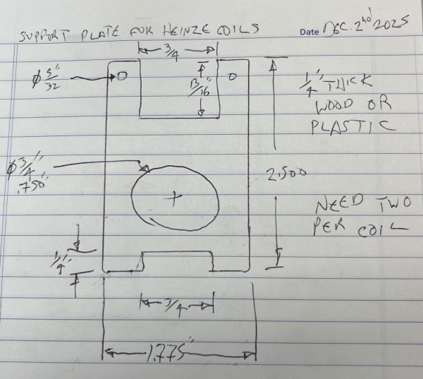

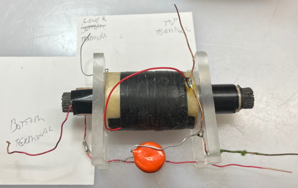

Here’s a simple drawing of the two support plates that I used in the Heinze coils. I made these on a milling machine but you can do this any way you wish. I’ve used both wood and plexiglass for the material. The slots are there only to allow the potting tar to get all through the coil. The only important measurements are the location of the hole for the primary core to go through, and the outside dimensions.
Last edited by Darren J Wallace on Thu Dec 04, 2025 3:30 pm, edited 1 time in total.

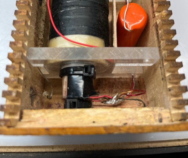

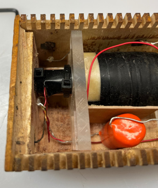

When you assemble everything, I used zip ties to hold the plastic plates lightly snug against the secondary coil. I used mechanical wire to hold the core snug on the primary coil. You can see where I have installed the first one on the right end of the coil. As long as the original iron core rods are good and tight in the cardboard tube, don’t get too hung up on how tight the zip ties are. They need to be tight of course but when the tar is poured in, everything will be solidly frozen in place. You just need them to hold everything from moving before tar is poured as it’s important to test the coil before committing the tar. The iron core rods MUST be tight enough that it is difficult to slide them all by hand. You should have to install the last of them with a small hammer.
If you lost any shims that were underneath the original primary core, the core top wants to be just slightly under the top of the top metal plate to flush. Within 1/64”.
Remember you are pouring the tar in from the top with all four panels of the coil assembled.
Last edited by Darren J Wallace on Thu Dec 04, 2025 3:33 pm, edited 2 times in total.

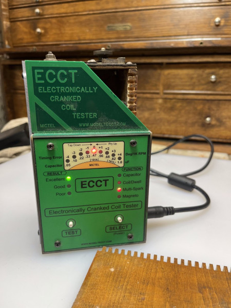

Also, you CANNOT use original Heinze electrical specs when setting up the finished coil! You have to now treat this coil like you would a regular later coil, I’m also using all new primary and secondary coils available from Lang’s and Snyder’s. I have not tried using any original wiring. I made a special adapter to use on a Strobospark, HCCT, or get Mike Kossor’s Heinze edition ECCT.
I have had excellent results changing just the points on original Heinze parts which I’ll post pics of too later.
Last edited by Darren J Wallace on Thu Dec 04, 2025 12:17 pm, edited 1 time in total.

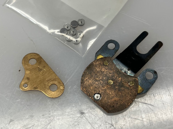

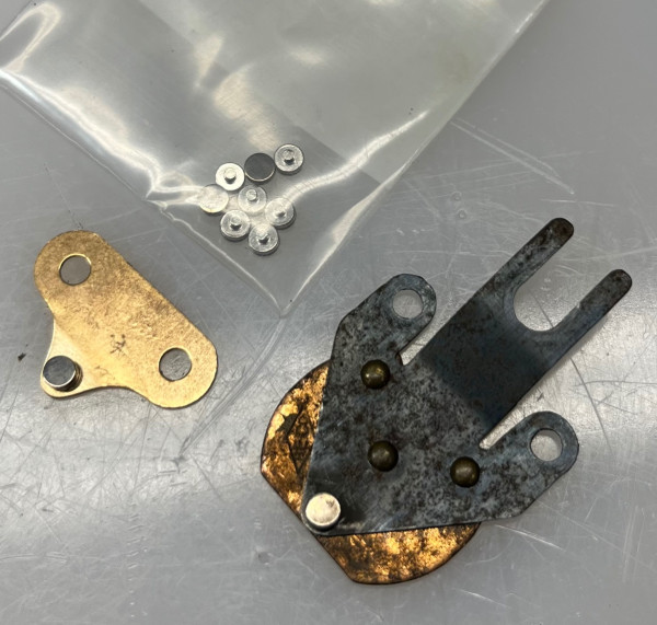

I used a 1/8” end mill carefully in my milling machine to access the point rivet. You must drill out the original hole to .062” to accept the new point rivet. Care must be taken not to distort the original parts. I use a machinery bench block to insert the old point side to carefully punch out the old point. You will trash your 1/16” drill drilling out the hardened spring material so drill the brass upper rigid point first!😉
Last edited by Darren J Wallace on Thu Dec 04, 2025 3:35 pm, edited 1 time in total.

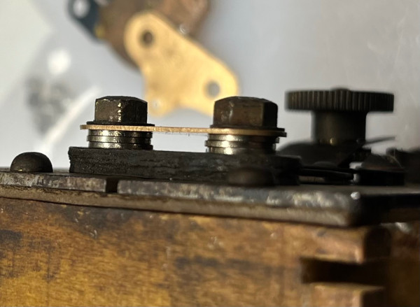

Because of the larger thicker points you will have to raise the upper stationary point considerably. In this case it worked out to just a few thousand shy of 3/32”. I use washers as shims to get the height right, then once I’m happy with the thickness required, I machine black plastic spacers which look less obtrusive.

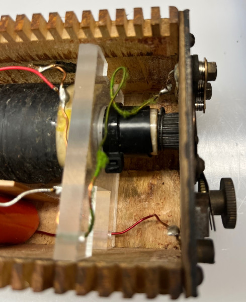

You will also have to bend the vibrator in many cases to get the adjustment within the range of the adjustment knob. It takes some patience but once it’s done, you’re done. The set in my car currently has run fault free for 6 years. I’ll post pics when I’m ready to pour tar.
Last edited by Darren J Wallace on Thu Dec 04, 2025 12:18 pm, edited 1 time in total.

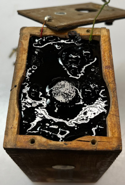

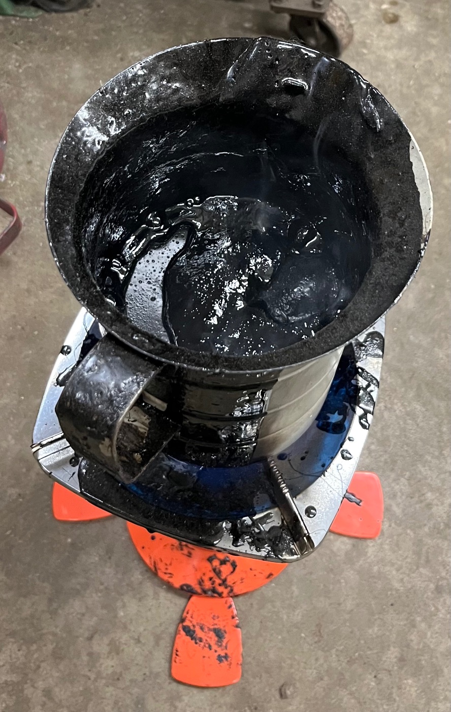

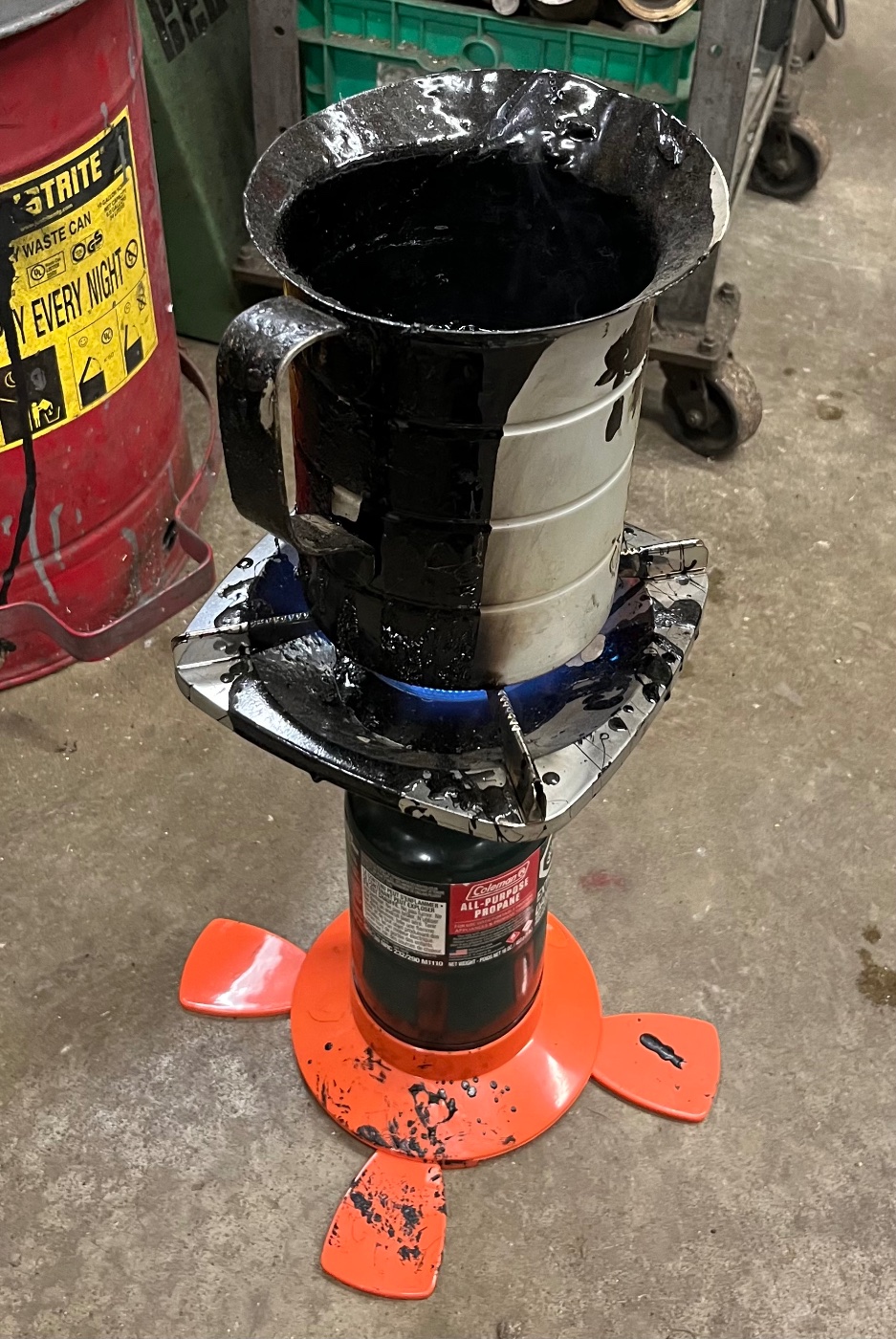

Decided today to pour some tar into the refurbished Heinze coils. I strongly suggest you test the performance of your coils before committing to pour the tar because trying to undo rebuilding them after fresh tar is not going to be fun if not just plain impossible. Haven’t had to do that ever and don’t plan to either!

Post by Darren J Wallace » Sat Dec 13, 2025 3:44 pm
My tar pot set up:
Darren J Wallace
Posts: 369
Joined: Sun Jan 06, 2019 11:43 am
First Name: Darren
Last Name: Wallace
* REQUIRED* Type and Year of Model Ts owned: 1913 Canadian Touring 1905 Queen model B
Location: Woodstock, Ontario, Canada
Re: Rebuilding 1912 Heinze Coils
Post by Darren J Wallace » Sat Dec 13, 2025 3:46 pm
The coil after a very careful, and SLOW pour. Watch for burps and fill slowly as needed.
Posts: 5574
Last Name: Gregush
Location: Portland Or
Post by Mark Gregush » Sun Dec 14, 2025 8:40 am
Why not pour from the side with just enough tar to hold things in place like the later coils. That is how I would do it.
In any case nice job!
Darren J Wallace
Posts: 369
First Name: Darren
Last Name: Wallace
Post by Darren J Wallace » Sun Dec 14, 2025 8:53 am
Thanks! You could tape up and seal the hole in the top plate where the primary core goes through easy enough. It's a lot bigger in diameter than the core. But then the top plate could be stuck. That wouldn't really matter that much if there's nothing wrong with it. I guess I just prefer to be able to remove the top plate, but that's just my personal opinion. Either way would work good. Glad everyone is taking an interest in my post! The only other thing I could add is the tar does hold all 4 wood panels like glue so having one loose would mean a better chance of renewal 100 years from now! I just reassembled them the way they were dismantled :P
Thanks for adding an important option I didn't think of! Cheers!

Post by Mark Gregush » Mon Dec 15, 2025 9:44 am
I would have to check the number, but the later insulating piece that goes under the metal top cover has smaller hole for the core, at least the ones I got from Langs did. Think the 1913 style? See your point about pouring the tar.

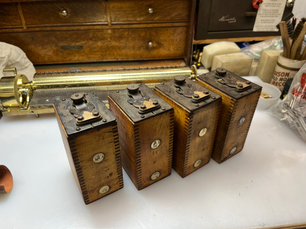

Post by Darren J Wallace » Sun Jan 11, 2026 8:31 pm
Finally finished the whole set. I wanted this set to look old. My car looks old, the coil box looks old, but they operate like champions! New points, capacitors, windings, and using all the original Heinze hardware.

For those curious minds:
how to open Heinze coil boxes without breaking the wood. I use a heat gun and puddy knife, I open the top of the coil and then take the capacitor side, heating both sides of the joints and using puddy knife easily open. Keep the heat going and continue separating the joints, from top to bottom, move the heat not to burn the wood. It’s an easy and very rewarding process
Regards,

Post by Darren J Wallace » Wed Mar 04, 2026 7:34 am
THAT is extremely valuable information! I wouldn’t have thought of that so thank you very much for adding this! It would certainly make it much easier to do without a doubt!
