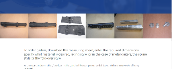

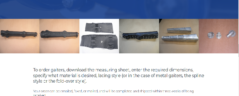

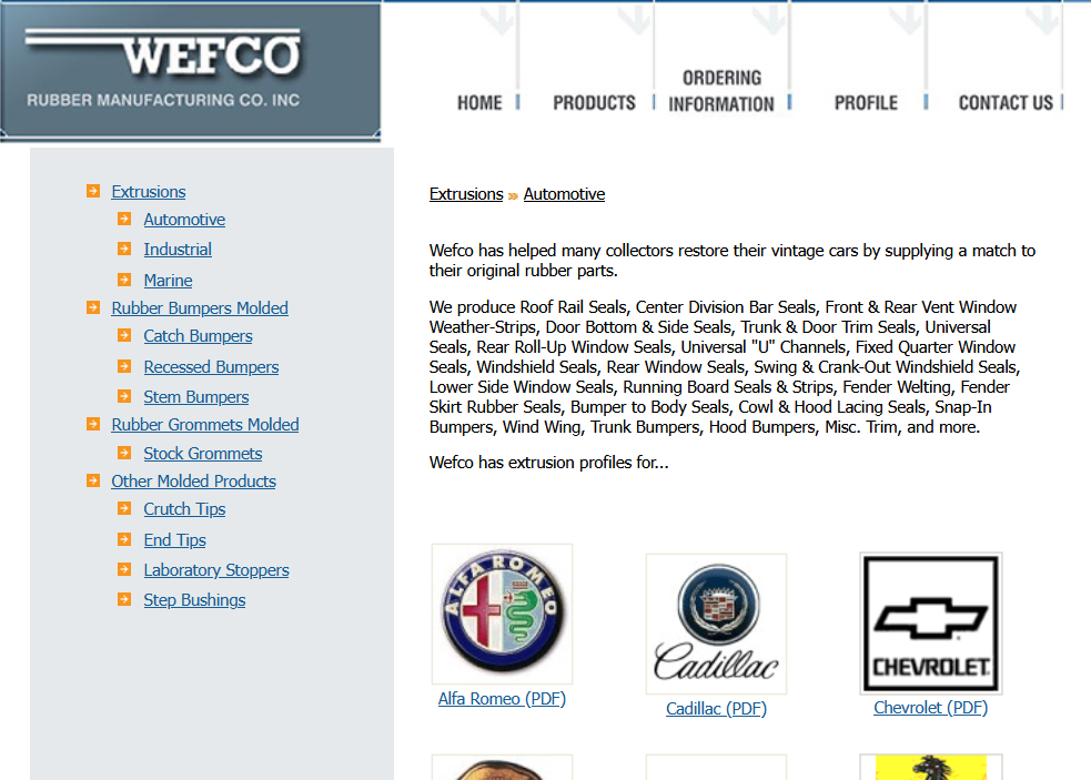

These Companies make spring gators
Accents unlimited https://accentsunlimitedgaiters.com/#about --
WEFCO not obvious https://www.wefcorubber.com/extrusions_auto.asp The following are general custom rubber molders like Rubbertech, Butser Rubber, and AE Rubber. Likely would need plenty quantity
