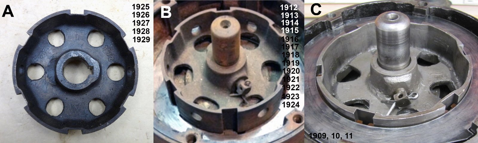

Yes, it does. But, I am taking notes and will endeavor to make a plan that reflects what ideal O.E.M.
I suppose then, that shooting for 1920 is perhaps the best shot, or is it 1925?

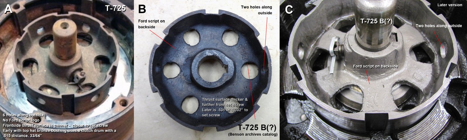

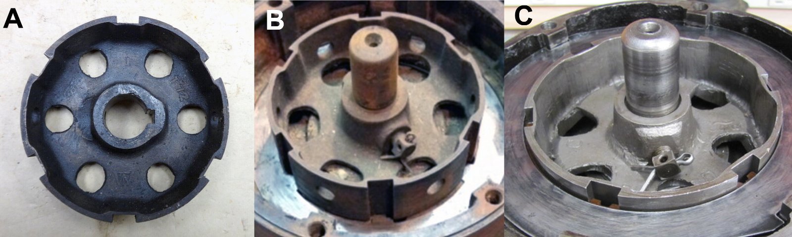

Is this the correct Clutch disk drum?
Thanks again.

- Posts: 5161
Re: 3D Model T transmission project - help needed
1920 after April? (my reference material is @ home)-1925 same until the wide drum
"Is this the correct Clutch disk drum?"
This is the most confused part. How to identify.
Since I see ford script on top, I would say, yes, its correct for 20-22?.(late using the 3 thick thrust washers.)
Some time later the back side has a beefer looking casting. Probably 22-27.

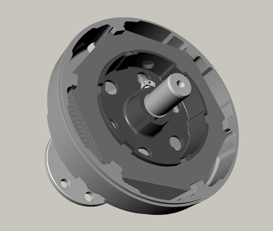

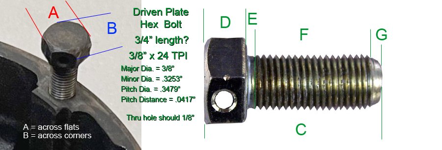

Here is the back of my brake drum (thus far). I tried to match the photos of the drum we had.
Having trouble IDing the Drive plate bolts. Says they are 3/8" x 13/16" - 16 TPI - coarse.
Thanks again,
Jim Key
Thanks again,
Jim Key
- Posts: 5161
3/8-24. Fine thread. I cant confirm length where I am now.

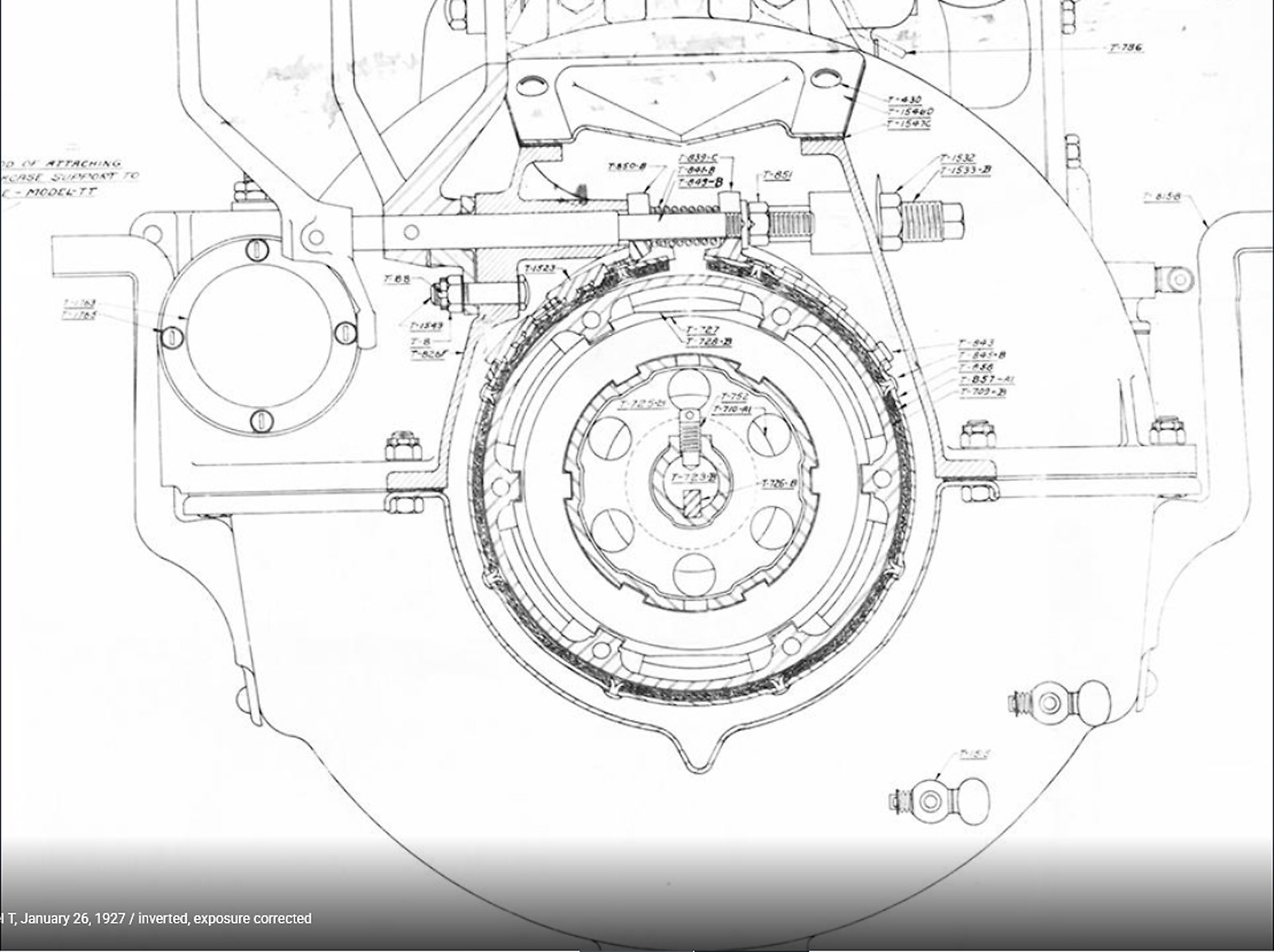

- Posts: 2956
- Last Name: Hjortnaes
- Location: Men Falls, WI

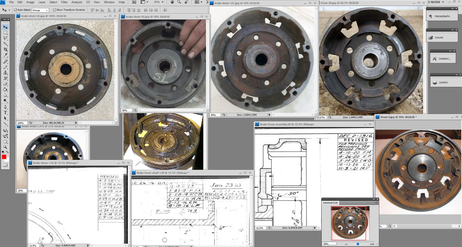

Have you looked at all of Martin's drawings yet?
I know they are on here somewhere. I just cannot find them right now.

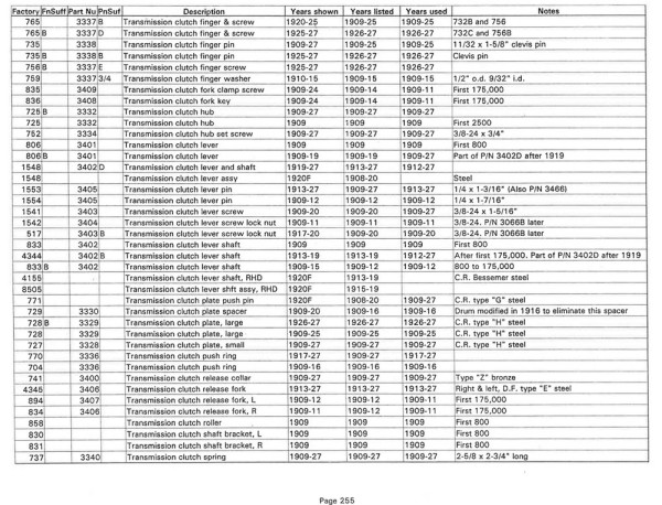

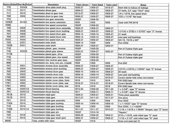

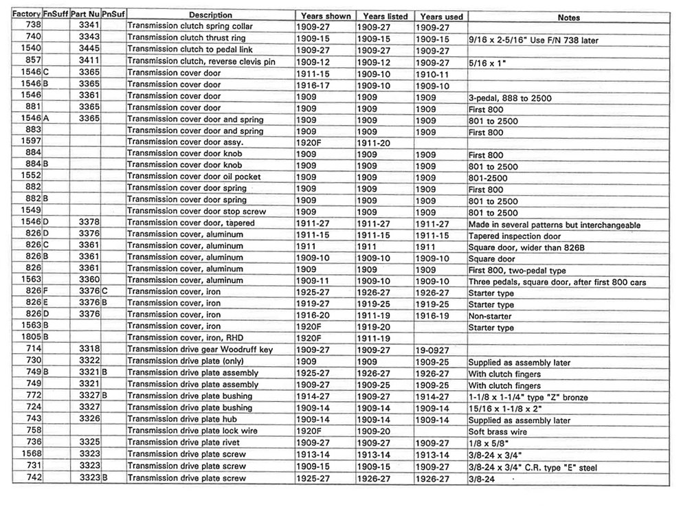

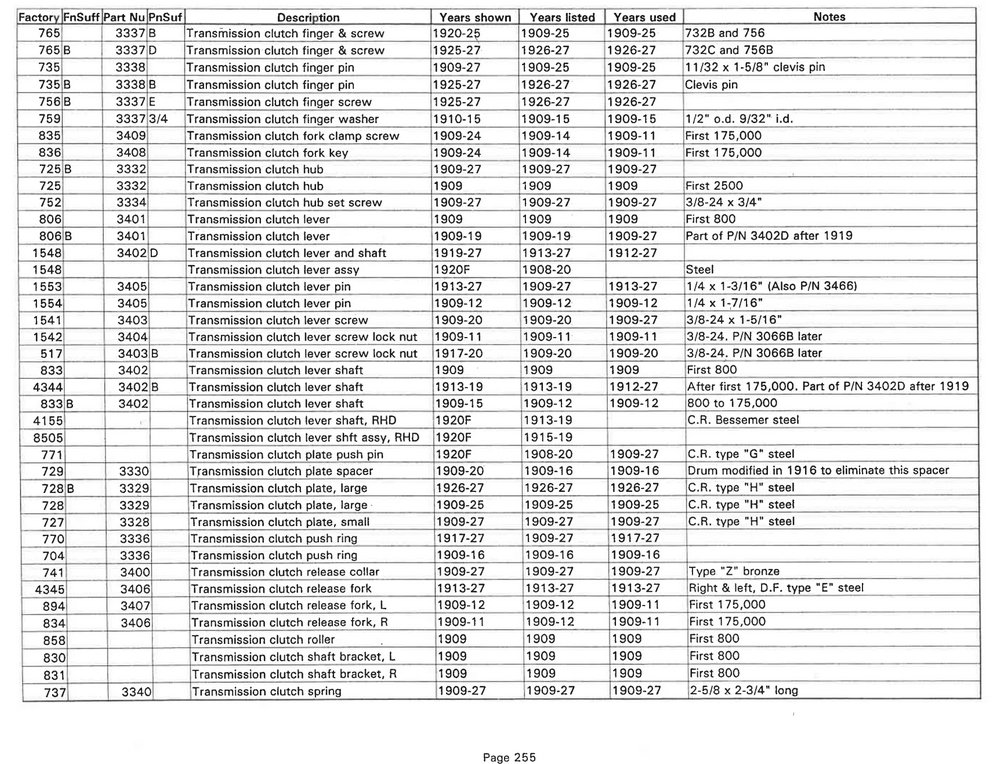

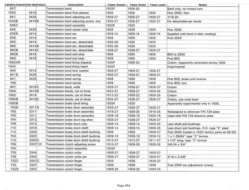

Here is the information on the Vowell Drawings

Part of what I intended from the start was the possibility of making a "Visible Model T transmission", so that the operation could be understood. Short of that, I may explore Solid works animation of the 3D parts I'm making so that one can observe the action of the low and reverse bands being applied. I haven't see a clear animation showing this yet, just descriptions. 3D models are great proof of concept so long as they are mechanically accurate, and not subject to stresses that only metal can handle.
At the very least, be able to offer a print schematic of the 1922-25 range transmission version, which I'm getting a fast education on. I have looked at Martin's work, which I find to be a nice presentation, but don't have the expertise to know if these are correct depictions of the time periods. I will be looking to have several authorities on Model T parts look over my works, before posting, or offering them to this group.
Case in point, just finished the clutch pack last night, only to find out that the large disk were originally circular with 2 flat sides. Will have to correct those going forward.
Jim Key

I would appreciate getting some help clarifying these different clutch disk drums.
Thanks,
Jim Key
Accurate Models
Thanks,
Jim Key
Accurate Models
- Posts: 5161
B) 6 holes would be early, like 14,15 & earlier. Probably DB marked.
A) Ford script on top side (Post brass hat thrust. 3 washers) Post early '20.
C) Ford script. Hard to tell, but looks like a heavier casting. Back side is heavier with a chamfer to the thrust surface. Look on the back.
This would be later than A. Most common type found today. This one fits your 22-25 range.
Happy to see you figured out the clutch disk difference. That would have been my next comment/edit.

Point of clarity: I believe the clutch drum with the 6 holes along the OUTSIDE is an "early" drum which would have been used with the "early" brake drum using the "top hat" style bushing & 2 steel thrust washers.

I just did a look at each parts catalog from 1909 to 1929 and found these years as presentation and order of presentation.
Jim Key
Jim Key
- Posts: 5161
The top hat style bushing is the thrust washer. There are no additional steel washers used.(originally)
Not all early clutch hubs have 6 holes.(pre '20) Not all 2 hole hubs are post '20. There is that period from about '15 to early '20 that have the 2 holes & the smaller thrust surface for use with the top hat bushing. There is the period from early '20 to around '21ish that have no Ford script, but fit correctly with the 3 steel washers. The 6 hole I have is DB marked.
The top hat bushing was used until early '20
Early brake drums that require a distance plate & 26 disks were used thru early '16.
The above information comes from service bulletins, period documents some from past posts & observation with measurement.

Just looking @ B. A 14 clutch hub is different in the thrust face clearance than a '24.accuratemodelmaker wrote: ↑Tue Jan 20, 2026 4:43 pmI just did a look at each parts catalog from 1909 to 1929 and found these years as presentation and order of presentation.
Jim Key
I do believe all of them will fit any year transmission/brake drum & center shaft.
The difference is in the amount of thrust washer thickness thats needed to maintain the thrust spec.
You could use an early hub in a 27 transmission drum, but you would need a thinner thrust washer pack OR remove .015 off the hubs thrust surface.

Here are the 4 pages from the Henry Ford Benson archives, listing each Model T transmission part, years in service, and variants. I found this to be of excellent clarity for defining the parts. Thought it might be helpful to share, if they haven't already been posted.
Jim Key
Accurate Models
Jim Key
Accurate Models
- Posts: 5161
Some of the information matches my findings. Some are in error?
751B lists the 1 piece type '17-'27 Also listing the 3 piece type '09-"21 (4 years MFG both??)
725B listed as '09-'27. (thrust surfaces are different '20-'27)
Distance plate usage & hat brake bushing use do coincide with service bulletin notices.
Aluminum HH's claim to be the same '11-'15. We know there are reinforcements added around mount holes for '15.
Thanks for posting this info. Ill sift thru it.

I'm wondering if someone can give me a few quick measurements on the earlier Drive-plate bolts - 3/8" x 24" x 3/4" or however long they are. Here are the key dims needed.
Thanks in advance,
Jim Key
Accurate Models

I got some interesting information today regarding transmission parts and variations. 3 drawings in particular reveal quite a bit about the transmission Brake Drum and shaft. On the shaft, the earlier version does not have the 30 degree bevel on the flange that connects to the drum. The later does.
The earliest version of the Brake Drum (narrow T-709), which I refer to as "A1", was drawn up April, 1908. It has revisions in '09, '11, '13, '14, and presumably into 1915/16. The openings for oil are located between the lugs. Did this primarily run from 1909 - 1915/16?
The T-729 Distance Plate was initially drawn up in 1908, and there are revisions for it in '09, '12, '13, & '16. It is not shown on the above T-709 (A1) part drawing. There is also a T-729 R drawing for replacement parts dated in 1919.
The Brake Drum was then redesigned in Dec. 1916, with revisions in '20, '21, & '22 - making it "A2". The openings are now larger and centered between the lugs. The strangest one I found is shown center with a riveted ring (distance plate?) This is the same practical piece of metal that is then machined out of the 1916 design, and carried over into the 1926-27 design. There is also a T-750 (assembly) "AR" drawing dated Sept. 1925 for repair and replacement parts. The entire assembly with shaft is listed as T-750. One would presume this 2nd version ran from 1916 - 1925
The wider T-709 "B" was created in 1925, and there are drawings for June & August 1925. It has been listed as 1926-27
The High Hat bronze bearing (T-769) can be seen in the original 1908 Brake Drum shaft drawing and there are shaft drawing revisions '08, '09, '11, '12, '14, and 3 in 1916.
I see that Martin Vowell did an thorough examination of the brake drum years ago. I have no desire to challenge that presentation. Rather, to present what I found today on my way towards exploring the R&D for my 3D project. The image presented with this finding, is meant to raise awareness and further comments from those who may have better knowledge. My observation is that the Brake Drum went through several major design revisions, mostly to get the best result from larger oil holes, better lugs and the best thrust clearances.
Jim Key
Accurate Models
Jim Key
Accurate Models
