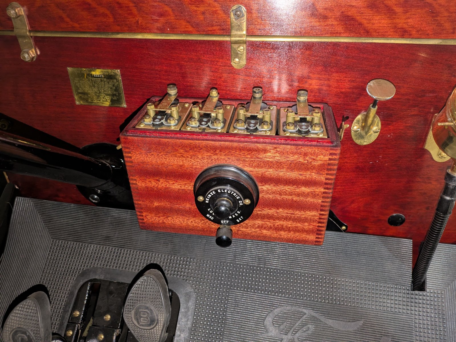

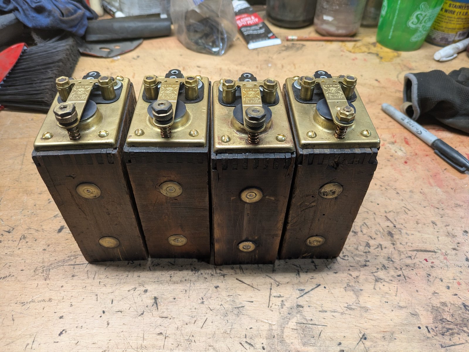

I used your ECCT when I rebuilt these KW coils for our 1911 T that I restored a few years ago. Since then I usually check them each winter and tweak them as needed. I cheated when restoring it by installing a new coil box that looks like the Heinze box but is sized for KW coils. 3 of the 4 Heinze coil that initially came with the car had bad windings, and you didn't make a Heinze ECCT at that time, so I went the "modern" KW coil route.
Your video is a great tutorial for anyone using the ECCT. Thanks for the video and for making a very useful tool!
