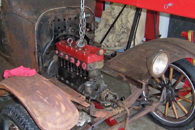

Lift point: the 2 outer head bolts in front of the 2 furthest back.

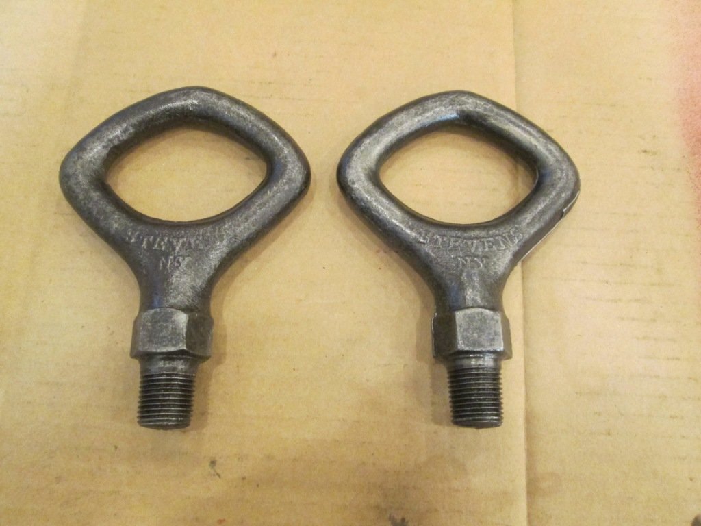

I purchased a pair of lift rings from one of the vendors. I attach the lifting chain from a cherry picker to the rings which allows me to tilt the engine easier. I asked an old time engine rebuilder about the safety of lift rings and he laughed and said you could lift a whole car with one. When pulling an engine, I either remove the firewall or at least free it so I can raise it high enough to clear the pedals. The radiator has to go and I pull the headlights so they don't get damaged. I also usually remove the steering shaft. It's a pain, I know, but with the exception of the 26-27 cars is about the only way. Get some guys to help you.

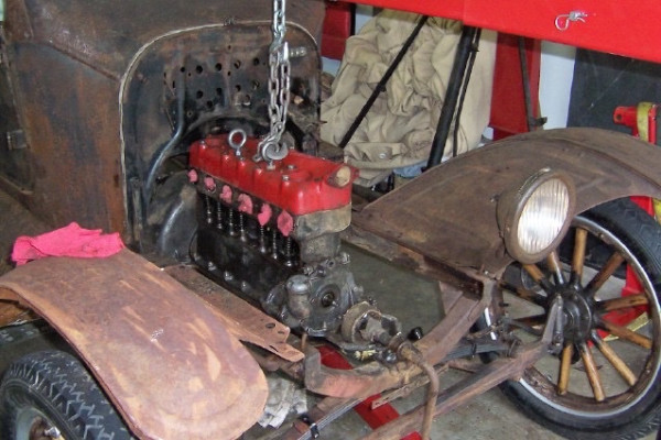

The bible (Ford Service Manual) tells you the exact sequence on removing an engine.
I have always used the one eyebolt method and so has our club.

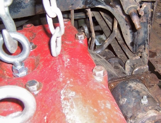

There is nothing wrong with using 2 eyebolts like they show in the above picture if
you think that is a better way to go. I do not think anyone used the ice tong method anymore.

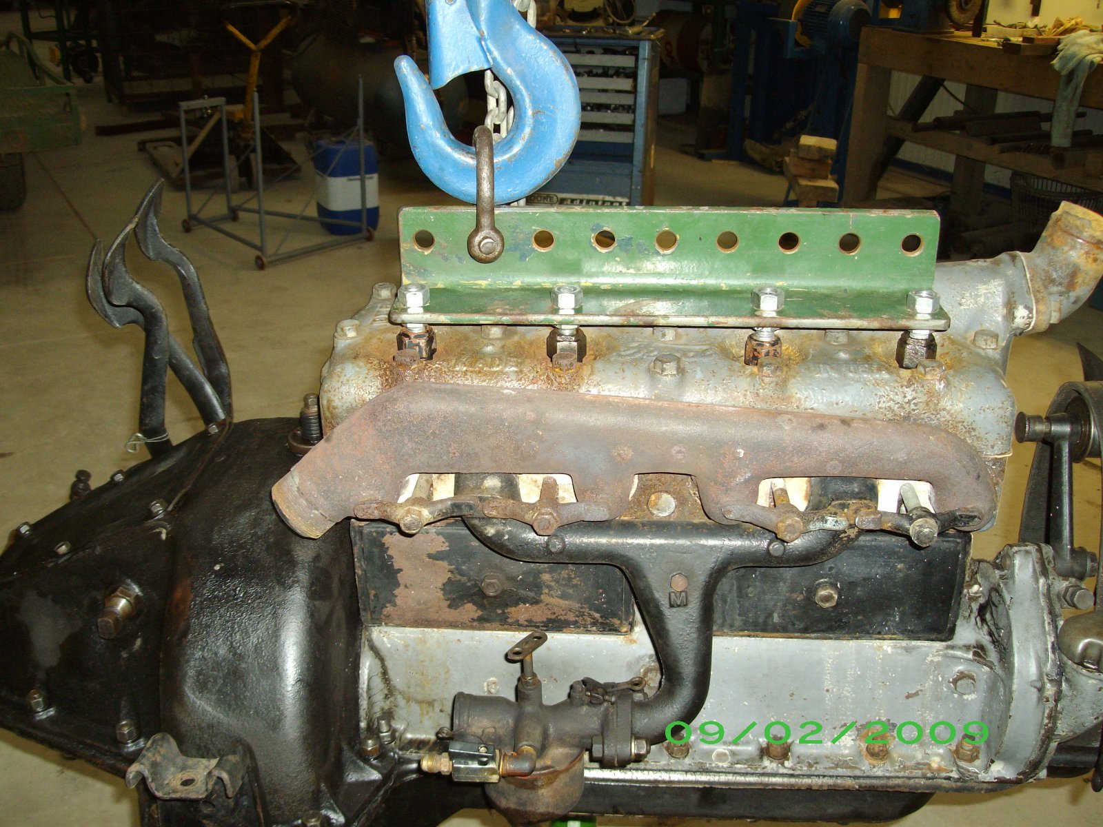

I run a chain across from a water outlet bolt to a manifold stud (or bolt) on the other side.
You have a choice of holes to get the balance you want.
And the benefit is that the bolts are stronger in shear (side force) than in stretch trying to rip 100 year old threads out.

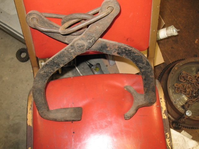

Ford used tongs to whip them into the chassis
See 5:52 of https://www.youtube.com/watch?v=Pf8d4NE8XPw

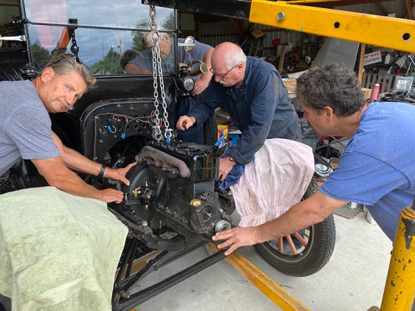

Like these?

Those era tong lifters are neat, I wish I had one. But they are fairly rare. A few people have made ones themselves. Eye hooks, and chains are preferred by many people, and a great way to go. But if you don't have those things? Good rope, properly and carefully used is the next best thing.

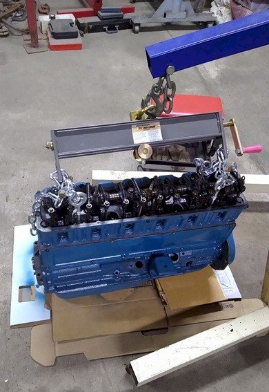

Post by RajoRacer » Wed Jan 21, 2026 10:42 pm
These work really good !

Never trusted pulling the engine with spark plug inserts. I use two eye bolts sent through the first two engine to pan bolt holes ahead of the hogshead. A picee of airplane wire through the eye bolts serves to attach to the engine hoist. Shown to me by a serious Model T engine rebuilder.

Lift Eyes are good, have used them many times. For one person lift, put one eye in 3rd plug hole , another in 2nd plug hole.
The 3rd plug hole allows engine to lift straight up off the frame rails, pull forward to clear the pan mounting ears from firewall brackets.
Then switch chain to 2nd hole to give tilt balance to angle engine under firewall and free the pedals.

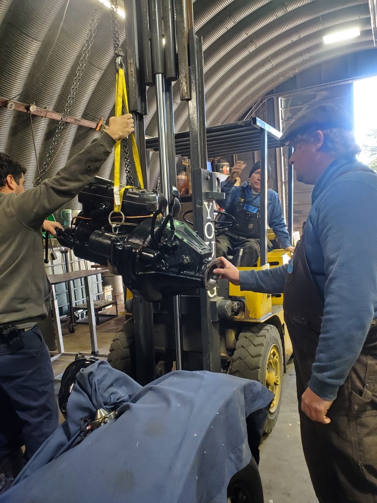

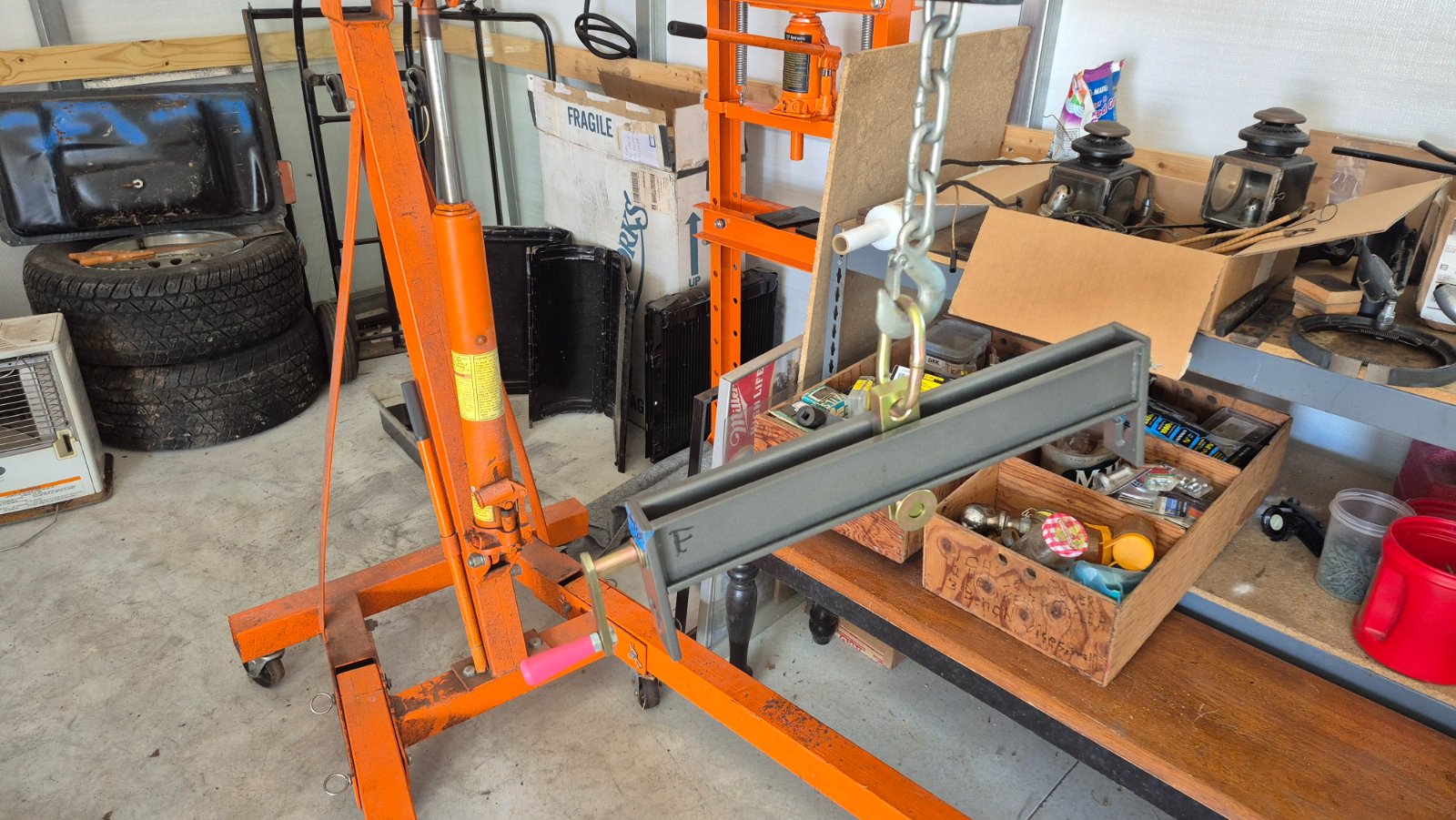

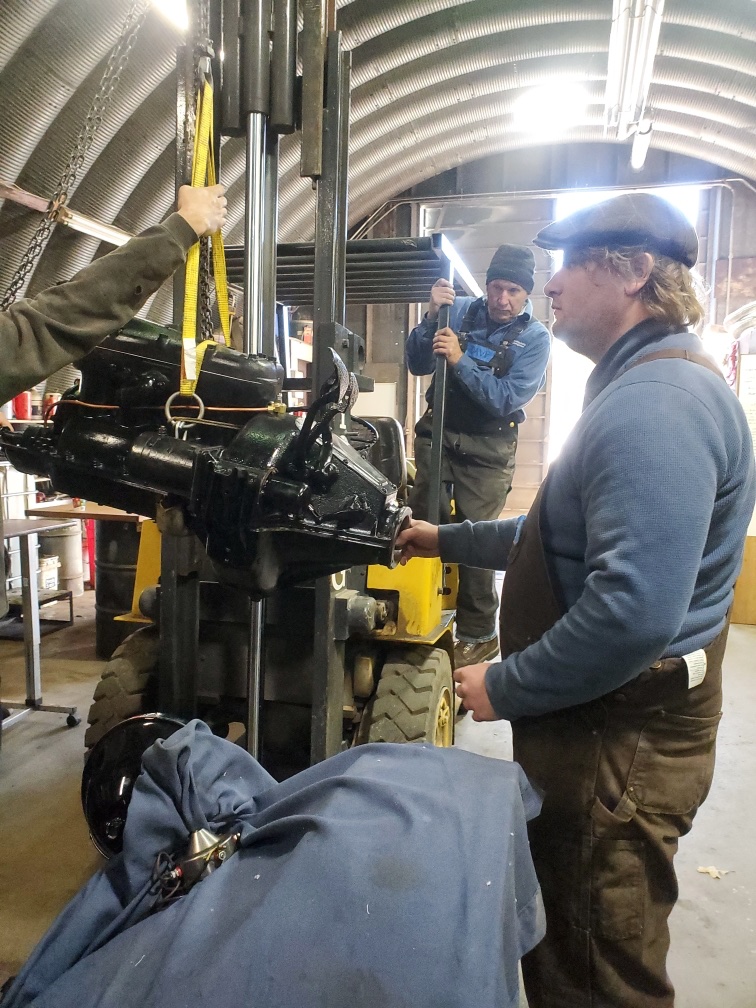

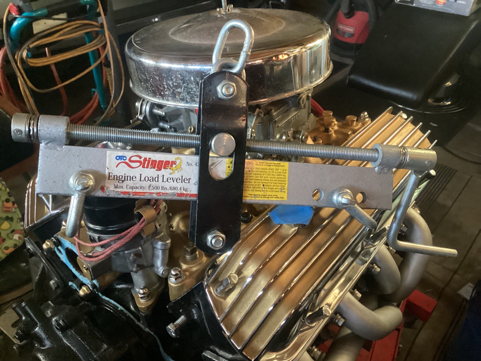

Buy, rent, steal or borrow one of these gems…
…maybe I’m spoiled since I got one, but it sure makes it safer and easier, especially pulling an engine out from the chassis or installing one that has its transmission attatched. Good luck and have fun! -Chris, in Boulder

I have a load leveler and have used it before.
If you use them on a Model T when you tip the engine to clear the pedals it jams the back into the firewall.
They work great on other cars but be careful rigging them on a Model T to stay away from the back.
Stay biased forward where it looks all wrong. The firewall can be removed but the cowl is much more difficult to remove.
Henry did not design the engine compartment to use one for some reason.
When balanced, the screw should be way towards the back end and not centered like normal.
Personally I use it on other cars but not my Model T's.
Everyone has their own personal preference, you have to figure out what works for you.
All good tools can be used badly and create problems.
Since this is your first time, take your time and be careful.
Getting help is also good since there is a lot going on when the engine starts coming out
Mike
Posts: 5608
Re: Attachment to block to pull engine?
Post by RajoRacer » Thu Jan 22, 2026 11:16 am
Like Dan's, these do work great !

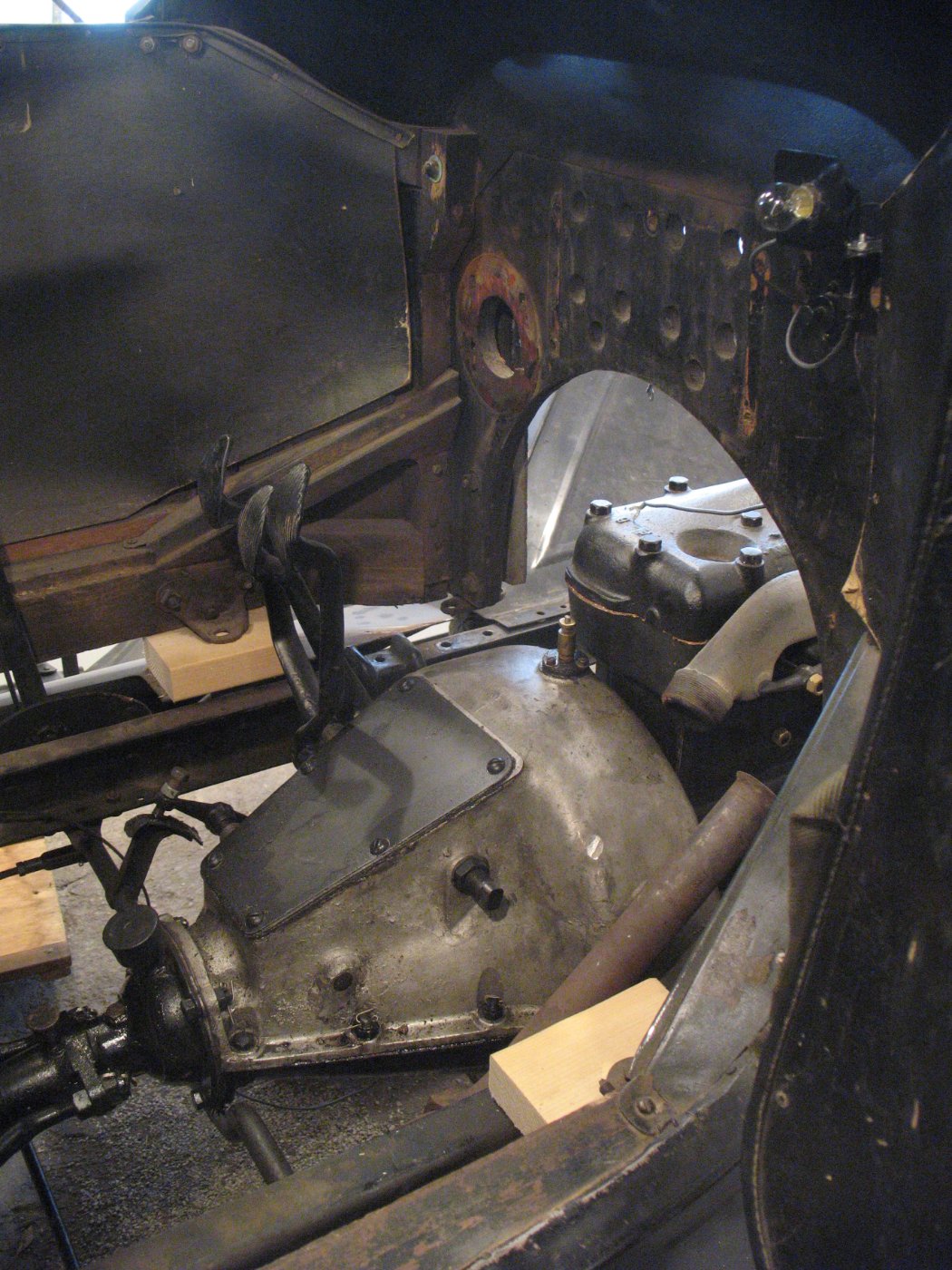

One old cheapskate's approach was to remove a couple of head bolts and bolt a short chain to those two holes.
Pulling the engine/transmission from my 1915,
I found it helpful to raise the front of the body and set it
on a pair of 2x4 blocks. No need to remove the firewall.

Post by varmint » Sat Jan 24, 2026 10:43 pm
Did this a week ago, lift, load leveler (H.F.), and 4 eyelets into the block. The eyelets came from Tractor Supply and are only rated for 300 lbs each.
