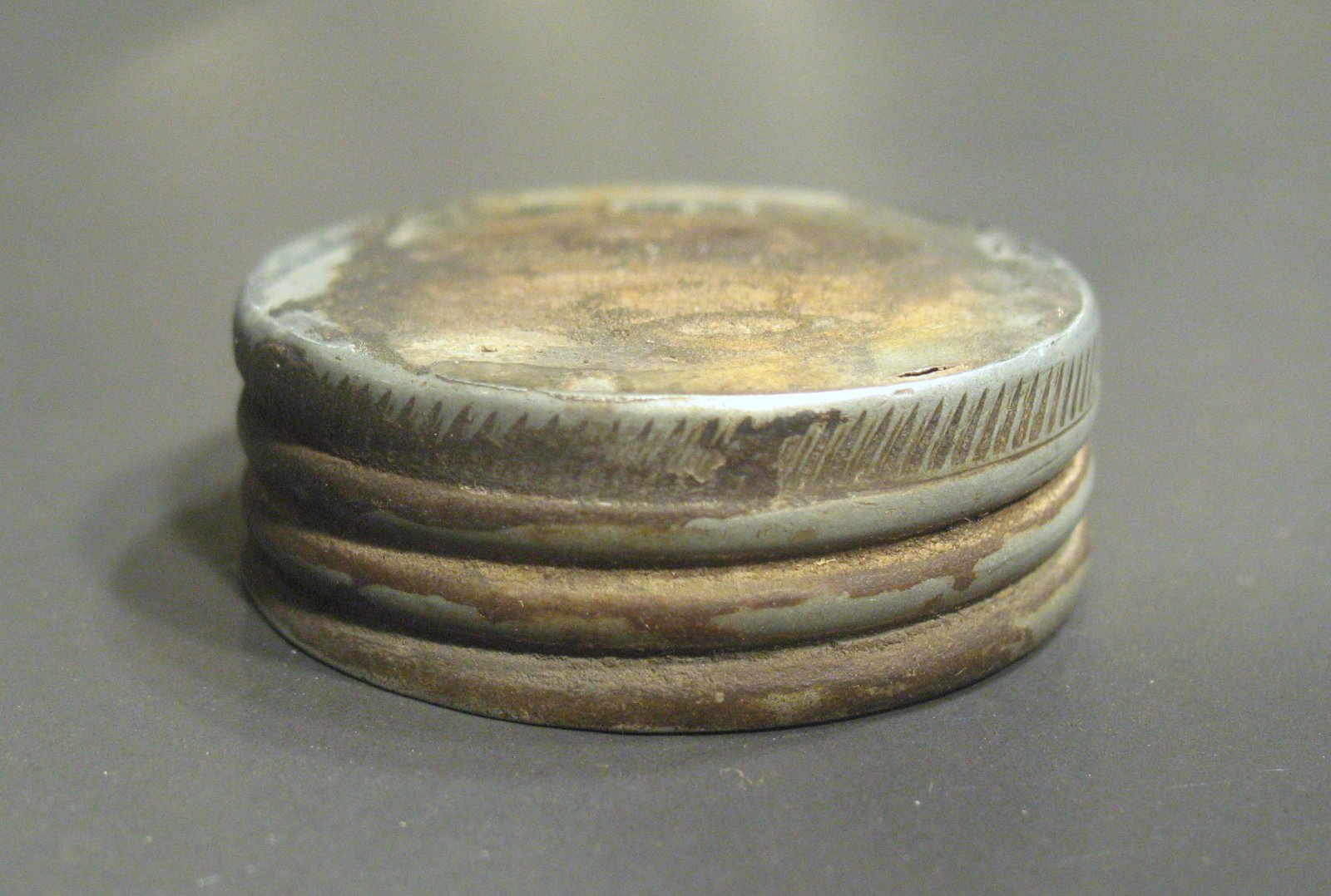

Posts: 7414
Re: Top/Lid for Boyco Running Board Cans
Post by Steve Jelf » Thu Mar 19, 2020 12:17 am
Orignal BOYCO lid. 1.5" x .5".

Old post, I know. I read this last night and it got my mind going!
It took Steve’s photo of the dimensions and I played around with the TPI and I managed to 3D print a cap that fits! It’s just a rough attempt to get an idea. The cap appears to be 5 TPI.
I understand the color and look isn’t right, it’s what I had in my printer when I got this wild hair last night.

Would be pretty simple to make a mold using your can's male threads and cast them out of brass or aluminum. Youtube has great simple videos. Don't over think it thinking you are going to find something modern that is going to fit a non standard thread, this was way before SAE standards.

If you have lathe access you can make lids from billet material.
I made a set for a different brand from brass. Knurled the outside.
You gotta make a cutter that profiles the very round thread.
