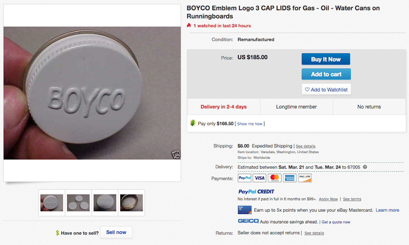

A company has tooled up and makes reproduction caps, but real pricey for a set of 3
https://www.ebay.com/itm/BOYCO-Emblem-L ... SwDN1UQuuu

And those reproduction lids look terrible compared to an original! They are a regular modern style screw cap with the logo stamped on them. Not at all what I’ve seen on originals.

I wonder where this guy is getting the lids he stamps with the Boyco name. They are obviously not a reproduction of the original Boyco lid.

What a Deal... Only 65 bucks each! They should seal leak free for that amount!

If you read the entire description on the Ebay ad that is posted, you'll see that a company is not presently making them, but the set of three is for sale by an individual who states the name of the company who did make them. Originals were straight and sharp at the bottom edge. My originals don't have a rolled edge at the bottom. BTW, I may have a extra lid or two, but they are likely bent or dented. If they had been choice grade, I wouldn't have discarded them. Also, I am 200 miles away from my parts and with this virus going on; don't email me about a dented lid unless you have plenty of months to wait for a answer.

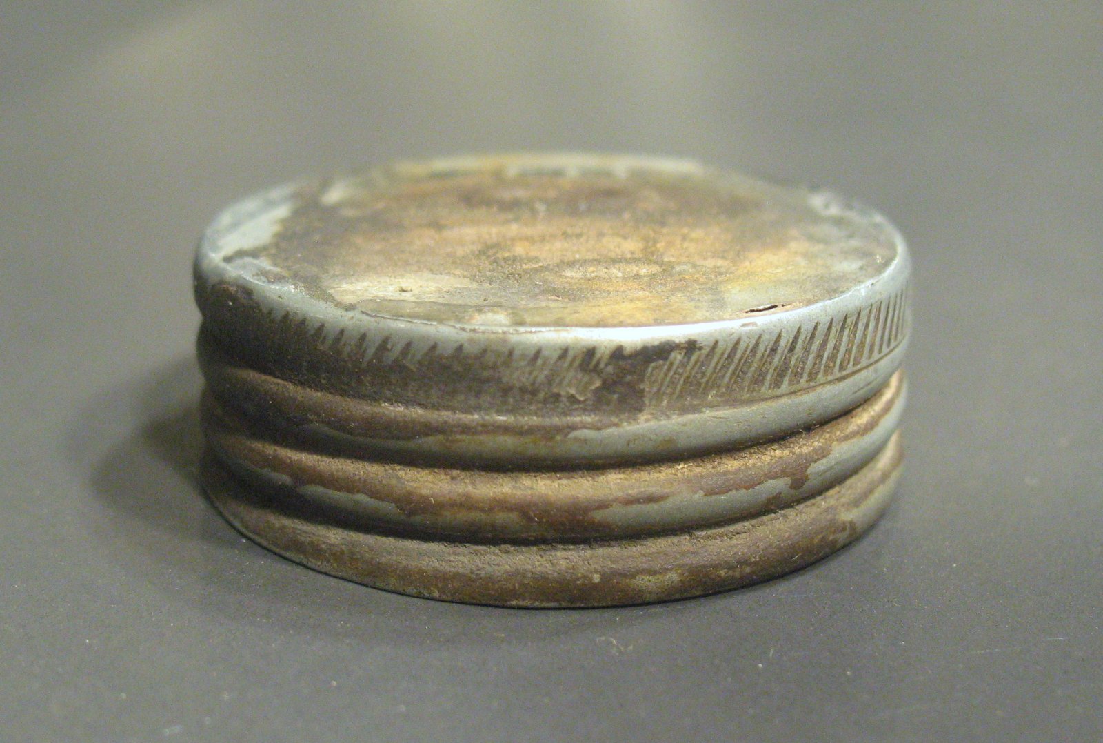

Orignal BOYCO lid. 1.5" x .5".

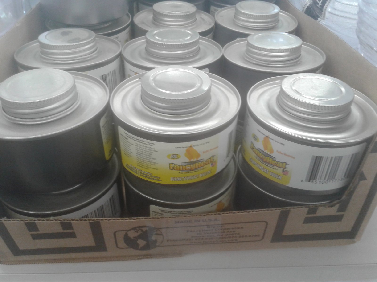

I was at a Dollar Tree store last week and they had charging dish fuel in a screw top can. No idea if it will fit, but it was a Dollar.

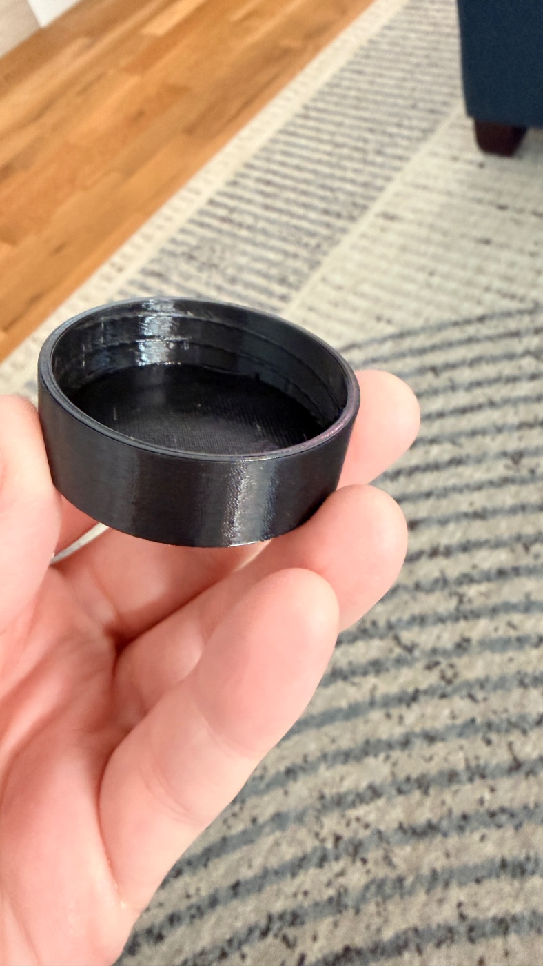

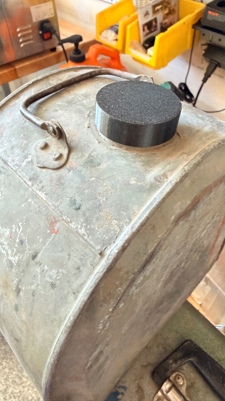

Old post, I know. I read this last night and it got my mind going!
It took Steve’s photo of the dimensions and I played around with the TPI and I managed to 3D print a cap that fits! It’s just a rough attempt to get an idea. The cap appears to be 5 TPI.
I understand the color and look isn’t right, it’s what I had in my printer when I got this wild hair last night.

the reproduction lid shown on the eBay ad is nothing more than a standard glass-jar lid with "BOYCO" stamped into it.
