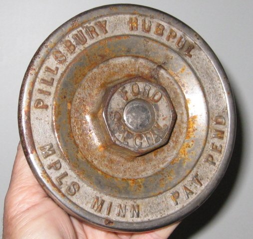

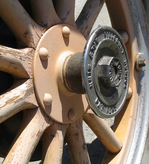

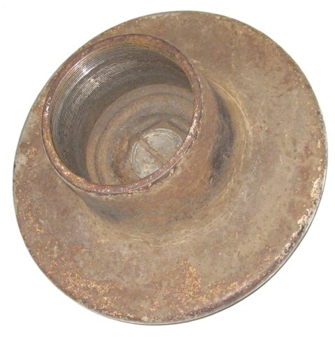

By Jay - In Northern Ca. on Wednesday, January 14, 2009 - 02:05 pm:
Here's a slick unit for guys who use thier T's off road. It also doubles as a hub puller. Most guy's carrier a hub puller on board the car, why not also have the ability to pull yourself out of a rut all vested in one tool? The unit is 5" in diameter and 2.25" deep. It is made of cast iron and is nickel plated. I think this would make a great repop,say in cast aluminium, what's your opinion??

Yes, that's the idea. Many thanks. This version s new to me. I don't know about making a reproduction. Would there be enough demand for it to pay the cost of production?

Hub winch or "Cat Head". User caution would be a must. That plus a snatch block would get you out of most any mud or snow situation without the need of a mule. Some high quality rope and a walking dog would be good to have, too.

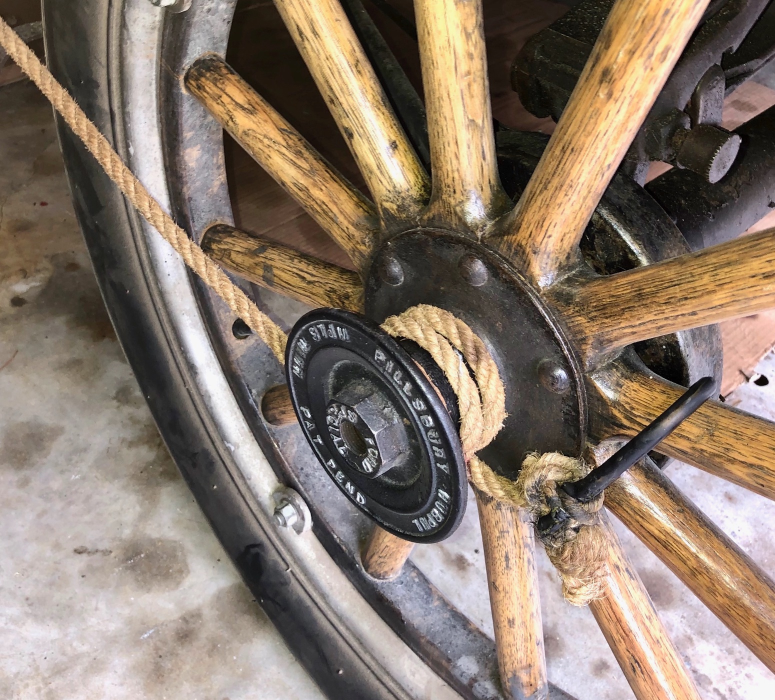

Bought one of those a few years ago, mounted on the '23 cut down. Haven't used it, but do carry a rope and hook for around a spoke, just for show and tell
Cool device as it doubles as a hub puller with the threaded hole in the cap to place a bolt to drive off the hub.

Useless idea unless the T has a diff lock or some other way of locking the other side wheel.

Unpin the brake rod on the active wheel and lock up the brake on the other

I think that it would pull if the other rear wheel had any traction at all. Since the winch drum diameter is a fraction of the other rear wheel's diameter, the torque load would be very low and the differential would allow it to turn instead of the wheel on the ground. In an extreme situation, such as glare ice, locking the opposite brake would cause the drum to turn. I'd want a lot of quality rope and a snatch block or two, and some short chains and a couple of double hooks Putting rope or tire chains on the opposite wheel would also allow the drum to pull.

As long as we’re theorizing, looks to me as if the thing could be big trouble if the line it’s pulling can’t be kept perfectly parallel with the car . . .
