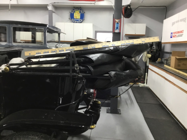

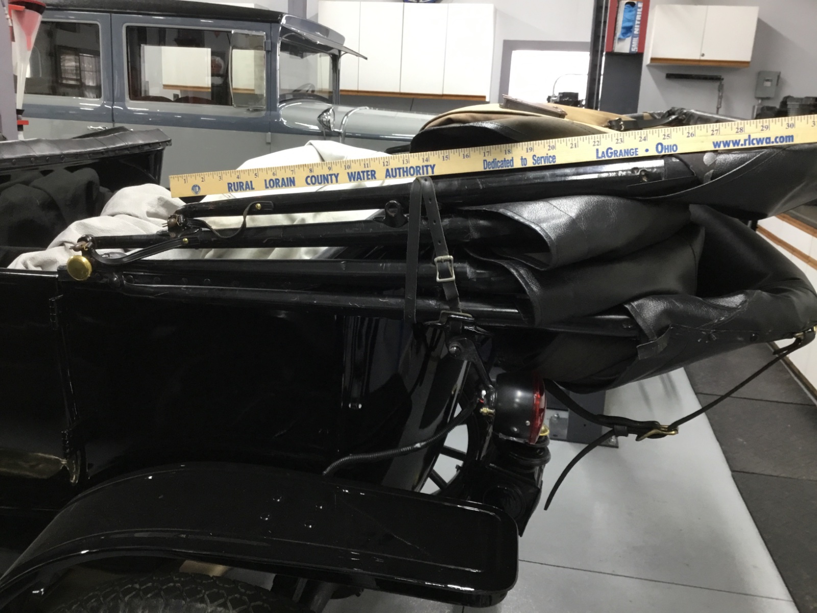

Can someone please provide the measurement of the front top bow from the locking pin at the bottom of the iron to the top of the wood bow? Thank you!

Allen, I believe this is what you requested. It’s 25” from pin to beginning of bow. Tim
