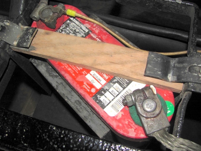

Re: Removing a battery from a 1927 roadster
I see the picture of an Optima mounted in the Runabout. I have a '23 and an Optima but have used heavy tie wraps to hold it, not the best. I see you have some sort of brace going across. What is it? Do anybody else have a cleaver hold down that can be got to from topside? The tie wraps need to be done from underneath and being old & fat, this is very unpleasant . . .
Easy to use the Ford clamps and carriage bolts that held the factory battery box lid.
Use a strip of wood as the structure for the clamps to bite on. Works well, no shifting of the Optima, esp. if you also make a pad with tall side wood pieces under the battery bracket.
Side boards on board fitted on the battery bracket for support.

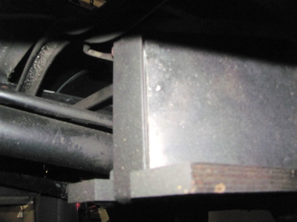

- Posts: 7330
My hold down is also wood. I started with a thicker piece, marked the under side, and cut a rebate to accommodate the battery. It hols down. as well as in place.
My Auto elec son suggests that the battery strap that hooks on the terminals is not a good idea,especially on heavy batteries. They have seen far too many batteries where the terminals have been damaged and the seal between the terminal post and the battery top has been compromised. There is a very good reason why most batteries these days have built-in carrying handles. He is the reason I use a plastic strap under the battery to lift it out.

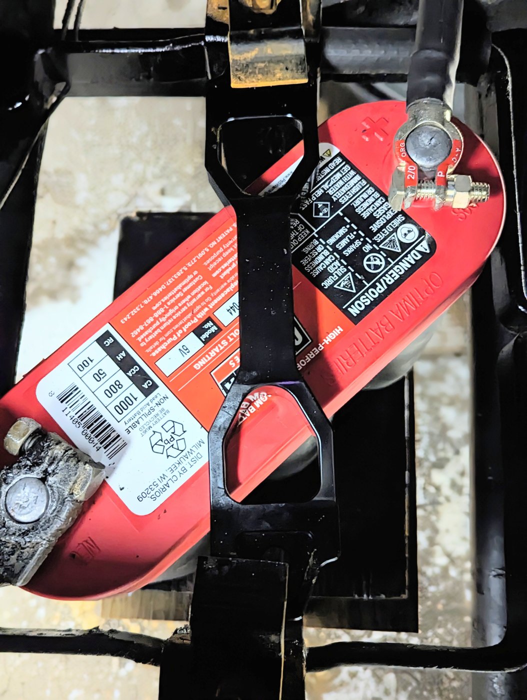

Hudson29.….. The brace that I have going across the battery is actually a modern aluminum universal battery hold down part that I used prior to a solid oak wood brace. The original style battery hold down brackets are still used to hold this piece.

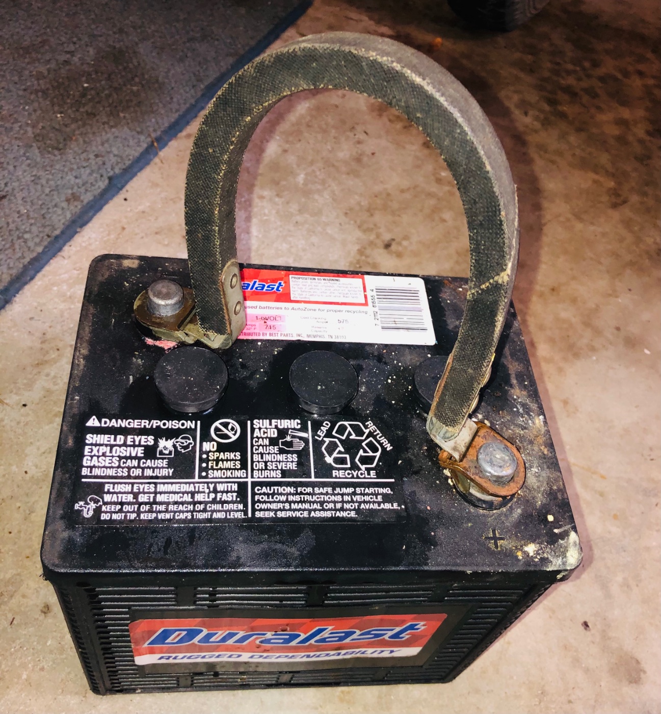

I like a battery strap too. For a battery I use a standard group 1 battery in an original Ford battery box. I had to put a piece of plywood beneath the battery, and along the sides to keep it secure in the box, and level with the top. I also use an original battery box cover and clamps. No regrets.
- Posts: 4700
Dan! I have a battery strap just like that. I’ve had it for years and always works great. It has the locking clips on it so it won’t slip out off the battery posts. In fact it’s been around here on the farm for years and as long as I can remember.

The original battery hold down method is shown in this thread
https://www.mtfca.com/discus/messages/1 ... 1311865183
The brackets do not fit properly without the box and lid so you might have to get creative like these.
https://www.mtfca.com/discus/messages/2 ... 59557.html
I don't like the stock ones, it does not hold them securely enough for me.
So I build my own brackets that are more of like a Model A style or like this with as much clearance as possible
If you use one exactly like the picture you will likely short the battery out, that is why I make them custom.
I don't have a picture of one of mine handy.
Mike

For the sake of completeness, clearness and clarity here is what I build to hold my batteries in.
I skidded on the frozen snow to walk out there and get a picture.
It is not authentic or original but it is secure.
While I prefer original and authentic, safety and reliability can take over the decision.
And frankly when I made my first one I had forgotten to order some repros and needed something that night.
What I whipped up from junk worked so well I custom make them for everything now.
The band around the outside is below the lip so any sharp edges are away from the cables and terminals.
The block underneath brings it up enough high enough it is above the carrier bars for no binding.
It looks like come spring service it could use some cleanup.
Even not on a roadster changing the battery can be a bit of a challenge since there is not much room to get under it.
I can't wait till spring when I can drive it again.
Mike
Mike

I like it, Mike.
If you spread a little Valvoline on top of the terminal clamps they will not corrode & will be maintenance free.
