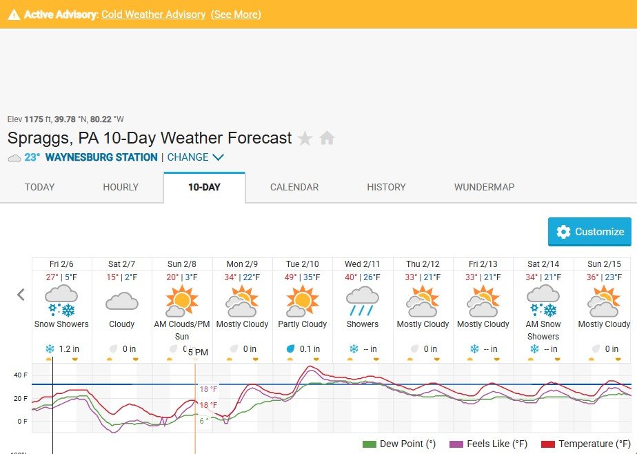

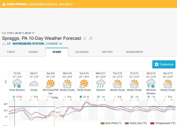

Allan,
Given his location listed I sure hope he uses something of antifreeze or protects the car.
You can use a water / AntiRust and keep it in a heated garage or drain it, I have in the past.
But then I started parking them in different places. Some temperature protected and some not so I swapped them all to antifreeze.
