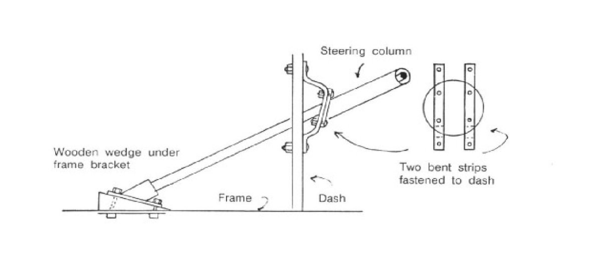

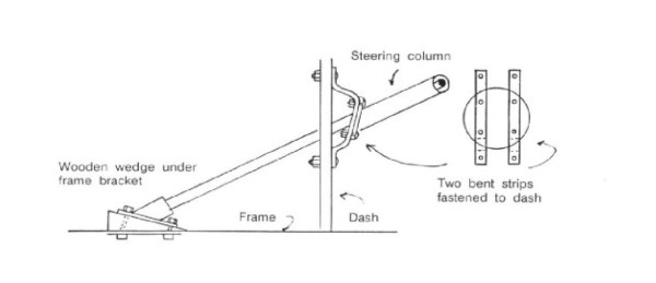

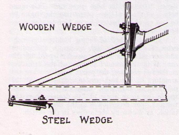

- Posts: 6611
Re: Need to lower steering unit 1913 speedster.
Here are some methods
