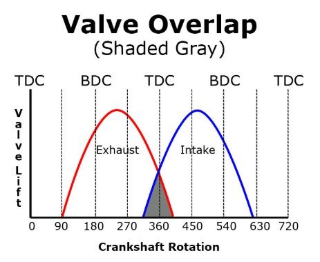

While BDC is much easier to prevent the engine from moving it has several flaws in the process.
1) The wear is minimal at the bottom and it is not the most important part of the cycle.
2) At least one valve is open at BDC making testing the valve seal quite hard.
Mike
