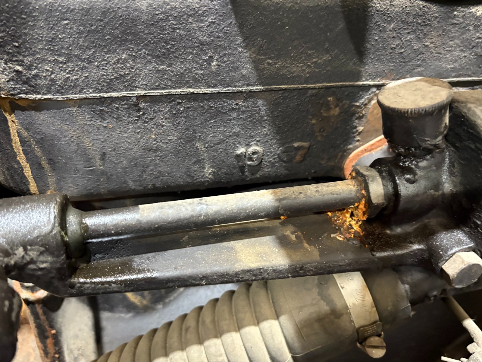

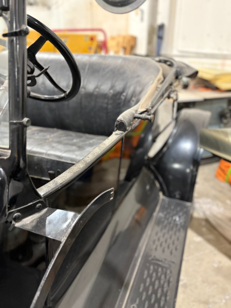

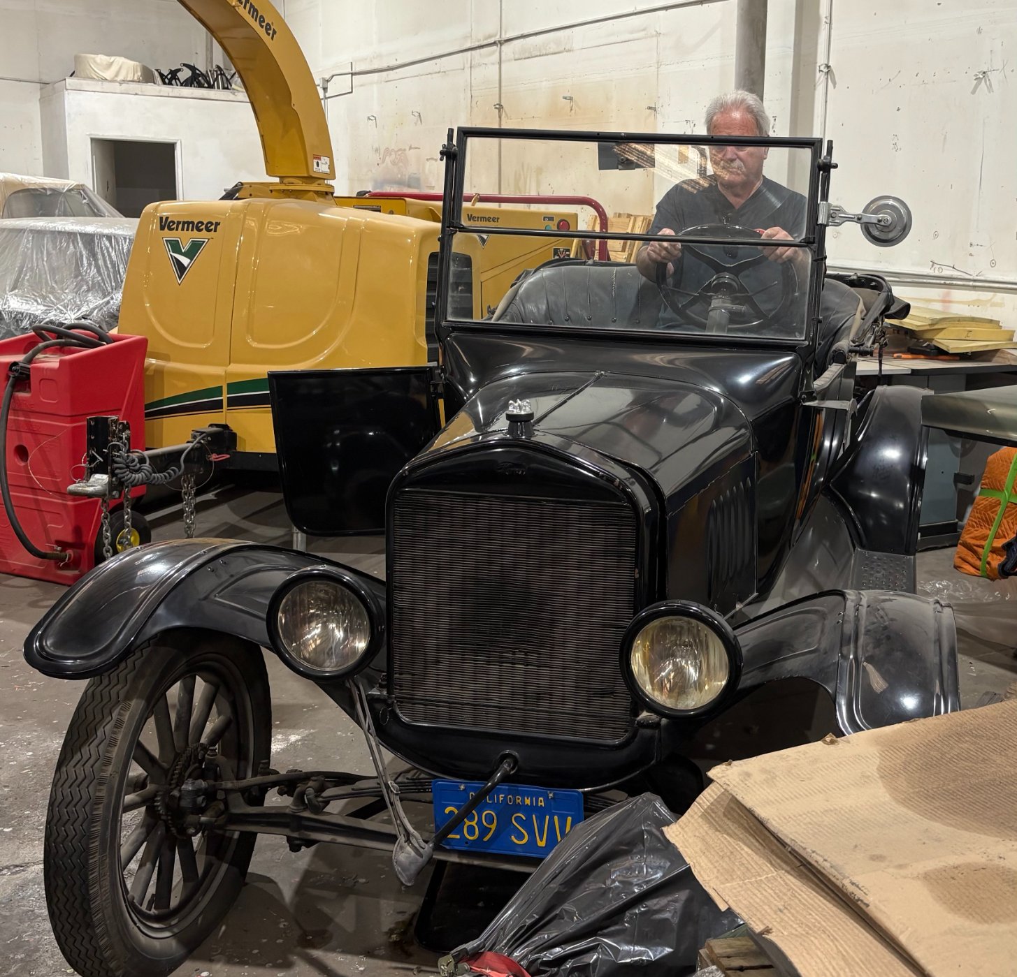

I am attaching pictures to help identify the year of the Model T. Also assuming it runs and drives OK, the seller is asking $7,500. Does this seem reasonable?

Depends on motor condition.

From your pictures it could be 23-25. No door hinge shown.

Likely a ‘24 or a ‘25 as upper windshield frame has holes for mirror and wiper. High radiator, can see an accessory speedometer drive too. 21” split rims optional on ‘25, which this T has. Interesting bracket on driver side for a rim, but there should be a rear carrier. Value depends on running condition, radiator, tires, upholstery and top cover as replacement of those add up to more cost.

1924 or 1925 model. Could have been built in late 1923 after the model year ended for 1923. Looks like a nice car but make sure the seller has paperwork in their name before buying. To drive on the road they still need to be registered, license and insured.

Yeah, it’s a ‘24-‘25 body style. Wide cowl and apron covering lower radiator tank is a giveaway. $7500 is a decent price..

A 1923 would have a low radiator.

The front fenders have the apron under the headlights. The radiator has the lower apron. Those two things say it’s a 24 or 25. The straight door hinge is usually a 25.
The body seems pretty straight. If it runs good that’s a good thing.
Adding the water pump in the past says something. Why was it needed? I can’t tell if the radiator is a recore or original. If it’s an original round tube that’s a big factor along with the supposed need of a water pump.
