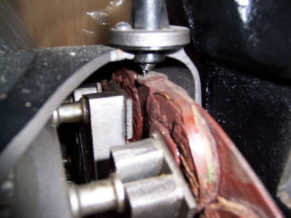

Has the magneto ever worked in this car?
I would test the magneto before going too far.
https://www.mtfca.com/discus/messages/5 ... 1470945248
It is possible to have a shorted magneto post so that is a quick test.
The last one I found was a tiny bit of wire caught in the spring, never found out where it came from.
I have seen several mag posts that do not connect well in certain spring positions so check that while you are at it.
There are lots of wiring connections inside the ring coil that can fail.

This following discussion shows a lot of pictures of what the magneto looks like inside
https://www.mtfca.com/discus/messages/1 ... 1264263362
Here is a Borrowed picture from the post above

When you remove the mag post, you would see a lead button that the post spike contacts. It's centered in the hole & not very deep.
When you put the mag post back you will have to push it down on the lead button, compressing the spring.
Its obvious if there is a field coil or not. If you can push your scope down thru the mag post hole, there is no field coil.
I definitely saw that button. I couldn’t get much farther with the scope. So, I at least have a Mag….of sorts.

You can see it better with the top cover - the one above the bands - removed.
That's also the place to look to align the magnets for re-magnetising.

Ford stated that the magneto air gap should be between .025 and .040. Crankshaft end play should be .002 to .004.
My end play looks to be more like .010, using the eyeball gauge, so the magneto air gap may be in the borderline range. Since I have an aluminum crankshaft pulley, I don't think I can use the shade tree shim. The engine crank-starts easily on magneto when warm, but not so easily when it's been sitting/////
I tried measuring the crankshaft end play with an outside caliper and a micrometer. Best I could tell, the end play is around .008. It may well be less with the engine warmed up.
