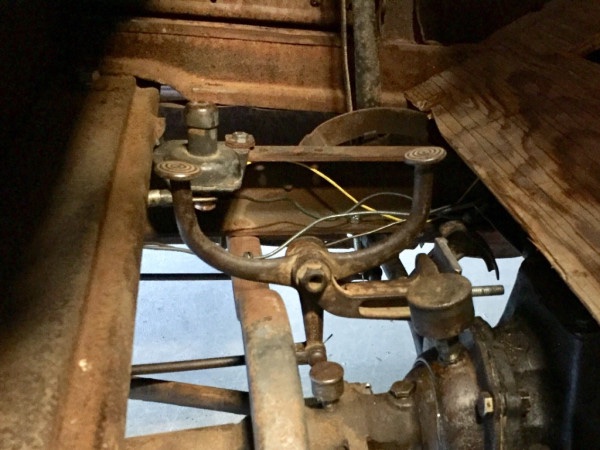

Take a spare parking brake unit. Mount the pillow blocks right behind, in line with the car's parking brake.
Remove the clutch cam. Remove the brake ratchet disconnect lever, pawl & rod. Weld up the holes.
Get fancy & do some shaping to the handle base until it looks like the second lever off an early 09.
Bend outward to clear the parking brake lever.(optional)
On the cross shaft, you will need to add a length of 1/4 x 3/4 iron stock to connect to the Rux shifter rod.
Direct will be back on the lever toward the seat.
Makes for a cleaner looking set up than the available kits. Rux shifter.jpeg[/attachment]
Note the shifter rod has an adjustable clevis to fine tune the lever's location. The bar it attaches to has multiple holes to set/change the lever's throw.
The rod has a fixed clevis in the Rux end & is made from 1/2" thin wall conduit.

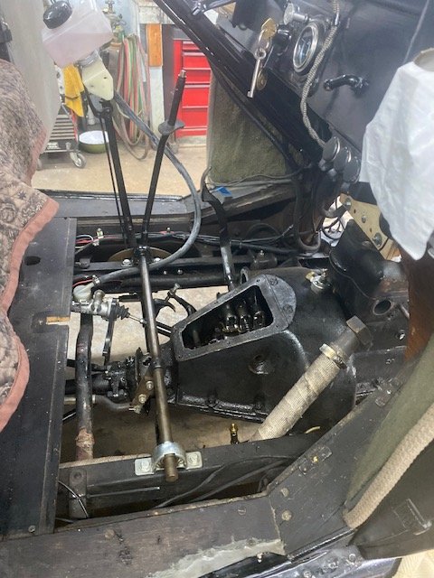

I just finished building a Ruckstell to replace the stock rearend. I do not have a shifter yet, so I am open to options. I want to decide which way to go before I install the axle into the car. I kind of like the idea of shifting with the lefthand, plus not having a shifter in the middle of the floor.

I like the conversion that John Karvaly suggests except that it looks like low and high are reversed from the original shift pattern. I think that I want high to be in the forward position to allow clearance through the doorway.
I acquired a spare hand brake and started looking into what all needs done to be modified and to install it. There is definitely not enough room between the floorboards and the frame on the 26-27 to mount it on the top of the frame. Does anyone have any better pictures of Tom Carnegie's under the frame method?

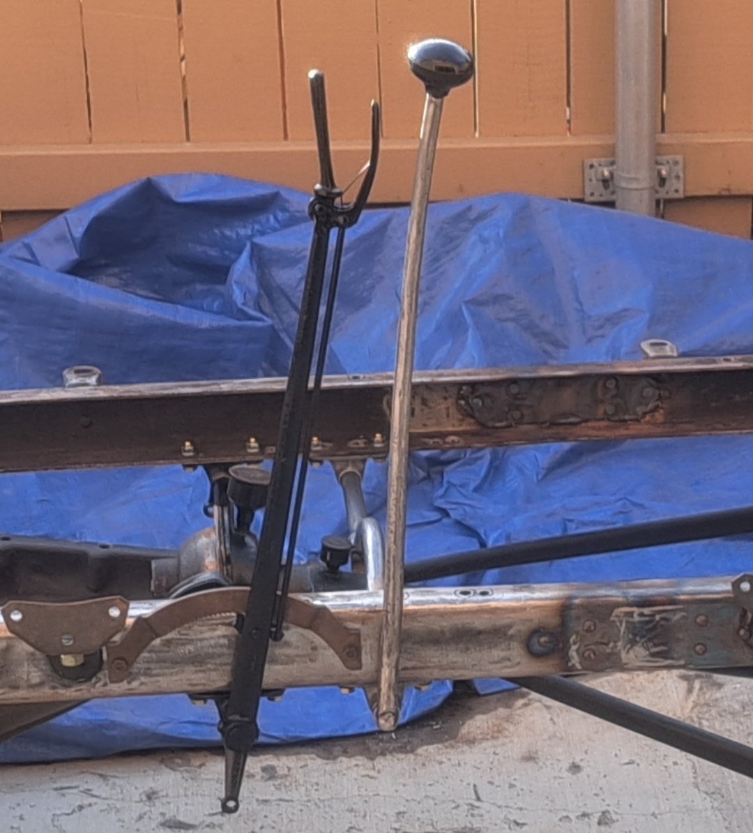

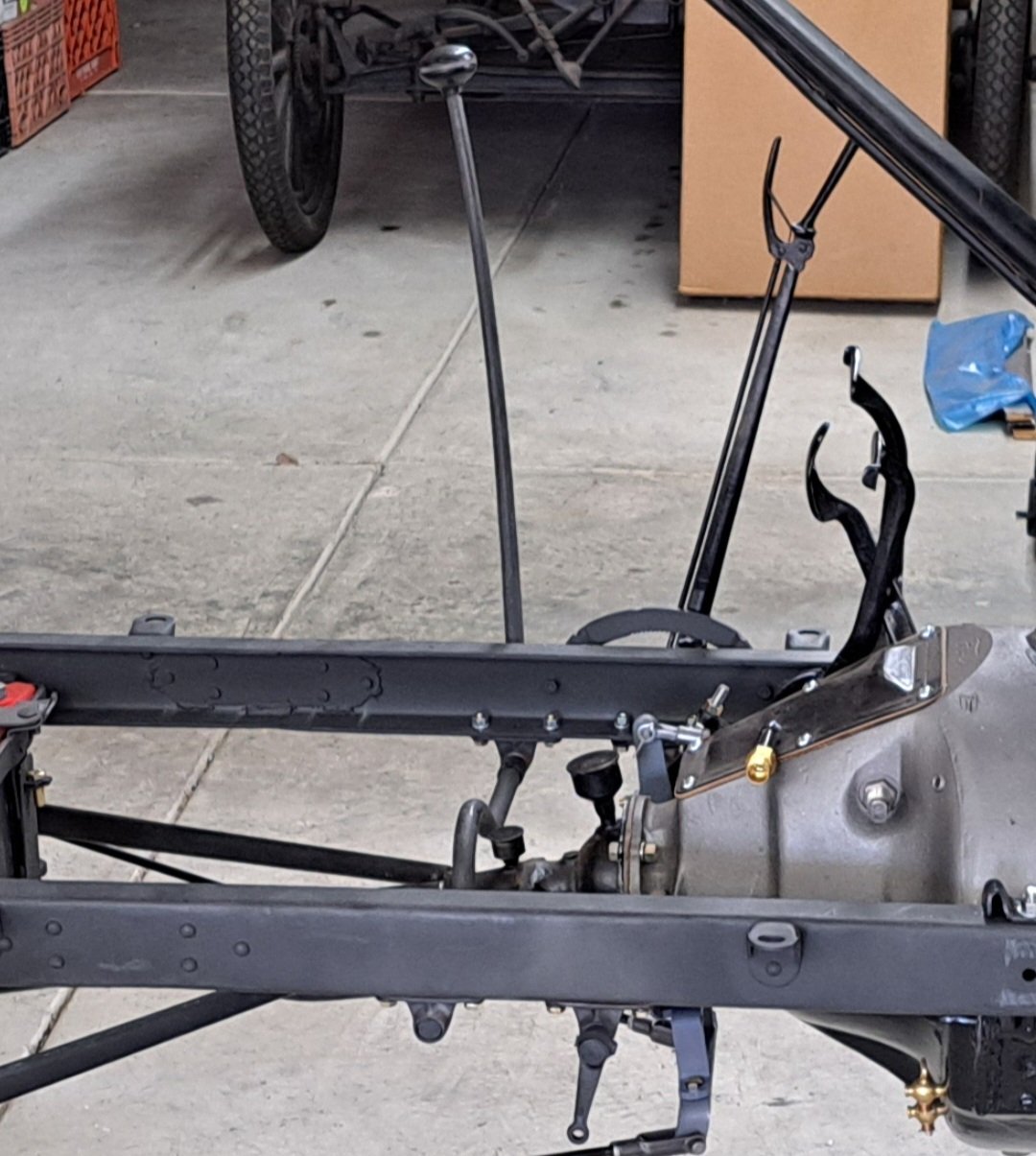

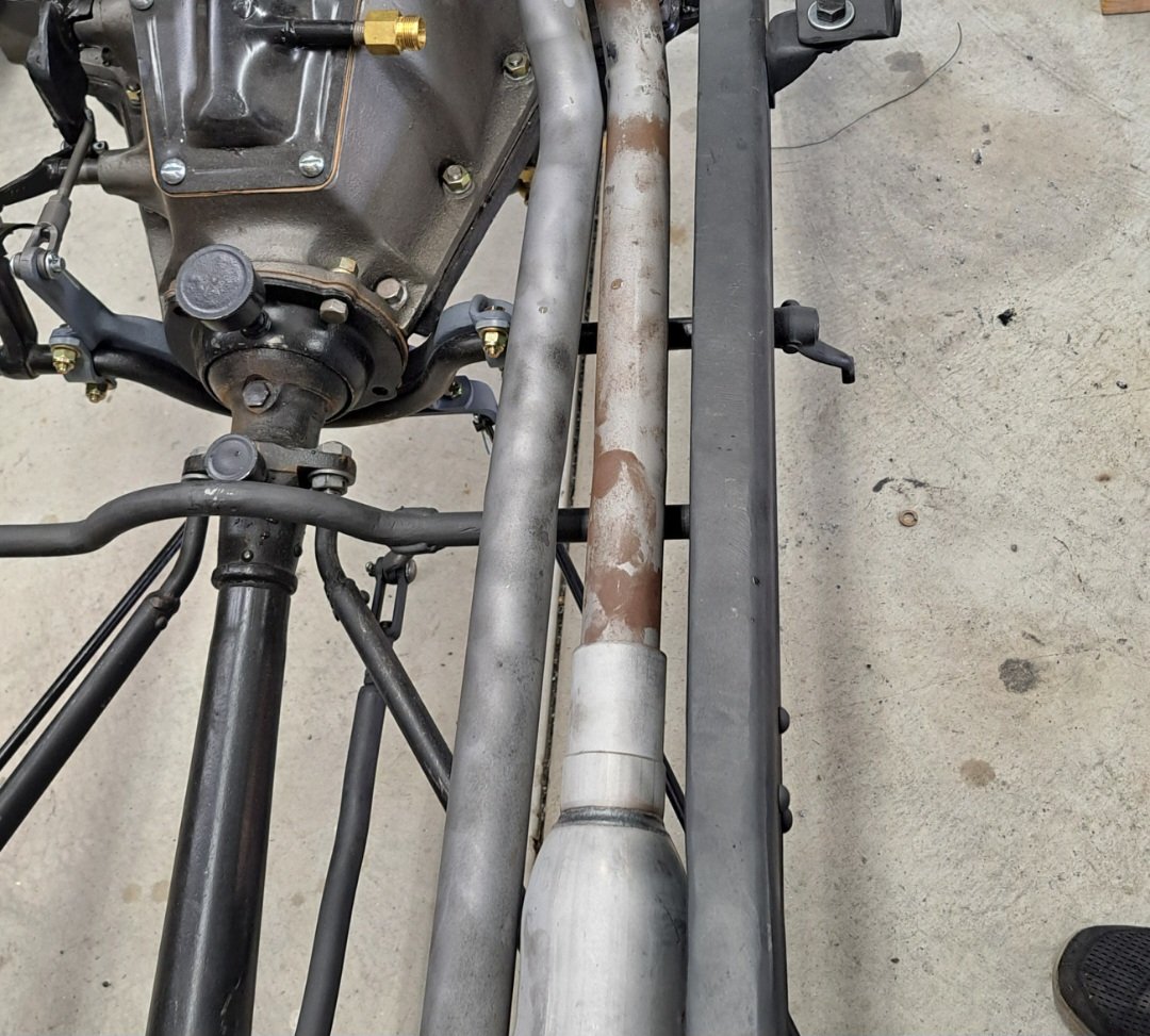

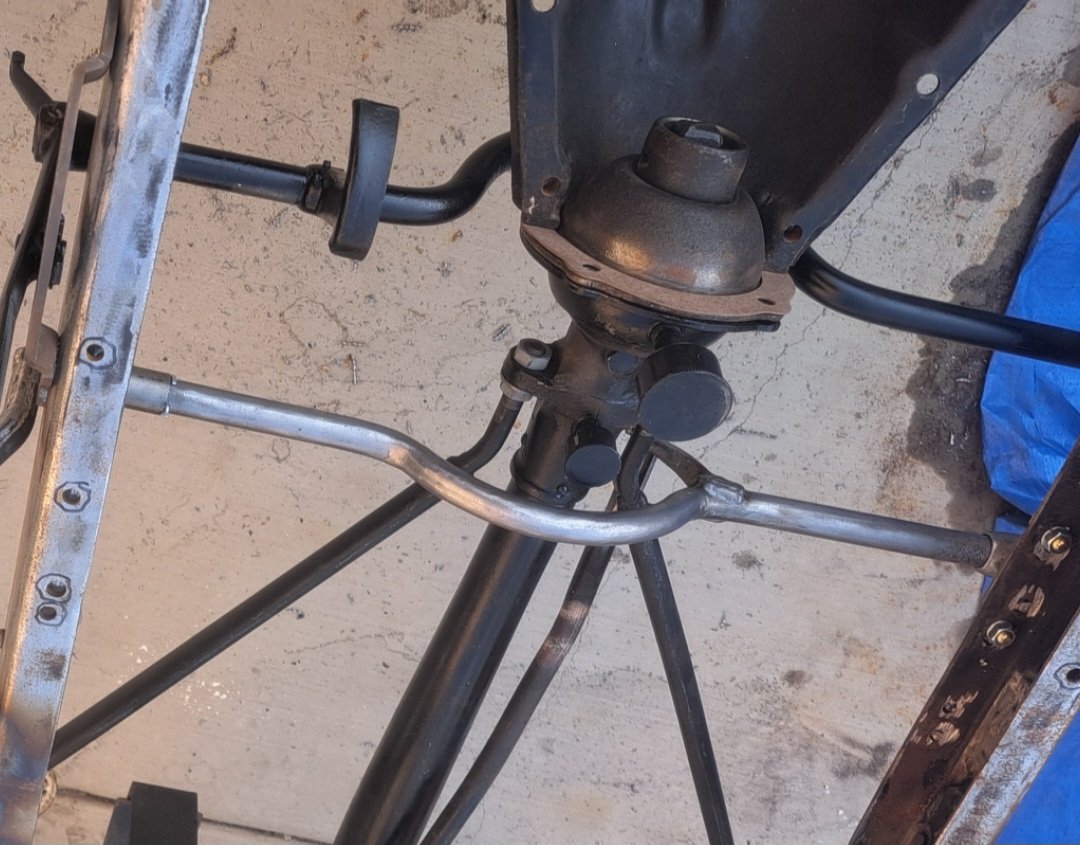

I saw a foot shifter on Don Asevedo’s 1914 T. I knew I wanted to make it so I asked him for details. His Dad had installed it 100% custom.
I knew I wanted to make one so he gave me the idea of using a Model AA foot shifter, possibly where his dad got the idea.
Here is what it looks like: This is no secret, I posted it in the past:
viewtopic.php?f=2&t=29499&p=228184#p228184
I honestly don’t know why more people don’t do this. The advantage are clear, when I am not using it I don’t know it is there and when I need it my right leg is free. My hand is free to manage the throttle.
The only update from my earlier posts is that I ended up welding the adjustment. The pipe fitting I was using stripped out. After that this worked even better. I feel this design works great. The biggest challenge was making the mounting bracket so I cleared everything.
Matt
Matt
- Posts: 5288
Re: 26-27 LEFTHAND RUCKSTELL SHIFTER
Like it a lot.
Great option for a 26-7 for door access.
