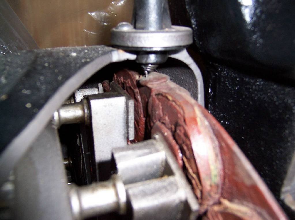

Would it be possible for you to post a picture of it installed?Russ T Fender wrote: ↑Thu Feb 12, 2026 6:42 pmI have used the pulley shim on one of my cars for years with great success. It was a good temporary fix that kept the magneto functioning until the engine finally got to the point where I pulled it for a total rebuild.

How was the 1/8" end play measured? If it was done by levering on the fan pulley and engine block, some of it could be due to a loose fan pulley. Whatever, 1/8" is excessive. If it is due to wear on the thrust face on the third main, I would suspect that the crankshaft flange is also worn. That rules out re-working just the bearing thrust face. The crankshaft flange would need to be ground and trued for a new third main cap to be made to suit.

Good point. I hadn’t thought of that.Rich P. Bingham wrote: ↑Thu Feb 12, 2026 7:52 pmHave you verified that there actually are magnets on your flywheel ? The past 40 years or so, it’s been popular to think a Model T can run 70 mph with modern traffic if only all that unnecessary revolving weight (flywheel magnets, cast iron pistons, etc.) can be eliminated.![]()

I may have to check again. I had the pry bar between the engine and lower pulley.Allan wrote: ↑Thu Feb 12, 2026 8:42 pmHow was the 1/8" end play measured? If it was done by levering on the fan pulley and engine block, some of it could be due to a loose fan pulley. Whatever, 1/8" is excessive. If it is due to wear on the thrust face on the third main, I would suspect that the crankshaft flange is also worn. That rules out re-working just the bearing thrust face. The crankshaft flange would need to be ground and trued for a new third main cap to be made to suit.

I pulled the magneto post yesterday. I’ve had it off before. It was clean and had continuity. I tried putting a scope in the top of the transmission to see if the magneto is actually there, but it was inconclusive. It’s really not visible unless you take the hogshead off, I assume?

When you remove the mag post, you would see a lead button that the post spike contacts. It's centered in the hole & not very deep.CatGuy wrote: ↑Thu Feb 19, 2026 2:54 pmI pulled the magneto post yesterday. I’ve had it off before. It was clean and had continuity. I tried putting a scope in the top of the transmission to see if the magneto is actually there, but it was inconclusive. It’s really not visible unless you take the hogshead off, I assume?
When you put the mag post back you will have to push it down on the lead button, compressing the spring.
Its obvious if there is a field coil or not. If you can push your scope down thru the mag post hole, there is no field coil.

This following discussion shows a lot of pictures of what the magneto looks like inside
https://www.mtfca.com/discus/messages/1 ... 1264263362
Here is a Borrowed picture from the post above

I definitely saw that button. I couldn’t get much farther with the scope. So, I at least have a Mag….of sorts.speedytinc wrote: ↑Thu Feb 19, 2026 3:39 pmWhen you remove the mag post, you would see a lead button that the post spike contacts. It's centered in the hole & not very deep.CatGuy wrote: ↑Thu Feb 19, 2026 2:54 pmI pulled the magneto post yesterday. I’ve had it off before. It was clean and had continuity. I tried putting a scope in the top of the transmission to see if the magneto is actually there, but it was inconclusive. It’s really not visible unless you take the hogshead off, I assume?

You can see it better with the top cover - the one above the bands - removed.
That's also the place to look to align the magnets for re-magnetising.
