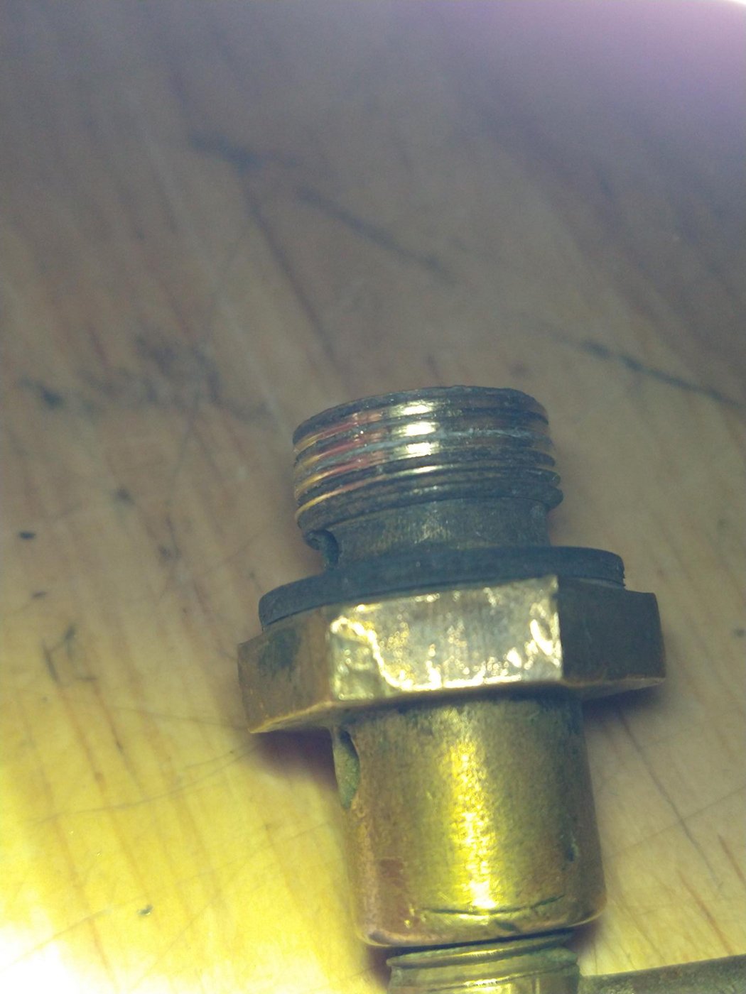

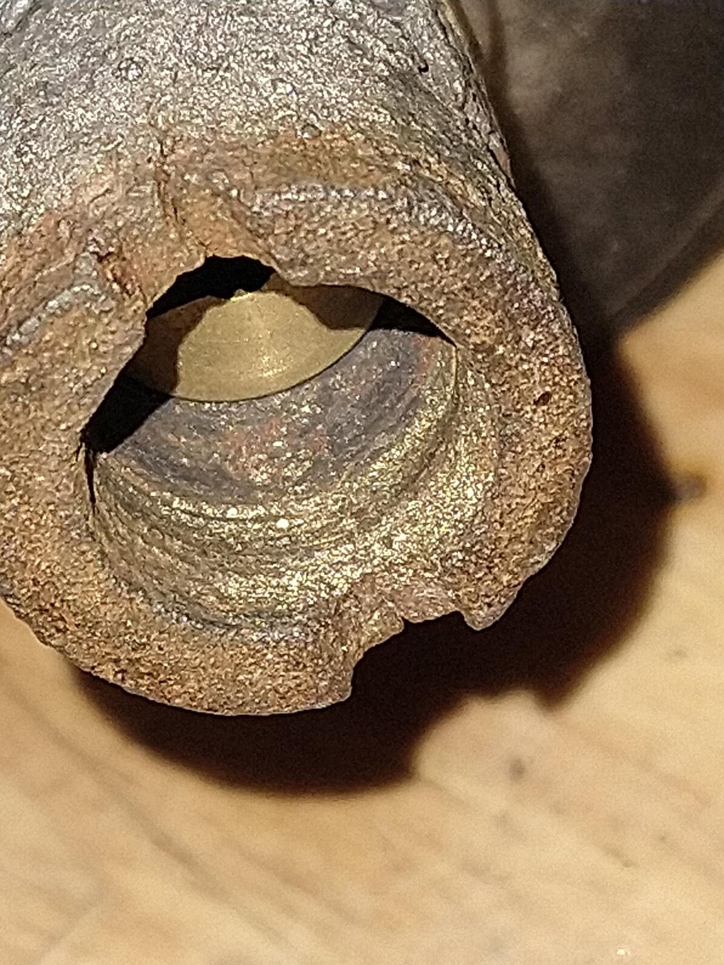

Holley NH Threads on bottom plug and bottom of carb where plug goes in no good....

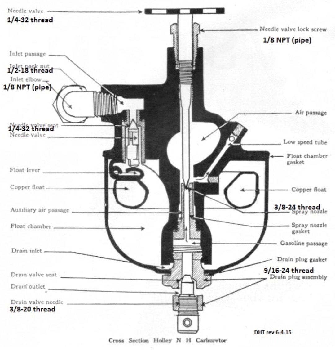

Thread sizes on the NH carb. Drain assembly into the carb housing is 9/16” - 24 thread.
Your carb body seems rather rusted, best fix is a better unit to rebuild. A good one looks like this:

A helicoil kit for that size thread and a replacement carb body are about the same price. Buy the kit and you'll never use it again and your carb will still be a rusted core no matter how well it's cleaned. Buy a good pristine core and never question yourself.
I know what I'd do.
You have a new engine that is relying on a good carburetor...what will YOU do?

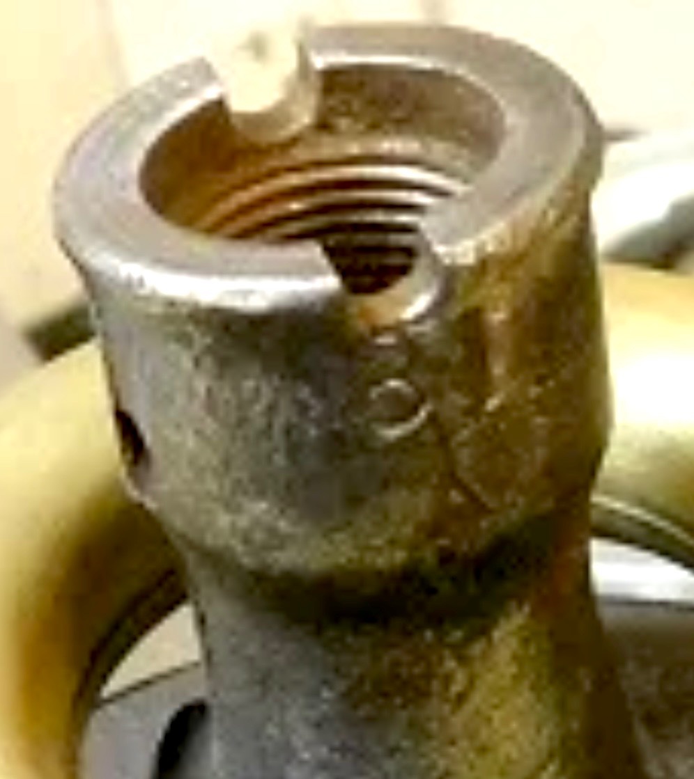

Thanks for the input. Yep - Working on another carb I found in the pile, although not that much better, it has decent threads. I'll give it a go if I can just get the darned float seat out...

Is the advice for this to heat the body to red, then allow to cool before trying to extract the seat?Wobbly Dave wrote: ↑Sat Feb 21, 2026 8:54 pmThanks for the input. Yep - Working on another carb I found in the pile, although not that much better, it has decent threads. I'll give it a go if I can just get the darned float seat out...

I have not done a lot of carburetors, but I've done a few and I've never had to do that, and I never would. Assuming that nobody has already destroyed the slot, it's not that hard to get the seat out with a tool properly sized to fit the slot, and some penetrating oil. I believe Scott Conger makes a proper tool for this.PorkChops wrote: ↑Sun Feb 22, 2026 6:20 amIs the advice for this to heat the body to red, then allow to cool before trying to extract the seat?Wobbly Dave wrote: ↑Sat Feb 21, 2026 8:54 pmThanks for the input. Yep - Working on another carb I found in the pile, although not that much better, it has decent threads. I'll give it a go if I can just get the darned float seat out...

I am sure to get criticism for this, but typically I work on bottom of the barrel parts and living in the rust belt with a non existent budget means the parts I work on are usually fairly bad. If I get a nice clean part it feels like cheating but I take it when I can.
I also often get handed part that others have already failed on.
I modified a screwdriver many years ago to fit the stock seat perfectly and it works great on the ones that are not pre-mutilated.

Thanks all for your input. Tried making a tool from a screwdriver this morning after several heating/penetrating oil sequences. Still no luck. So rather than totally destroy the seat insert, I may hand it off to someone who has more experience with these and use it as a good core - the only good one I have!
