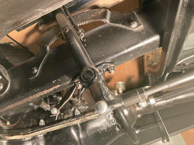

Yes, some time in 1925 model year the quadrant had only 2 holes, but the frames continued for a time with the std. 4 holes till perhaps the Improved Car frame in Aug 1925.
Note the 4 holes (one is filled with a bolt), but from the factory the quadrants were riveted in place, Ford didn't use bolts for the quadrant.
1925 frame pictured, factory rivets on the new 2-hole quadrant.

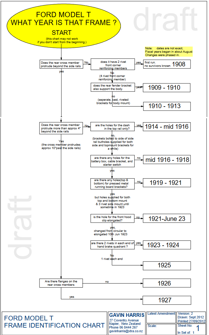

One more check for frame holes just before the quadrant check

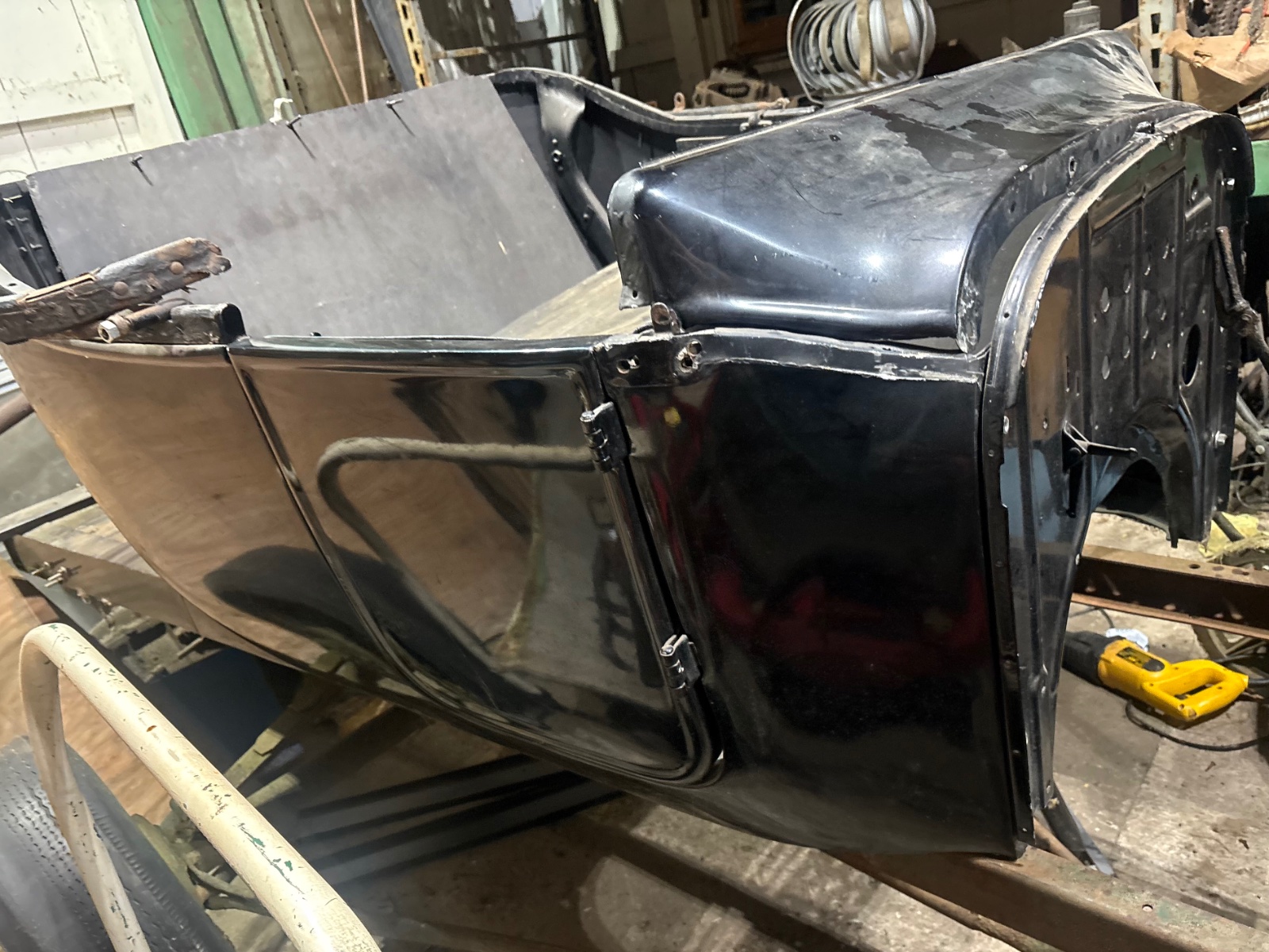

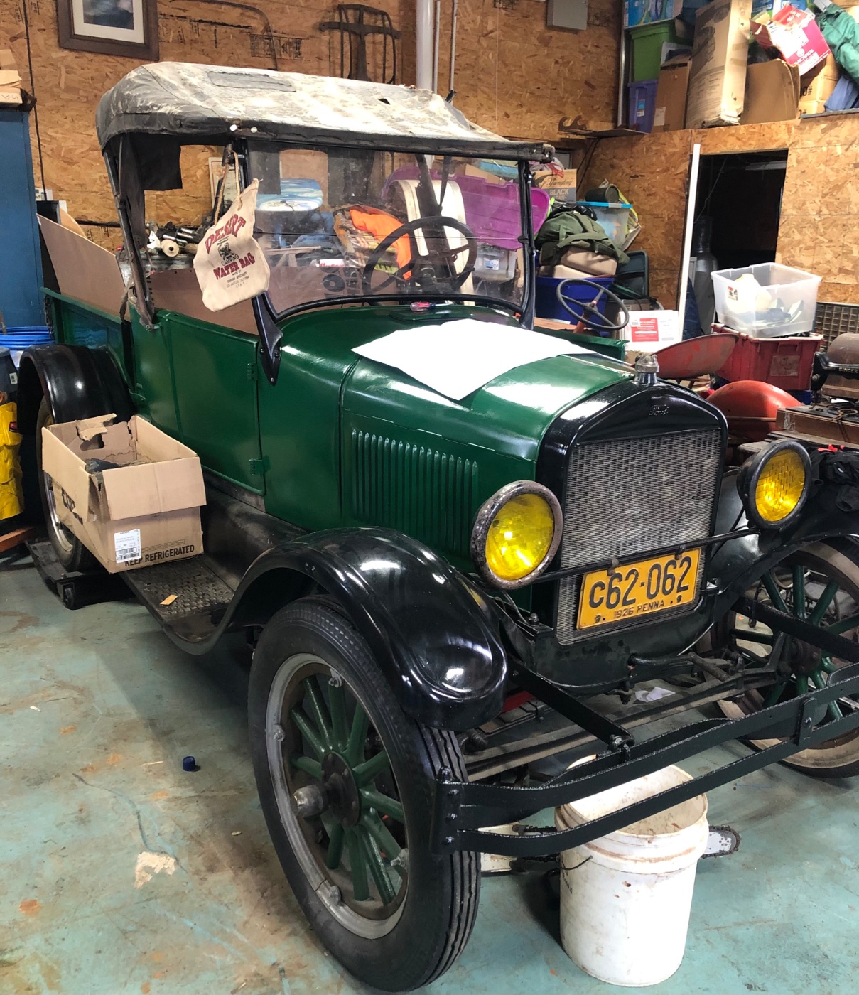

Post by Oldrusty26 » Mon Feb 23, 2026 3:05 pm
[image][/image]Yes , I’m working on a 25 roadster , the TT was for my father , he passed last year , it’s going to be next on the list . I’m actually working on a few , 26 roadster pick up , 27 Tudor , I have a c cab that I’d like to put together too , lol !! I inherited the hoarder gene from him I’m afraid …

Pic of a 1925 two hole frame/two rivet quadrant. This is a July 1, 1925 Touring. I've owned this car since 1998, found it on a farm a little south of the town I live in.
