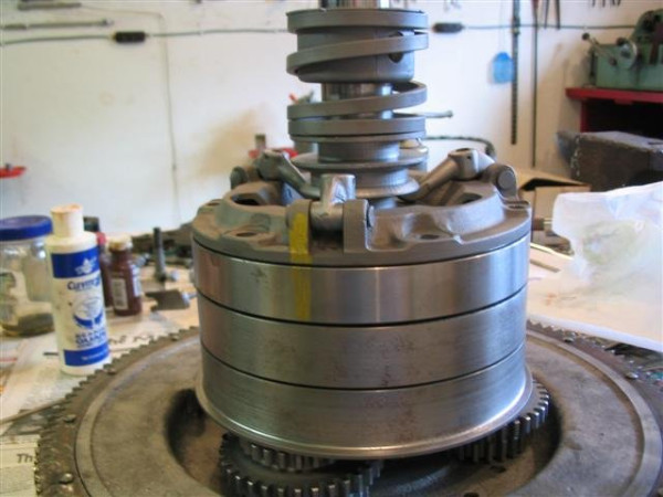

Take a long look at this picture, knowing that the lever that compresses the spring is fastened to the hog's head and in no way is a counteracting force on the spinning transmission. As the spring is compressed backwards (to the rear of the car) when in neutral (or reverse), I may not be understanding plain English - and if I am not, my apologies, but where is this "pushing it forward" effect in neutral, low, and reverse coming from?
It's been several years since I did my last transmission, and perhaps I am just becoming senile...if so, I'll happily accept correction, but from my experience, memory, and knowing how things go together, it seems to me that just the opposite is happening.
The clutch lever pulls back on the collar depressing the spring and releasing the clutch...the transmission assembly and thus the crankshaft is pulled back...the front of the rear main is supporting/constraining the load and thus the wear occurring on that front face of the rear main bearing inevitably leads to an increased clearance between magnets and coil.
photo credit: Herm Konhke

Scott, if I’m understanding you correctly, you’re saying compressing the clutch spring by its normal leverage point in the hogshead is actually a force moving the transmission away from the magneto ring ? Seems right to me.

So this afternoon I went through how the thrust forces work in a Model T transmission and came up with this:
When you push the Clutch Pedal down it pushes the Clutch Spring (#3340) rearward compressing the spring.
The back of the Spring is locked by the Clutch Spring Support (#3341) pushing it rearwards
The Clutch Spring Support is locked to the Driving Plate (#3321) by the Clutch Support Pin (#3342) pushing it rearwards.
The Driving Plate is bolted to the Brake Drum (#3311) pushing it rearwards.
The force moves to inside the of the Brake Drum riding on the Transmission Shaft (#3331) and it is stopped by the Driven Gear Washers (shims #3320).
The Washers get jammed up against the Transmission Clutch Disk Drum (#3332)
The Clutch Drum is locked to the Transmission Shaft (only in thrust but not rotationally) by a light press fit and the Transmission Clutch Drum Set Screw (#3334) pushing it rearwards.
The Transmission Shaft passes through the transmission and flywheel to be bolted to the rear Crankshaft flange pushing it rearwards.
All of these forces are pushing rearwards once the Transmission Clutch Release Ring (#3400) starts pressing rearwards all the way to the crankshaft main bearing front thrust surface.
Hopefully I have cleared things up and not made them worse.
