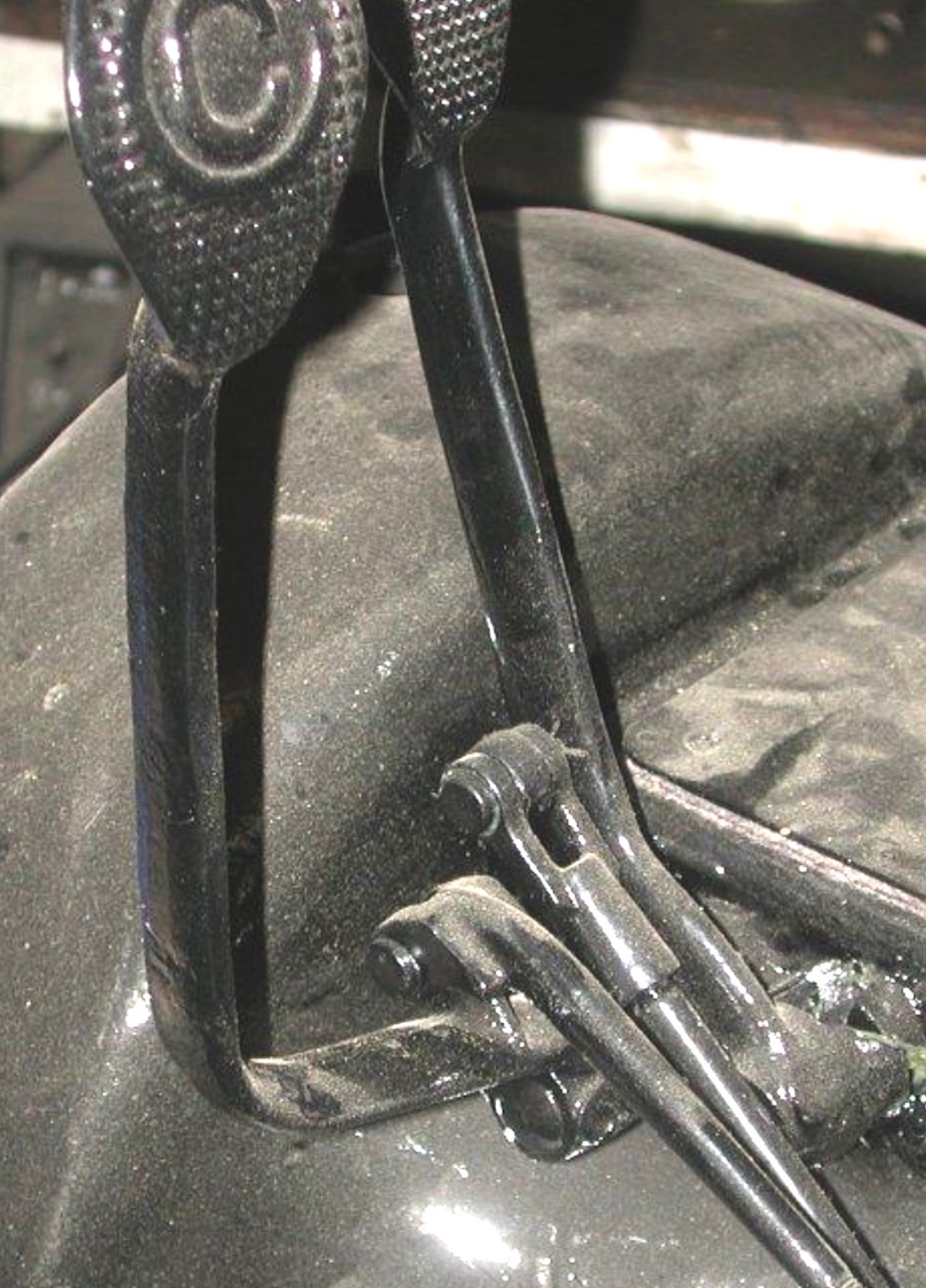

Look at the cross hatch on the clutch pedal. One person thought early 9. No foundry mark that I can see. What say you?

That C letter with the ‘flat’ side on the C looks like same on this early 2 pedal Ford. So maybe early clutch pedals have that look?

You can see a difference in 09-10 foot pedals when you compare them alongside later ones. There is more curvature in the 09-10. Its not hard to spot.
