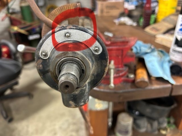

I'm looking for the secret to remove the steering wheel lock from the column. It was made by the BATTLE LOCK COMPANY and of course the key is long gone. I cannot see any pins that could be keeping the lock in place. Some paint does remain that could be hiding a pin. If anyone has any knowledge on how to separate mechanism from the column please share. The gears at the top of the column need to be checked and greased

Let's see some views from the bottom side.

I see some odd discolorations here, located 180 degrees apart. Locations of hidden pins? If so, they're likely driven out from the bottom, (hence my request for bottom end pictures).
- Posts: 5267
Re: Removing Battle Locking Steering wheel, help needed
I also saw the one on the right also. Pin locked. One way. You will have to drill them out.Jerry VanOoteghem wrote: ↑Tue Mar 03, 2026 11:12 amI see some odd discolorations here, located 180 degrees apart. Locations of hidden pins? If so, they're likely driven out from the bottom, (hence my request for bottom end pictures).
It wasn't made to be removed once installed.
- Posts: 4478
If it's like a FOX steering wheel lock, (and some others), the pins will drive out from the bottom. Look up from the bottom of the housing for small notches along the threads that screw the device onto the gear case. In the case of the FOX mechanism, only a very slender pin punch will work.speedytinc wrote: ↑Tue Mar 03, 2026 12:13 pmI also saw the one on the right also. Pin locked. One way. You will have to drill them out.Jerry VanOoteghem wrote: ↑Tue Mar 03, 2026 11:12 amI see some odd discolorations here, located 180 degrees apart. Locations of hidden pins? If so, they're likely driven out from the bottom, (hence my request for bottom end pictures).

Zoom in where the circle is. A pin maybe? Just above the tag.

I don't know if you call it locked or unlocked but the steering wheel does turn and steers the car. Fwiw.
Pins have been located by wire wheel paint removal..
