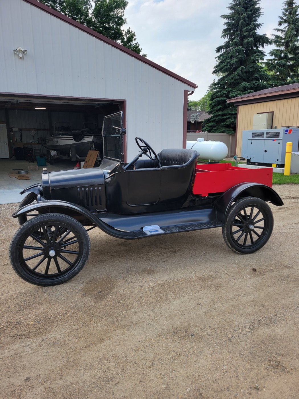

This car was my Dad's. This photo is of him in 1948 at 16 years old. He passed away in 2024. He always said he would like to have a brand new Model T with today's paved roads. Back then in ND they were few and far between. This is why I'm trying to keep it as original as possible. Here's what she looks like now. (without the red wheels)

Wayne, the picture of your Dad in his T made me smile! I really like the contrasting paint on the edge of the fenders and running board-- I have never seen that done but it sure gives a T a snazzy look!

That custom striping was done by a 16 year old boy with a can of red barn paint!

Wayne, that is what what I like about it-- a kid having fun with an old car...
