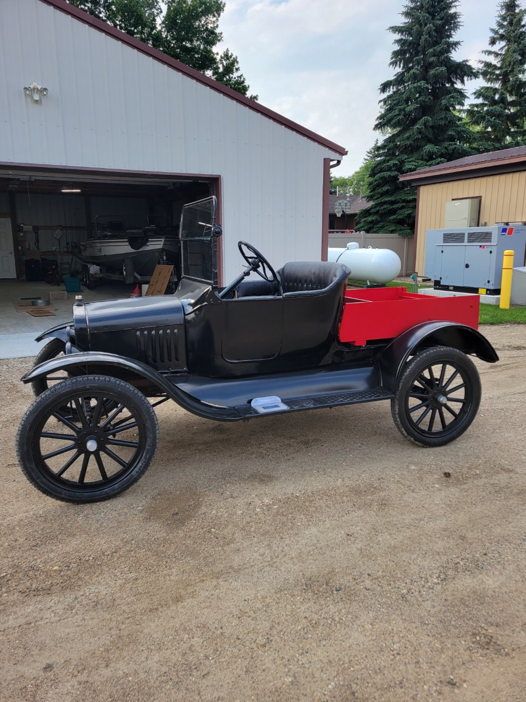

Post by Wayne Jacobson » Thu Mar 05, 2026 11:20 am
This car was my Dad's. This photo is of him in 1948 at 16 years old. He passed away in 2024. He always said he would like to have a brand new Model T with today's paved roads. Back then in ND they were few and far between. This is why I'm trying to keep it as original as possible.
Here's what she looks like now. (without the red wheels)
Shannon_in_Texas
Posts: 242
First Name: Shannon
Last Name: Helm
Location: Arlington TX
Re: New guy, new camshaft?
Post by Shannon_in_Texas » Thu Mar 05, 2026 11:59 am
Wayne, the picture of your Dad in his T made me smile! I really like the contrasting paint on the edge of the fenders and running board-- I have never seen that done but it sure gives a T a snazzy look!
Wayne Jacobson
Posts: 7
Joined: Sat Jan 31, 2026 10:04 pm
Last Name: Jacobson
* REQUIRED* Type and Year of Model Ts owned: Roadster 1921
Location: Bowbells ND
Post by Wayne Jacobson » Thu Mar 05, 2026 12:08 pm
That custom striping was done by a 16 year old boy with a can of red barn paint! :lol:
