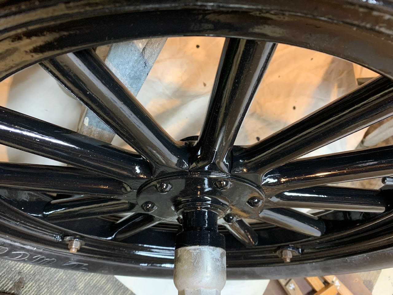

[image][/image]I made a tree with cut off ends of rear axle shafts, and hooks to mount a pair of front spindles. I drove it into the ground behind the shop, and painted the wheels on a sunny day. I spun them slowly by hand while spraying. I'll try to post a picture.

Will be more successful if you spray paint vertical and rotate the wheel as you do.
Photo is from the forum on this subject, pro method.
For home garage work, placed a piece of PVC tubing clamped in the legs of a ladder, to rotate the wheel front hubs, used steel rod for the rear hubs.
Have also primed with brush and then sanded each spoke, more work but results on final spray was good.
Final finish on later steel felloe wheels using rotated vertical method.

I do mine vertically too. After the first coat, you need to brush up on your counting to 12. Putting black over black, it is not easy to see where you have been. Starting at the valve stem hole, I rotate the wheel and spray one spoke at a time from the one direction, then rotate in the opposite direction and do the second side, counting all the time. Then the process is repeated from the other side of the wheel, so each and every spoke is addressed from four angles. The same process works for clearcoat also.
Allan from down under

I decided to make a vertical wheel painting stand, using my saw horses, 1/2" all thread and fender washers and nuts at the end. The nuts and washers were a good idea as the wheels tended to migrate down the all thread, and that kept them from falling off and really ruining my day. I used copper pipe clamps to hold the far end of the all thread to the saw horse tops, as there's quite a load pushing down on the all thread, especially if the wheels are a foot or more way from the end of the saw horse.
I primed them yesterday and today, as well as a bunch of other T parts. The stand worked well, but boy, is the saw horse heavy with two wheels on it!
Here's a picture of the stand, as well as the many parts out drying in the sun. A neighbor lady walking by thought that I was working on a sleigh!
