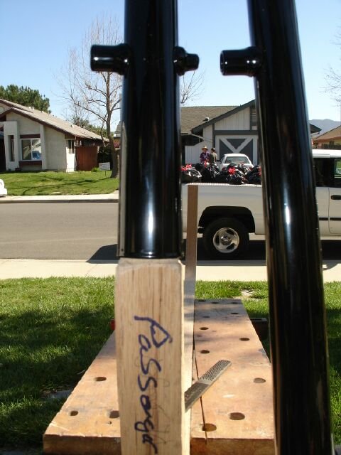

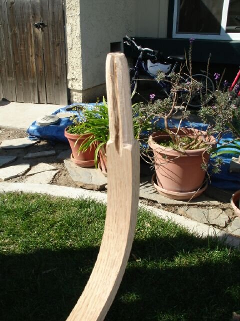

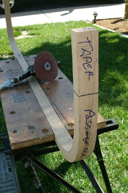

Early 15 roadster. My upholstery friend & expert carved the bows. First with a spoke shave. Then graduated to a 3" angle grinder with 80 grit.
Much faster. The procedure is to cut the approximate angle(cone). Fit into the socket. Where it marks, remove more material. The trickiest part was carving the relief slot to fit the rolled seam inside the socket. He used a wood chisel for this channel. A dremel or 1/4" carbide burr in a die grinder will do the job also. The key was to remove a little material then fit to determine where to remove more material. The first bow end took a several hours. (learning curve & being overly cautious.) The other 5 ends were done in one day. They all fit like a glove. We figured if we went to far, we could add some epoxy for filler, but not needed.
No big deal really.
No big deal really.

Brent,
I second John's statements.
If you want a template, measure the outside of the iron and make the bow that size and shape.
It will fit too far out and then use the rub marks to guide you to the proper fit.
Cutting materials faster makes fitting faster and makes mistakes faster.
Find a material removal speed (and tool) that matches your comfort level and confidence and skills.
I like a grinder with a sanding disk on wood but it removes material too fast for detail fitting.
I use it to rough things to shape then switch to slower tools as the final fit comes near.
Mike
