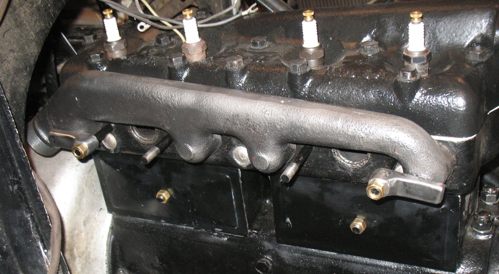

I hate the idea of cutting up original parts, so I made these.
