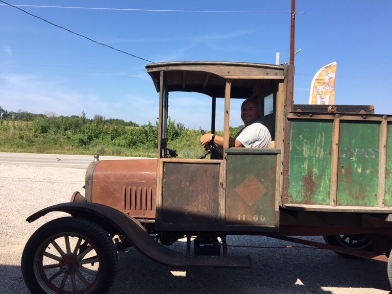

Guys thanks for all of the great help. Unfortunately I have to work at the NSRA nationals in Louisville for the next several days so I won’t be able to play with the truck this weekend. I can’t Waite to get it back out and learn how to drive it. I will
Report back and post more pictures.

Posts: 6719
Re: I drove my TT for the second time.
Post by Scott_Conger » Tue Jul 30, 2019 9:28 am
Now THAT is a GREAT truck!
Even I might be converted with something like THAT! :lol:

If its the same truck, it belonged to someone around Wales, Wisconsin about 25 years ago. Looks like the same one.
Post by Dallas Landers » Tue Jul 30, 2019 11:23 am
Big, Green and really cool. You guys know I like it!

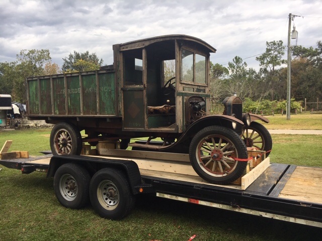

Post by abcarswell » Tue Jul 30, 2019 9:58 pm
Duane,
I see your TT is a former REA truck. This is very cool as I am actually restoring my 24 TT C cab as an REA (actually its predecessor American Railway Express). Any pictures you could post/send on details such as lettering etc would be appreciated.
Bruce Carswell
Post by Duey_C » Wed Jul 31, 2019 1:42 am
Duane, you have fun at the NSRA Nationals! That truck will wait for you. Quite patiently, in fact.
What an absolutely beautiful truck! And I thought my Lucky was a good lookin' ol' devil that has no view behind without a huge mirror.
