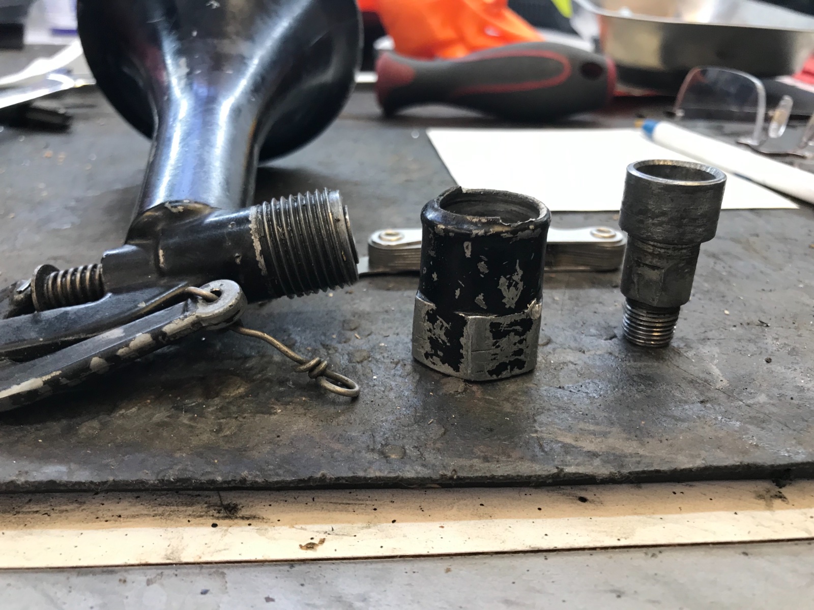

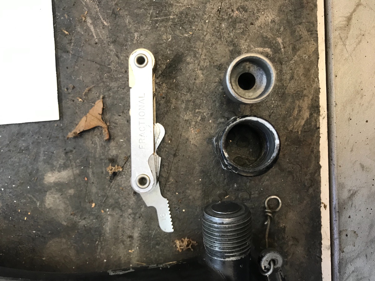

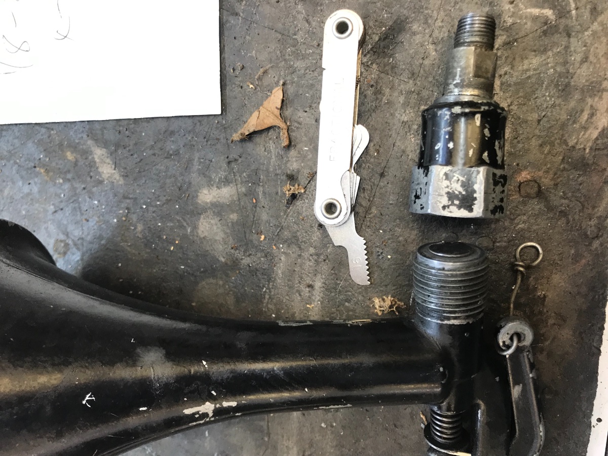

I need help replacing the connector on my wolf whistle which just broke and isnt fixable. Does any know anyone know where I can source this type of connector?
it appears to be 1/8"-27 NPT x ?? -16. Not sure of the dimensions of the large end. I don't have anything to compare it to. It's smaller than 1/2" pipe thread and 16 TPI.

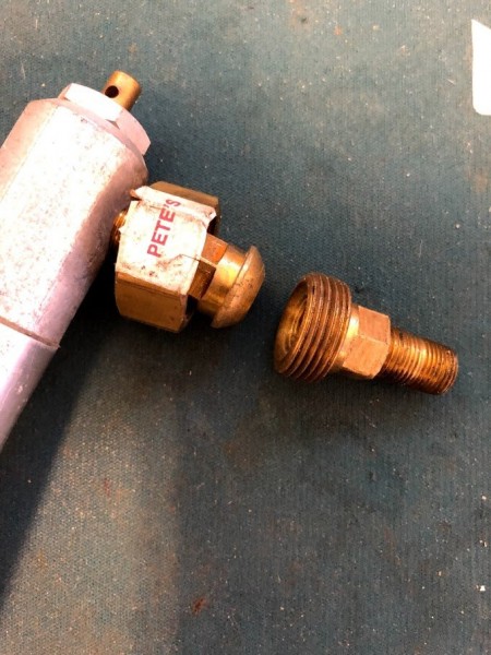

Here's the parts I bought from the local hardware store for mine back in the 70s. That's when hardware stores sold hardware. I just pull the plug in my manifold and install. It's not a pipe thread and I only use it now and then for special occassions. Normally it's off the car.
Hopefully the picture helps you. I can get you thread and size if you need.
Al
Al

That looks like it might be 13/16 ORFS (O-Ring face seal).
Your local hydraulics shop should have something to replace it.

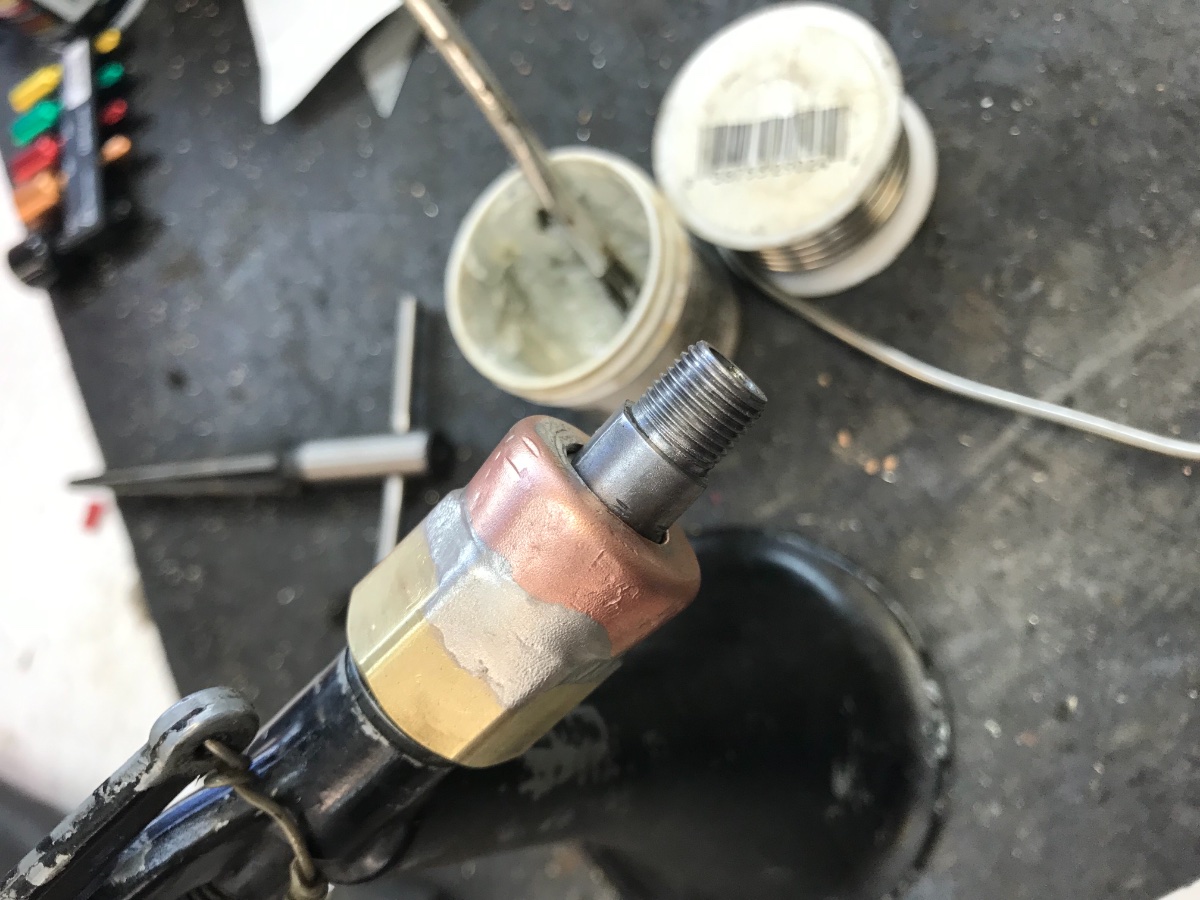

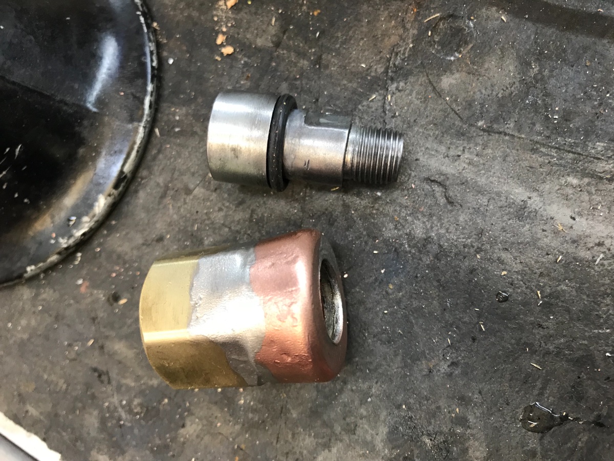

Re: Wolf whistle *solved*
Sometimes you just have to sleep on the problem before you can come up with a fix. I had all these parts in my parts bin and with a little bit of brazing and some ingenuity the new part works better than the old one does.
