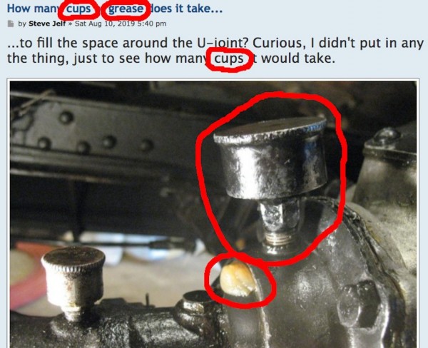

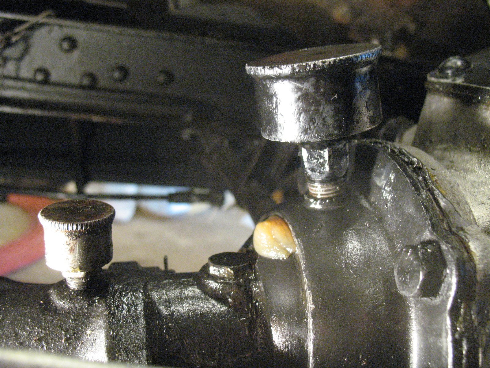

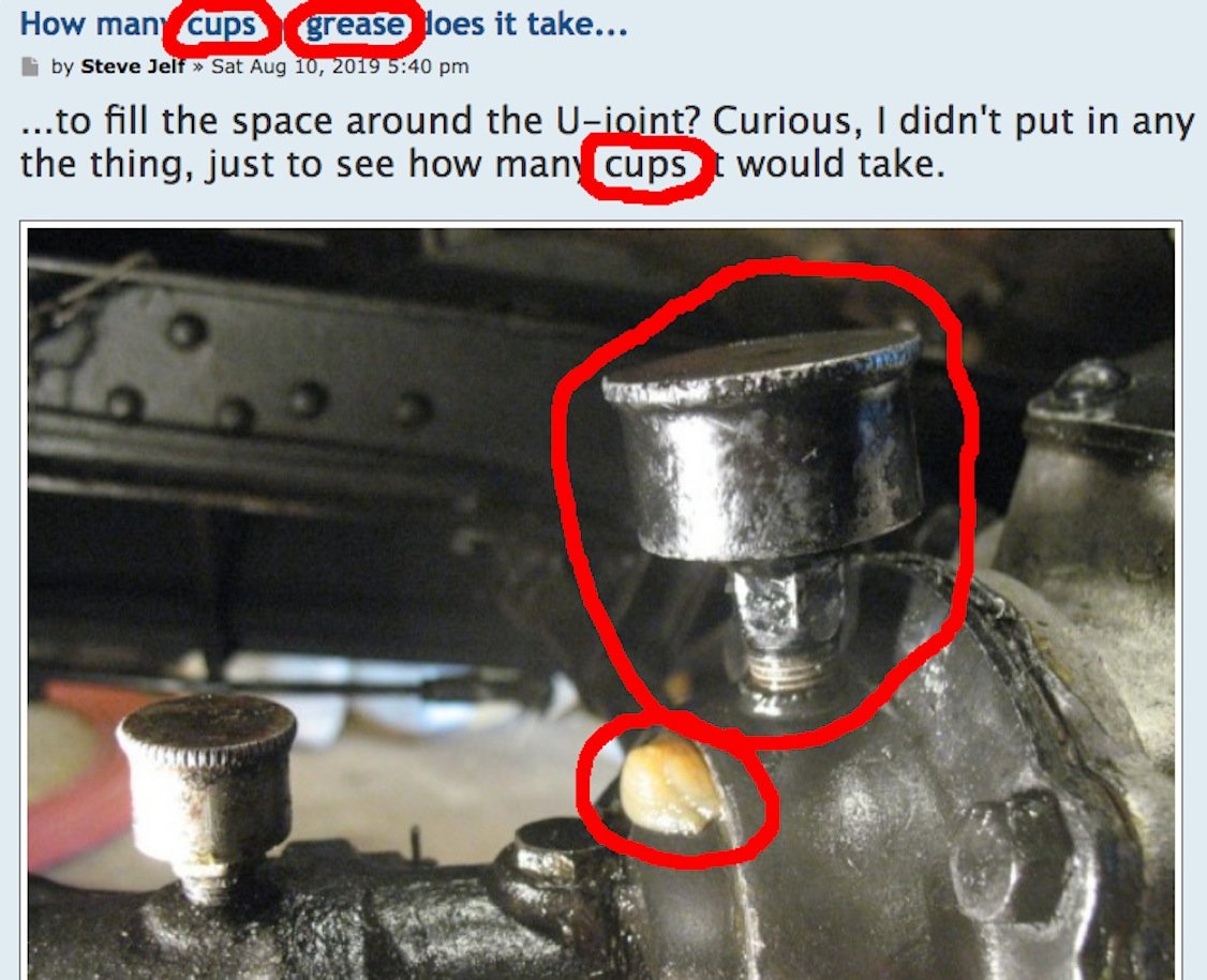

...to fill the space around the U-joint? Curious, I didn't put in any grease when I assembled the thing, just to see how many cups it would take.
The answer is 23, at least in this case. After the car has run a few miles the grease may be spread around to make more space.

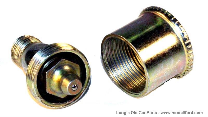

The best idea I've seen for these type grease cups is to install a modern Zerk fitting inside the cup. It sure does make greasing the T a simple task. It's important to grease that U joint often..

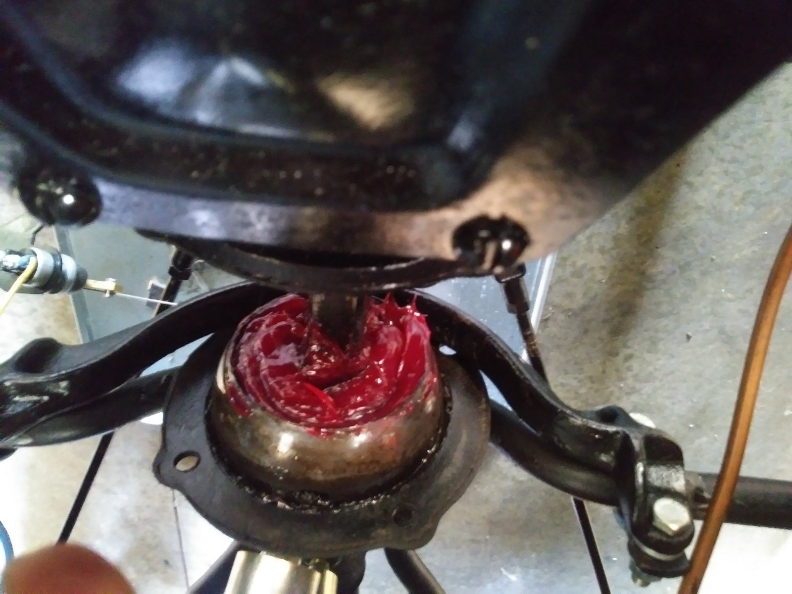

I'm happy you shared that. It's much easier to pack the cavity before you slide the u-joint into the engine. Then, all you need is to fill the grease cup a few times. If you install a zerk, then how are you going to keep the grease cup from coming off? It's better to not use a zerk.
- Posts: 6548
Re: How many cups of grease does it take...
You can buy them already made too, in steel or brass, for U-joint, steering, rear axle....
- Posts: 5507
"If you install a zerk, then how are you going to keep the grease cup from coming off? It's better to not use a zerk." Most of my grease cups for that size are not spring loaded if you are talking about the cap. If the cap unscrews from the base, you have more problems to deal with then just a lost cap. And even if you lost the cap it would be no big deal, no different then just installing a Zerk without the cup, both are pipe thread. I install mine dry and fill after, enough to deal with without the mess of grease everywhere. I find about 1/2+ tube of grease fills it from dry, but I am not going to go out a measure how many caps full that is!
Simple matter to unscrew the cup install a Zerk fill the housing then reinstall the cup for refilling later if you so wish.

As the regulars on this forum know, I use original parts. The cap has a three or four sided stud which is welded to the cap. There is a spring affair that fits into the base, and when the two are engaged, it prevents the cap from loosening. Of course, if you have a zerk down there, it can't work.

I used one with a zerk when I assembled my drivetrain for the first time. It took 3/4 of a tube a grease to fill it from empty.

Can’t have too much grease in the u-joint ball, Ford used the largest dope cup there. Takes about a full cup of grease to pack.
Have always packed it full on install of the engine, filling the joint and space in the torque tube ball, allows for the square end of the u-joint to stand up and not wobble in slack as you couple. Keep that u-joint packed each 500 miles.

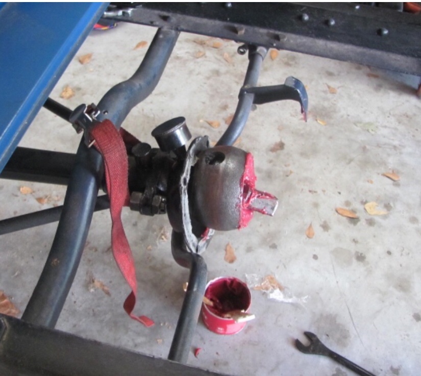

No, no, no. Not eight ounce measuring cups. We're not baking a cake here. This is about Model T GREASE cups.
And yes, I really did fill it and screw it on 23 times before it filled the cavity enough for grease to start oozing out around the cap. (See the first picture I posted above.) I assure you I'm not running for office, so I'm not lying.

Like Dan said...if you have the engine out or rear end out just make sure and the ball full. And yep it does make it very easy to keep the universal in place for an easy coupling. Just did that last week. Very quick and easy hookup. Then every 500 miles I give the Zerk fitting cup 20-25 pumps and its good to go. Plus 4-6 on the driveshaft bushing. Never had any trouble with the caps staying on the cups either!

Filling the ball full of grease and continually adding more grease is like taking a whole bottle of aspirin. More is not better...

How is having the ball full then adding some after it squeezes out under normal operation a bad thing? I would think having it mostly full would be an advantage for a healthy u-joint, and for preventing engine oil from going down the torque tube and into the diff. Me confused.

Some grease squeezes forward into the transmission and engine. Modern grease does not mix readily with engine oil. Because the oil system is not pressurized, the grease has the ability to foul oil grooves and oil holes in the engine and transmission preventing proper lubrication. Grease also EASILY will plug up oil lines, even the accessory ones. It’s really important to keep any traces of grease out of non-pressurized engines.

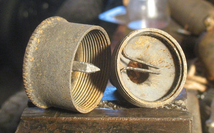

I've lipped off about this before but I just took the entire, clean and correct cup assembly off the empty U-joint cover on the 18 and held the grease gun against the hole for the cup and started pumping. You prob'ly remember this, it took me a few tries to get it done but it was full. And a few more (grease) cups worth. Ouch. Then I sat down again and refreshed my self with a cold drink.

OK. I will ask the question. Adam replied that some grease squeezes forward into the transmission and engine and may plug oil lines and grooves. I packed my u-joint with the fiberous yellow truck wheel bearing grease in hopes that it would stay put and not run out like regular grease. I also considered using the red grease for heavy equipment that stays put. Do these types of greases pose more of a danger of plugging the oil lines? Am I asking for trouble? What is the best type of grease to use in this location?

I can verify Adam's comment about some of the grease working its way into the transmission. I pumped away at my zerk fitting, never seeing any grease come out of the U-joint cover. Next time I opened the transmission cover plate I found what I first thought was a dead mouse in the screen. It was a big glob of grease partially dissolved by the engine oil into a very mouse-like shape. It even had a tail. Should have taken a picture, but my hands weren't very clean.
It never occurred to me to check the oil lines, but I will do that now.
