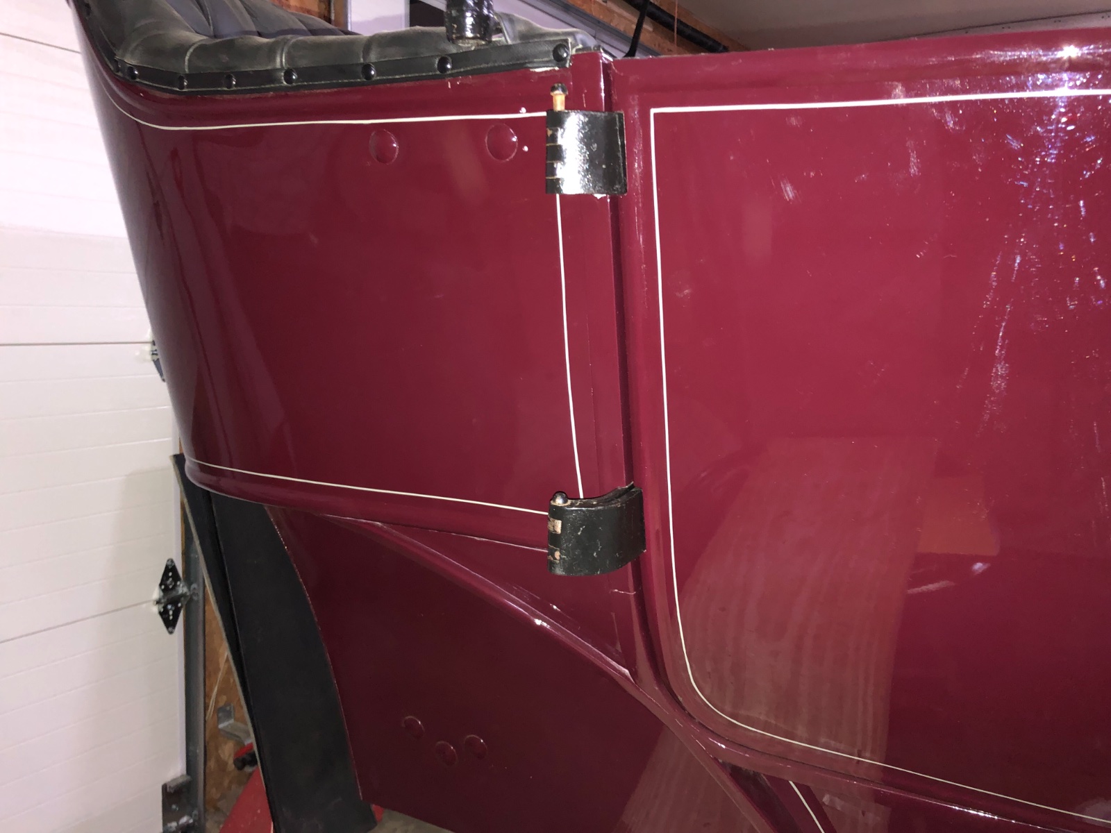

Post by Bill Anziani » Thu Aug 01, 2019 6:01 pm
Got Mz. Daizy back from the pin stripper. Had the red stripe run under the belt line on the 24 coupe

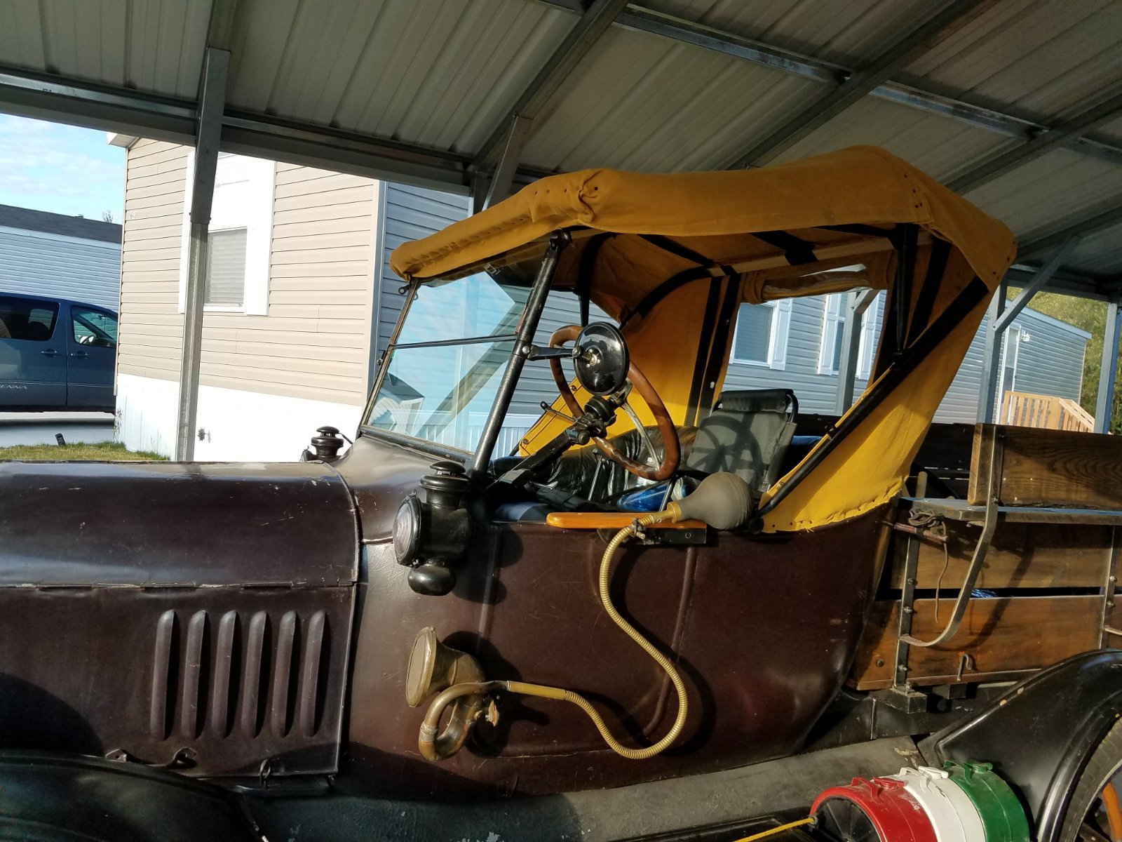

I drove mine [And any T] for the first time! Just got it Tuesday and got brave enough for a quick spin today. I think I have to learn to drive all over again.

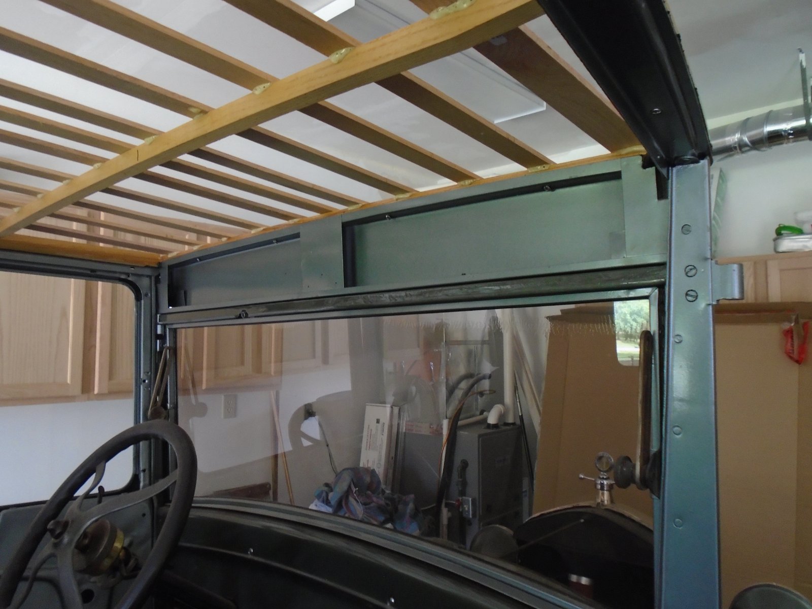

I installed the qtr and rear windows in my 26 coupe. I'm ready to start putting the wooden roof frame on does anyone put any kind se sealer down before mounting the wood frame?

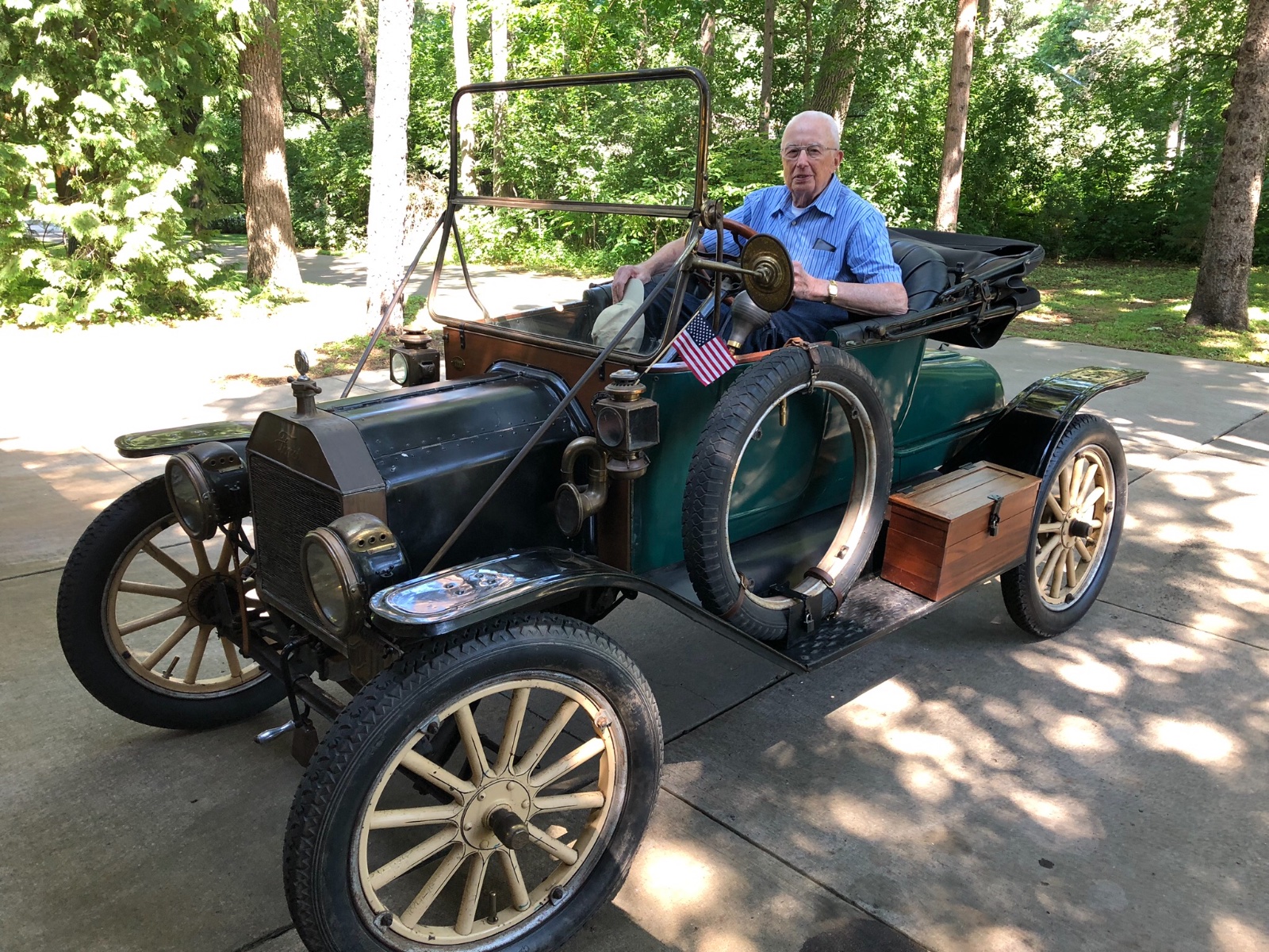

Erik and his father Bob Johnson stopped by to see my 1913 Runabout. Bob originally found the car beside a barn in dilapidated condition back in July 1951. B/W picture of him behind the wheel after getting the remains running. He sold the car and after 68 years and several owners (plus a “re-body”) he was reunited with it.

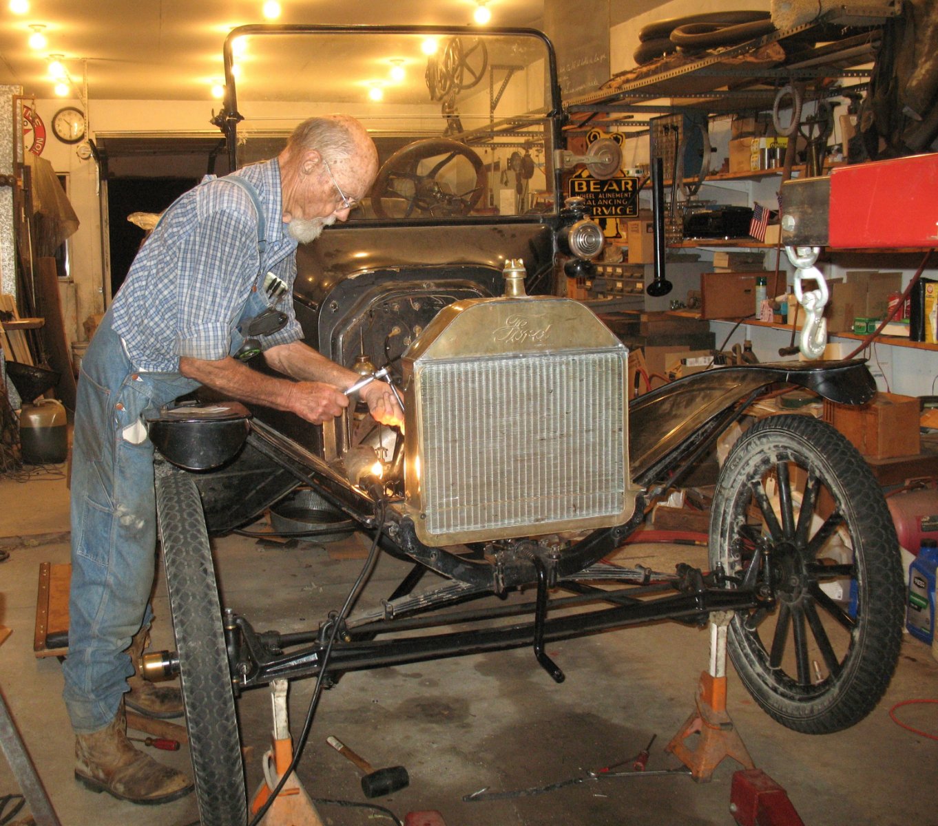

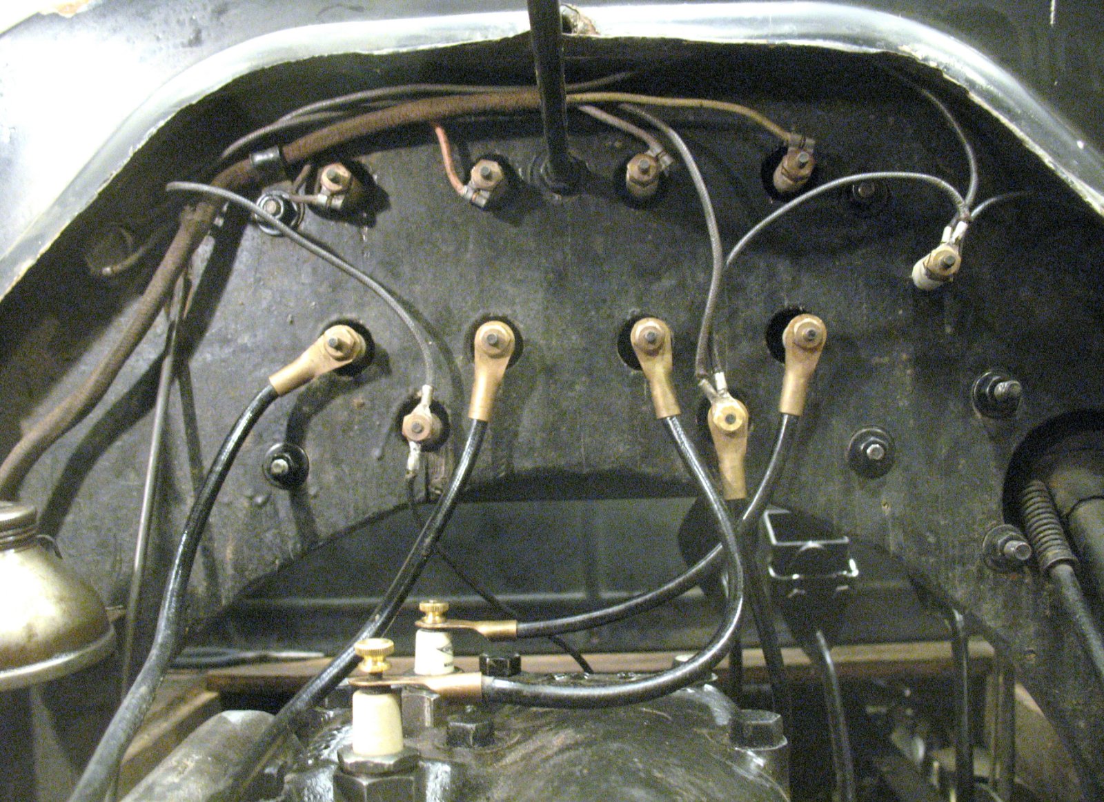

Post by Steve Jelf » Sat Aug 03, 2019 12:47 am

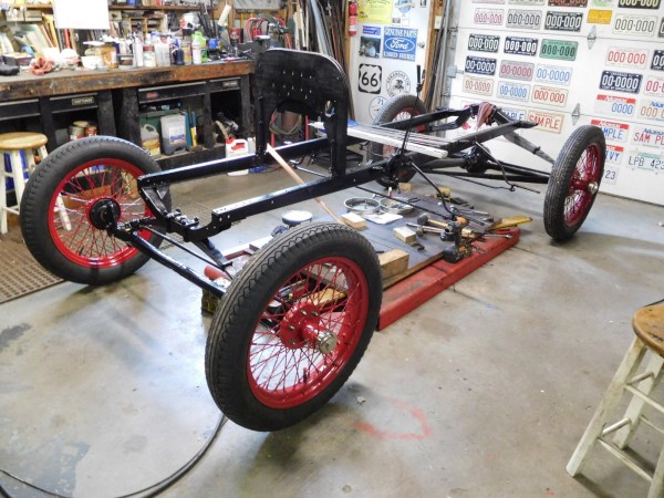

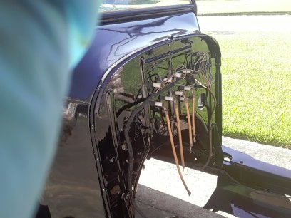

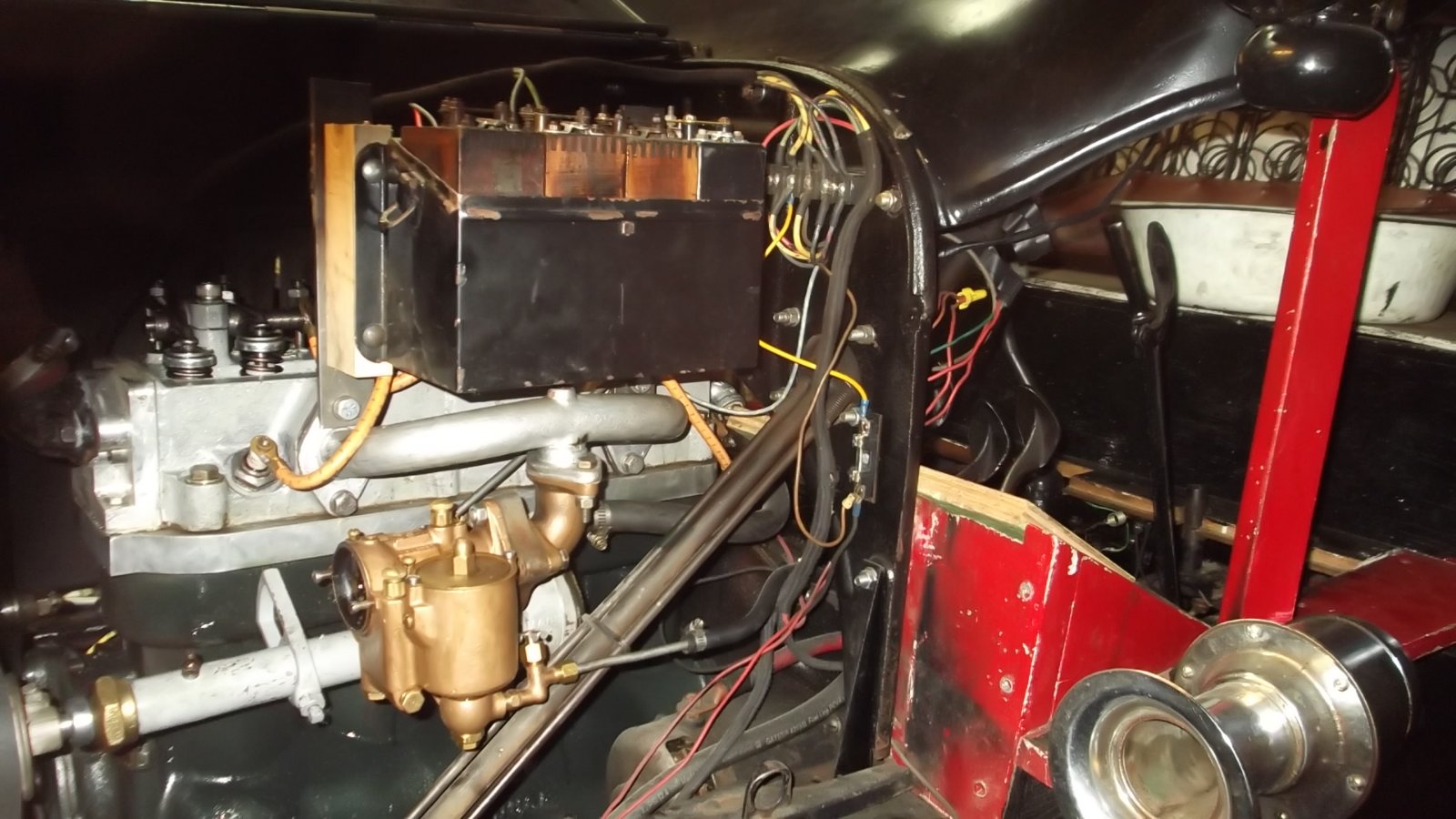

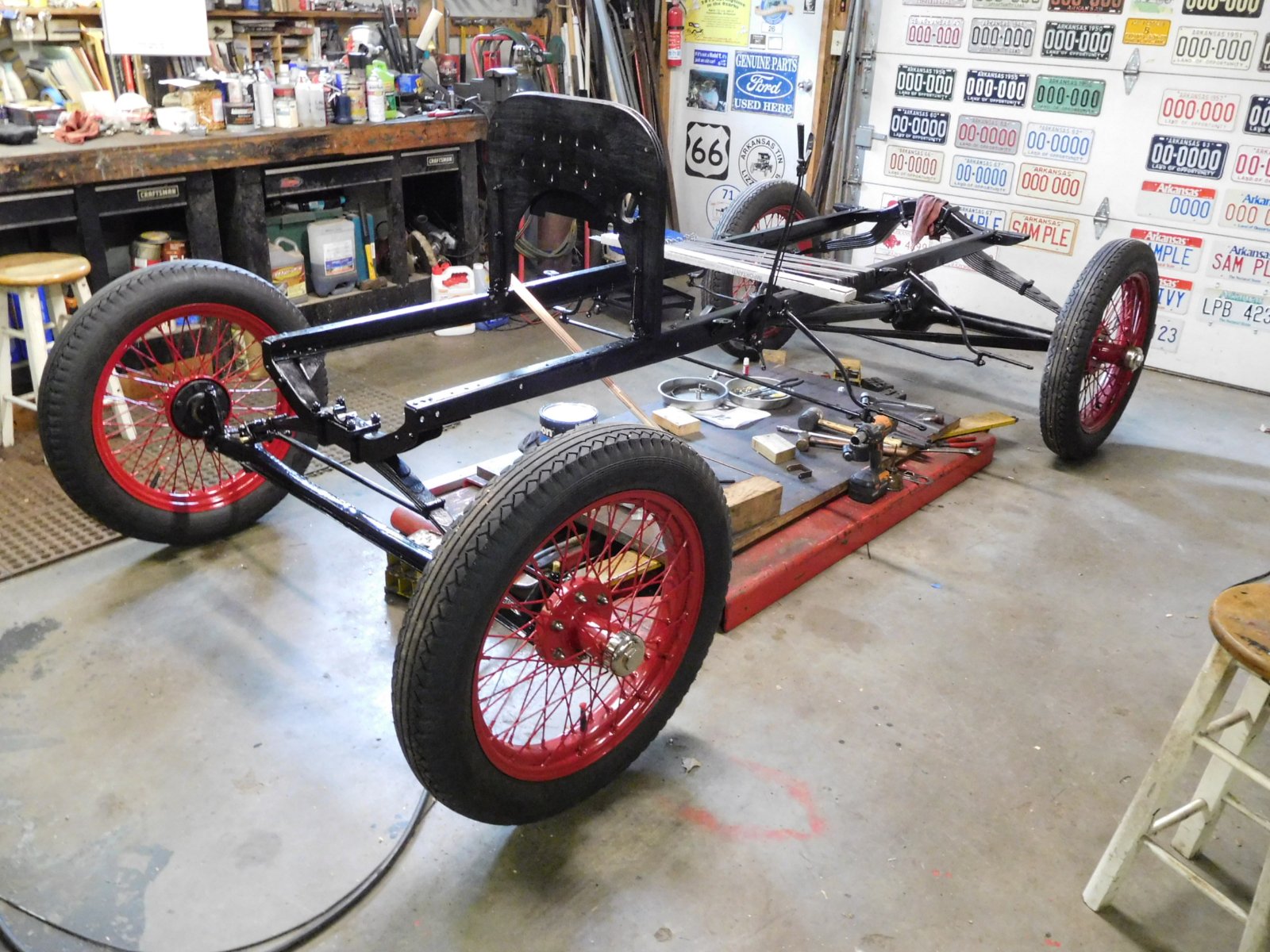

Continued runabout reassembly.
Today I installed radiator, coil box, wiring, spark plugs, and that most exasperating Model T part—hood latches. They would be easy if I had three hands.

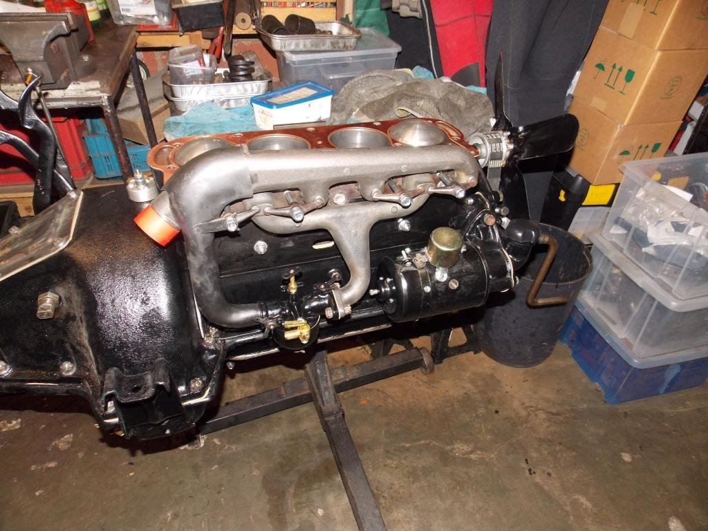

Post by AndreFordT » Sat Aug 03, 2019 10:58 am

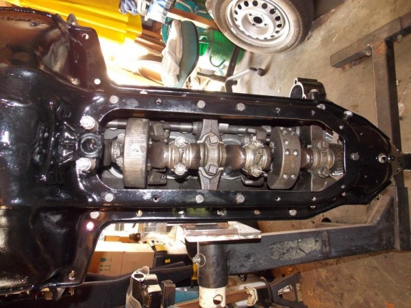

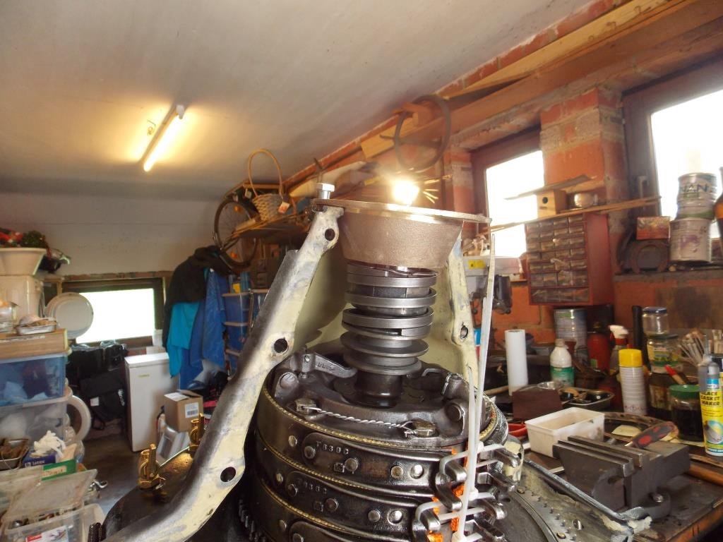

I made the trouble engine run again.
https://www.dropbox.com/s/8dlh57tq0lm48 ... 1.MOV?dl=0
Andre
Belgium
Other photos will follow

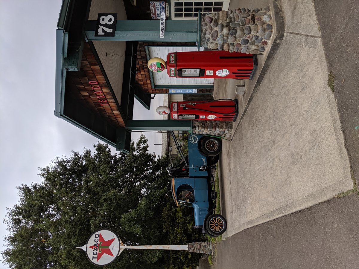

Post by D.Yoder » Sat Aug 03, 2019 9:11 pm

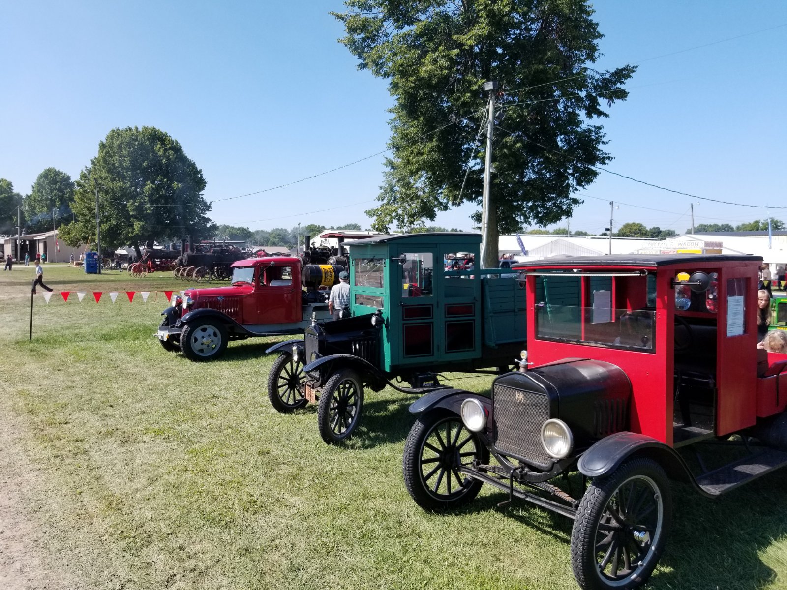

August starts a month of T travel for me
    Playing with early fords in Minnesota now.

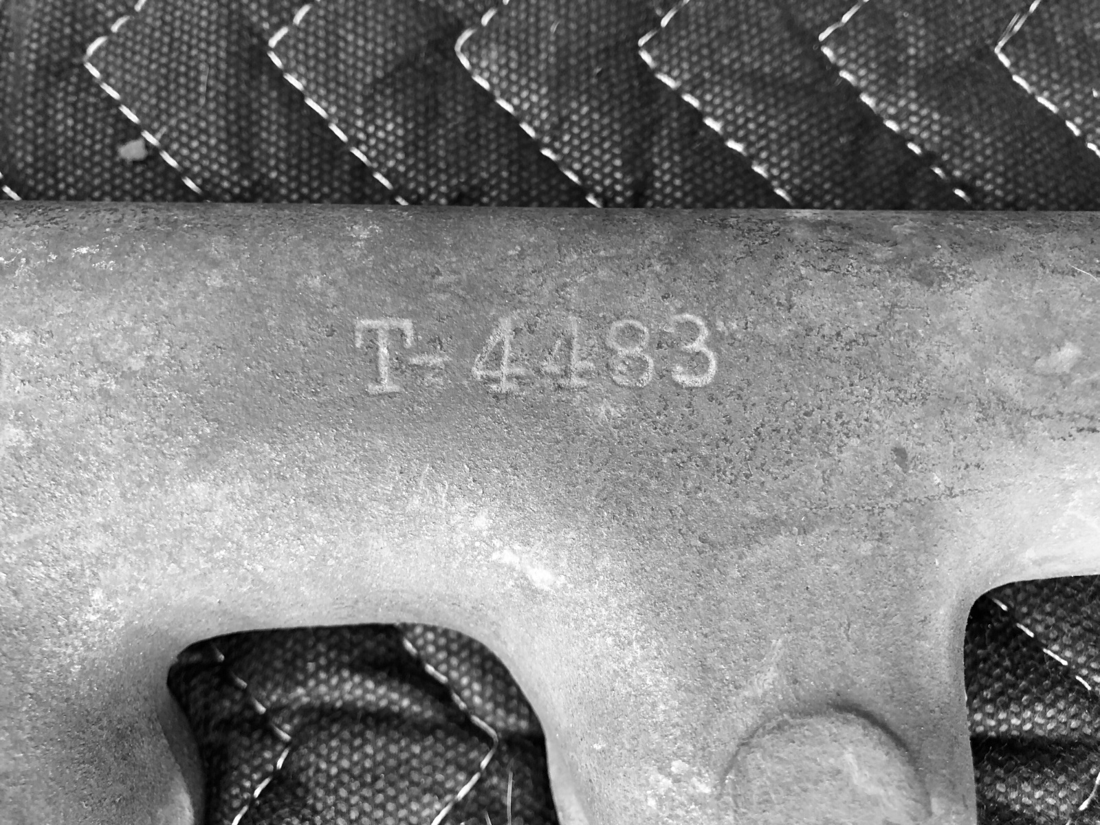

    Post by Mark Osterman » Sat Aug 03, 2019 9:34 pm

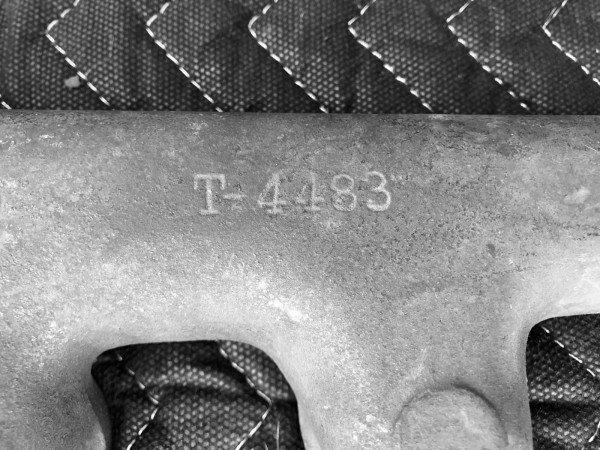

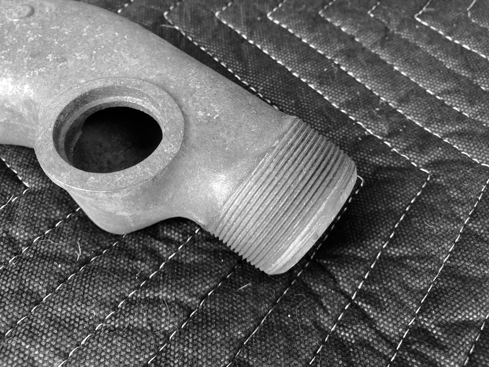

    Took a trip to Lang’s and bought an NOS exhaust manifold and NOS front and rear spring shackles. Anxious to get home and reinstall the manifolds and get back on the road.

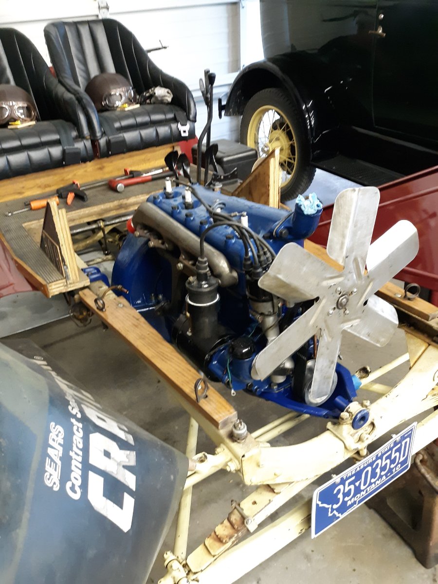

    Post by kelly mt » Tue Aug 06, 2019 7:44 pm

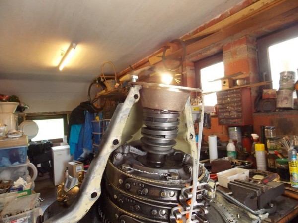

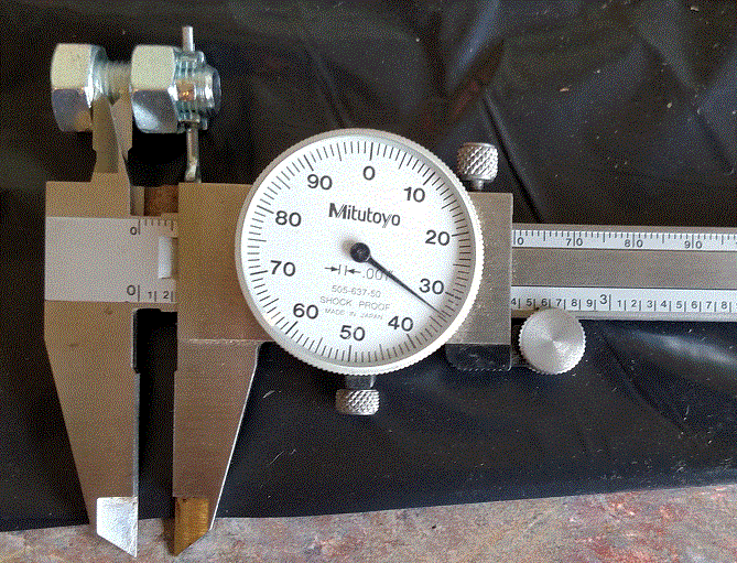

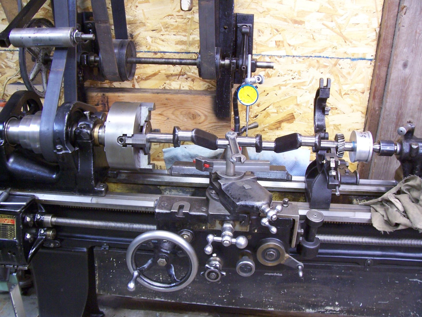

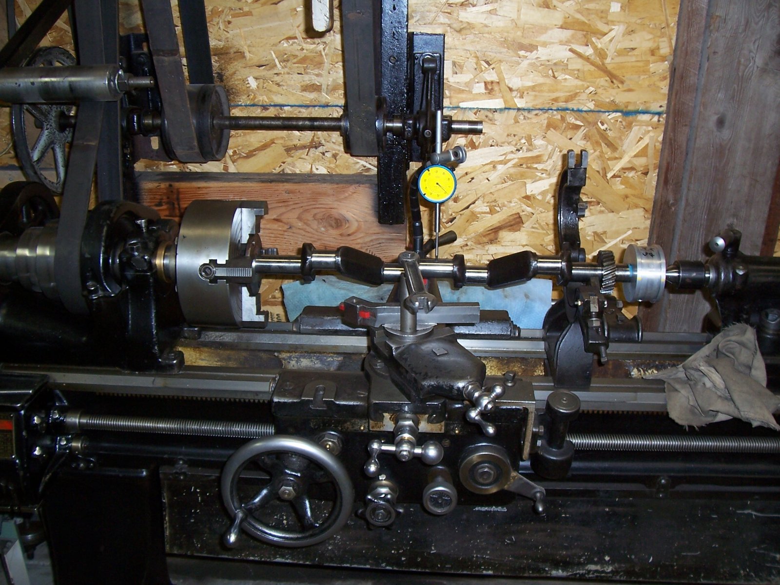

    My new speedster had some bad noises so I pulled it down. The odd measurement in the clutch turned out to be the retaining bolt left and everything moved back running on the 4th main. The center main and two rods were very loose. The front cam bearing was bad. Looked like it was new but the locating hole was oversize and the shell halved didn't fit at the break line. The timing gear was binding at one spot every rotation. I changed out the bearing and this problem went away. Also an .008" bow in the crank and a cracked low drum. Lots of odd things which means lots of work to do. Good thing I like this work.

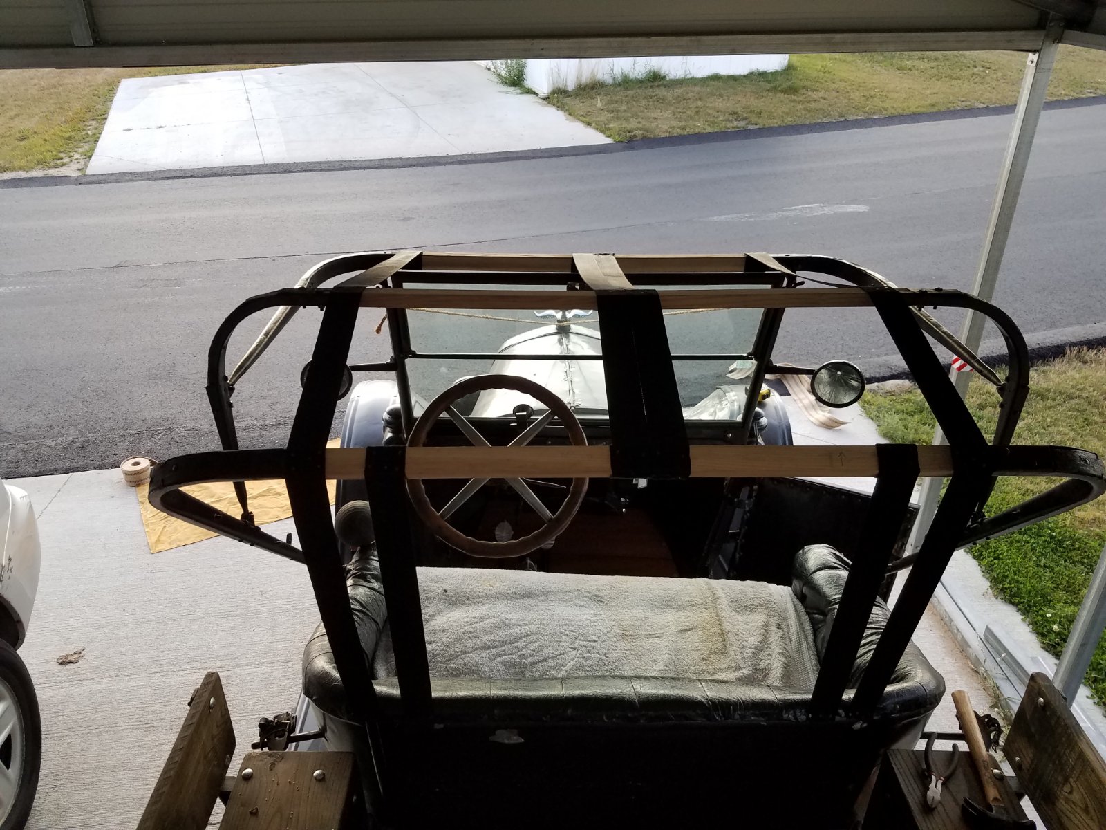

    Post by Graybeard77 » Wed Aug 07, 2019 6:02 am
    Going to get our "T" ready for the Route 66 parade here in Springfield, Mo. This Friday evening. Will be several old cars and classic cars in parade.

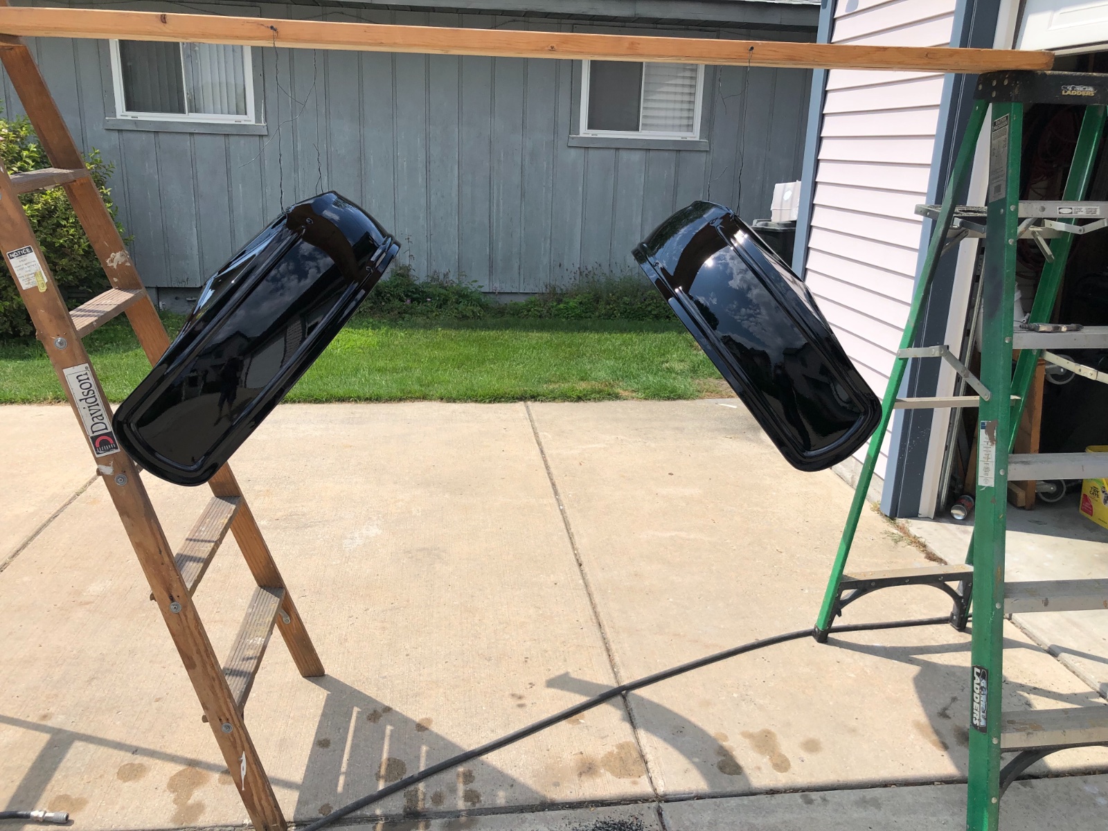

    I got my rear fenders painted finally hopefully they will be on tomorrow :D

    Are you shore they are not your T`s fenders? :lol: :lol: MEL.

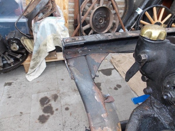

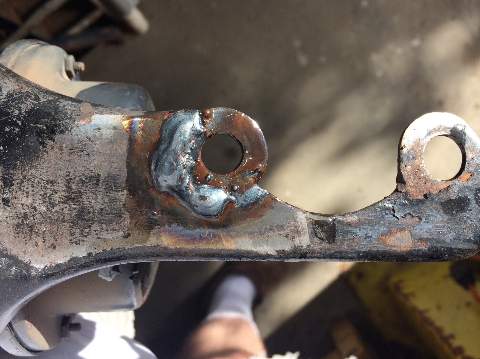

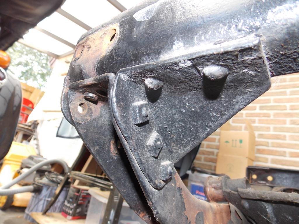

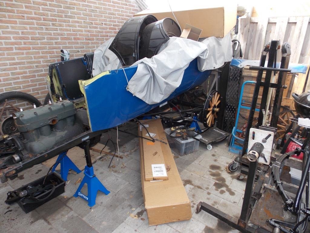

    Restart the dis assembling of the wrecked 1915 touring.
    Watch the way the front was assembled to the frame.

    Andre that is a "bolt -on" modification, ;) must have been on there a long time, with the square nuts !

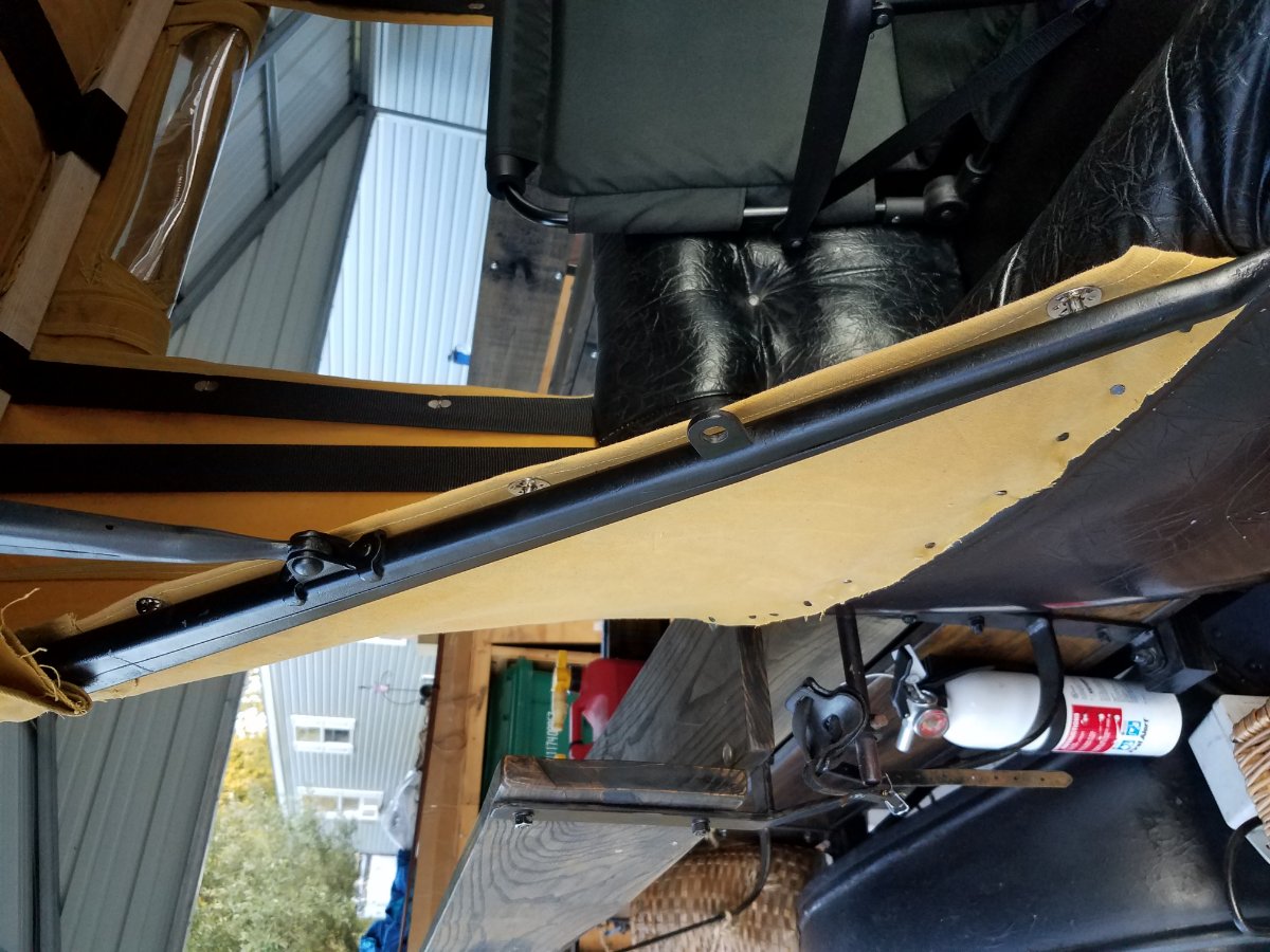

    Been installing window glass in 26 Tudor and prepping to purchase interior kit. I have seen video with roof wood frame off to attach headliner, but don't quite understand how headliner is attached at the header of the windshield since there is no wood there. Am I missing something?

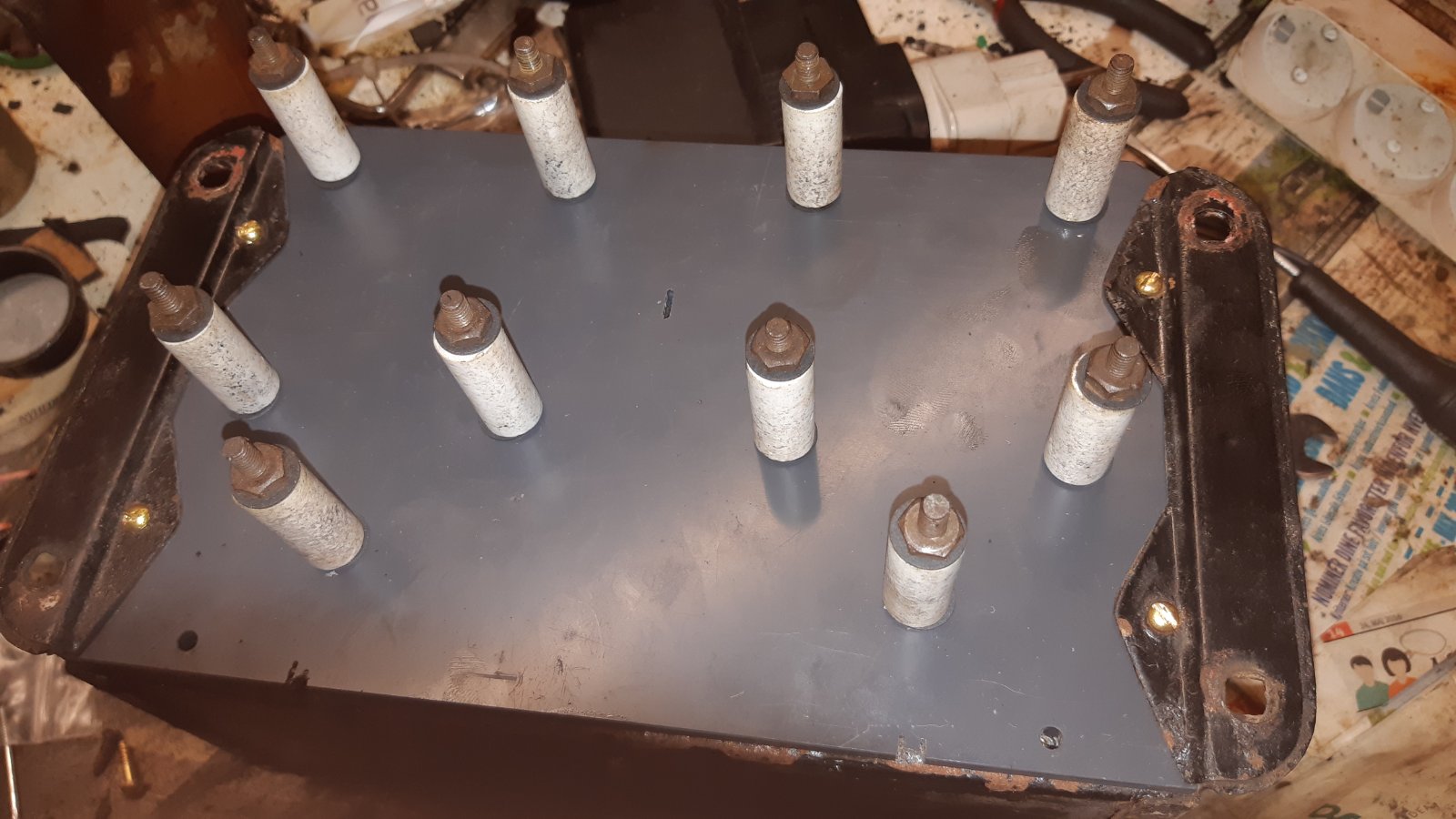

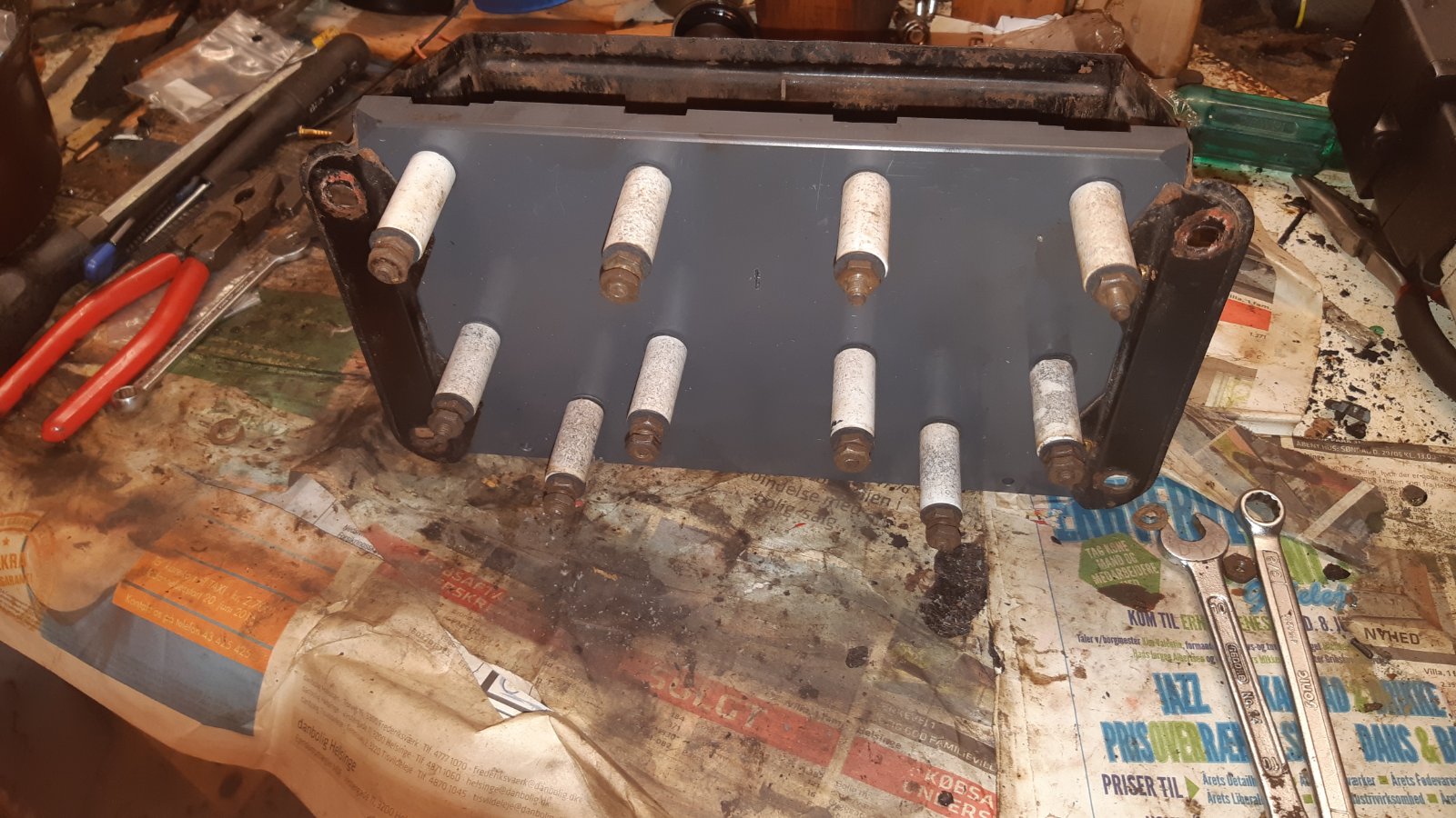

    Rebuild the coilbox for my Pick-up with Fun Projects plastic inserts.
    Porcelain tubes cleaned with dishwashing soap and a brush.

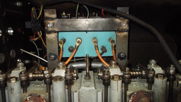

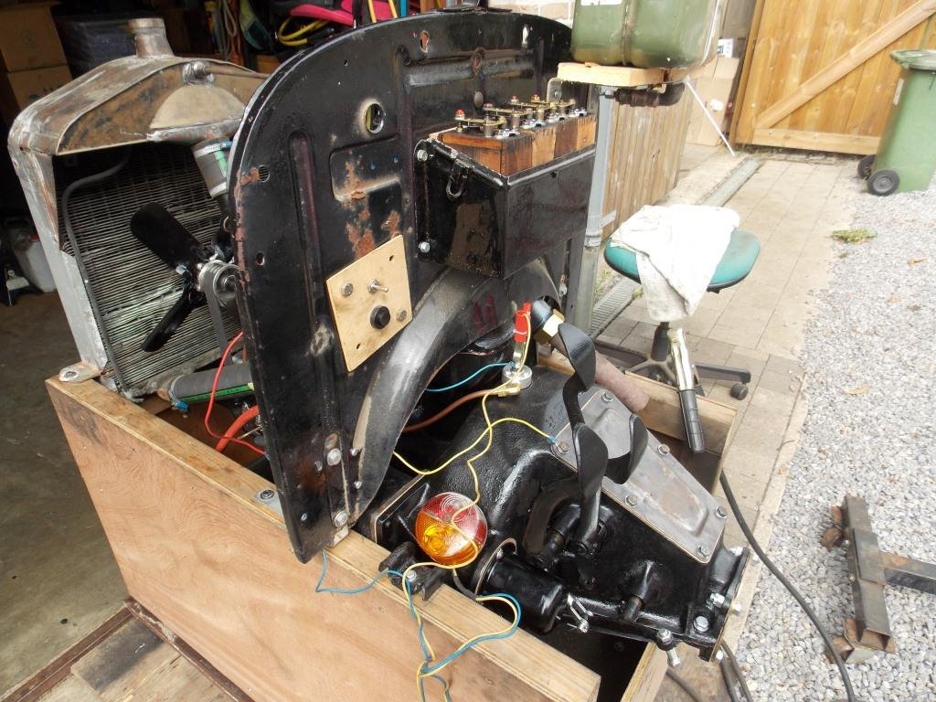

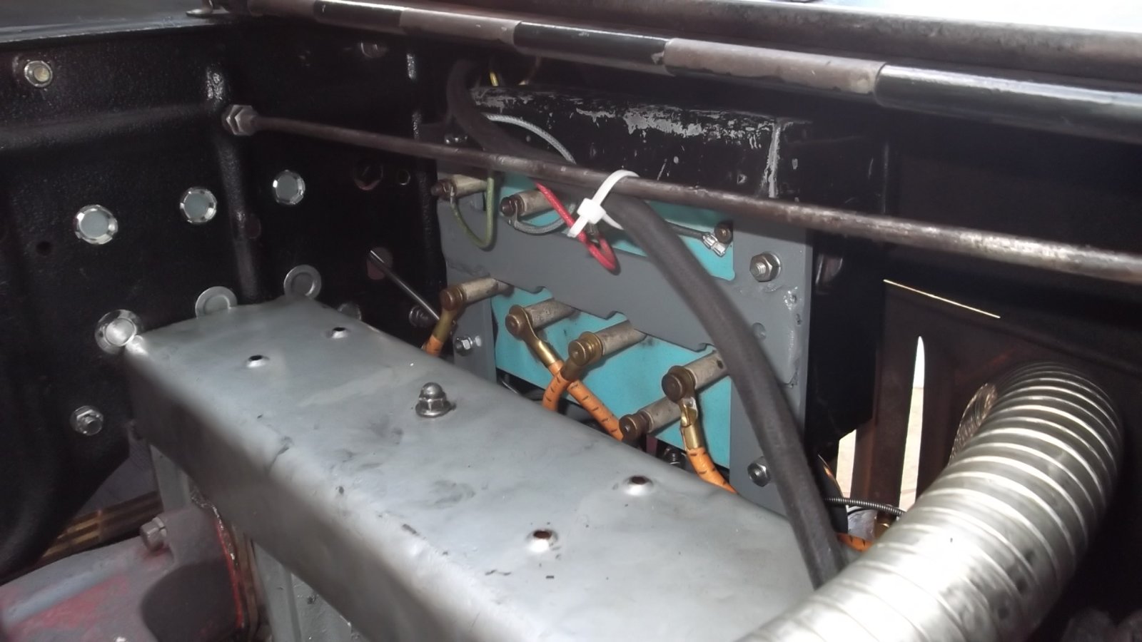

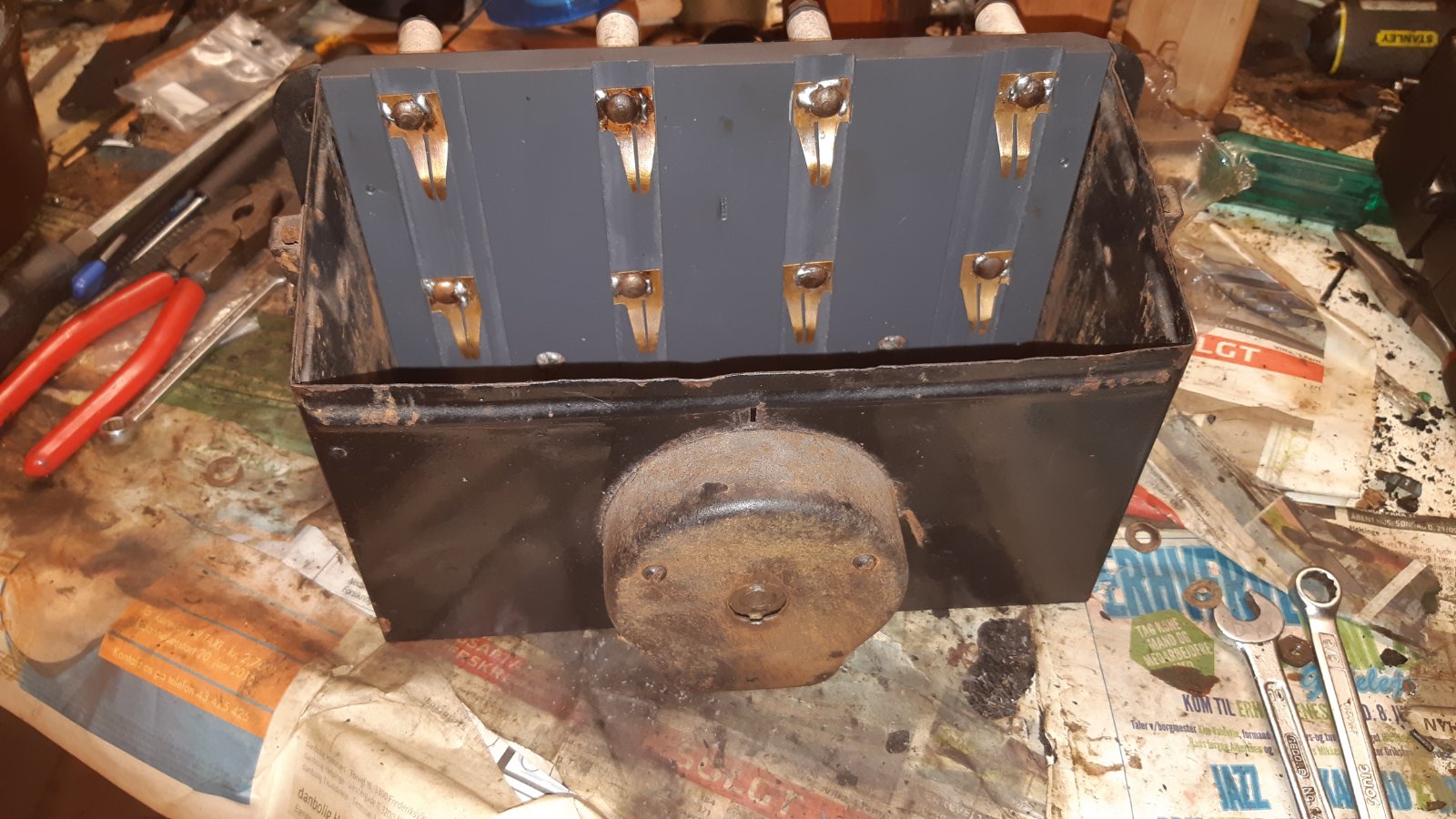

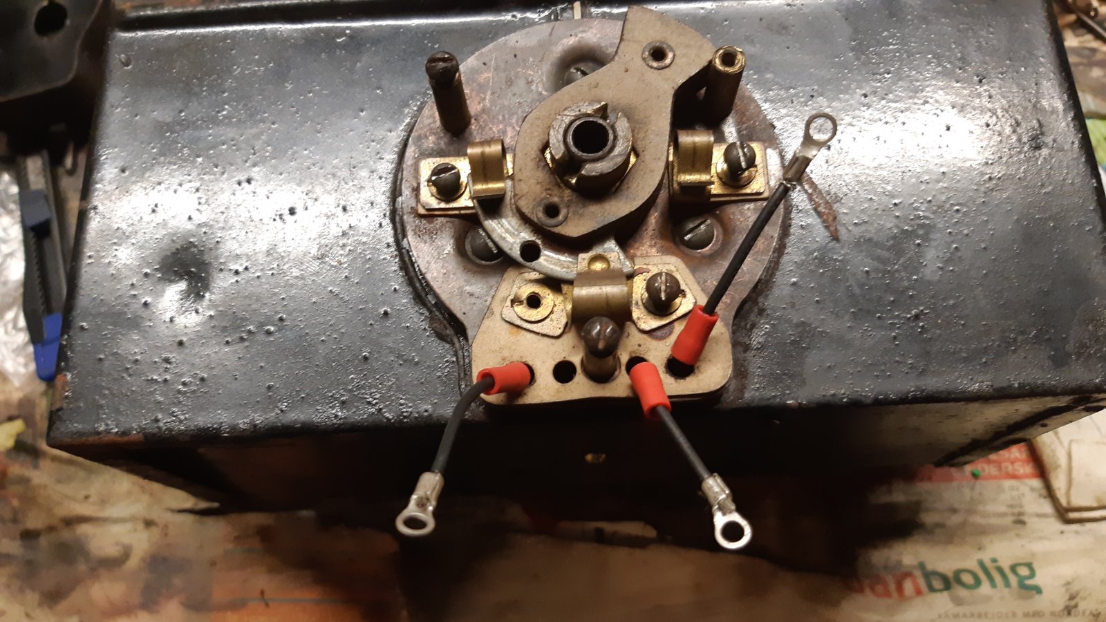

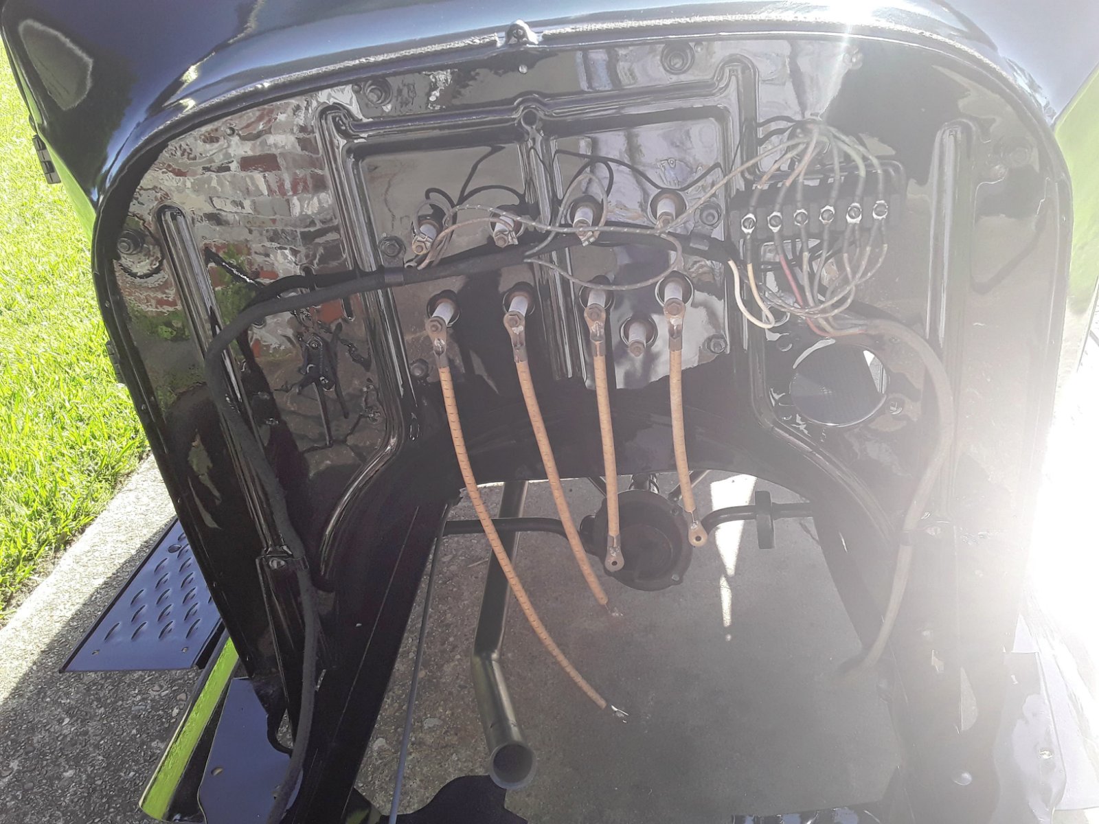

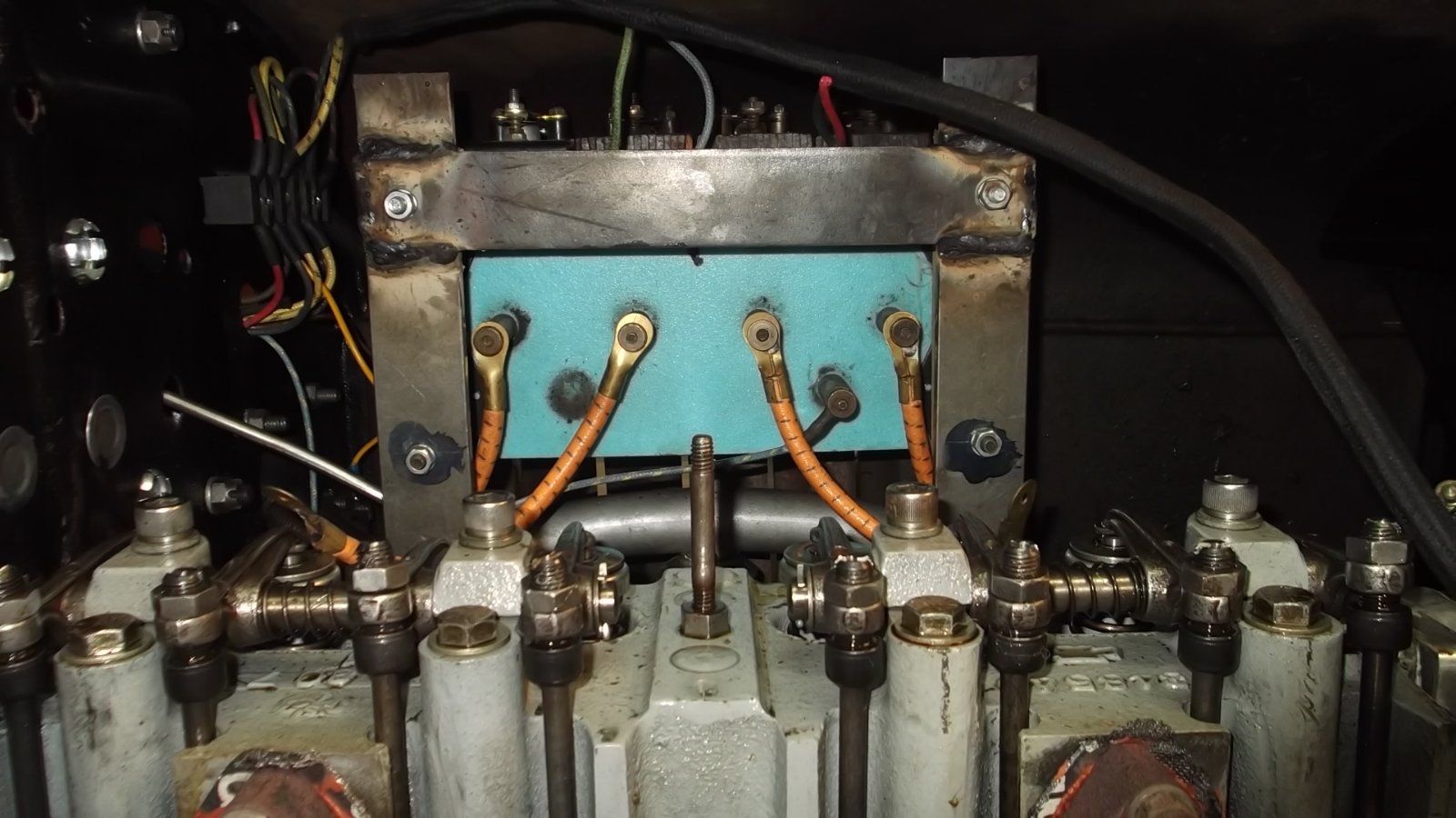

    All bolt soldered to the bronze springs.
    Terminals soldered to the leads
    Leads monted.
    All done.
    Ford Model T 1914 Touring
    dykker5502
    Posts: 487
    First Name: Michael
    Last Name: Deichmann
    Location: Rågeleje, Denmark
    Rebuild coilbox - result.
    Post by dykker5502 » Sat Aug 10, 2019 12:42 pm

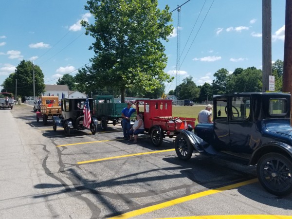

    Steam and gas show today. A buddy brought his 19 wood cab truck . A couple more buddys showed up with 21 DB coupe and 22 center door. Took a few photos and we headed to the next town for a parade about 10 miles away.
    The red truck behind my TT in the photo had twin flathead V-8 on the bed with a huge belt pully. It was a threshing truck in its day.
    Posts: 2832
    First Name: Dallas
    Last Name: Landers
    Location: N.E. Indiana
    Re: What have you done to your T in August
    Post by Dallas Landers » Sat Aug 10, 2019 4:26 pm
    A few more of the day!
    Ended up with 3 wood cab trucks in the parade.

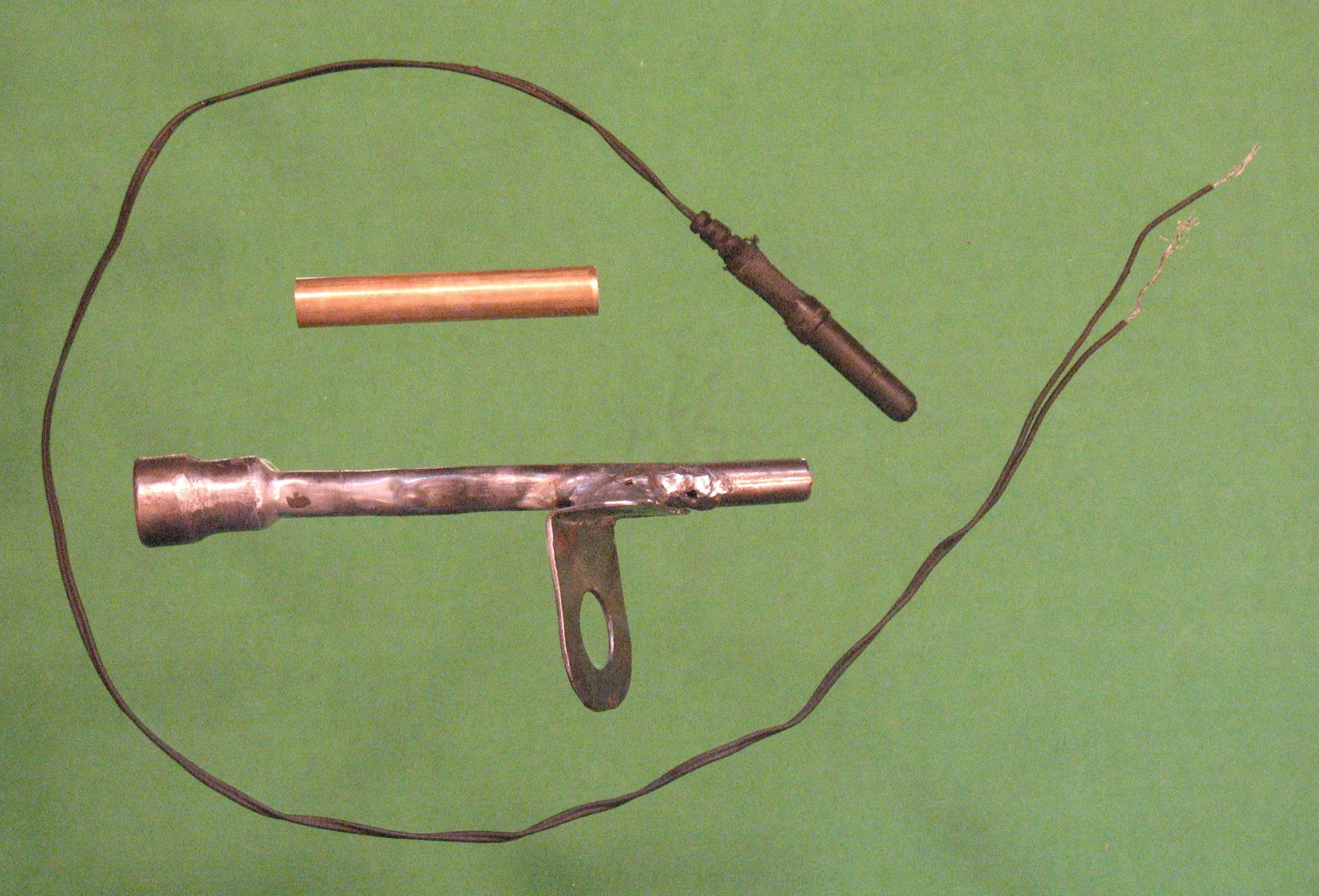

    I've been working on my 1915 runabout's bike speedometer. Bicycle speedometers work very well for Model T use, but the little wires can easily be damaged by road hazards. So I've taken to encasing the wires in protective coverings.
    The sensor fits into 3/8" steel tubing that protects the wires. The cover over the sensor is ¹³⁄₃₂" ID brass tubing (non-ferrous/non-magnetic).
    The tricky part was welding the tubing to the 18 gauge bracket without burning it full of holes.

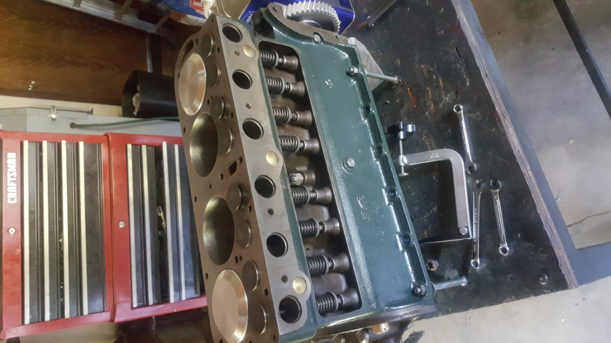

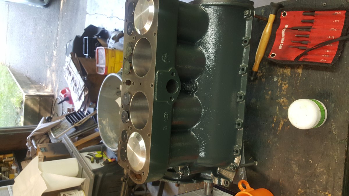

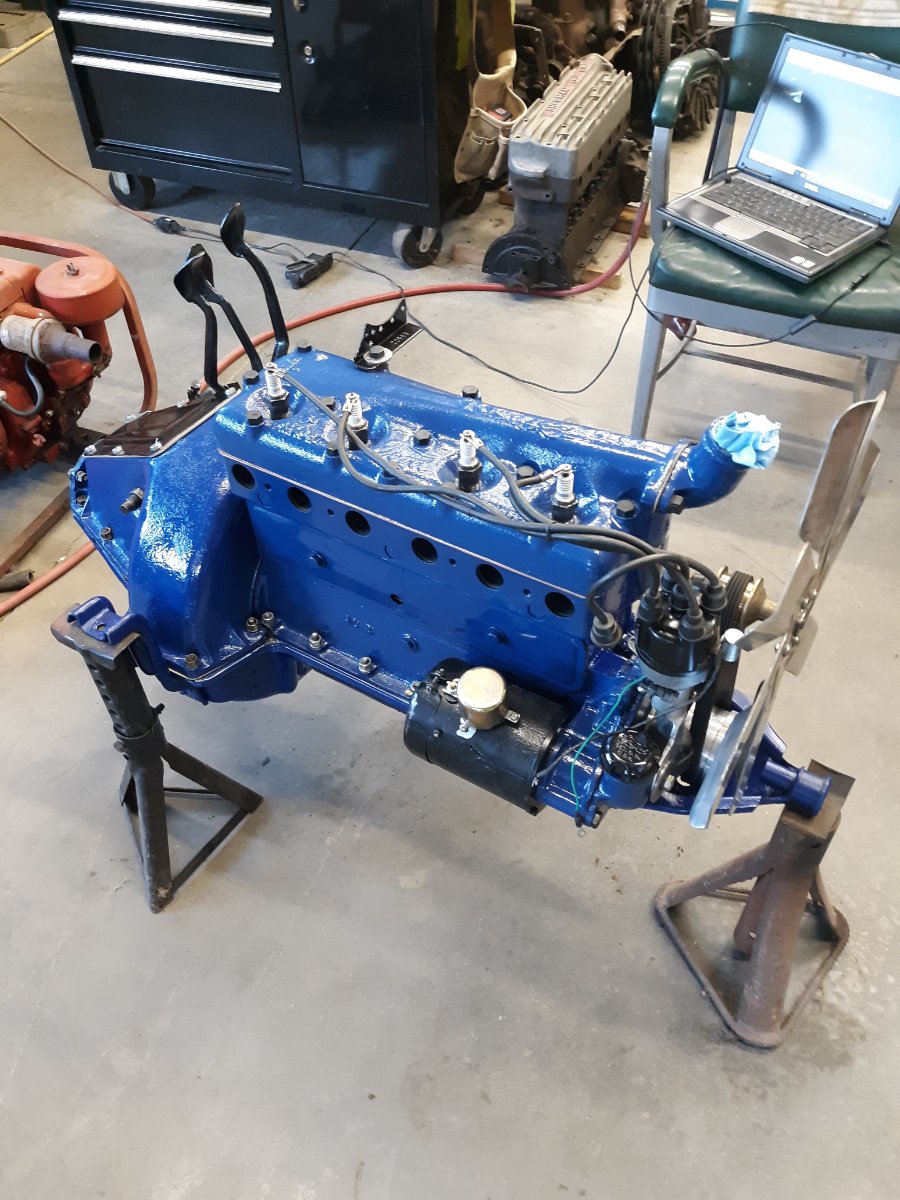

    Finished up the engine on the 2017 Roadster.

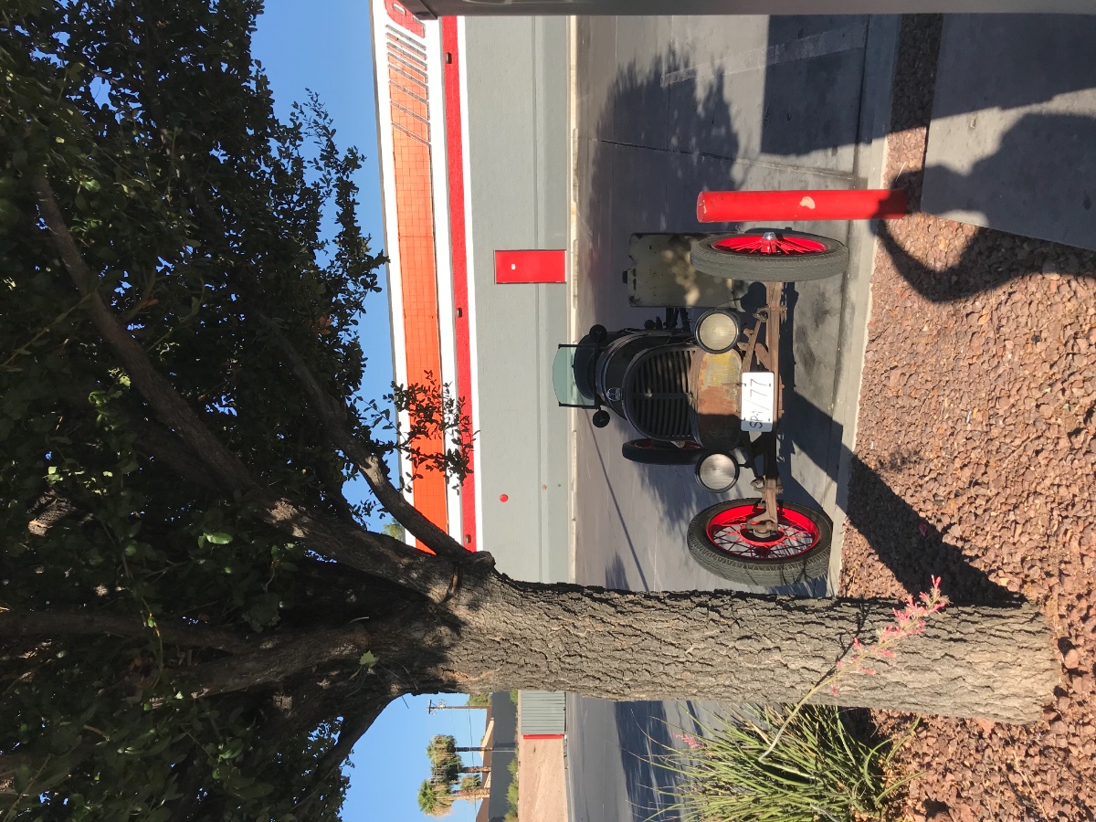

    Had to do a shade tree repair this morning :lol:
    Posts: 7372
    Post by Steve Jelf » Sat Aug 10, 2019 11:59 pm
    John, you might get more shade from that tree if you put it overhead.

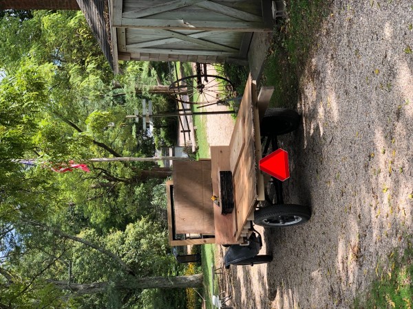

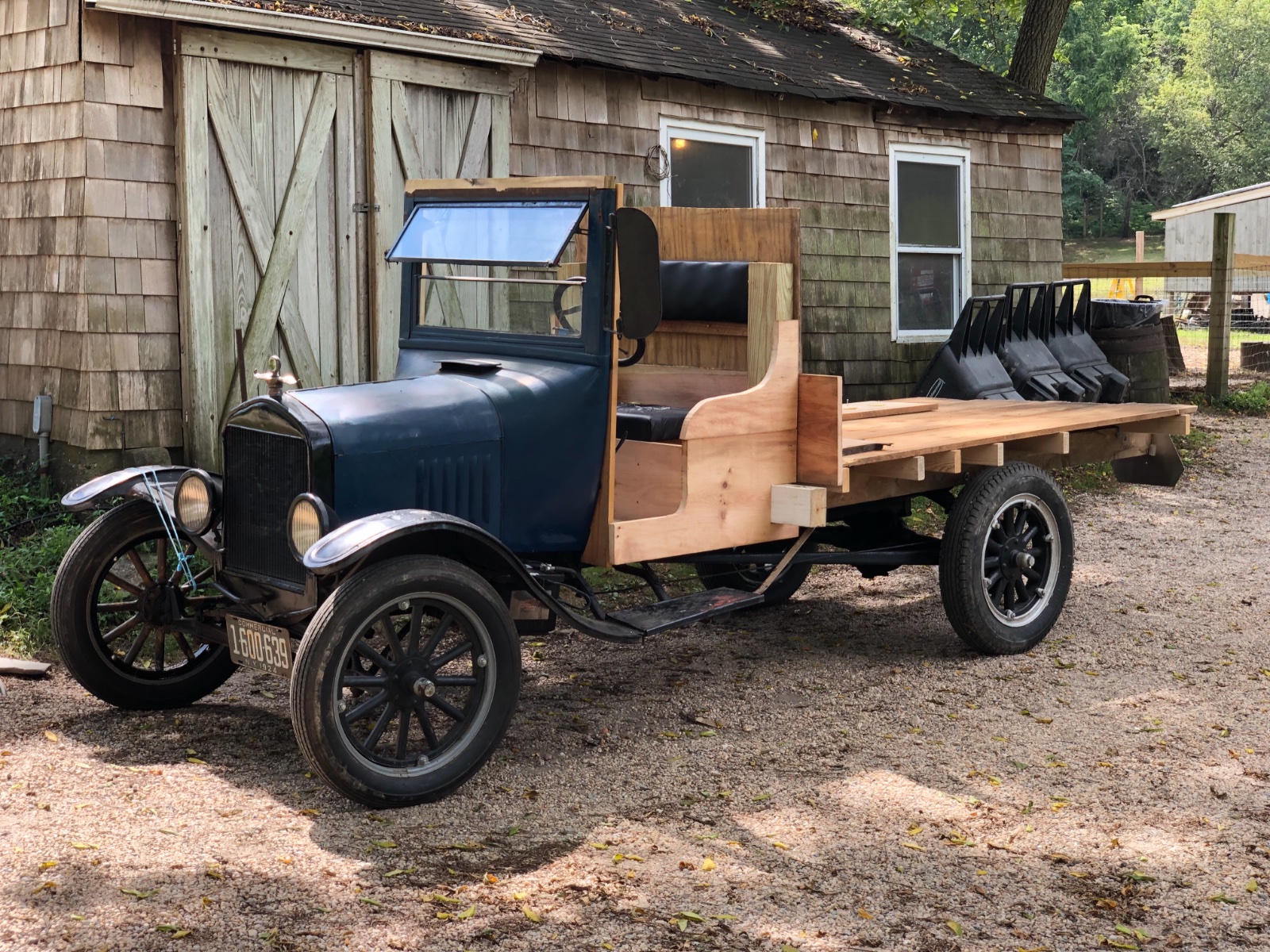

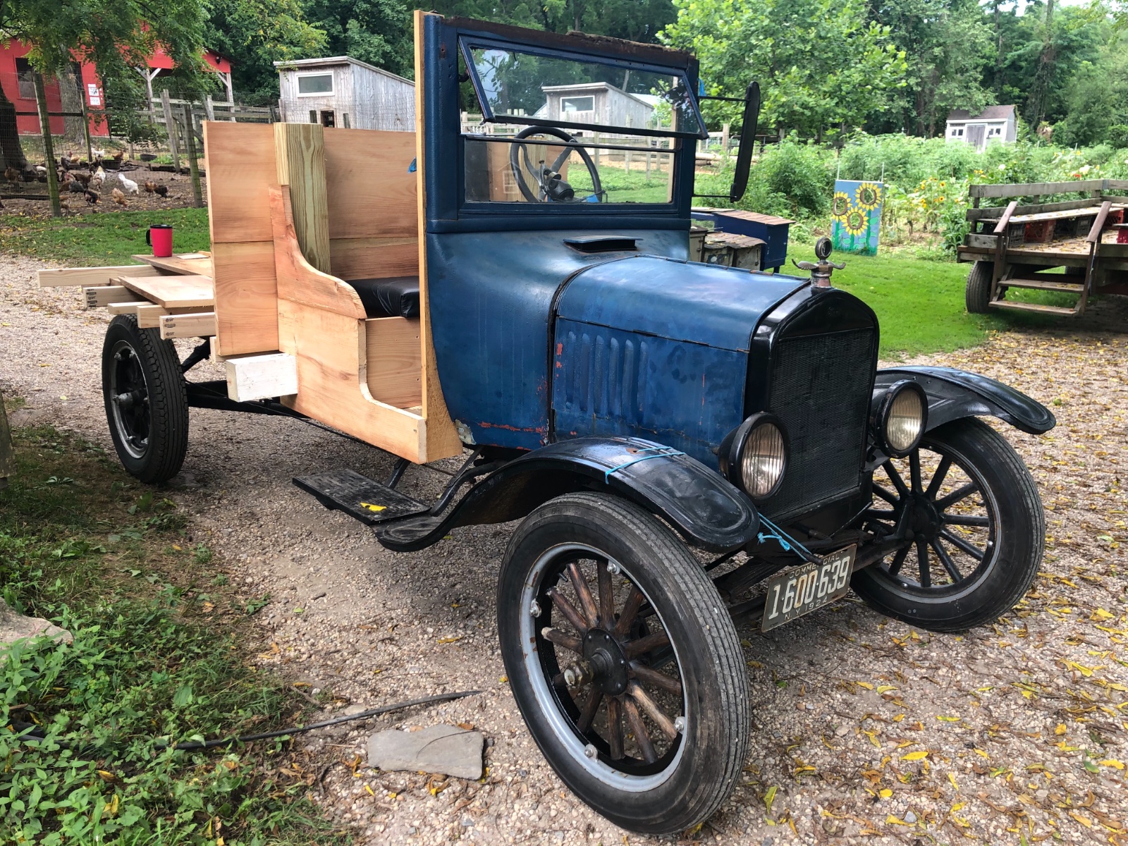

    Post by Bobbbenner » Sun Aug 11, 2019 8:25 am

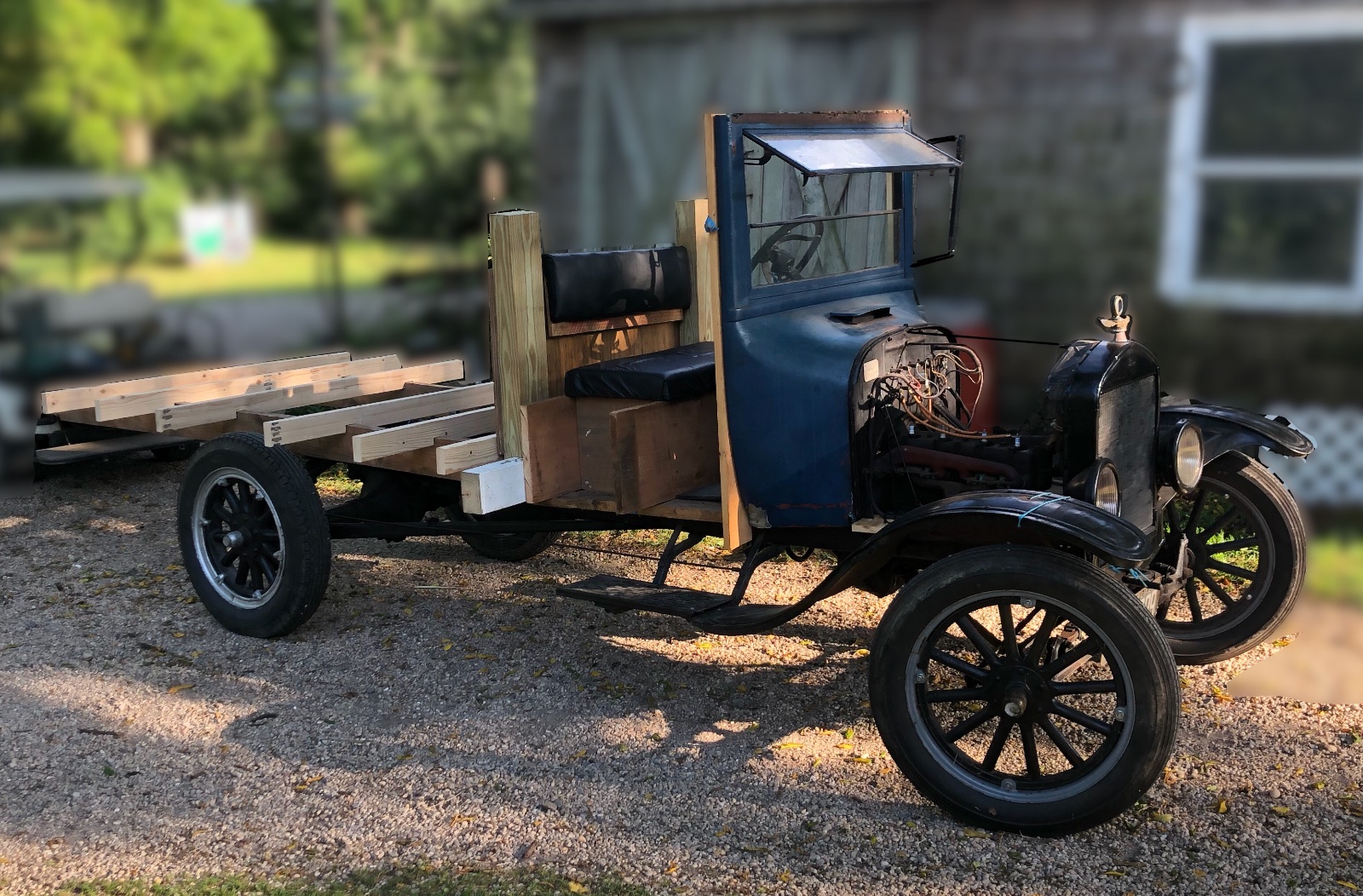

    She’s coming along. Grandson is coming to the farm this week, we’re going to attack the wheels!

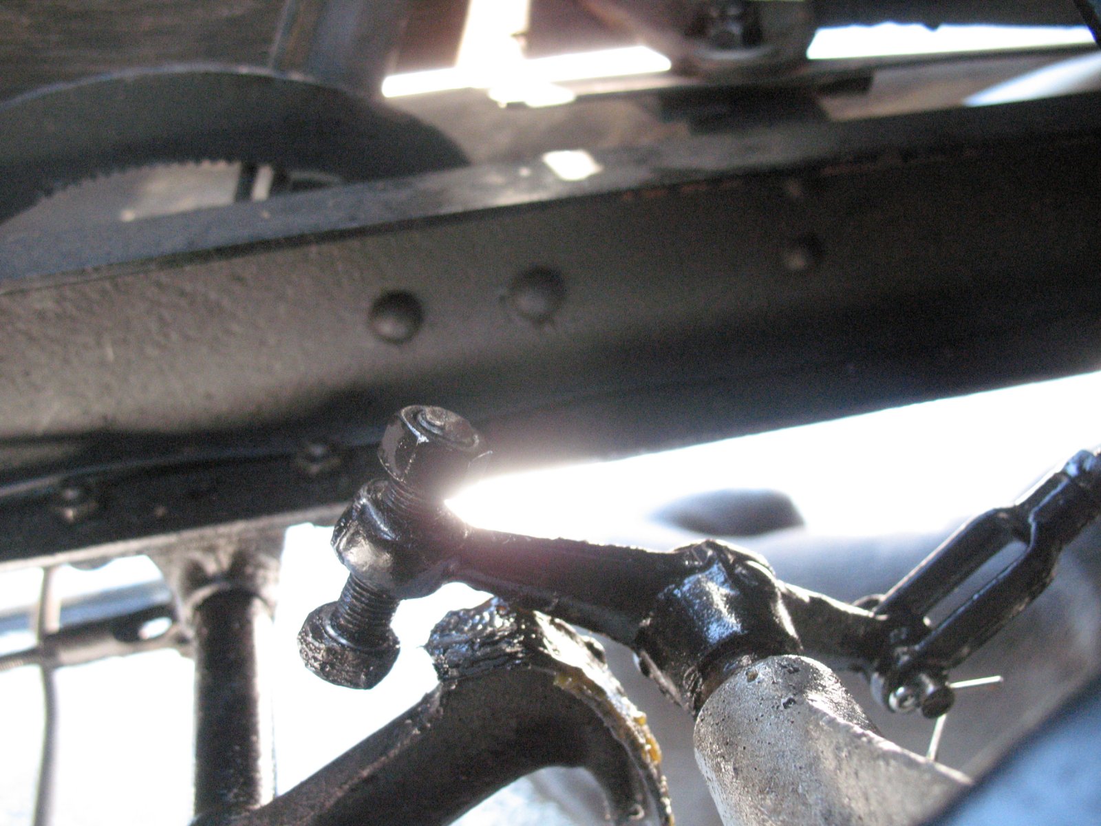

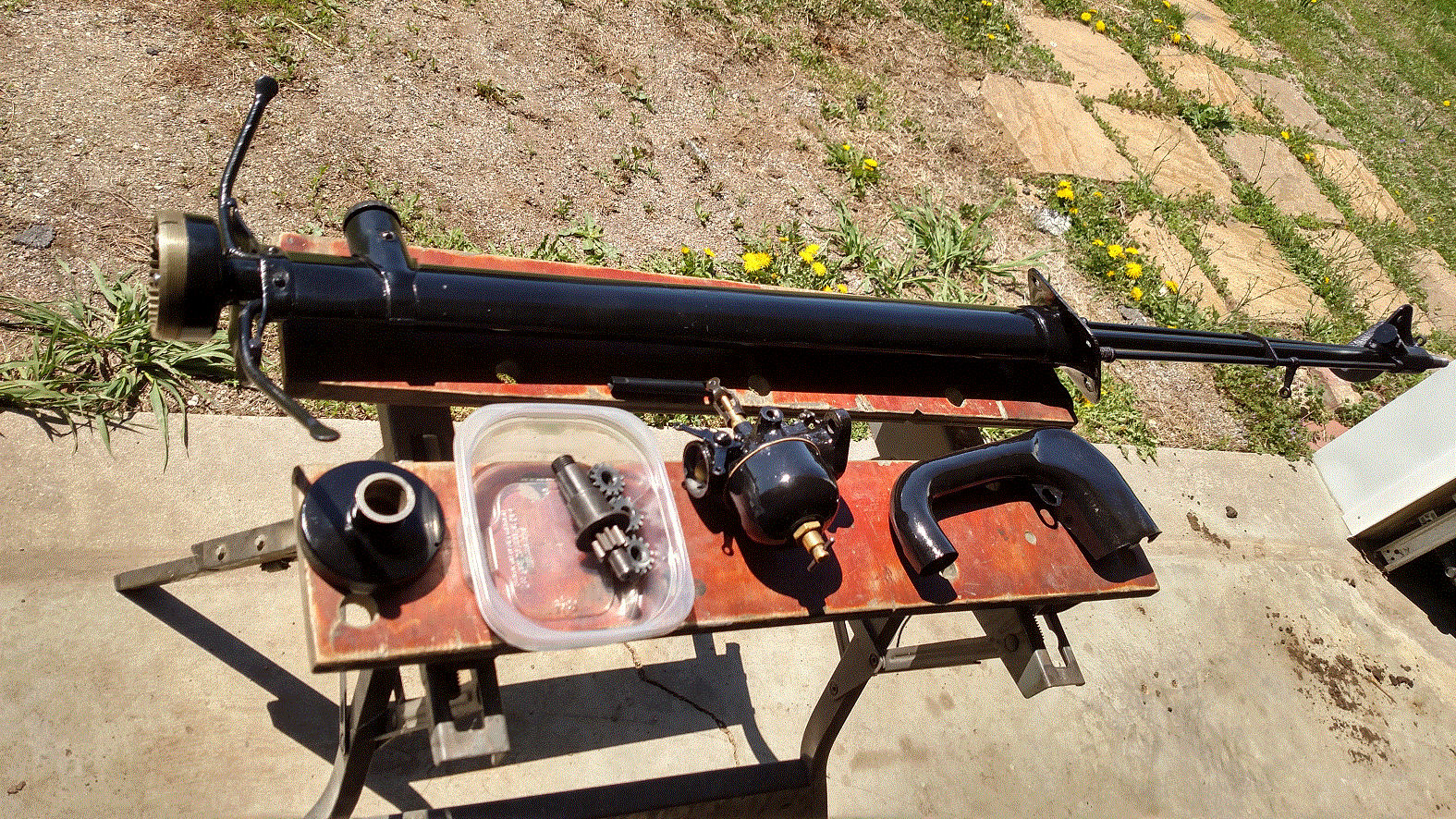

    I reinstalled my rebuilt steering column last week. I also installed the wood block behind the steering bracket, which my car lacked. There is no play in the steering wheel now. :)

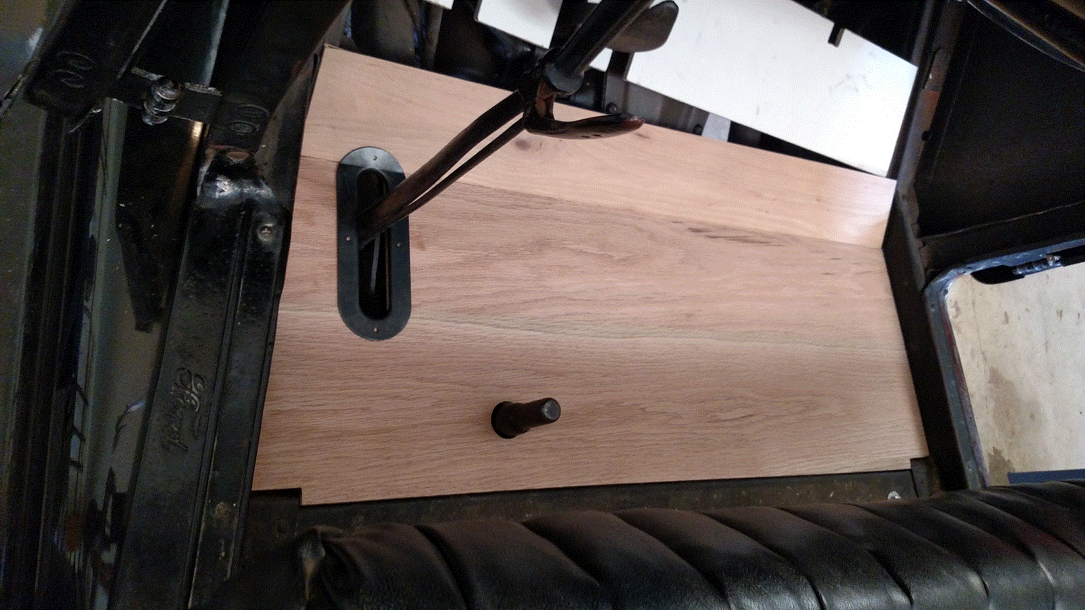

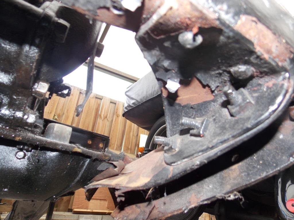

    I started making new floorboards yesterday. I made a lot of sawdust milling 4/4 lumber down to 9/16" thick. I think that the floorboards that came on my car were once someone's kitchen cabinets.
    My car did not have wood blocks between the pan ears and frame. There are indentations in the frame and left pan ear from the two being pounded together over the years. I installed the blocks over the weekend and bought the bolt kit for them from one of the vendors. The problem with the short bolts is that there is not enough space between the bolt and nut to allow inserting a cotter pin. I measured a maximum material allowance of .234". But, my frame measured .190" and the pan ears are .120". That means I need another .076" to install a cotter pin. There wasn't enough length in the bolt to drill a new hole so I used lock washers. The description on Lang's website (not who I purchased from) said the bolts should be 7/8" long. Those I bought are shorter than 3/4". Clearly, I received out-of spec bolts. I will address the situation again when I pull the engine for a rebuild. For now, it works but I'm not happy with the wonky bolts. Has anyone else had this problem?

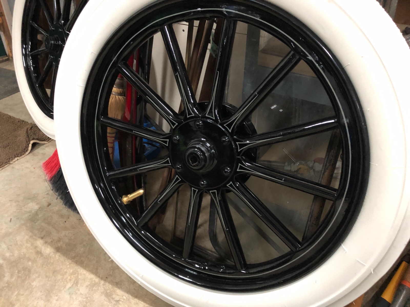

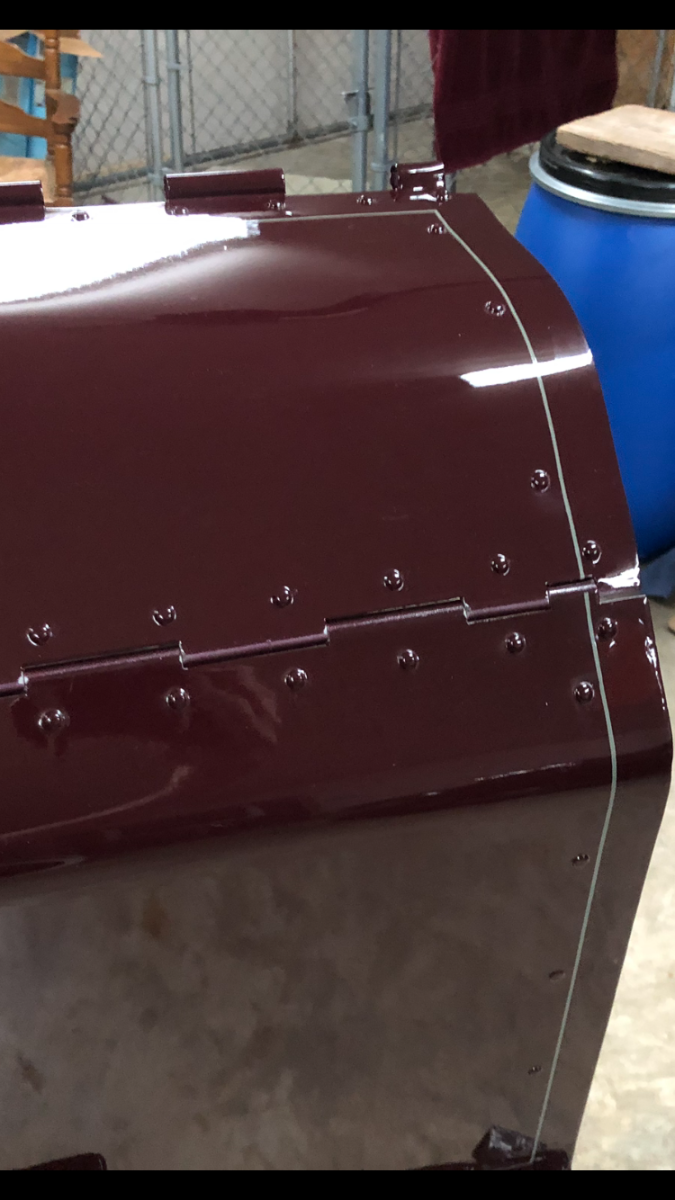

    Jim Brand came by and pinstriped my 11 Touring and my 31 Victoria yesterday. I went with the “ no boxes on hood” look. Art

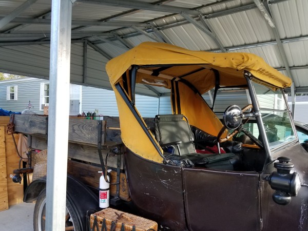

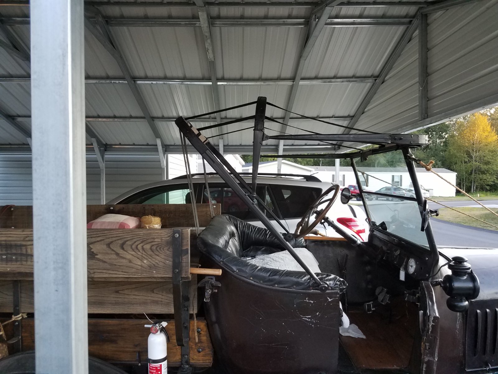

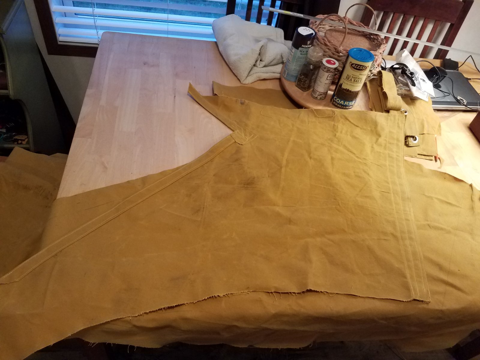

    Today it's nice and warm, in the 80s and I'm taking a break from my top bow project (you may have heard) to replace two front tires, flaps and tubes. The two rears were done earlier this year. I originally purchased all four Riverside tires and tubes from the Montgomery Wards catalog and picked them up myself at the Oakland, CA warehouse. That was 1971. $300 for all. Well, at least that's what I borrowed from my Grandmother to get them. Yes, I paid her back in full within three months along with free lifetime rides. She loved the ice cream runs and I have the VHS tapes to prove it. Anyway, they're almost 50 years old and while I added another 600 miles to them early this summer, their time has come. I realize I'm trading USA tires for Vietnamese but it will happen sooner or later and I'd rather take care of it here at my garage.

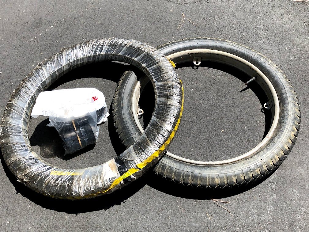

    ...they're almost 50 years old and while I added another 600 miles to them early this summer, their time has come.
    Yes, they should go. Whenever the subject of tire replacement comes up we hear from people who have been running on the same tires since 1958 or whatever without trouble. But the fact remains that rubber does deteriorate with age, and running on ancient tires is running on borrowed time, no matter how good they look. I agree it's better to change them at home than out on the road.

    New exhaust manifold and some exhaust wrap to help keep the cab a bit cooler.

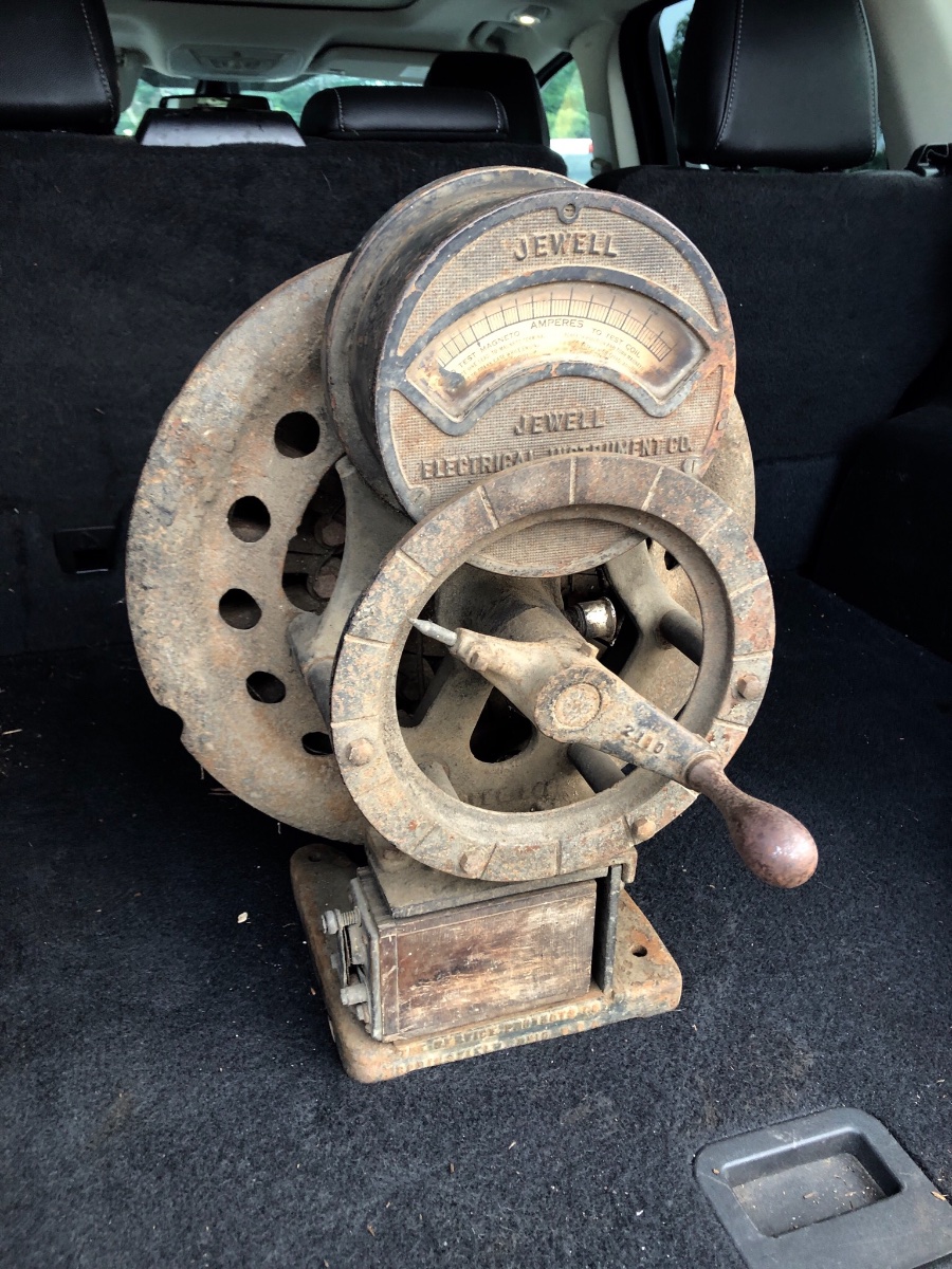

    I used Murray Fahnestock’s method of recharging the magnets in my magneto (pp. 235 to 240 in the compilation of articles titled”The Model T Ford Owner”). My ECCT shows the output raised from an inadequate 14 volts to over 30 volts at 1200 rpm. I’m super pleased with the results.

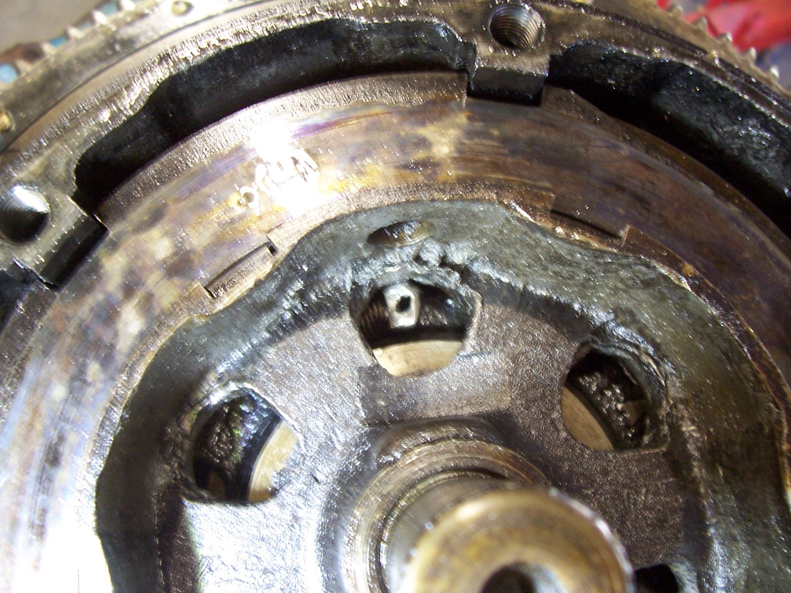

    After spending most of yesterday and today cleaning up and putting things away so I could get the runabout out of the shop, Shorty and I went to town for some shopping.
    Actually she didn't buy anything. All she cared about was getting a ride. Last week I ran the fresh engine to cure the manifold paint, but this was the first time since last year the car has moved under its own power.
    That distinctive noise and the sudden lack of power told me to look under the hood. I was expecting just a loose plug, but it was beyond loose. Fortunately I carry spare plugs.

    Finished cleaning up the valve seats and ground the valves. Got the bend in the crank to .0005". Waiting for gaskets and paint.

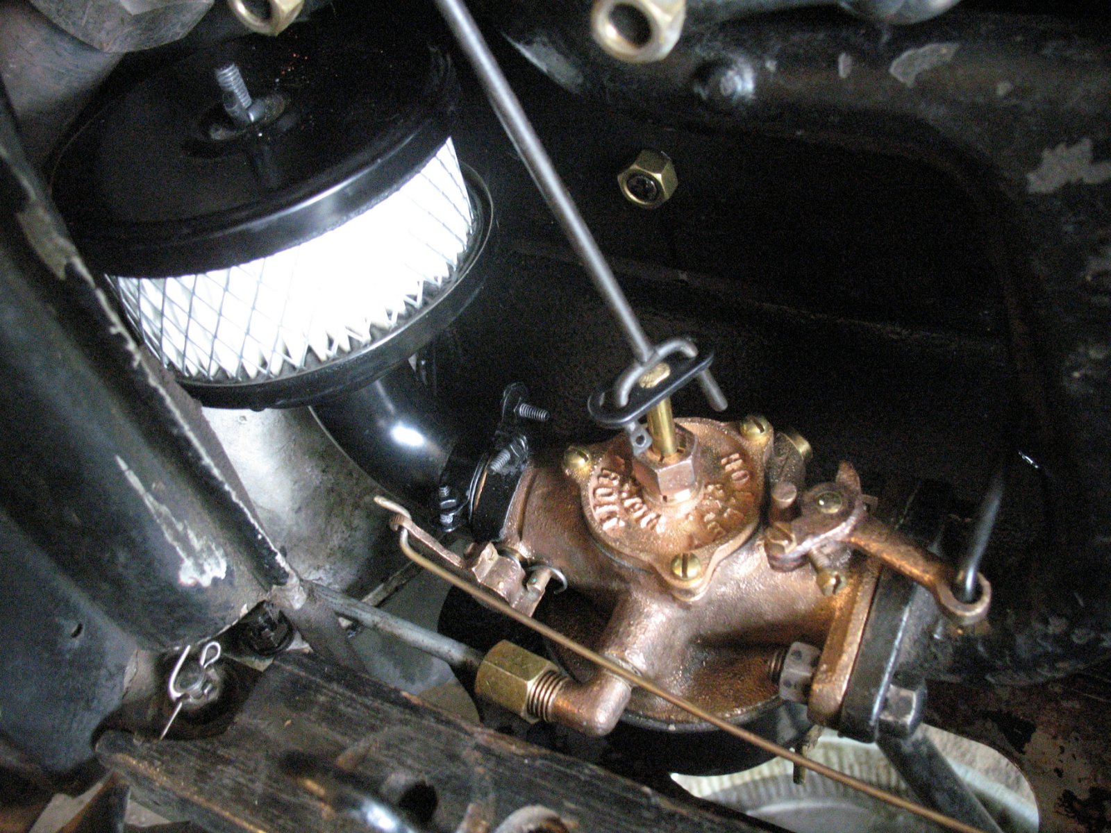

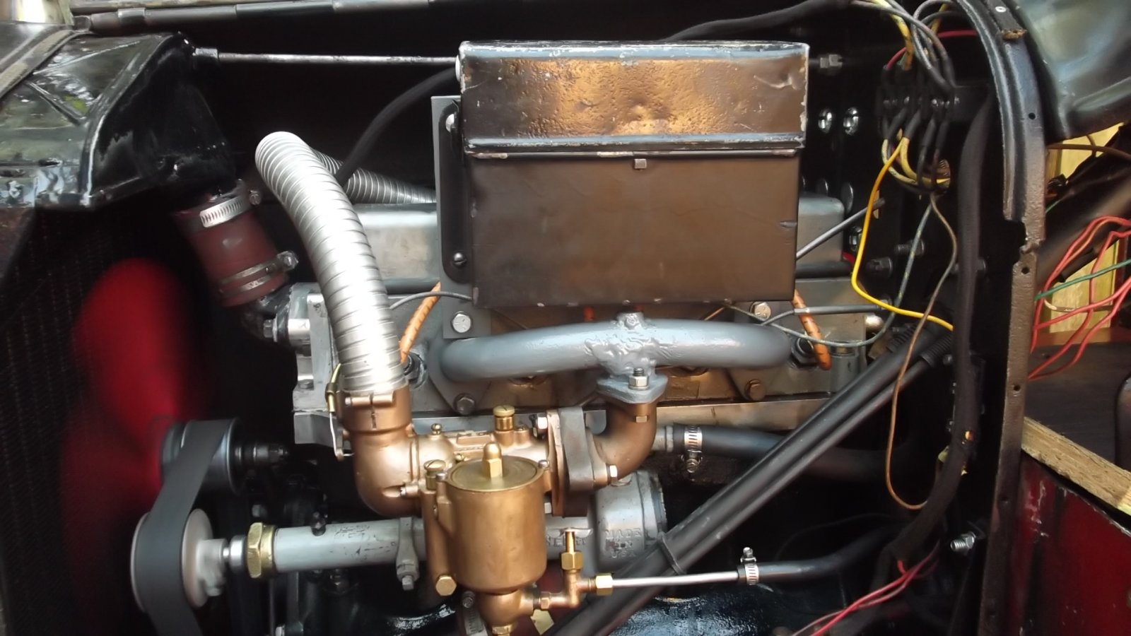

    I've been running a Holley NH on the 1915 runabout. This morning I removed it and put on the stock Model G. Then I drove to Winfield for banking, a round trip of about 37 miles.
    Coming home I couldn't pull the hand lever back for neutral and had to use the pedal. In the parking lot at the farm supply I took out the floor boards and found this. Apparently I forgot to lock down the lock nut.

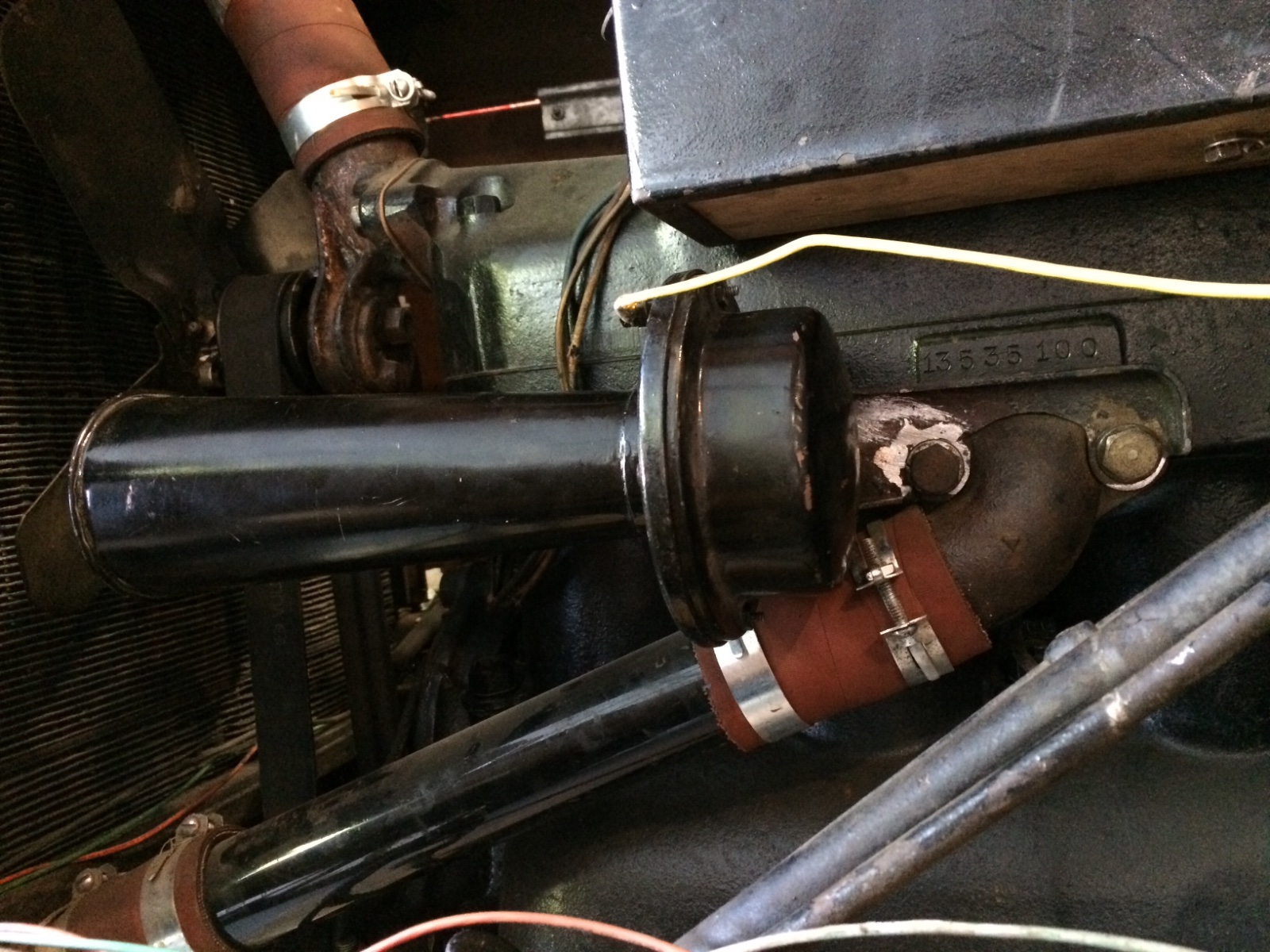

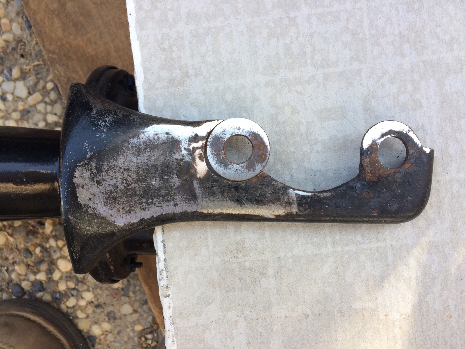

    This Spring in Bakersfield I bought a horn. The front hole on the bracket was torn out and someone had braised it. I should’ve got a picture of it before I started. But here are the progress photos:
    As you can see I used a washer to add a eye. I can ground and file the world smooth. But the photos I took of that were too blurry.

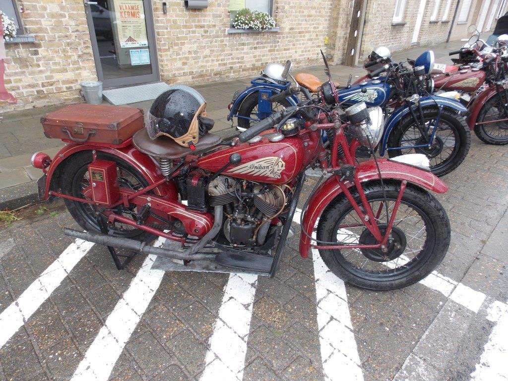

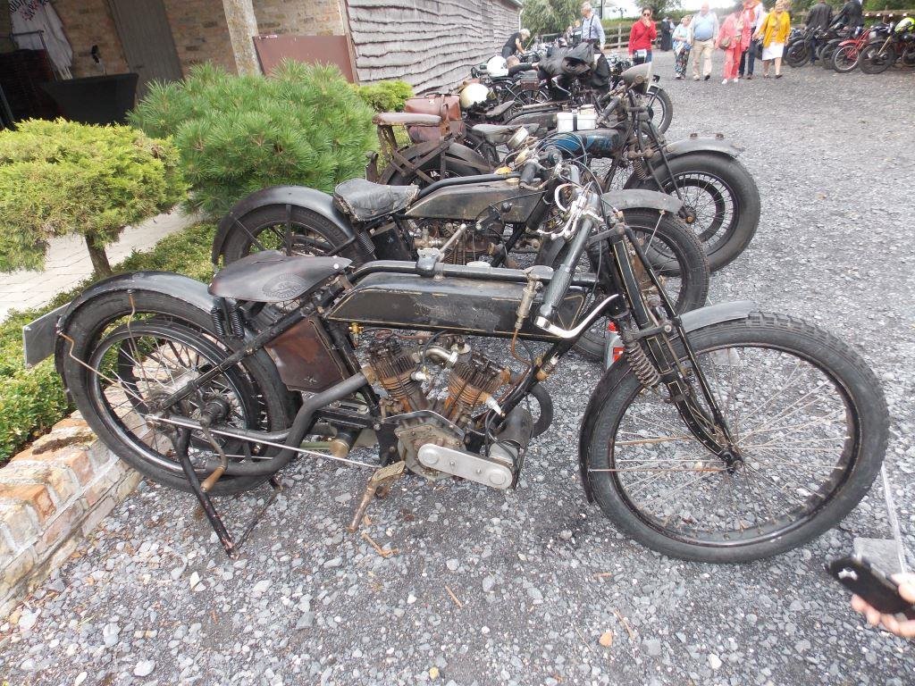

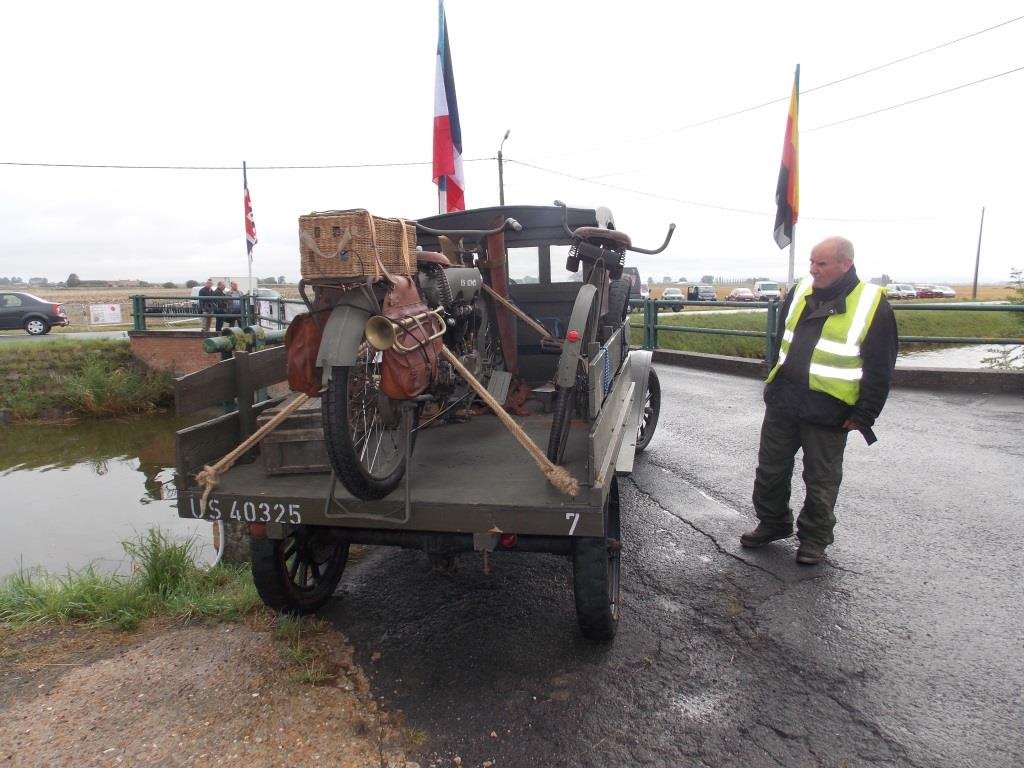

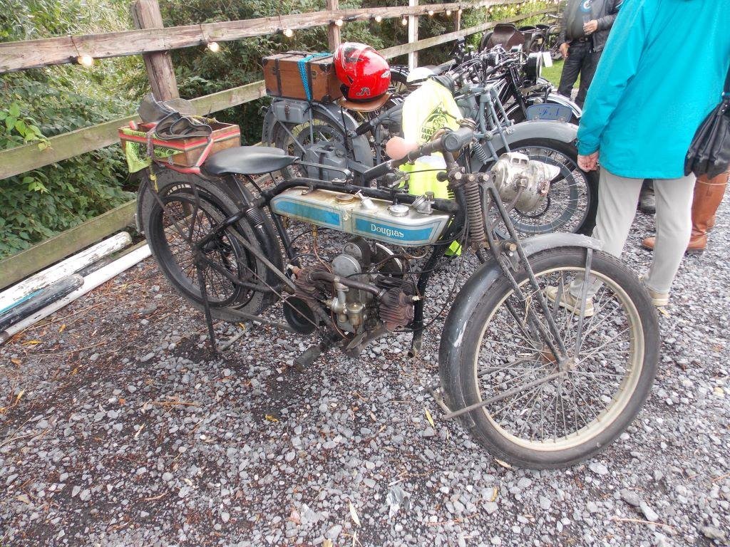

    Yesterday,
    It was a rainy day but we took T out to look for Anna.
    "Where is Anna" is a remember drive for a lady, Anna, working as a nurse during the First World War near to Diksmuide en Veurne in the Flanders Fields.
    A few cars but most of drivers were on Motorcycles all older as 1931.
    The oldest was a 1900 De Dions-Button tricycle.
    Photos in attachment, just enjoy.
    Andre (whit gas this times)

    Post by Bobbbenner » Tue Aug 20, 2019 8:50 am
    Literally piece by piece!

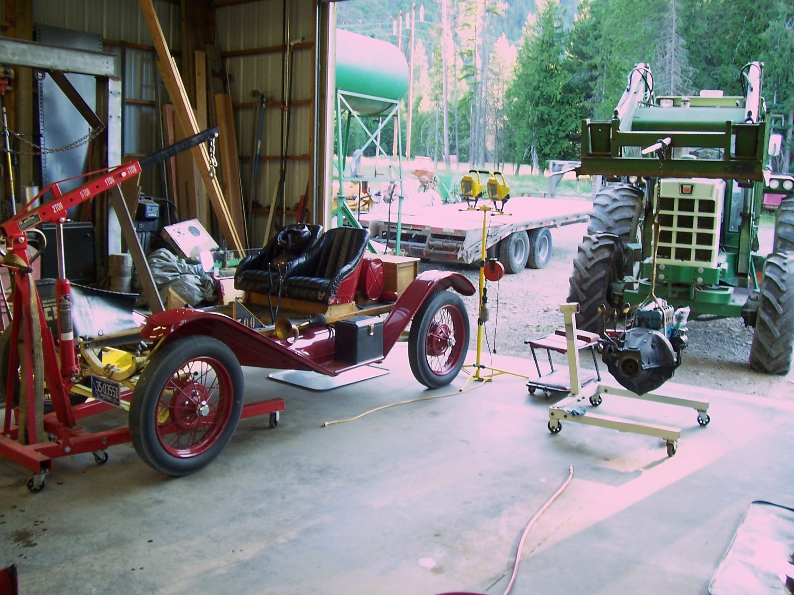

    Started assembling the speedster motor yesterday. Hope to be back on the road soon.

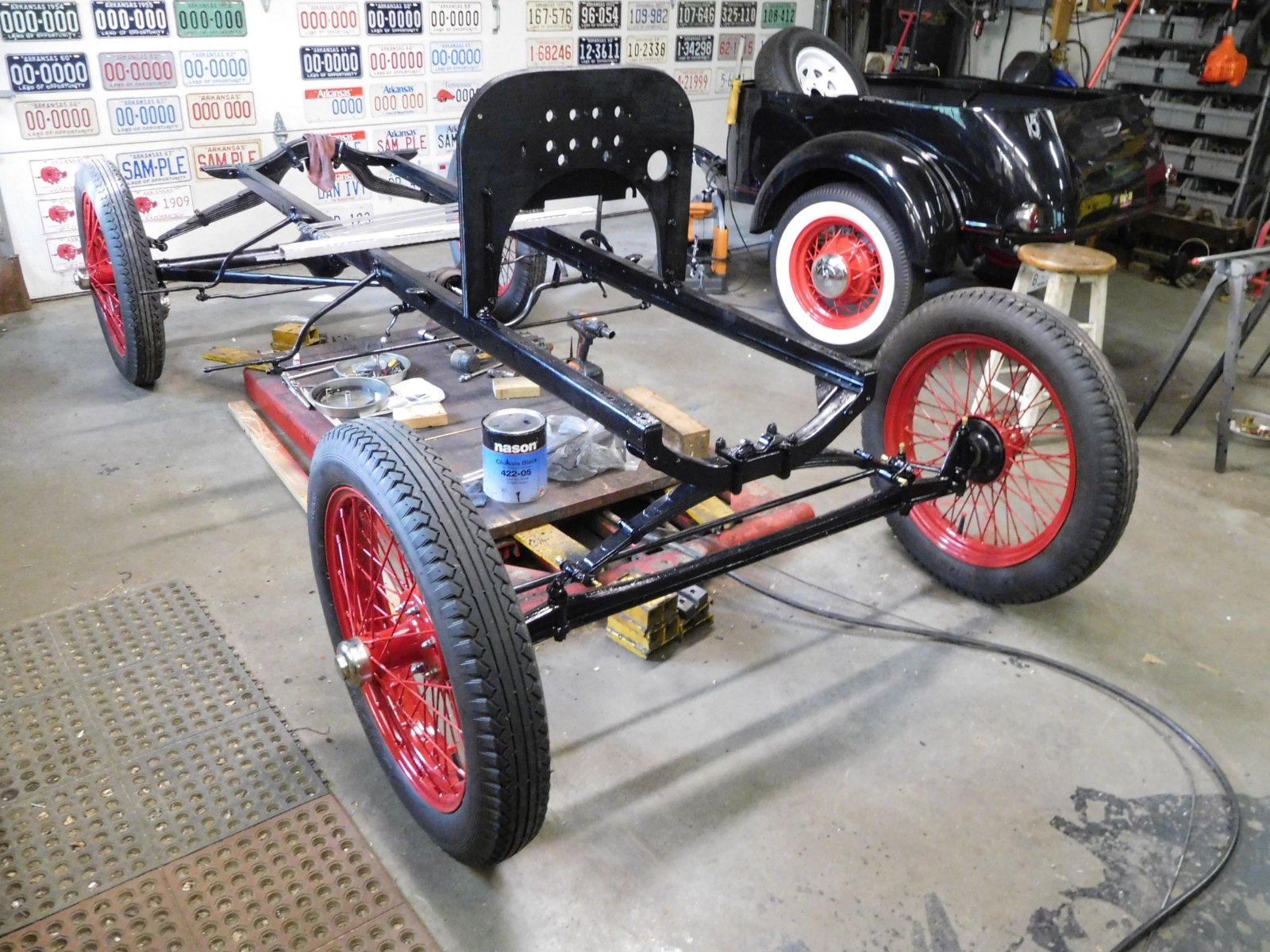

    Today I got the chassis for my "new" T standing on its own 4 feet for the first time.
    I always feel that this is the first major plateau when building a car from scratch. The next major step is getting the engine in and running, and the next is the first drive. There are lots of smiles at each level. :)

    Thanks Andre, great photos of the old bikes. Thanks jw

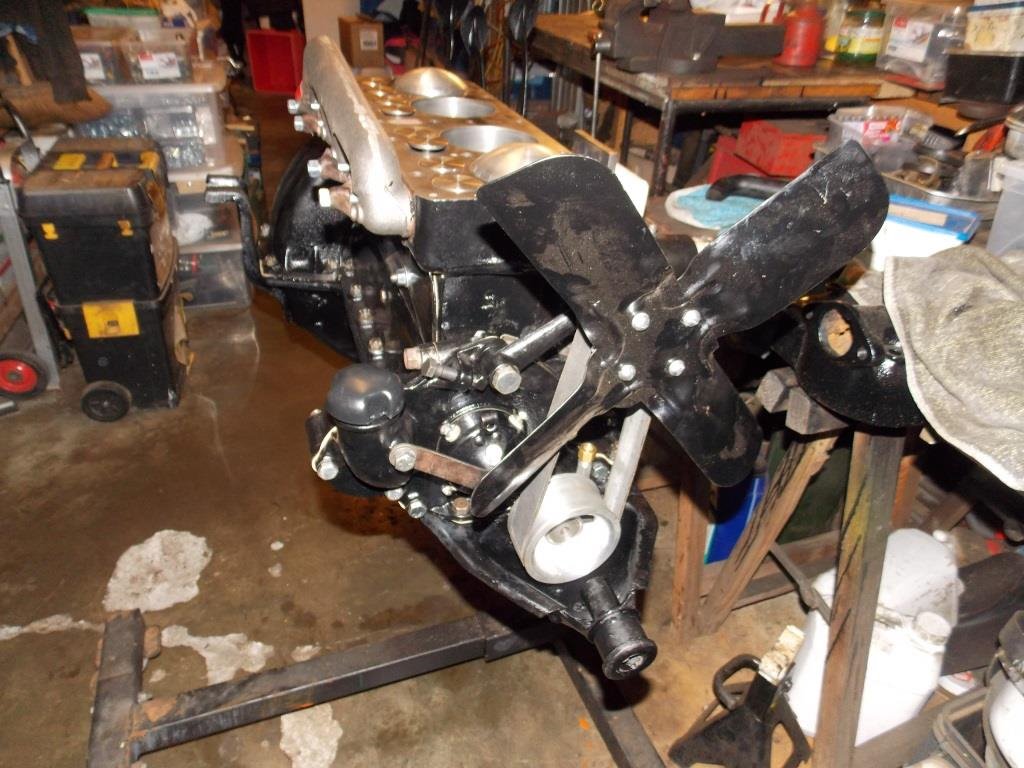

    Got the speedster motor finished tonight. Ready to set in the car.

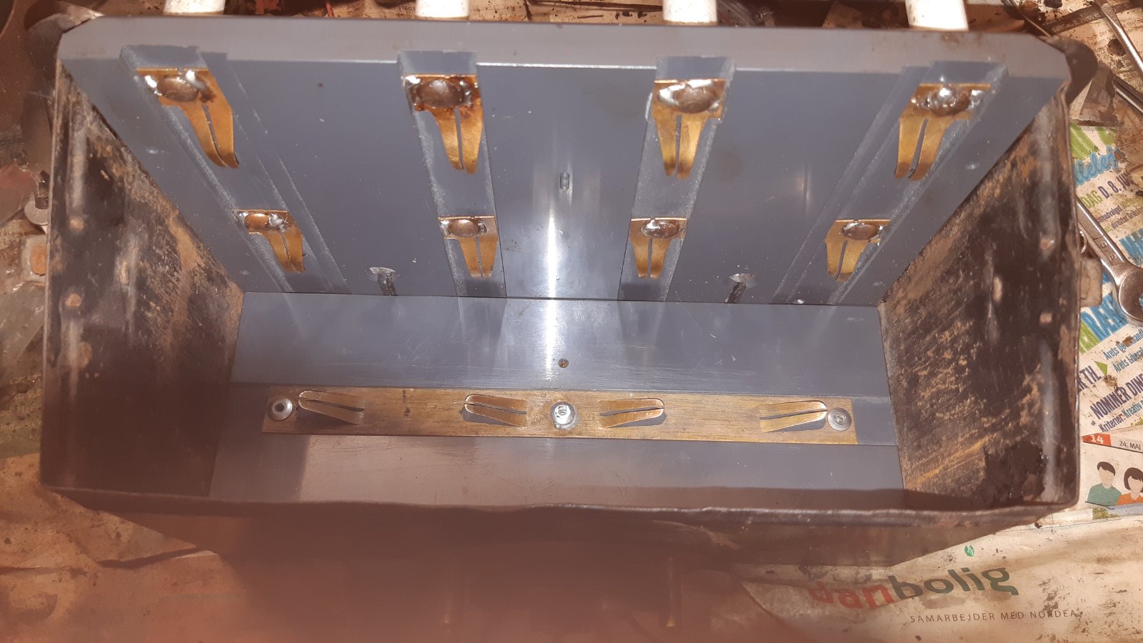

    Post by Mark Osterman » Wed Aug 28, 2019 7:41 am
    Bought this unrestored hand crank coil tester in Buffalo a few weeks back. Removed the black overpainting to get down to the original blue hue. I removed all the magnets to clean the flywheel and recharge the magnets. Also had to take the Jewel ammeter apart and reset the main pivot shaft to get it working. Just need to replace the four insulated spacers and rebuild the coil receiving box to get it up and going.

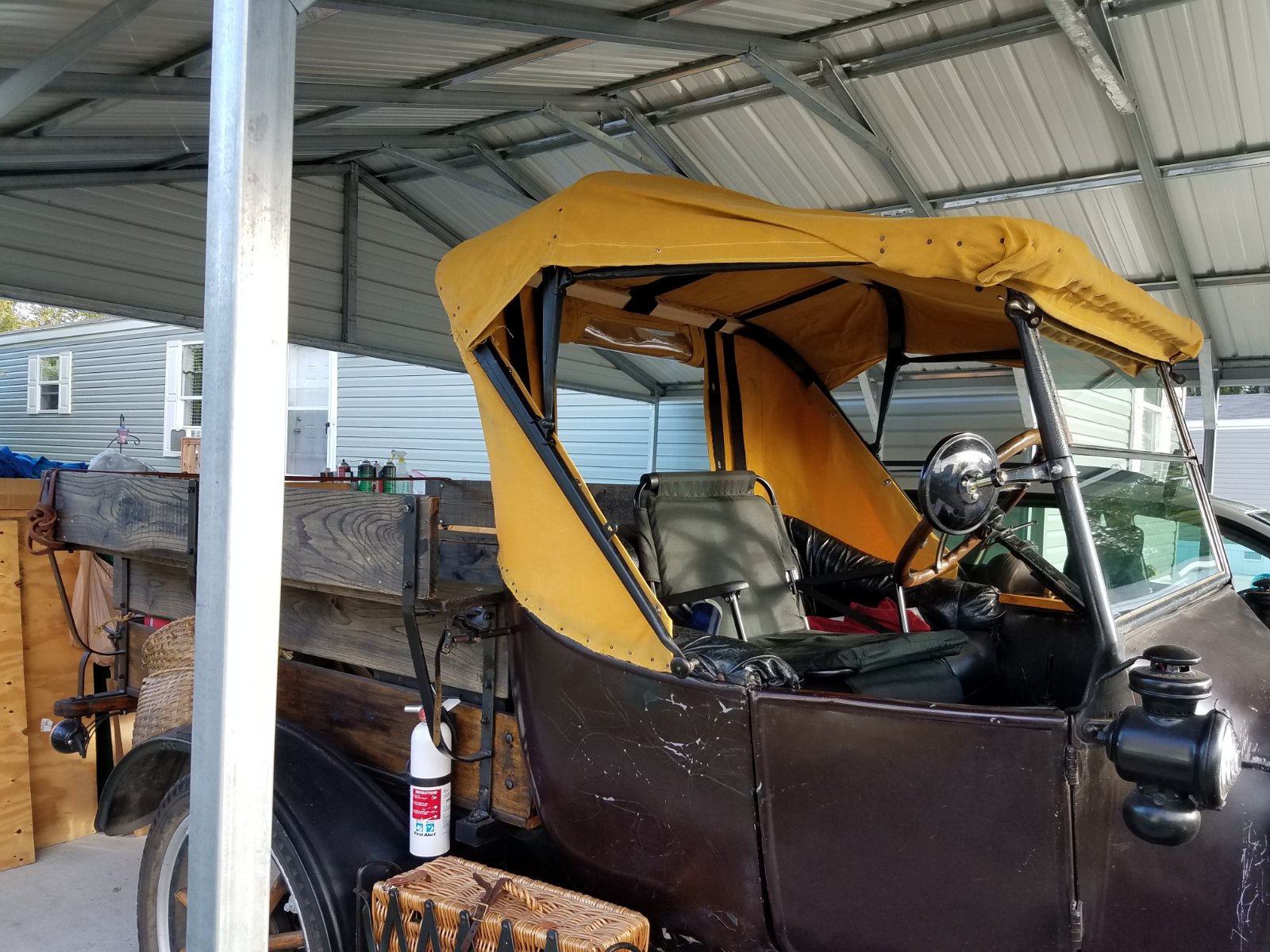

    Post by dhosh » Thu Aug 29, 2019 8:44 pm
    Building a new top out of a Tractor Supply tarp...

    Hitting the like button on the top! :idea:

    Looking good Dennis! If it rains at OCF you will be good to go?

    kelly mt
    Posts: 269
    Last Name: Kelly
    Location: Noxon MT
    Post by kelly mt » Sat Aug 31, 2019 11:17 am
    John, yes it's quite a fan. That thing moves a lot of air. New car so I'm not sure I need all that fan yet.

    Post by dhosh » Sun Sep 01, 2019 8:55 pm
    Well, I didn't finish until today, but did most of the work in August... Does that count? :-). I replace mybincirrect irons and bows (fmcut down from a touring), with more appropriate ones, and fashioned a top from a Tractor Supply tarp. I don't know how long it will last, but functionally, it's a WHOLE lot better, although it won't win any awards (except maybe a Rube Goldberg...)

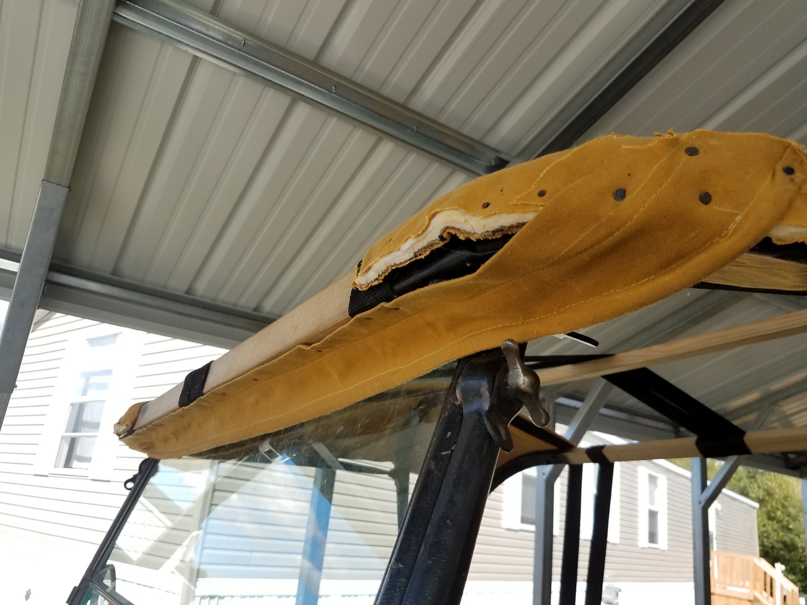

    Post by dhosh » Sun Sep 01, 2019 8:59 pm
    Still need to add trim to cover the tacks. Might have to make my own hidem.... Might use strips of leather.
    Also, seen in the pickup bed... I sent a front wheel to Noah Stutzman, and it came back beautiful!! Knocked out the old bearing races. Now.... Where did I put the new outer bearings and race? I have 2 sets of inners.... Hmmmmm.....

    Post by dhosh » Sun Sep 01, 2019 10:10 pm
    Dallas... I'll be ready now! :-). .
    I kind of wonder how much bleeding I'll get from the tarp. The waterproofing is a tad sticky, and clothes get a but yellow, working with it.

    Dennis, if it rains and it bleeds, you can have a nice tan :D

    Post by Bobbbenner » Mon Sep 02, 2019 7:16 am
    Each day a little closer.

    Post by Mark Gregush » Mon Sep 02, 2019 10:55 am
    Made the bracket to mount coil box under the hood on the 21 with the Chevrolet over head. The first try put the box too far out and up.
    After re-drilling the mounting holes 2ed try that now fits. In order to change spark plugs will have to pull the box off the frame.
    After the 2ed try, found the choke wire was shorting out # 2 plug so moved it and engine settled down now I am a happy camper;
    Now I have to recharge the magnets. They are dead dead! I have 10-11 days till our clubs next tour to get it done. If I have to pull the hogs head to get things lined up to use the KR Wilson charger I am going to put a wood band in for low or brake (I only have one, so have not decided). It runs fine up to a point on 6 volts but upper cruising speed not so much. Failing to get the magnets recharged, I am going to add a 12 volt battery just to power the coils for it and the next tour. Right now I can't get any N/S reading thru the hogs head.
