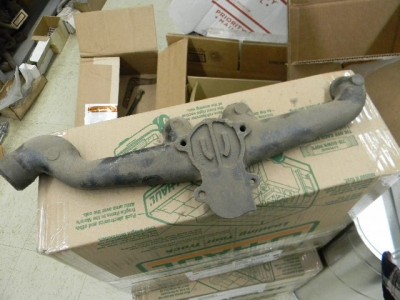

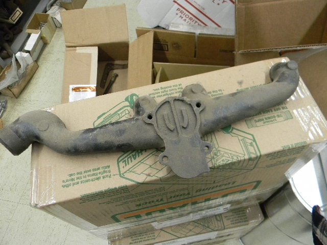

Post by FATMAN » Mon Jan 21, 2019 11:16 am

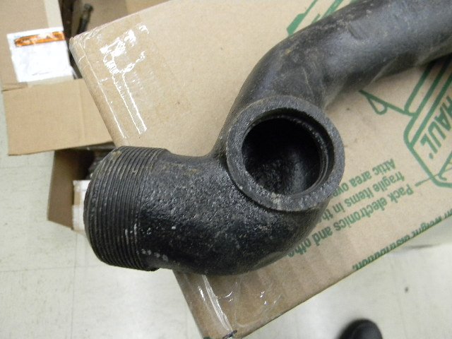

looks close to Model T but never seen one like this could it be Metz or star ?? any ideas, Bob
thank you forum

Re: Wierd exhaust manifold Ford or what??
Post by Jim Sims » Mon Jan 21, 2019 11:27 am
Just the exhaust manifold from a vaporizer carb assembly . Common for 1927 Model T Ford
Post by FATMAN » Mon Jan 21, 2019 11:41 am
not vaporizer no opening in back, Bob
Post by John bevardos » Mon Jan 21, 2019 11:49 am
I believe its for a Simmons vaporizer.
Who's still makes these gaskets, I might be in the market for a solid copper one myself.
Post by FATMAN » Mon Jan 21, 2019 11:55 am
there is no opening's in the back it is all solid , strange
Post by Mark Gregush » Mon Jan 21, 2019 11:56 am
I was going to suggest Simmons but does not match ether;

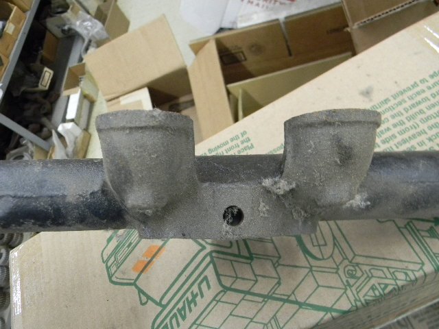

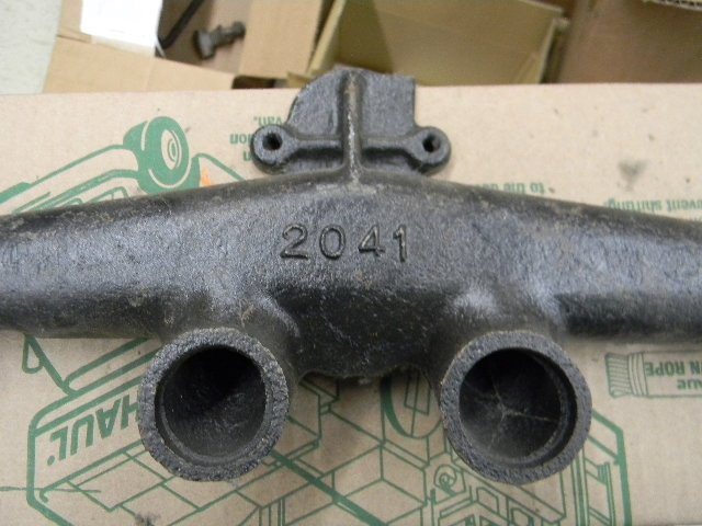

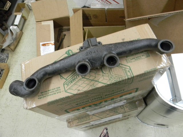

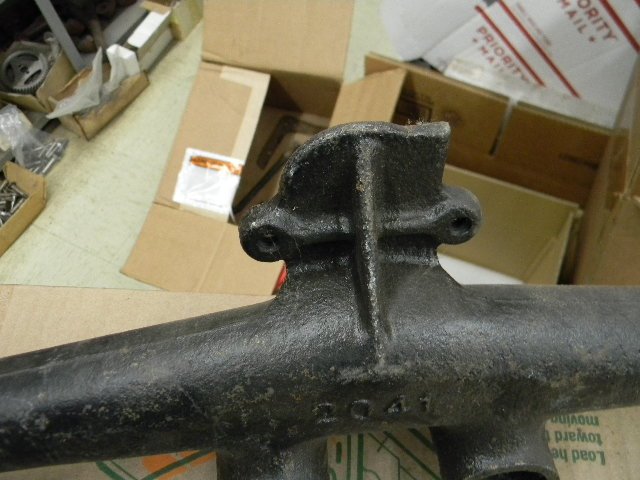

Post by FATMAN » Mon Jan 21, 2019 11:59 am

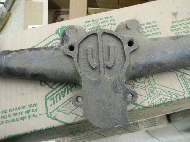

Only one small hole on top no vaporizer plate see photo's

Posts: 7398
Post by Steve Jelf » Mon Jan 21, 2019 12:09 pm
Bob is right, of course. :D Ford part numbers begin at 2500. The Ford part number for a Vaporizer manifold is 6272, and the factory number is 4483C. It's not a Model T Ford part.
Post by Jim Sims » Mon Jan 21, 2019 1:00 pm
After market manifold to fit Model T Ford. Most likely works similar to a vaporizer.
Posts: 4048
Post by DanTreace » Mon Jan 21, 2019 8:12 pm
As Jim noted, could be this one.....there were so many different aftermarket vaporizers offered.
