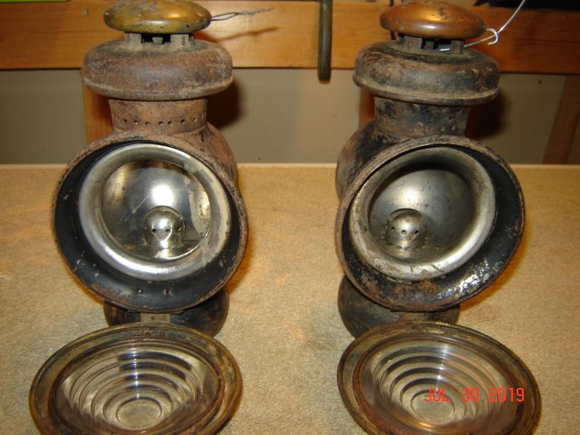

Here is a pair of E & J Model 8 side lights for the 1915 Model T Fords. Even though they need restoration, they have pretty nice examples of the round "diver's helmet" reflectors that Allan is describing.

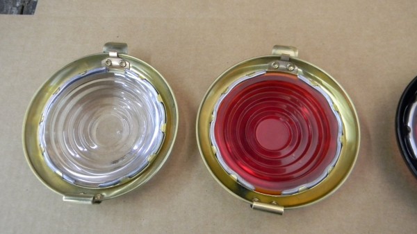

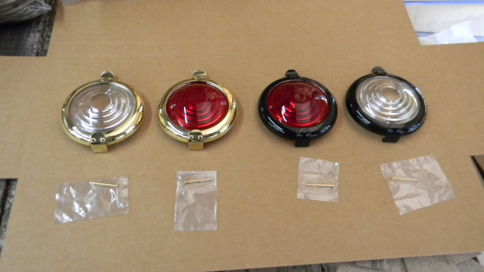

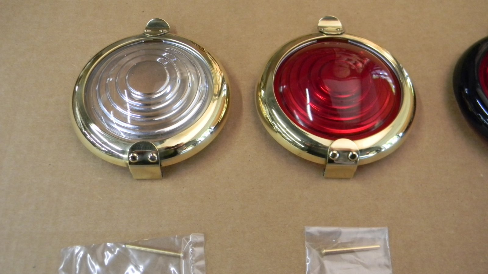

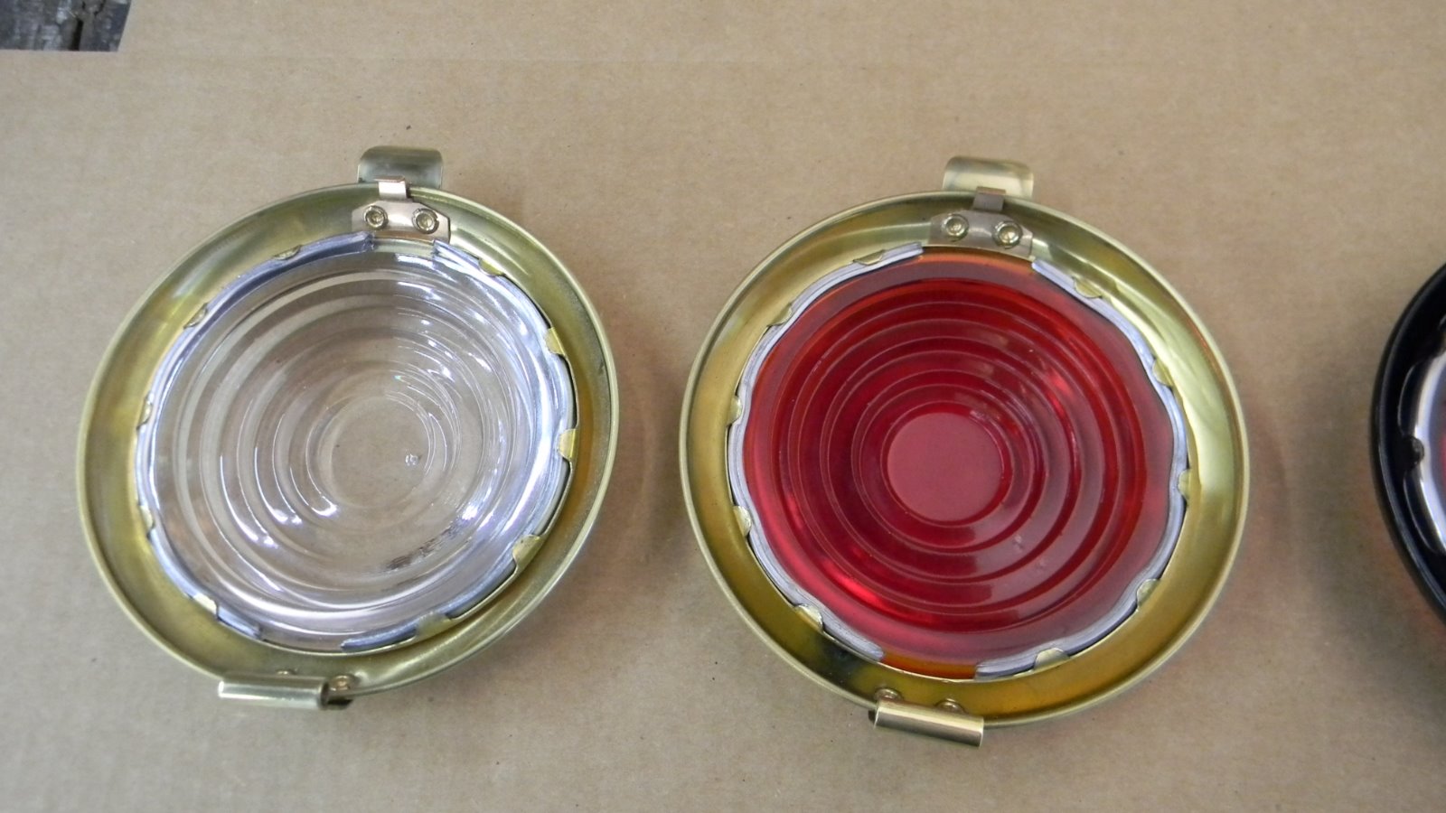

We have these in stock now with tabs to hold the glass, and we sell them with glass installed, Bob
