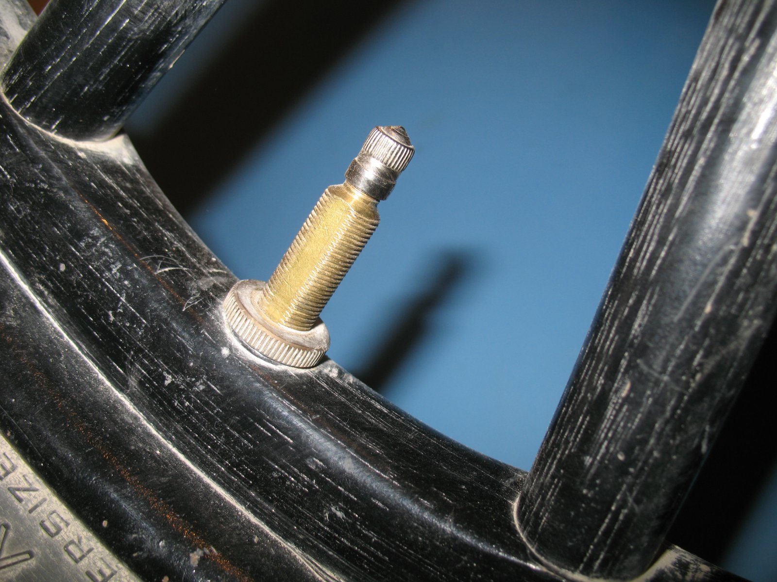

- Posts: 7411
Re: Inner Tubes
I believe most tube "deflating" issues are a result of the cheap-ass STEM VALVES...
Don't depend on the valves.
Help them out with small caps that have a rubber seal inside.

Please don't assume the photo that Steve Jelf posted is correct for a Model T, it is not. I'm not saying it doesn't work. As you can see it does, but why would you want to screw the dust cap all the way down those threads, when you can just attach it to the rim nut and be done. Two issues ago, I wrote an article for the Model T Times explaning what is correct for a Model T. Apparently few have read it.
- Posts: 7411
Re: Inner Tubes
If my scanner was working I'd show you a picture of the correct rim nut from Larry's piece in the MTT. You can see it on page 25 in the May/June issue. I'm using the Schrader 724 and 725 stems, and the incorrect rim washer that goes with them, because that's what was readily available among the stems I happened to have, and the dust covers I was given fit them. Eventually I may switch to the correct 777 stems and the hardware that fits them, but for now I have bigger fish to fry. I may be using the wrong ones and suffering the ordeal of screwing the covers off and on for a long time.
The point of my photo above was not the stem and rim washer, but the cap to help the valve hold air.
Topic author - Posts: 3944
- First Name: Larry
- Last Name: Smith
Re: Inner Tubes
That cap will not help the valve hold air. Give it a try some time!

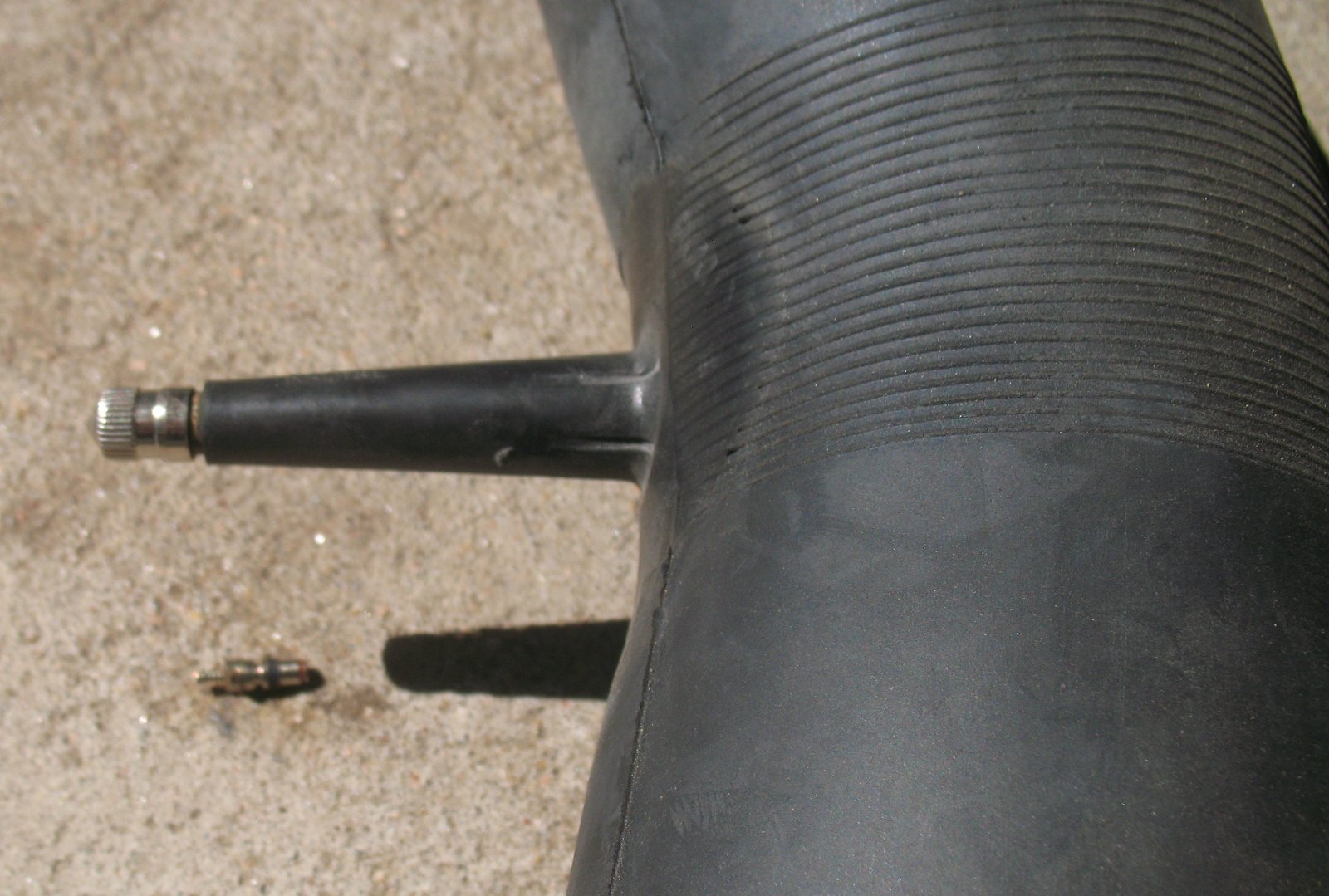

OK.
Here's a tube with the valve removed, and the cap with its little rubber seal inside holding air. Your move.

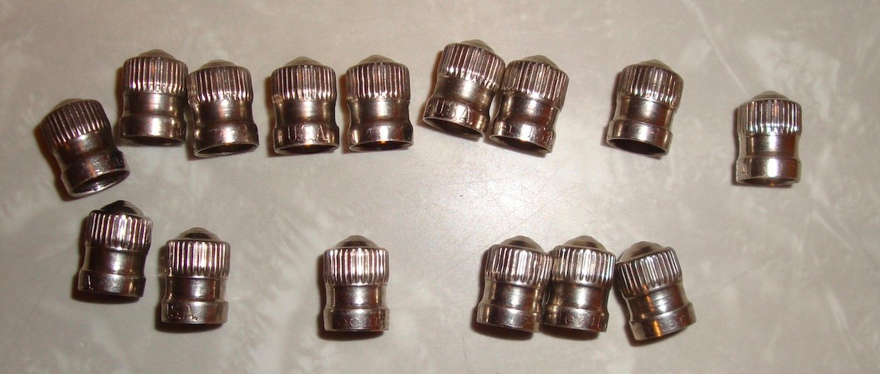

In their advertising, Schrader promoted the use of the metal caps with the rubber gaskets to completely seal the stem.
First photo is of brand-new Schrader brand metal caps with the rubber gasket inside. These should not be confused with plastic caps that merely keep the dust and dirt out but do not provide an air tight seal.

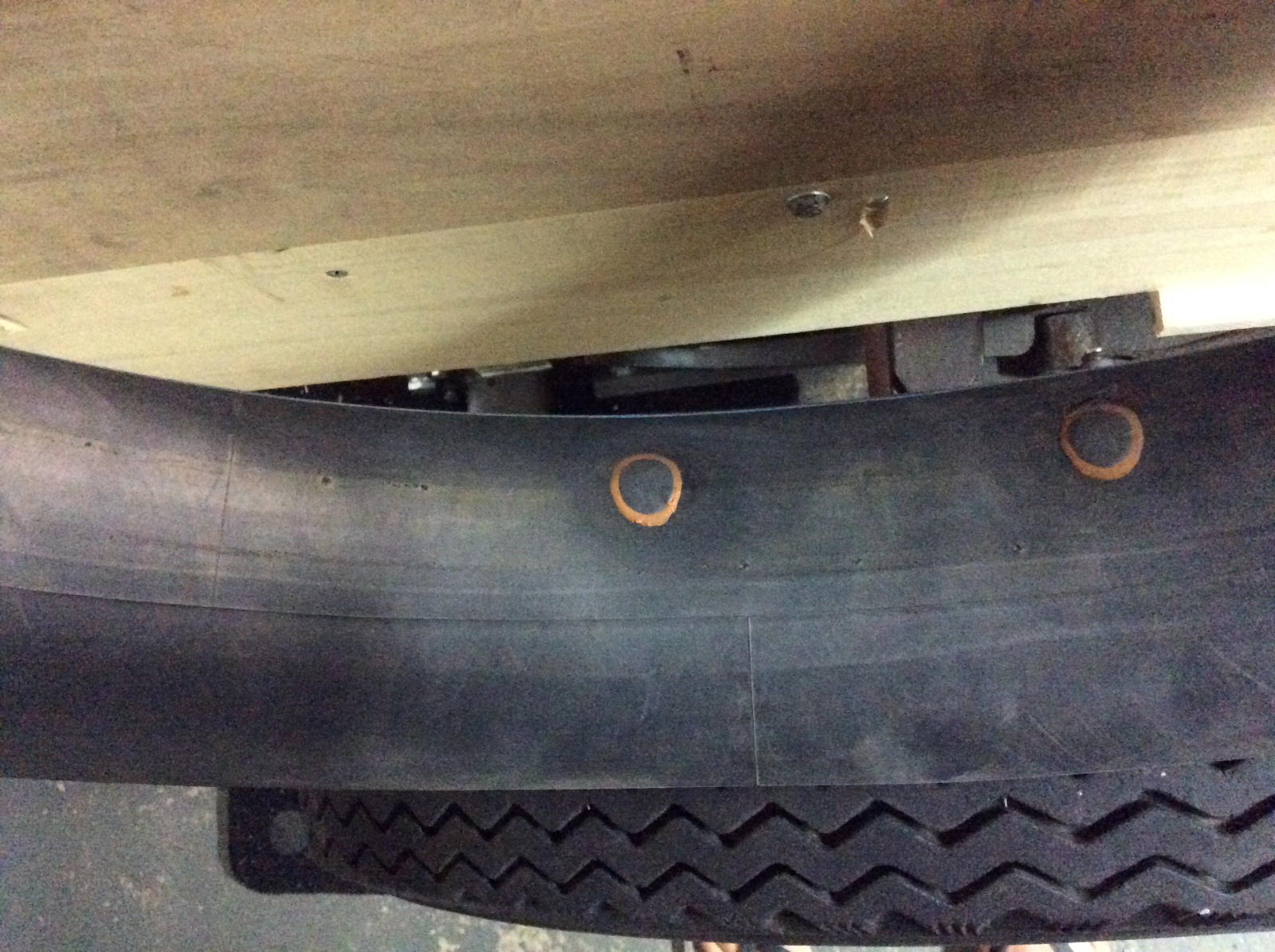

Is this the splitting issue you guys are talking about on the custom classic tunes?
Daniel828
- Posts: 45
- Joined: Sun Jan 06, 2019 9:04 pm
- First Name: Daniel
- Last Name: Brennan
- * REQUIRED* Type and Year of Model Ts owned: 1
- Location: New Jersey
Re: Inner Tubes
Sorry for the bad pic. I can take another with better light if need be.
These tubes are mounted on wire wheels. I thought at first the edge of the rim strip was causing the problem, so I removed the rim strip as a test and the tube continues to develope these pock marks Its only affecting one wheel so far. All the wheels have the same tubes in them
Dan
Dan

Is this the splitting issue you guys are talking about...?
Could be. Both patches appear to be on a line that could have been a fold.

Daniel, those are miniscule patches. Are they from a bicycle repair kit? I like to see the patches with a greater footprint to avoid the chance of leakage.

Alan, good eye. They are in fact bicycle tube patches lol. It’s all I had . I keep getting these pin holes I can see them developing the inner circumference of the tube. They are right in line with the he edge of the rim strip. I was thinking maybe the edge of the strip was digging into the tube and causing these pin holes But I removed the strip for a test and the holes are still developing. I bought another tube so I’ll I have to use that one

Steve's fix for the short valve stem issue may not work too well. The m/c tubes I have replaced are thinner than car tubes. They do hold air though! This may mean there is little rubber for the replacement stem to squish for a good seal.

Richard, valve extensions are already made. Good quality ones are machined brass. They have an inbuilt plunger which depresses the valve core just like the air chuck does. They are often used on trucks and odd-ball machinery to give access to the valve stem on duals etc. The problem is they are not cheap. There were some cheap plastic ones around one time but they were less than satisfactory.
One T owner I knew had fitted 2.50 x 23 motor cycle tubes and had the short valve stem problem. He bought just one extension, and used to screw it on and off as he checked each tyre on his T.
