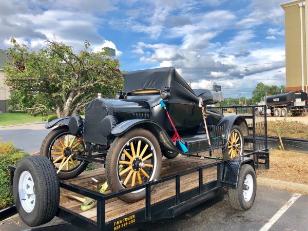

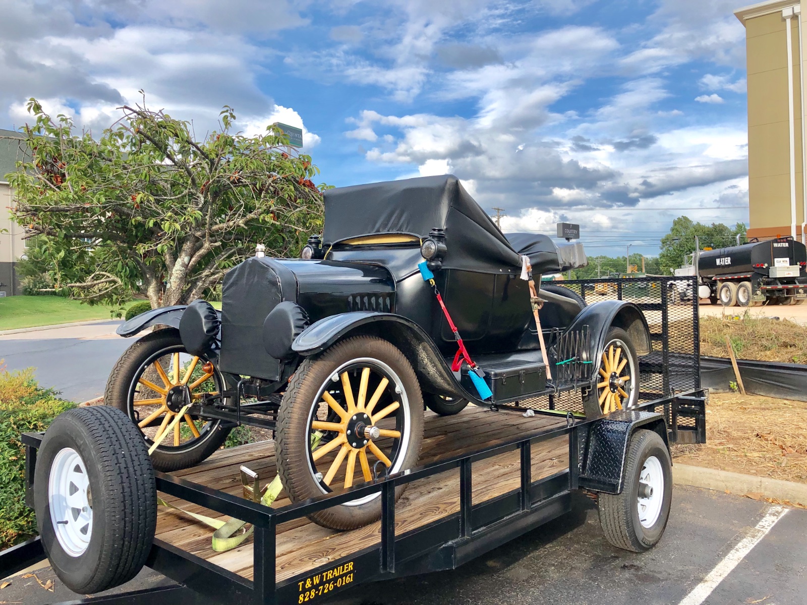

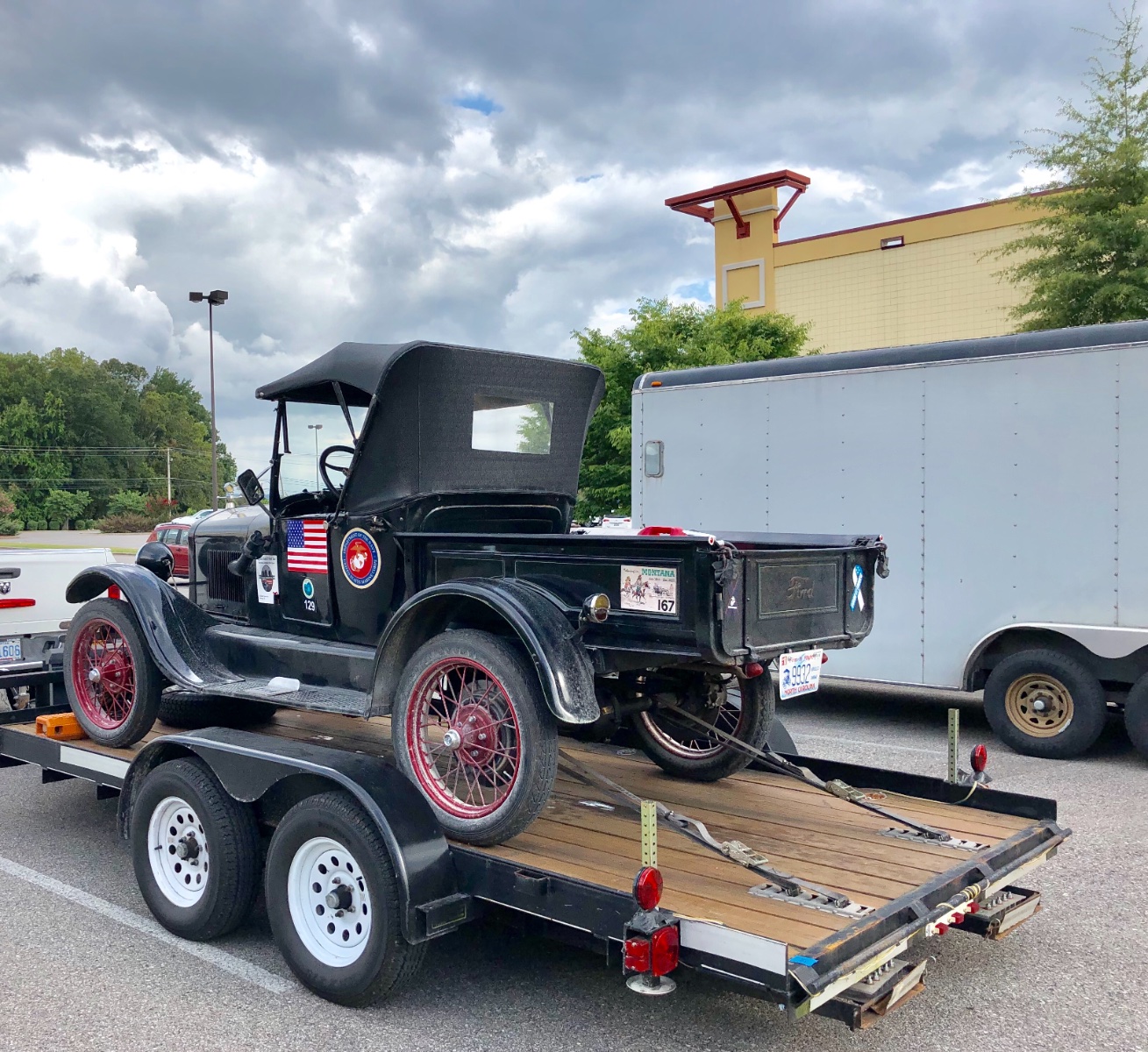

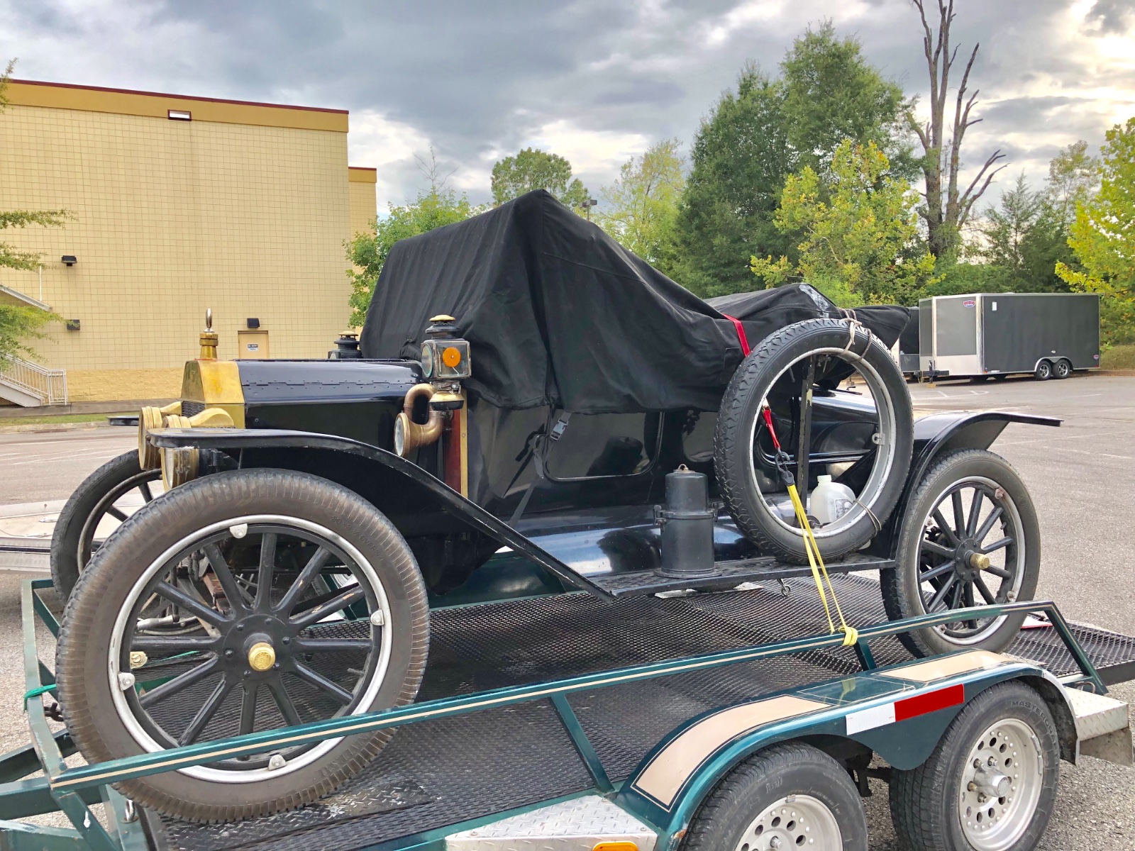

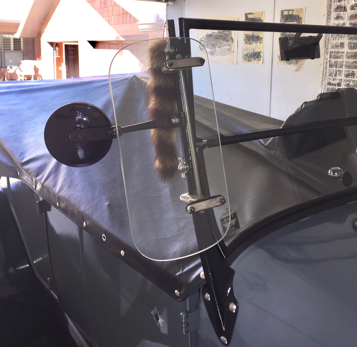

Here are three samples from the nat’l tour in Cookeville. The better protection for open body Model T’s on open car haulers for the interior is a custom fitted vinyl cover. Closed style bodies are easier to haul in the elements.
On my gray ‘27 the snap fitted cover goes just over the interior, has boot to cover the folded down top. Windshield closed, and nothing inside the T, gas shutoff, and ignition key removed.
Lots of bad roads when hauling that can shake and rattle stuff loose on your T
