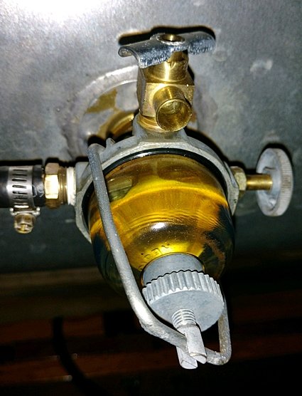

Attention, NOT FOR THE PURISTS
My car had a cast iron FSB with the brass valves. I used valve lapping compound to try to seat the valves (both the shut off and the drain valves) to no avail, could not get the #$%* thing to stop dripping. So I went to Tractor supply and found this bowl for a Massey Ferguson tractor, half the price of the one from Langs. It cant be seen unless you climb under the car and it has a glass bowl so you can see what's in your gas, a fuel shut off and a filter screen, in my opinion an improvement

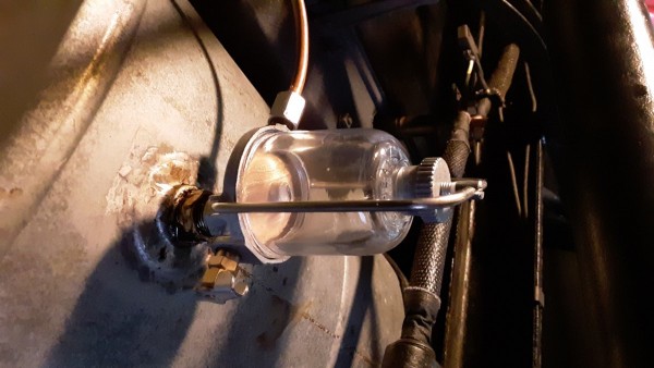

I got one too. I don't often post non approved purists pics, but since were on the topic......
I even modified it and added a tank drain
