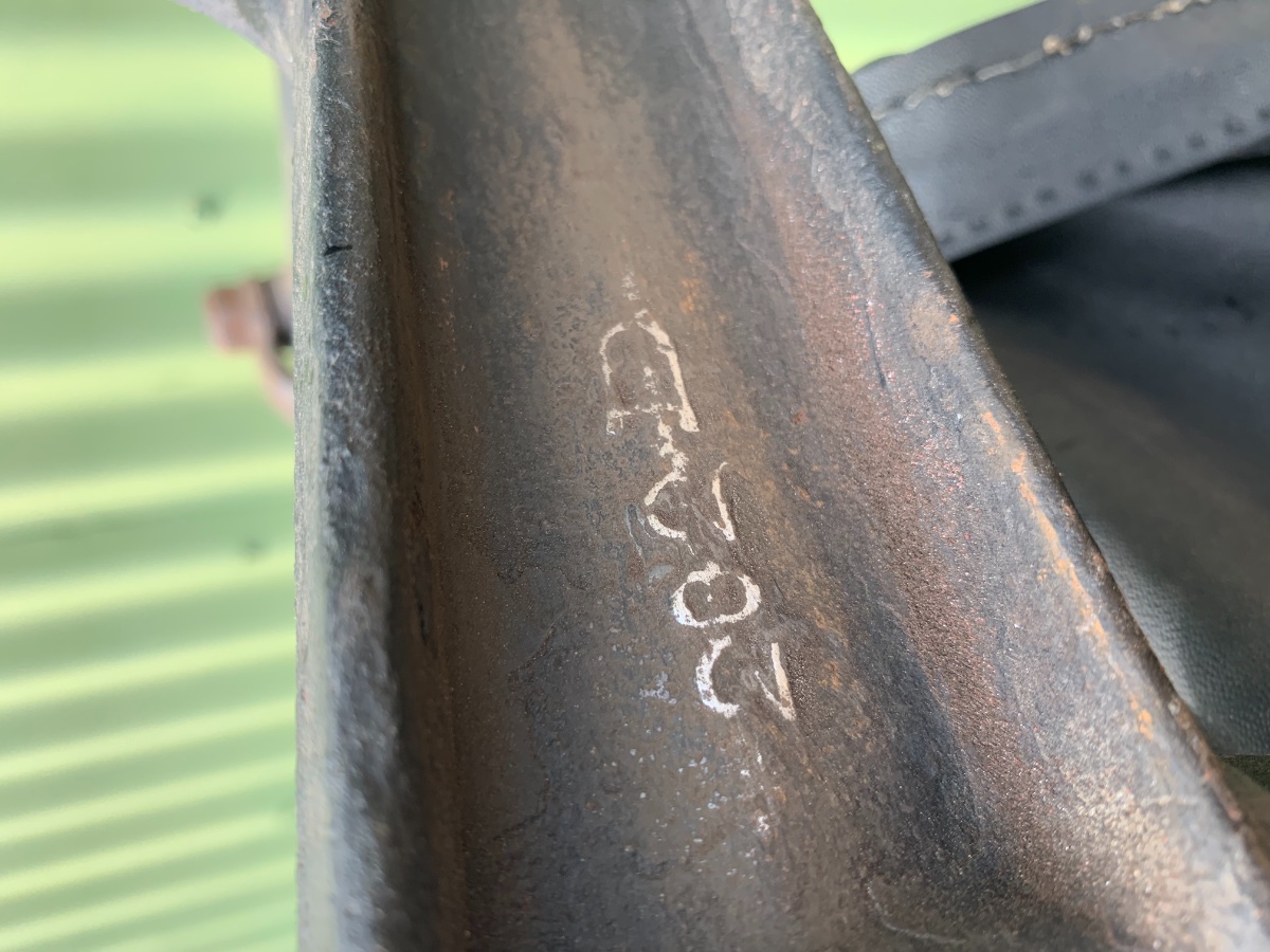

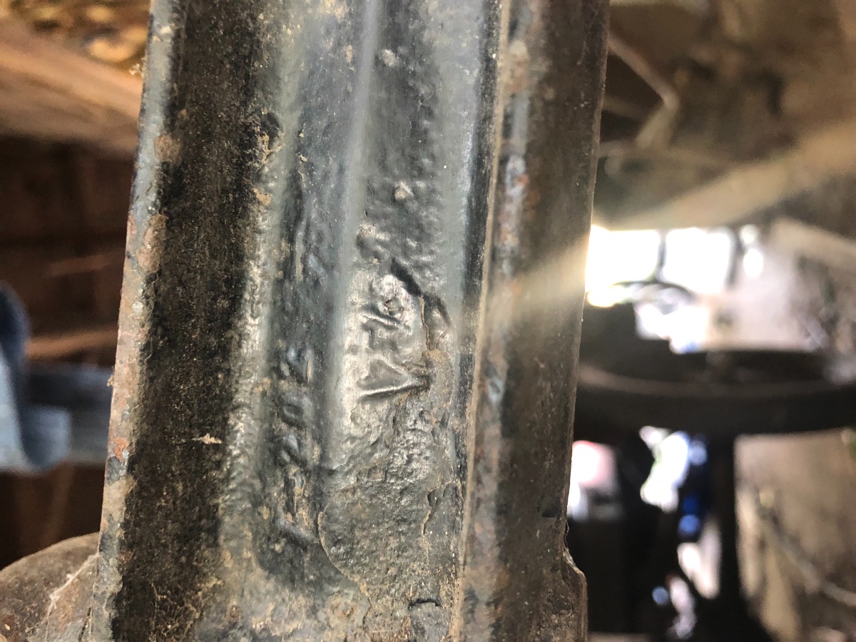

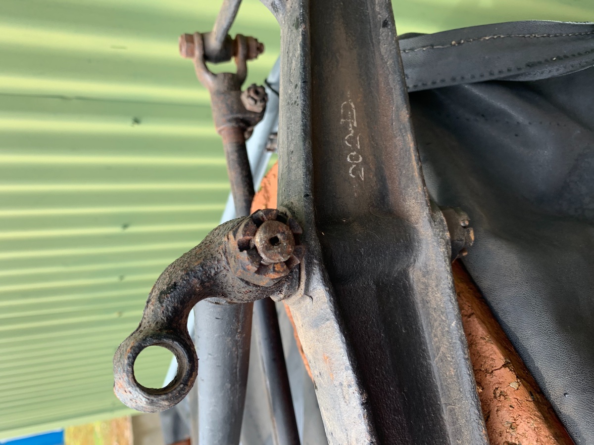

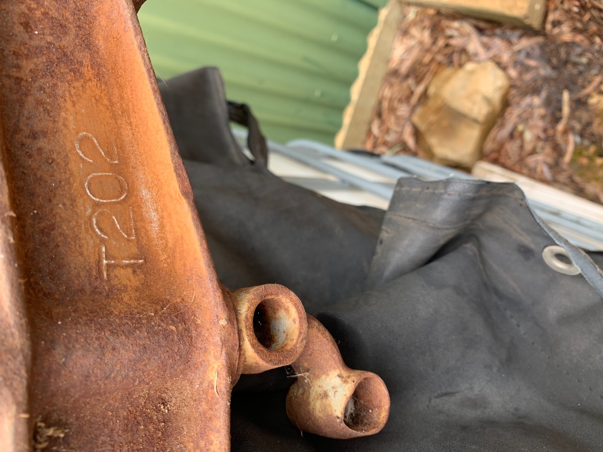

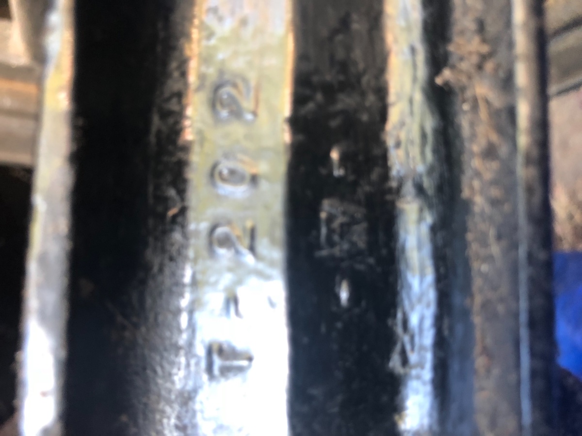

What’s are the correct markings on a early 1912 front axle. Here is what I got. Or is it what is pictured in the first photo. Thank you in advance.

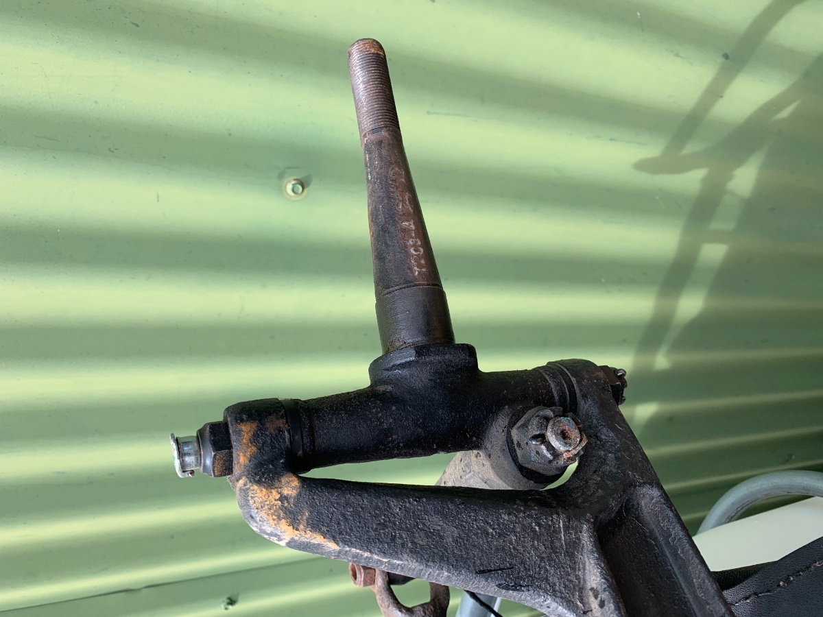

The spindle and spindle bolt are 1917 or newer.

Does the axle have DB markings?

The rusty axle, I do not see a maker's mark in the photo. The black one shows a mark, however, I do not recognize that one, although I know I have seen it before. In the beginning, Ts used almost all Dodge brothers front axles, by the introduction of the two-piece spindles in 1911, Ford was outsourcing from Transue and Williams (a "T" over a "W" maker's mark) and soon thereafter a couple others. I don't recall the names, but I think there were at least four suppliers by 1917.
The HCCA crowd does love their Dodge Brothers axles and other parts. Me? I cannot afford to be that particular. Transue and Williams was a supplier before 1912, and a Transue and Williams axle is good enough for me on my cars. There were minor differences in the stampings for earlier axles. I do try to find earlier TW forgings.

Cannot see any DB markings, would they be near to the numbers?

Michael, the elongated D forge mark is common on later parts out of Canada. It would tie in with the later spindles on the axle. I believe that axle is at least late teens.
