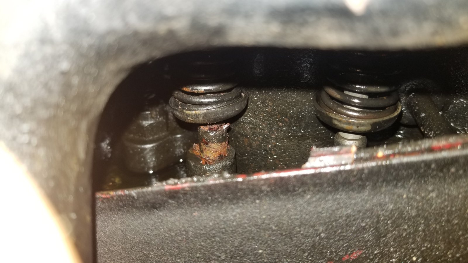

Hey guys, trying to help a fellow T'er get his running after sitting for a year. Went thru the fuel, air, spark tests and found the problem to be a stuck open exhaust valve on cylinder 2. Everything else checked out ok. Would one open valve cause us to not be able to get her started?
Picture of the poor thing looking at mine, just wanting to get out and cruise the open road.

Most T's will run on 3 cylinders although it will be lacking power - might be a combination of issues - does it even attempt to run ?

An engine sitting for a year might be pretty hard to get going with a stuck valve, especially if it's an intake valve....blowing back into the carb with each stroke.
Try pulling the plug and put some penetrant oil MMO in the hole toward the valve and let it sit a while. Then tap the valve down (make sure it should be closed) and crank it through and repeat if needed.

Spray some good carb cleaner on the stem and tap it down with a wooden dowel.
It will free right up.
Will kill the mice, too.

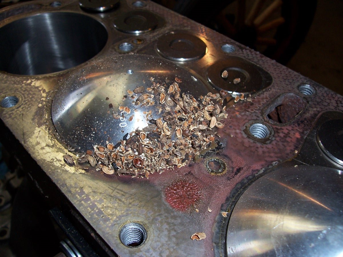

I found this stash in a newly rebuilt engine that had been sitting dormant for a number of years - little bugger got in there someway !

Was able to wiggle the valve this morning so I figured the problem must be deeper. I decided to pull the cover to look for a mouse. I didn't find a mouse, but I found lots of rust. Why would the valve cavity be so dry after sitting for just a year?

So, we have been spraying Kroil and trying to wiggle the lifter. So far to no avail. I said we should keep spraying and trying a couple times a day for 2 days. If that doesnt work, could we apply heat to the lifter boss? What about using a vise grip to get a better grip on the lifter. I would make sure we are only grabbing the top 3/16th inch or so, the amount that doesnt drop into the boss so we son't mar it.

Seeing what you have there, you don't want to vice-grip this thing (you may ultimately have to replace it, but you will kick yourself for the damage you'll do to the lifter boss when you try to drive a vice-grip-bunged-up-lifter back out). The lifter WILL come loose if you wire brush what you can see, as depicted in your photo, then pull the inspection pan and alternately tap the valve closed through the plug hole in the head, and tap the lifter "up" (using a brass or wood rod and small hammer).
Pulling the pan will also reveal if the bottom of the lifter is rusted, too, and if so, maybe the cam lobe, though I don't think that's a strong possibility. Steel and castiron are very compatible as a bearing surface, and if the starter forced the lifter up and made the valve stick, then it's not fused together...this is very good news for you and why I say it WILL come loose. All this may end up as a slightly looser lifter than the others but will do no more damage than 90 years of wear has done already. If this was a fresh engine, I'd pull the cam and get that lifter OUT of there. If it was an older engine, then mox nix...once it's freed up, cleancleanclean and oil liberally and then drive it.
Once it's running, it will be interesting if you ultimately discover how/why that moisture got there, specifically. I'd bet a small head gasket leak which is inconcequential to running but allowed a small amount of water to migrate past the valve...you may find it's a bit rusty, too, ultimately...it's wobbly loseness probably kept it from seizing like the tappet/push-rod did.

We decided it was time to remove the head and have easy access to everything. Head came off easy, inspection of the head gasket showed possible water infiltration into combustion chamber. I'm not the best gasket reader, but it wouldn't take much to cause the rust I'm sure. I pulled the valve spring off the valve over the stuck lifter so we could pull the valve and tap directly down on the lifter. Problem was, valve wouldn't budge. At this point I decided saving the valve was not necessary as that is easily replaceable. I grabbed a pliers and wiggled and pulled and twisted and grunted until she finally pulled up and out. The top of the stem that does not go into the guide was so rusted and corroded that it is less than a quarter inch diameter. The guide portion looked pretty good. It was also bent near the top, possibly from trying to push it down through the spark plug hole, possibly from me twisting, possibly because it looks original.
We used a wood dowel first to try and tap the lifter down to no avail. We didn't have a brass rod, so I went with the next thing I had that would fit. A new valve. I dropped it in the guide and gave it a couple light whacks with a hammer. The lifter dropped. We oiled it up real good and then proceeded to spin the engine over. Lifter would stick up, I would tap it down. Over and over until Rods' thumb couldn't hold the starter button down anymore. When we stopped, the lifter would still stay up but just touching the valve with your finger would drop it instantly. So I'm sure the valve spring will get it to move.
I moved on to inspecting everything else and it doesn't look so good. It appears to me that all the valves are original, not just replaced with OEM, like 75 years old original. The stems are all corroded and thin. The moisture infiltration got the lifter bad but got the whole inside to some extent. The cylinder walls have a light film of rust on them, the intake and exhaust ports have chunks of rust on them, the valve seats are rusty and the valve faces are pitted.
My current plan is to pull all the valves and re-lap them. I'm wondering if the 7 poor sealing seats was keeping it from running since it should have sort of run with one stuck valve. I will replace the one valve and then put it all back together. We are also going to pull the Bendix cover and check the bolts and spring to see why it hangs up when hand-cranking. Then if it runs, I'll leave it to the owner to decide if he is comfortable the way it is of if he wants to go through the whole thing.

I ended up replacing 3 valves. The stuck, bent one and then 2 of them that the valve faces were so pitted lapping wouldn't fix it. I lapped all other valves so the seats and faces look good. Then I started bolting it all together. Everything went super smooth until I got to the exhaust manifold. Take a guess what it looked like. I dont understand how it could've been attached with gland rings before we took it apart. Could it really have been bent and then sprung when we released it? When I had mine apart, there was about a 1/16th drop and I was able to get it lined up and attached. I dont think this one is going back on. Besides ordering a new one, any other thoughts?

I'd suggest to just order & install a new one - you can spend more in acetylene to attempt straightening !

jachady
Posts: 118
Joined: Fri Jan 11, 2019 11:16 pm
Last Name: Chady
* REQUIRED* Type and Year of Model Ts owned: 1924 Fordor
Location: Jefferson WI
Re: Need confirmation of problem
Post by jachady » Wed Oct 23, 2019 9:30 am
Update: We decided to make sure it ran before spending money on the exhaust. So we bolted up the manifolds, gaskets on the intake, none on the exhaust. Then went on the carb and a final check that we werent missing anything. All good, so it was time to fire. Rod let me have the honors since I had all my time in. I jumped in and gave her a crank. And she cranked and cranked and cranked and cranked. And never popped.
Back through the steps, fuel at the carb - check. Spark at the plugs - check. Compression with a thumb check - not so much! 2 cylinders seemed very down on compression. At that time Rod says he has an actual compression tool. So we run a real test. Cyl 1 - 35, Cyl 2 - 10, Cyl 3 - 40, Cyl 4 - 25. Not good. But should be good enough to fire. So we jacked the rear off the ground to relieve any driveline drag and tried her again. She started right up! We had her running long enough to get hot so we can retorque the head bolts. And as she ran the engine started to smooth out and sound a little better. Altough it was hard to hear over all the exhaust leaks. Next step is to see if it will drive, then we can determine the next course of action.
Duey_C
Posts: 1557
First Name: Duane
Last Name: Cooley
Location: central MN
Post by Duey_C » Thu Oct 24, 2019 12:05 am
Great update John!
You bet, in fair tune they'll pop right off and run good with a couple cylinders with really crummy compression.
Been doing it with one of mine for 20 years, I just pull on one of the good'er' cylinders. 8-)

jachady
Posts: 118
Last Name: Chady
Post by jachady » Sun Oct 27, 2019 10:30 pm
Well, I drove it today. Definitely down on power. Feels really good in low gear but the transition to high is horrible. Theres just no torque to get it going. It'd make a great parade car the way it is but I think the owner wants to drive it more than that. Next step is to do a leak down test to see if we have a valve sealing issue or a piston ring issue. Then we will move to the next stage.
J1MGOLDEN
Posts: 1314
Last Name: Golden
Location: Bowie, MD
Post by J1MGOLDEN » Fri Nov 01, 2019 7:55 pm
I recently purchased a complete 1925 engine that had been in storage for about 40 years. The valve cover was in place and tight, but the inside area was filled in the front area by a mouse nest and the whole center area was filled with a bee's nest.
There was a very large mouse nest in the front part of the oil pan and I still cannot imagine how they got in or out of there.
