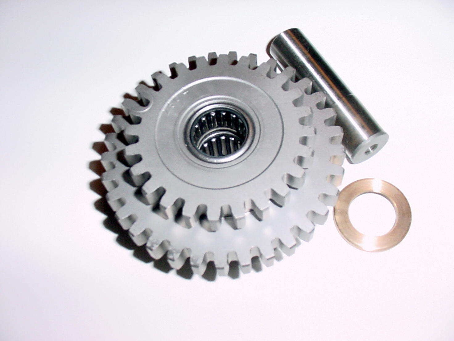

I'm outa popcorn, BUT- Gene if you or anyone else knows of a case of my needle bearing conversion failing, I would sure like to know about it. The needle bearings have never failed as far as I know, and the reason is they are a 100% engineered solution to an ongoing problem that will never go away regardless of the amount of clearance one gives or does not give to those bushings. This subject eventually drifts toward the metallurgy of the bushing material, Z bronze etc, but never really addresses the fact that a bushing that size cannot develop and maintain a proper oil film to prevent metal to metal contact given the loads involved. I've done the calculations and the numbers don't lie - that's why I developed the needle bearing conversion over 20 years ago, and the original protoptype is still running in a regularly driven car with no issues what so ever. Thanks, Dan

I split this topic as there has been so much interest in this conversion it's worth a discussion. I've heard privately from no fewer than 5 folks who swear by it and have been running it their cars for 20 some odd years with great results. The mechanical theory is sound, the triple gear design screams for it, and it just makes sense. Needle bearings have been used for decades in many high-stress applications and especially racing transmissions - ie Formula One (my wife has a Fernando Alanzo transmission needle bearing neckless that cost me $250 in Paris), and this application should be no different. Certainly better than the current bronze bushing that causes so much grief for so many.
And in this case it doesn't subscribe to the "if it aint broke don't fix it" adage - this is broken. It's obviously a bad design from the outset. Witnesses the countless folks who have clearly suffered from this issue, and it's conjecture at best to ascribe all of the the failures to incorrect fitment clearances. Mine included. I was there, live and in person, when we set it up.
Purists can disagree and come to my place and climb my hill in their T every day in low Ruckstell and then see how they feel. Perhaps my application is extreme. So be it. I'm putting Dan's needle bearings in my triple gears so I never need to worry about climbing my hill again.
Jeff
Jeff

If they run on a properly hardened pin that has a proper surface finish and roundness, I agree with you. They are very unforgiving to being run on soft or out of round races (pins). A search of the forum will show that all manner of really bad pins have been foisted on the public over the years, and even now, I understand that of the two suppliers of pins, one tends to be recommended and one rejected by those who understand such things.
I suspect these will be adopted with great success in shops which ensure the above, but will be met with less than stellar life in the hands of unskilled tradesmen.

Dan's needle bearing require new pins or forget that idea
Last 5 years I fix 2 sets of triple gear bushings but case old pins where used and the tranny bushings in the drums was way loose may been a factor
Plus we driving these cars faster and for longer periods of time might be another
So
To many variables say yep that the issue
So
