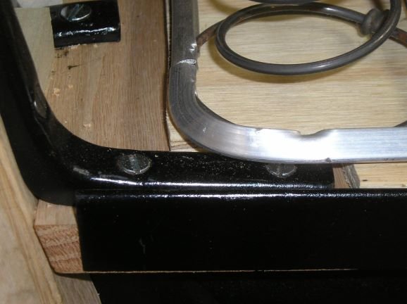

the new springs do not have the S shaped aluminum channel to receive the bead on the upholstery like later years.
the new covering kit I received does not have the bead either.
The spring does have an aluminum U shaped edge that only opens toward the spring coils and is smooth on the outside.
Question,, is this edge supposed to be on top or bottom?
Also another thing, others have commented on the metal edge nailed on the front of the seat frame not holding the seat spring in place.
I am working with a very basket case of original wood and sheet metal.
The angle bracket on both sides from the seat wood to the door post keeps the seat spring from sitting flat on the wood.
This would cause the seat spring to ride forward over the metal lip.
My possible solution would be a wood spacer (3/8 plywood) with the front corners cut out to clear the angle brackets.
Were the original springs made with the front corners shaped to clear those brackets?

Re: 1913 runabout seat springs
Hello William,
I have attached two photos of my 1913 front seat and springs. It is hard to see, but there is a notch in the plywood on which the springs rest.

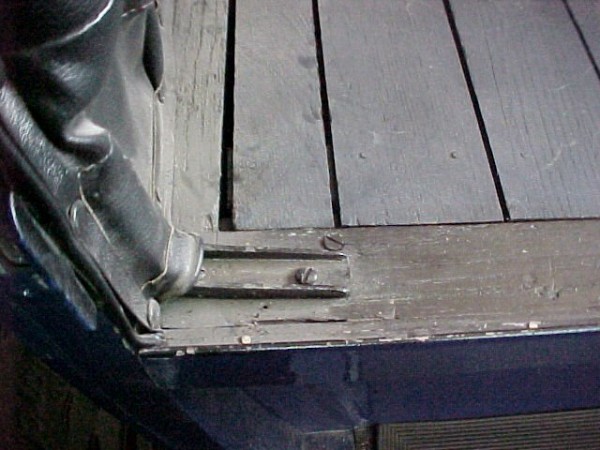

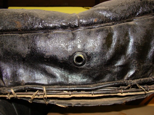

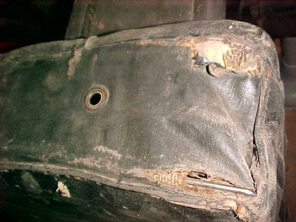

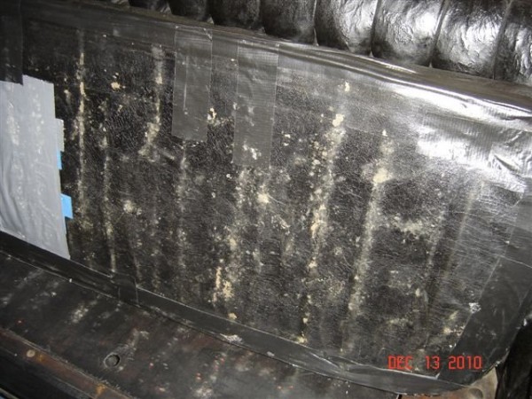

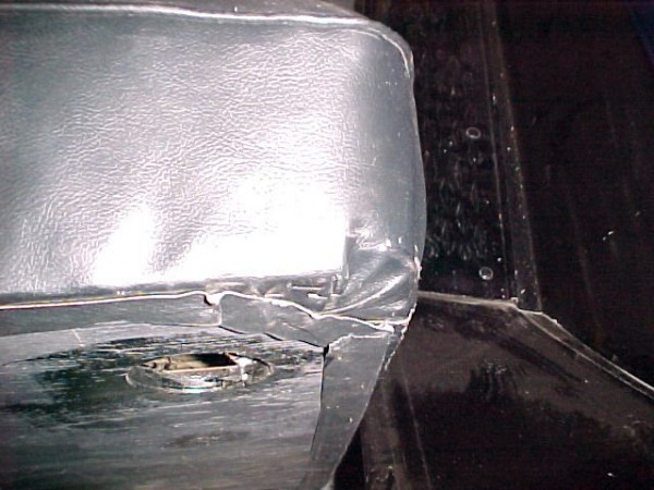

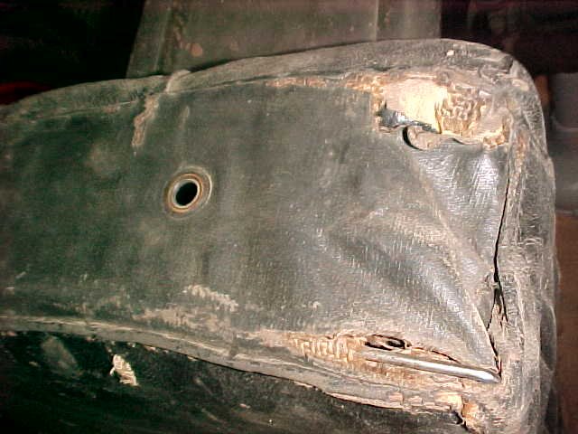

My late 1911 and cars through 1912 used hardboard covered artificial leather on the underside of the springs. The whole assembly was stitched together. Instead of hardboard I used 1/8" plywood and cut reliefs for the body irons. The originals just sat of the irons and brackets.
Here are some pics of originals...
Earlier 1911 cars with the bent-wood frame for the seat springs have notches cut in the wood.
Not sure about 1913...
