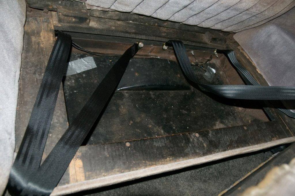

I "borrowed" a picture I found on the net while researching the rear seat box for a 1922 Center Door. It shows seat belts having been installed in it. I do not know who's car it is, so I cannot give proper credit. It isn't mine.

In that photo above I see the belts bolted into a piece of wood. If that is the only mounting, what the "H" good is that? :shock:

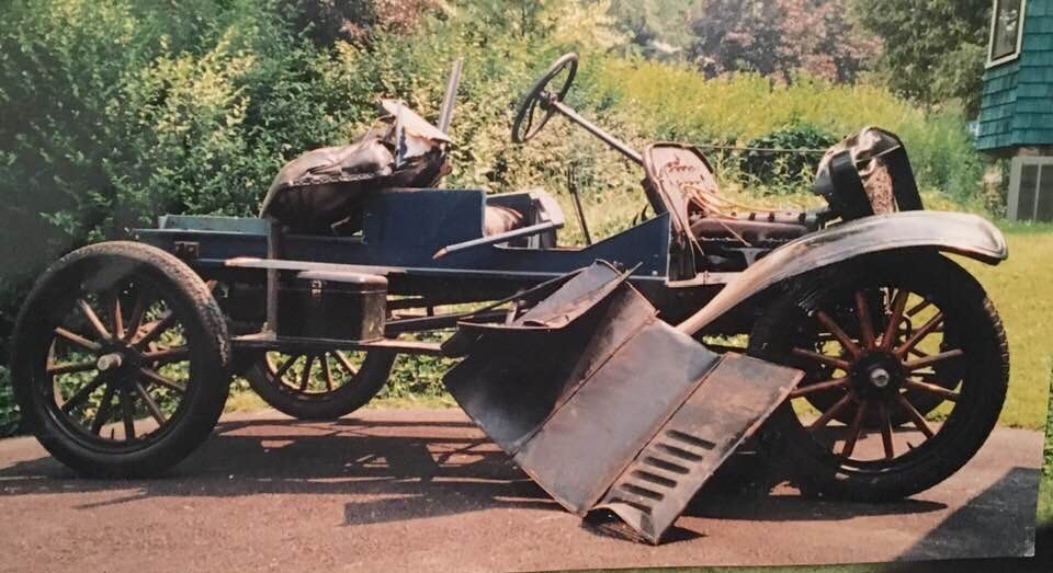

I’ll never install seat belts in a T. Here is my roll over in 2001. Thank God I wasn’t strapped in.
