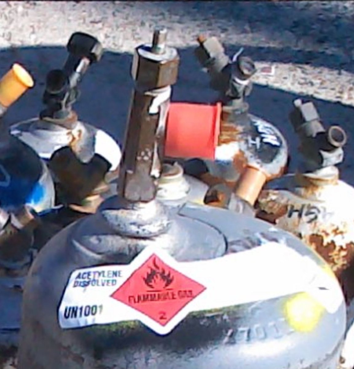

The 20 inch tank is called a "B" tank at the welding supply houses where I find a few Prest-O-Lite offset valve tanks mixed in with the regular tanks. They are not the old style tank with the pressure gauge on the bottom which can't be filled here in the U.S.

IF you have a choice on Prest-O-Lite tanks at the welding supply, the "fine" valve is easiest to "crack" the old way without a regulator.
Third Photo-Coarse Valve
Knurled Knob is modern change out by filling house. I use this style with a Uniweld Regulator.
