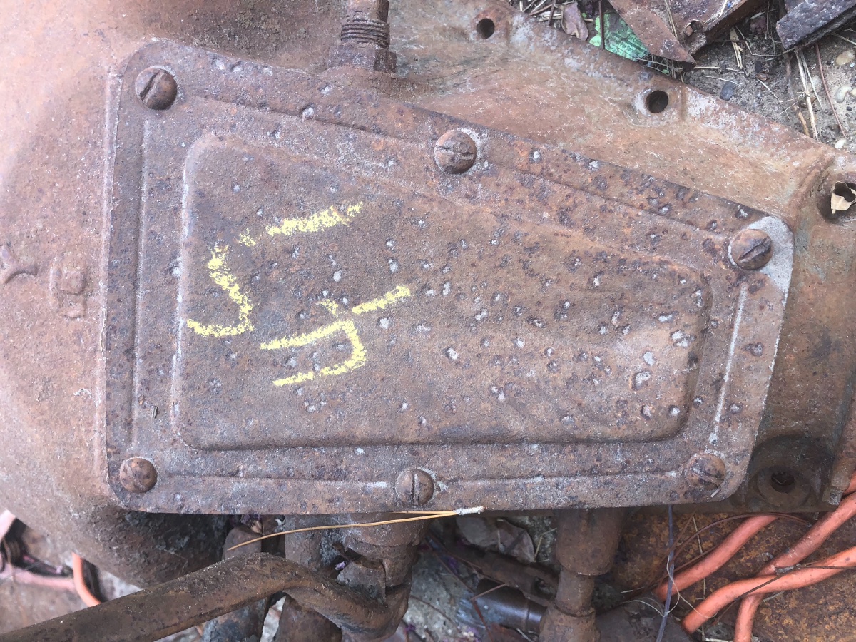

Post by John kuehn » Wed Sep 18, 2019 4:52 pm

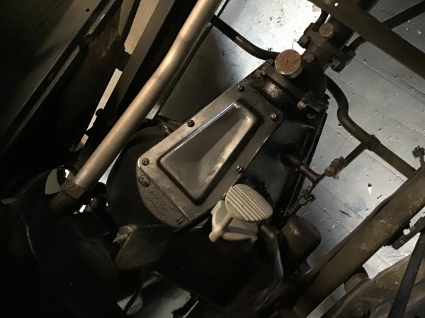

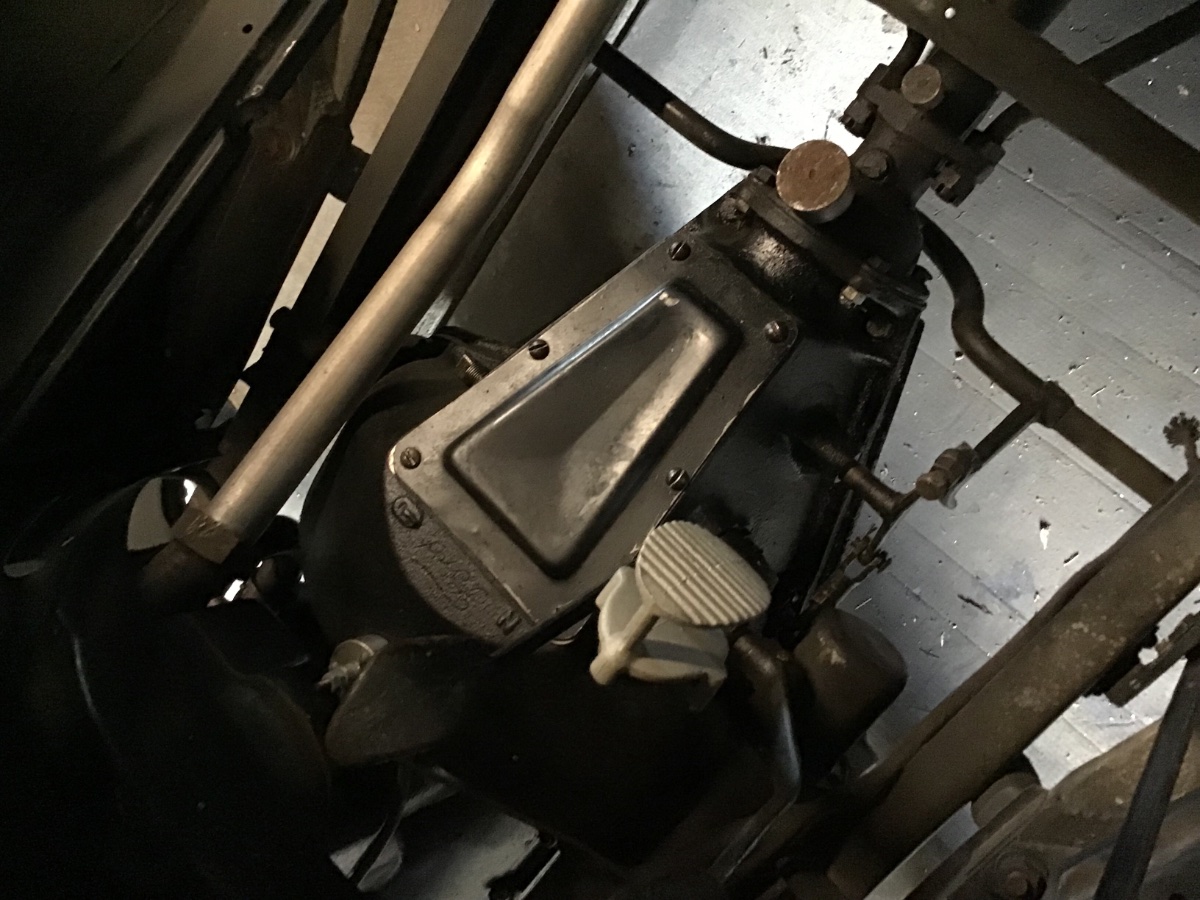

Here’s the one in my 24 Coupe. I’ve had this car since 1959 and that’s the way it was when I got it. The T encyclopedia says the transmission door covers were “embossed” starting in 1917 and became the typical style used from then on. Maybe the embossed door was supposed to help in oil distribution? The T shop manual shows it to be installed with the V pointing down. Maybe the engineers decided to use the V and get away from the flat covers.
Anyway I guess I passed the cover inspection test according to the manual!

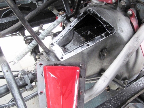

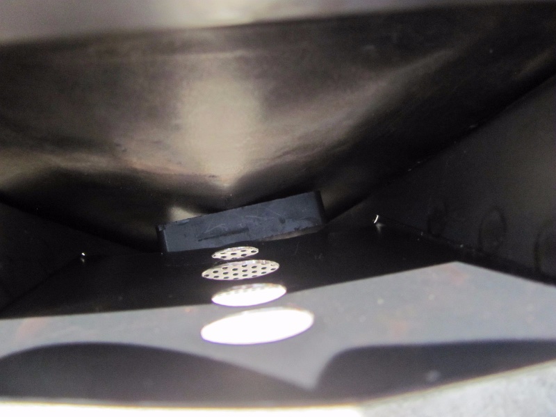

As others have posted, the triangle form (Famous Ford 3-point :P ) inside the cover ....defects the oil to the bands or the screen plate.
IMG_6731 (500x375).jpg (131.61 KiB) Viewed 6332 times
Note the oil film flow, top of the triangle and down..... :P
And for those with a magnet in the screen, that formed cover may help retain it. You can see in this view the triangle form directs oil to the screen.
