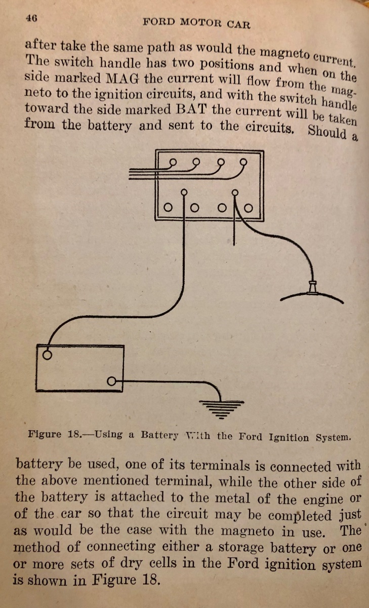

As others mentioned, Ford capitalized on the flywheel magneto, but Henry did put redundant systems on his T, so the coil box mounted switch does have BAT position and a battery terminal for the coil box.
This info is from publication The Ford Motor Car, by Harold P. Manly. 1917
As mentioned in the page, ground the battery to any nearby place, using a bolt or nut on the engine or frame, just be sure it is a bright clean connection.

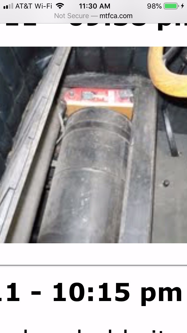

Location of a single or multiple array of dry cell or 'hot shot' non-rechargeable battery was up to the owner, and wiring it too. Nary a formal mention in the early Owners Manual.
IMG_0712 (306x600).jpg (116.85 KiB) Viewed 9333 times

I have batteries in both of my 13's. They are 12 volts, and are about the size of a standard Model T coil. Yes, you have to wire it yourself, but it's no big deal. I use the old time cloth covered wire, so it kind of looks authentic. In my touring I have the battery under the back seat, and the roadster I have the battery in the tool box in back of the gas tank. The coils buzz much better with 12 volts than 6 volts.

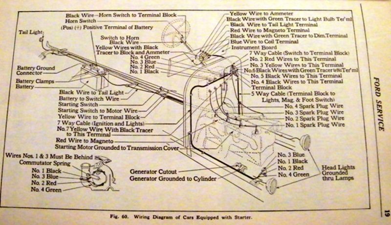

I think this diagram will help in answering the question as to where the battery ground strap was attached for cars with a battery & battery box. There are no other wiring runs to provide better ground connections to other parts of the T. Having said that, everyone has provided excellent advise on how to add a battery, where it can be located and the need to provide good grounding. But it would seem that, back then, if a battery was added one would ground it to the nearest chassis bolt. Since the cars were "new" the chance of a bad ground connection throughout the vehicle were much less than 100 years later.
