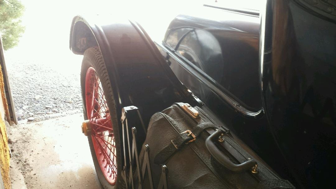

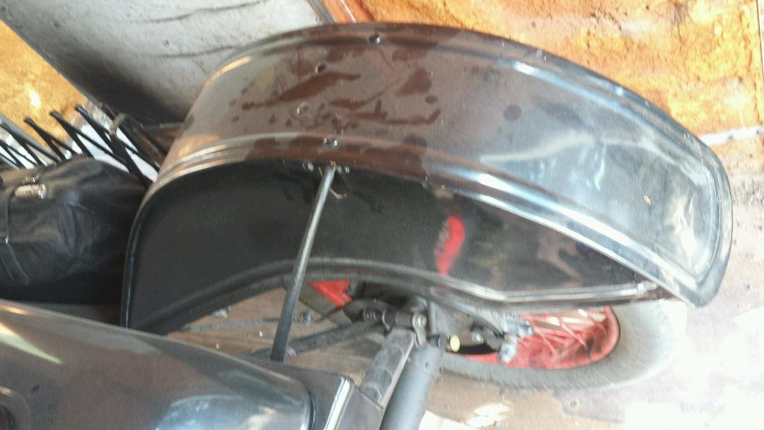

I looked at this car today. I am wondering what it may be worth. I was asked to make an offer. The car was built in the late 70s. 1916 # engine electric start Ruxstell rear end rocky mountain brakes?, McLaren wire wheels. Owner says runs and drives great. The car has been parked for several years. I did not hear it run or drive it. Just curious what it is worth?
Thanks for any information

Really depends on "mechanical" condition of engine/chassis & Ruckstell components - if all is in top condition I'm estimating easy $12 - 15K.

Dressed up with extra brass to look like a 1915. As Steve T says, it depends on the mechanical condition. I paid $8500 for my 1915 runabout, but it needed lots of fixing.

Although that car has a lot going for it such as the aftermarket wire wheels, be aware that the body is 1917 or later as the cowl has a notch in it.
It's possible that the car started life as a 1917 Ford and it has been dressed up to look like a 1915/16. Note that a block with a serial number from August through December 1916 would be in the 1917 model year.

Mike...look in the 2nd pic of the 2nd bunch..right above the coil box. I noticed it too and thought "uh-oh"..another one. I have seen other 15' s for sale with the same. Happens a bit.

This car that you are looking at, is a bit of a mixture. Said to be a '16, some details would be correct for 1916 model year Ts only (rear fender). Apparently a later body, but how much later we do not know. Very close examination may or may not be able to determine that. The brass trim on the lamps is correct only for true '15 model year cars. In fact late '15 model Ts had the black trim beginning in July of 1915.
