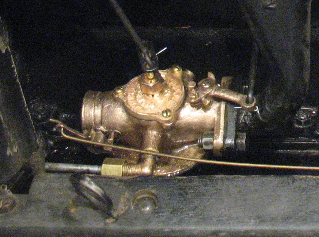

I am changing the copper/brass fuel delivery line from tank to carb with a flared steel brake line using brass adapters, couplings, and fittings. Need a consensus/opinion as to whether to use plumbers Teflon tape on the threads. Thanks in advance. Reason for doing so: I’ve had the original lines leak and break from vibration and don’t need this problem when driving across the country in June.

Willard, Teflon tape works great IF you use the yellow tape that is designed for gas use. The white tape is not designed for that. Dave

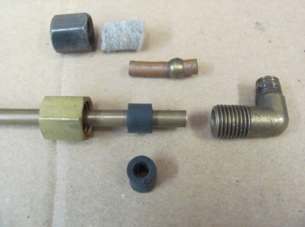

How I do it: Cut off the flares and bend the line to fit. Use the stock Ford 2910 nut and 6154 elbow. Cut off a little piece of fuel hose for a washer. It goes inside the nut. I've used Teflon tape on the elbow where it screws into the carb, but some say that's a no-no.

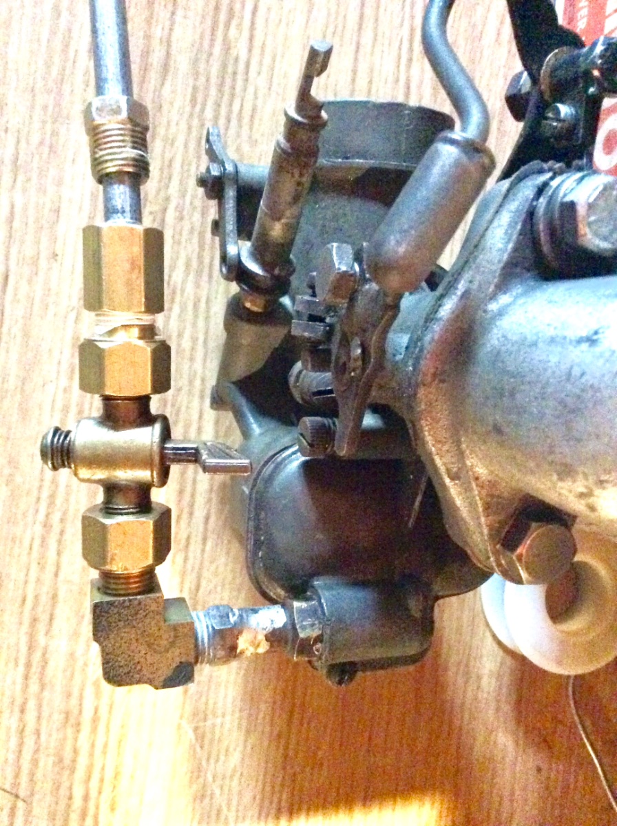

Steve, the only reason using (yellow) Teflon tape on the elbow would be a no no, would be if it wasn't done correctly. A LOT of people just wrap the tape around the fitting, not paying attention to how it ends up. As I'm sure you know, the first thread should be left bare. If not, the tape can be cut off and a piece end up in the carb. Other than that, I don't know why it would be a no no. Dave

I've used yellow tape with success and was an advocate for it until I went to Permatex #2. You don't even have to remotely tighten down the elbow with #2 and thus there is Zero risk of breaking the carb (as is so often seen on NH bargains at the flea market). In the last 3 years since switching (4 T's) I have had no leaks. The added benefit is that you're not fishing out tape with tweezers if you have to remove the elbow. Not as bad as "white" tape, but still a problem.

I've done Steve's recommendation about using a slug of fuel line in place of the felt and it's always worked quite well. As to Teflon as stated it has to be correctly installed or it will lead to trouble. The Permatex sounds good too. The monster problem really is over tightening which can easily happen when using Teflon. Slippery Devil.

I agree with Steve except I couldn't get a rubber fuel line seal to work over time and went back to the original felt seal and have been leak free for 10 years and counting. I have tried many different lines and fittings over the years including modern flare fittings and compression fittings and they all developed a leak over time. A steel brake line with the flare cut off and the original ford nut and felt seal did the trick. I think the problem lies with nothing in the fuel line design to absorb the movement of a engine vibrating and the frame twisting. A modern car has a flexible hose between the engine and fuel line to allow for movement, the model T does not. I think using a modern compression fitting or flare fitting becomes problematic. The felt seal may allow some twisting and protect the fuel line. I do not know why I couldn't get the rubber seal to work for me but had I used fuel valve lube on it it may have worked better.
As to teflon tape, I use it for pipe threads on smaller fittings, for larger fittings like 1/2 or 3/4 pipe threads I use pipe dope. Regardless of tape or dope, keep it on the threads only, if you get it on the edge of the fitting it could work its way through the system and reduce or block something... that was a lesson learned.

Does the felt seal need to be seasoned or coated with anything before assembly?

There are several different outside diameters of 1/4" neoprene fuel line.

Mark, use the felt seal dry.

The problem with the fitting isn’t so much will it seal if you tighten it as it is will it be positioned for the fuel line to fit. Cast iron will break if you over tighten a fitting into it but you can cut the threads a little deeper with an 1/8” pipe thread tap carefully so that it will screw in the right amount and face the correct way then use whatever sealer (if any) you want. I did this where I have twist oilers so that the holes for the oil are on top for shackles and forwards on the spindle bolts to make them easier to oil.

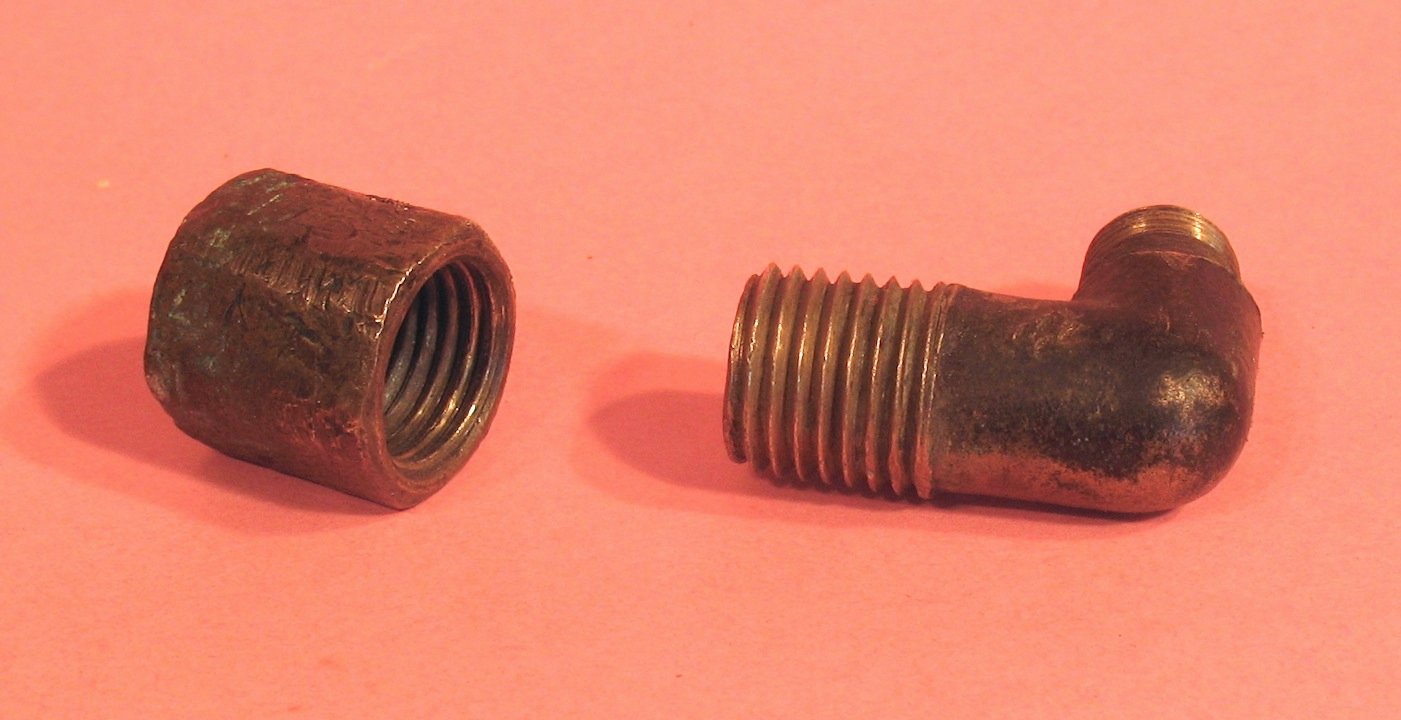

As most of use know, pipe fittings are a tapered thread so really "crankin 'er down" will literally cause a wedging action....and split things you don't want to split.Corey Walker wrote: ↑Fri Jan 25, 2019 3:35 pmThe problem with the fitting isn’t so much will it seal if you tighten it as it is will it be positioned for the fuel line to fit. Cast iron will break if you over tighten a fitting into it but you can cut the threads a little deeper with an 1/8” pipe thread tap carefully so that it will screw in the right amount and face the correct way then use whatever sealer (if any) you want. I did this where I have twist oilers so that the holes for the oil are on top for shackles and forwards on the spindle bolts to make them easier to oil.
About using an 1/8" pipe tap.... I had to grind the end of the tap, reducing its length, in order to get it in far enough. Otherwise it simply bottoms out in the carb.
Although I've used pipe tape and several kinds of "dope" over the years, I found that that those pipe dope "sticks" in a small cardboard tube work very well. Seals very well without a lot of fuss. It does tend to turn hard after time where it's exposed to the air though.

The question of if you use thread tape or not very much depends on what two items are actually doing the
job of sealing. For example, if you use the later style compression fittings for the “fuel line to elbow “ connection then thread tape is pointless as the sealing isn’t being done by the thread. If fuel is leaking between the nut and pipe
it’s caused by a poor seal on the collar or the two tapered points. Even the tapered thread on the “carburettor to elbow” joint shouldn’t require thread tape as the tapered threads should give a sharp edge seal. Problem is, 100 year old parts have
serviceable but worn threads and a sealing compound of some form is needed here in the majority of cases.
With the felt style seal, if fuel is dripping out along the pipe, then again the sealing function (felt) isn’t doing its job and thread tape On the threads could actually be a reason for this by not allowing the nut to tighten up enough to compress the felt.
As mentioned previously, leave a couple of threads free of sealant to prevent ingress into the carburettor
Just my experience. Alan

Fuel resistant pipe dope on the elbow to carb joint is all that's needed. Works good on sediment bowl to gas tank too.

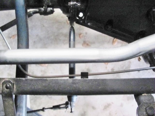

with that much mass hanging off the carb, you would do well to secure the fuel line to the frame of the car back near the front seat riser (general location) to protect the carb from fracture. Do not allow the fuel line to dangle from the sediment bulb all the way to the carb. About 18" of fuel line extending forward to the carb from the secure point will allow sufficient flexibility of everything without stressing the fittings...particularly the elbow fitting. At least 90% of cars I see have no support of the fuel line and that can be a problem. Few know about Ford's securing clamp and even fewer use it. Make sure you have it or an equivalent.

I currently do not have any securing clamp for the fuel line and want to know if I should have one and where! Or are you talking about only vehicles with the gas tanks under the seat? My gas line has a big "S" to allow the line to flex from the rigid shut off mounting to the Holley carb on the engine.
Just trying to remain safe.
With regards to Fords gas line securing champ, is that also for the 26/27 vehicles with the fuel tank in the cowl?

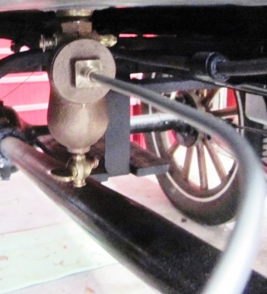

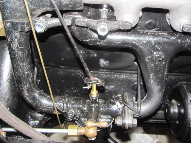

Revaz, this might be a good candidate for the L shaped shut-off valve that the vendors sell. Would eliminate over half on your connections. Sort of pricey, but when playing with gasoline, would be worth it IMHO.
- Posts: 4004
Re: Teflon Tape for Carb Fittings
Will
Re-consider the plumbing on your carb....oh my
That's a bunch!
Can't really do wrong with Ford method. Steel lines, large pack nut easy to tighten or remove when needed with the T-1917 tool kit open end wrench.
Add the hi-quality repro shut off too, at the carb. Keeps one from getting under and makes it a snap to drain the carb bowl when the T sits for a couple of weeks, that gas sitting in the bowl compromises the float, hinges, and needle valve.
Stock modified method in center, pack nut, but with modern gasoline tubing neoprene instead of felt, seals the best and reuses time and again. Steel line cut for it to fit fully into the connector, that way you have full support. Plus removal of the line only requires pulling back some, with a slight bend, and the gas line is free. Anchor the gas line to the frame with the Ford clip.

"Now there is one for the “Rumor Mill”... Any actual documentation that this really happened, or just something you heard somewhere???"
OK, here is my personal experience with a copper line. It's a Model A, and it's engine oil, but the effect was the same.
Some years ago I bought an aftermarket oil filter kit for my 31 Model A. The kit included a length of 1/4" copper tubing to go from the block to the filter base. I kinda wondered about the use of copper, but figured for amount that I drove the car, it would be OK.
After installing the filter kit, my next errand was to take a package over to UPS. I tossed the package into the rumble seat and drove the 2 1/2 miles to UPS. When I walked around back to remove the package I noticed a line of liquid on the ground, coming from the street right up into the spot where I was parked. Ever the optimist, I thought, "Boy the last guy who parked here was in real trouble." As I returned to the car after posting the package I noticed a peculiar glint off the right front fender. And then I notice the same shine on the top of the running board. As I got closer, I realized that the fender was covered in oil and the running board was literally filled with oil. In a flash, I knew what happened.
When I opened the hood I saw that the copper line had broken at the fitting that went into the filter base. My first action was to pull the dipstick out to see if there was any oil left. One quart. Boy, was I relieved
The good news part of this story was that within less than a minute a fellow pulled into the parking lot. He was restoring a Model A and just wanted to look at the car. While we were standing there discussing the best way to get me back on the road and home, a second Model A owner pulled up to see what was going on. #2 guy allowed as how he lived very close and had fittings on hand to plug off the new filter system, and would go home and get the fittings, tools, and a few quarts of oil.
Before benefactor #2 could return, the UPS maintenance mechanic wandered out because somebody told him there was a Model A in the parking lot. The mechanic also owned a Model A. He walked back to his shop and bent me up a new steel line. By the time he had the new line installed, #2 arrived with the oil. We poured the oil into the engine and I was good to go. Nobody would take a cent for their trouble.
Lesson #1: Don't trust copper in a vibration environment.
Lesson #2: Model A guys are just great. And there seem to be a lot of them.
Lesson #3: One quart seems to be adequate for a short time.
